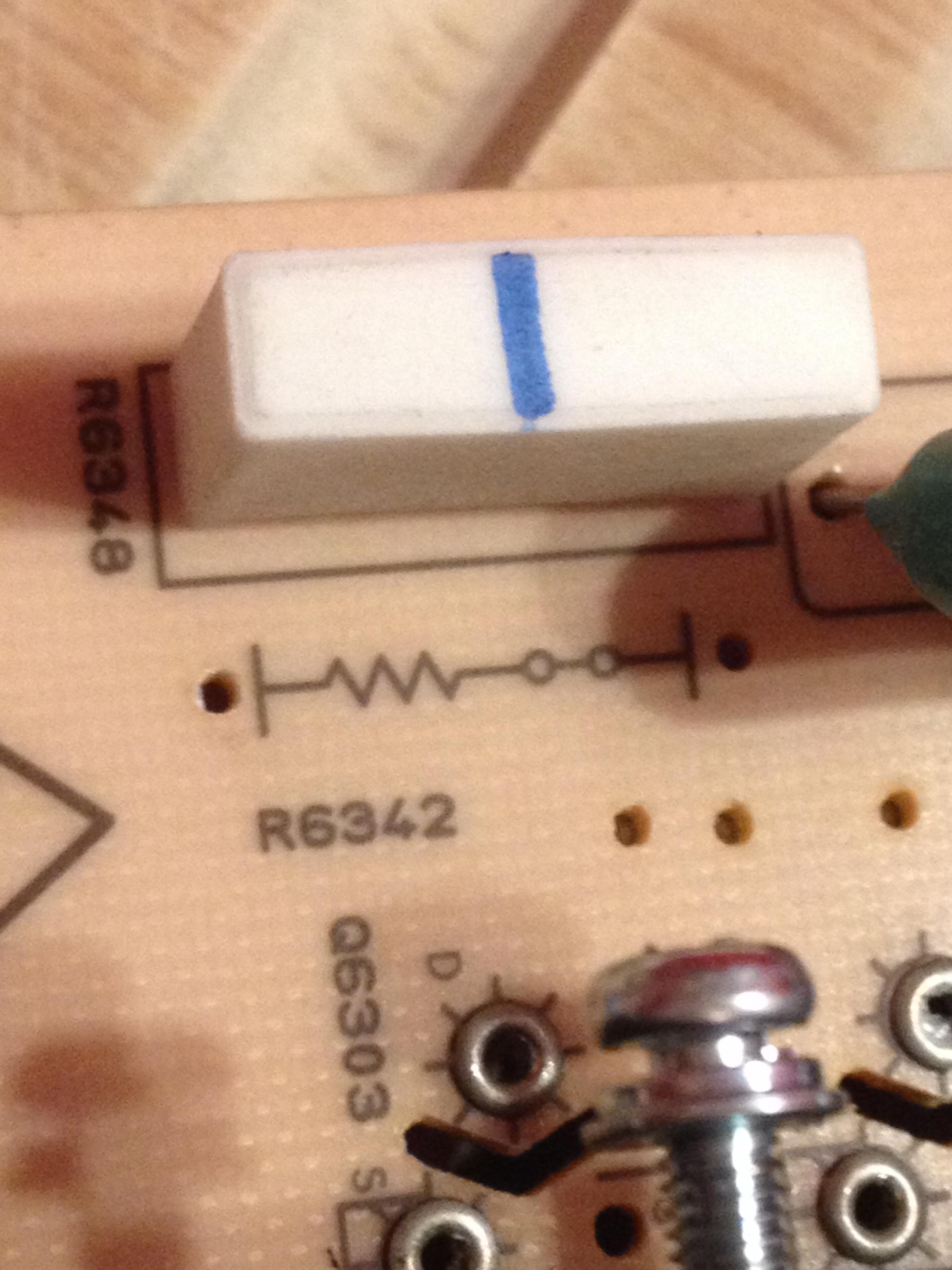

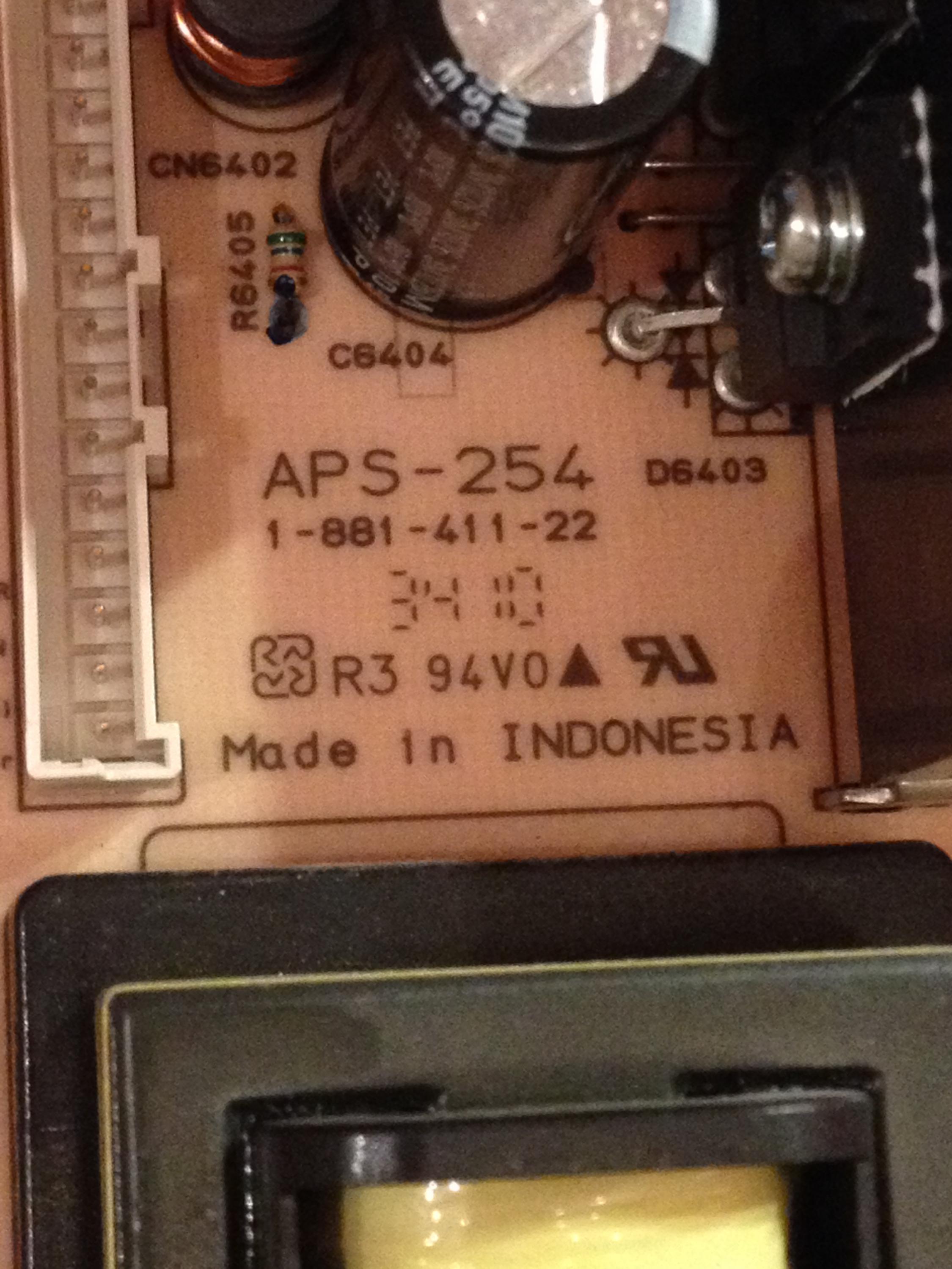

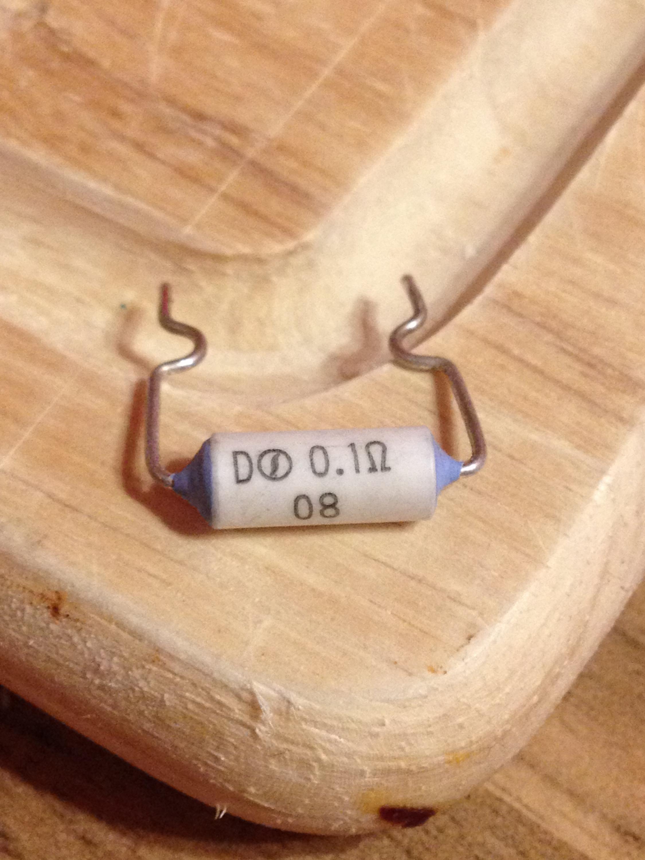

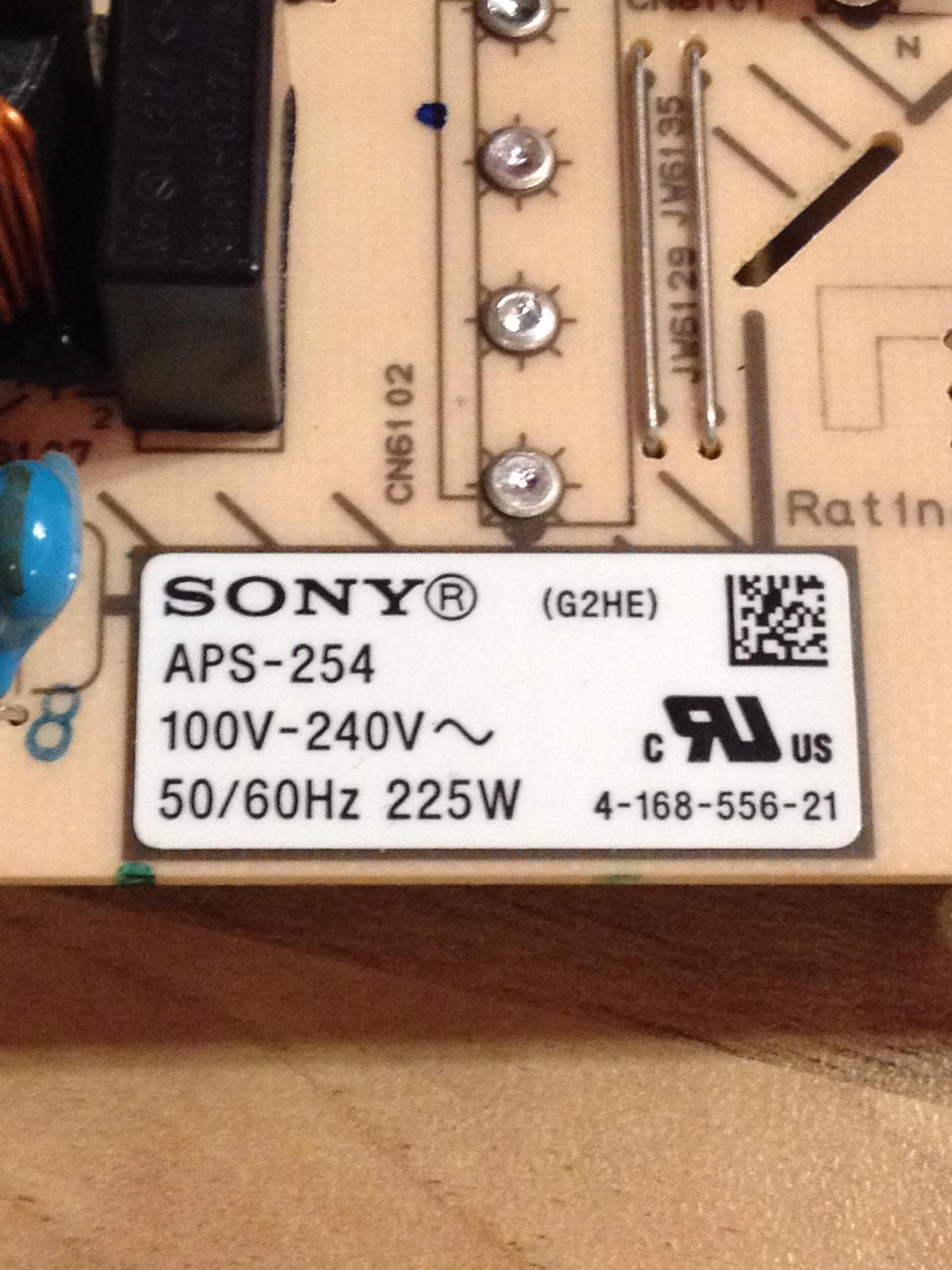

          Hi guys, I have an update on this fault.
          Working on a SONY KDL-40EX403, from standby (red) light turns green for around 2-3 seconds and then 2 red flashes. Not a firmware issue, it was the power supply APS-254 not turning on, so no 12V main for the SSB.
          Found Q6302-6303 s/c R6342 (0.1R Fusable) o/c Q6302-6303 ARE 2SK4096 I had no stock, substituted with STP9NK50ZFP.
          Set now fine.

            Re: Sony KDL-40EX403 blinking LEDs.
            hi,I am trying to fix my board aps-254 and I need a R6342 (0.1R Fusable)
            any idea from where to buy one or some replacement .
            thx
              thx
              Farnell, CPC or eBay supplier. Got a picture of the component or more specifications?
                yes I have some photos taken .
                • matyka
                  • Jan 2015
                  • 179
                  • Uk
                  Hi I replaced with this and is working now
                  FRN25JR22 FUSIBLE Resistor 0.22ohms 1/4watt 0R22
