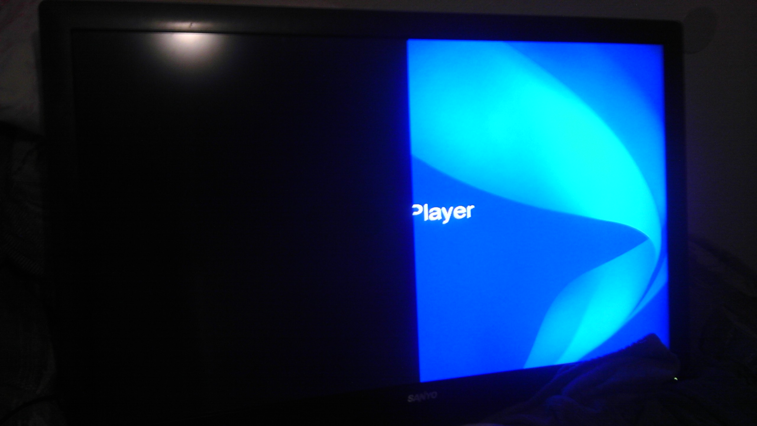

    hi all I have a Sanyo dp46819 lcd and the left side if the picture is black....the backlight is good and when I touch the panel u see the liquid like The good side.. the line runs right through middle of screen and from middle to left up and down its all black...when its on a black background I can see the left side is a tad darker.. would like to fix it.. please help..

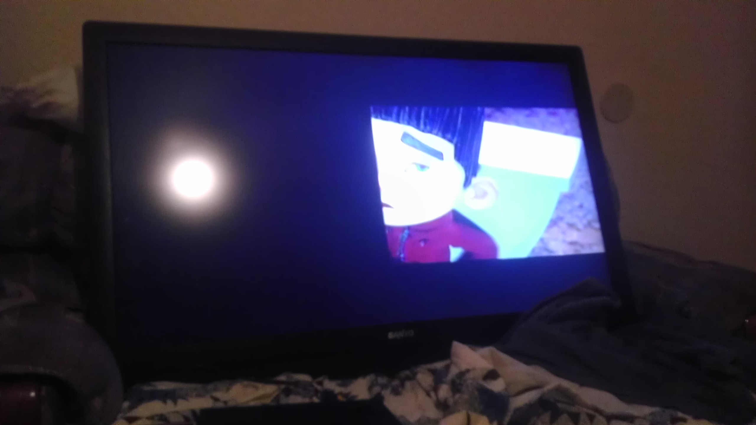

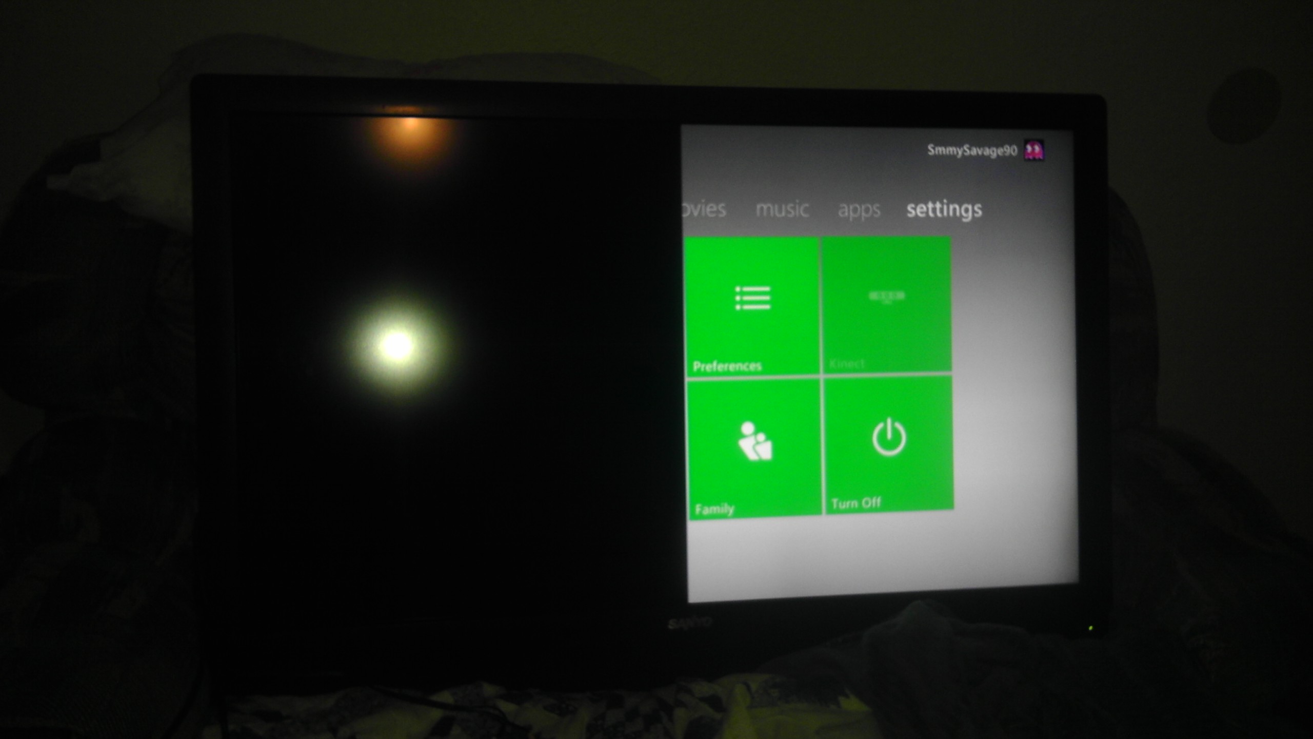

    another pic.

      There should be two flat white cable between the T-CON and the LCD PANEL, it looks like the left side cable may not be connected or the drive for that side is dead. See post 10 for the pictures of typical flat white ribbon cables.
      https://www.badcaps.net/forum/showth...ight=LG+47LH55
      Did it happen all the suddenly?
        Re: Sanyo dp46819 left side screen black
        Tab bond defect
        https://www.youtube.com/watch?v=purk_SyiT44
        (Same cause - symptoms vary from no picture in affected half to scrambled/unstable picture or vertical lines.)
