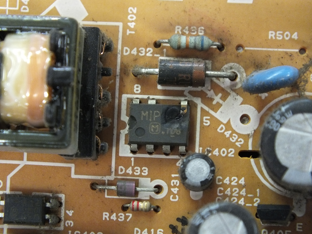

    Hi all. This TV will not power on; it is totally dead. Inside has a damaged IC with the name "MIP". Has anyone come across this IC, (IC402)?
    See picture:
    Thanks.

    All I can tell you is it's an IPD(intelligent power device) by panasonic, lots of different types.
      Re: What is this IC on Murphy TV37RN15DM
      That looks like an Orion OEM board? (Orion: One good OEM that used to make pretty decent badge jobs.) The schematics for it may be available. What part #s are present on the PSU?

        Yea I was thinking about that. Finding a schematic manual is proven difficult.
        All I can see is "CEG354B". No name you mentioned.

            Searching on ebay (UK) I came across the actual board for £29.99. But all I need is just the name of the IC.
            I have a few for Orion OEM.
            Can you tell me the name of the IC? Or sell me one?

                OK. I have looked at your web link but I do not see anything regarding: Murphy TV37RN15DM and this number on the board: "CEG354B".

                  I had a look and I don't have one. Sorry! 2000 files and you'd think... maybe not. More to collect!
                  Anywhoo... Did a little Googling and found a very similar PSU.
                  http://assets.shopjimmy.com/media/ca...re-v.1-top.jpg
                  MIP2F4 looks to be a possible chip match. I'd suspect ORION would use the same chip across all their boards.

                    You are a star, Tom! Thanks. That will do. It also have the ic402
