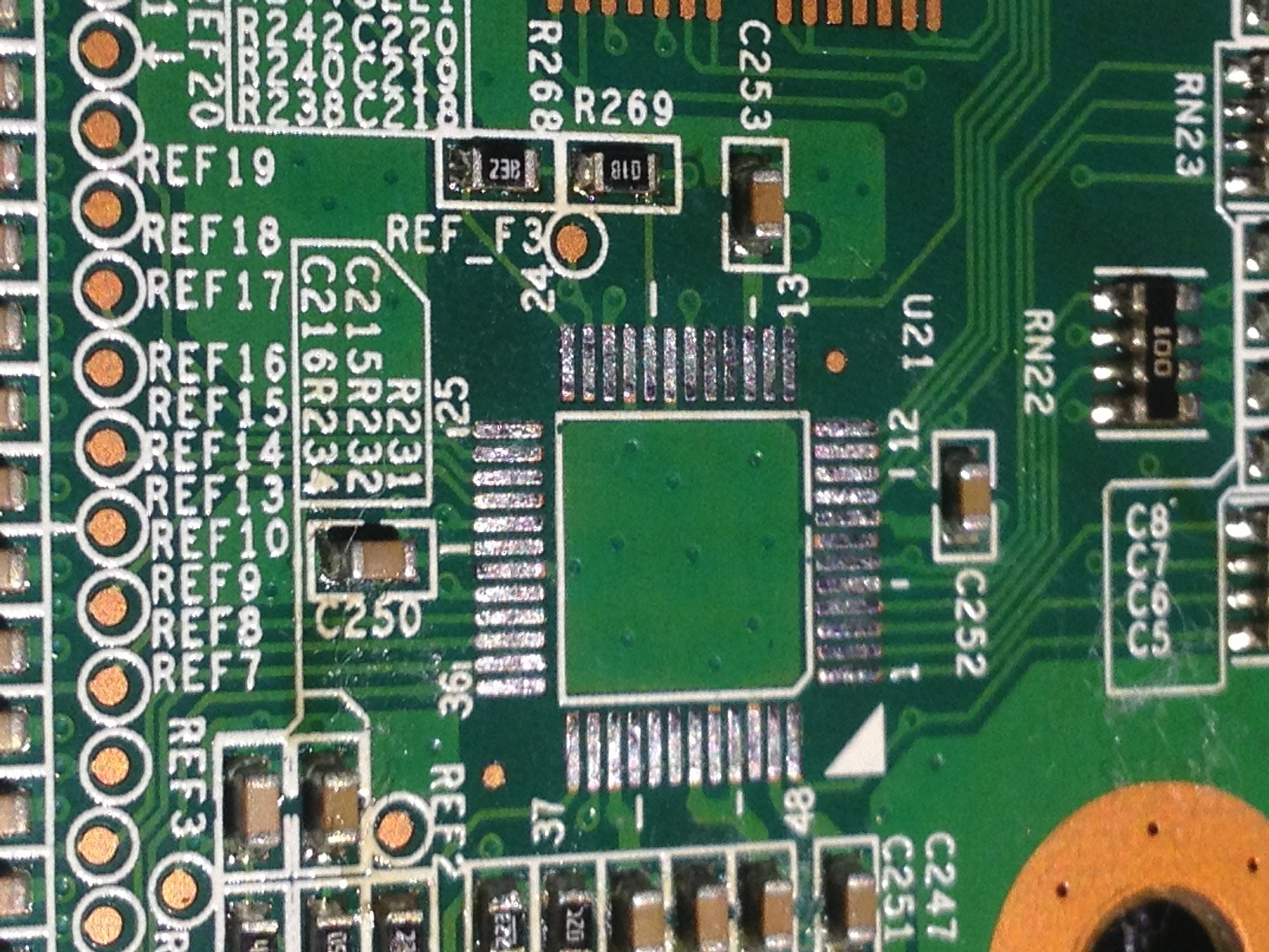

      Ah I always hated buying parts from china. Also found this one, I don't mind spending an extra $7 for a little faster shipping though. These ones will work too right?
      http://www.ebay.com/itm/5-PCS-E-CMOS...item20d3489874
        Re: Samsung LCD TV LN40B530P7N Distorted Color Picture
        They look fine.
        Bear in mind all US sellers are doing is buying them from China. The only difference is better service and support.
        Practice removing ICs like that on dead motherboards, soundcards etc before moving to the T-con board.
          I have a hot air gun, would it be easier to remove that way?
            Hot air works good; cover all but the IC you want to remove with foil. Before replacing the IC clean the pads with solder wick and use plenty of flux when putting the new IC on. The heat pad in the middle is important. Use a tiny bit of solder paste on the PCB (use the same amount as you would use for a CPU heatsink, if the CPU heatsink were as small as the pad.) Solder paste is very slightly adhesive, so you can use it to help you hold down the chip. Solder four corners, then flood all the pins and wick up the excess. Then heat the IC with a hot air gun (limit 300Β°C) for about a minute on the bottom of the board to solder the heatpad. With practice I am able to do one of those chips (generally, not simply on T-con) in about 10 minutes.
              Looks like I got the hard part, I was able to remove the IC successfully! At first I thought I ripped off a couple of traces but it was just the really dried up solder. Hopefully I didn't overheat anything that was near around it too much (even with the foil) that's the only concern I have. It doesn't have the heatpad in the middle so it should be easier to replace with a new one. Time to order the new one.
                The pads look perfect to me.
                Looks like the reason these gamma chip may be dying is due to the lack of heat pad. The chip itself has one; they haven't used it so it will run a lot hotter. Like running a CPU without a heatsink, the lifetime is much shorter. I recommend adding a small heatsink to the IC after this repair as this is the case. For example:
                  Since the other chips have those rubber pieces on them that also attaches to the metal plate which covers the entire tcon, should I put one of those on the gamma chip for the heat to transfer to the metal plate? Not sure if I would be able to screw on the metal plate if there was a heatsink on.
                    #29
                    That could work too. I forgot about the shield.
                      I use the foam thermal pad on these too..
                      For reinstall of new chip here's what I do.. clean get the pads good and clean with flux and alcohol and qtips. Then apply liberal amount of paste flux to pads. Place new chip on board and align very carefully.
                      I use a 1/32" chisel tip and .015" solder and tin the tip of the iron and do the corners first, then hit each pin after. You can use an exacto knife to make sure there are no bridges between pins.
                              Just got the IC's in today, when I solder them on the little circle on the chip is suppose to match with the arrow on the board correct?
                                #35
                                Yes; also it should line up on one side with pin 1 (only one side will work!)

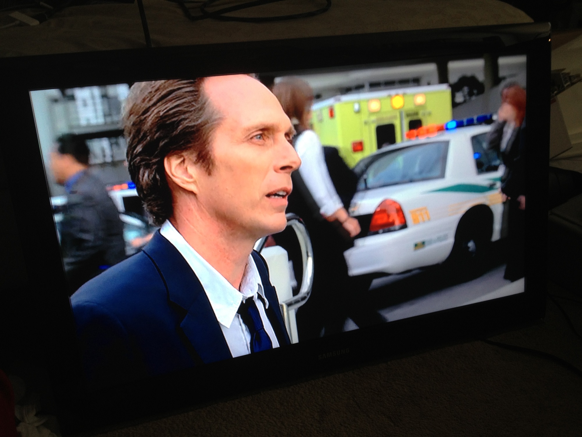

                                  Finished it up! plugged everything back in and it works! =D
