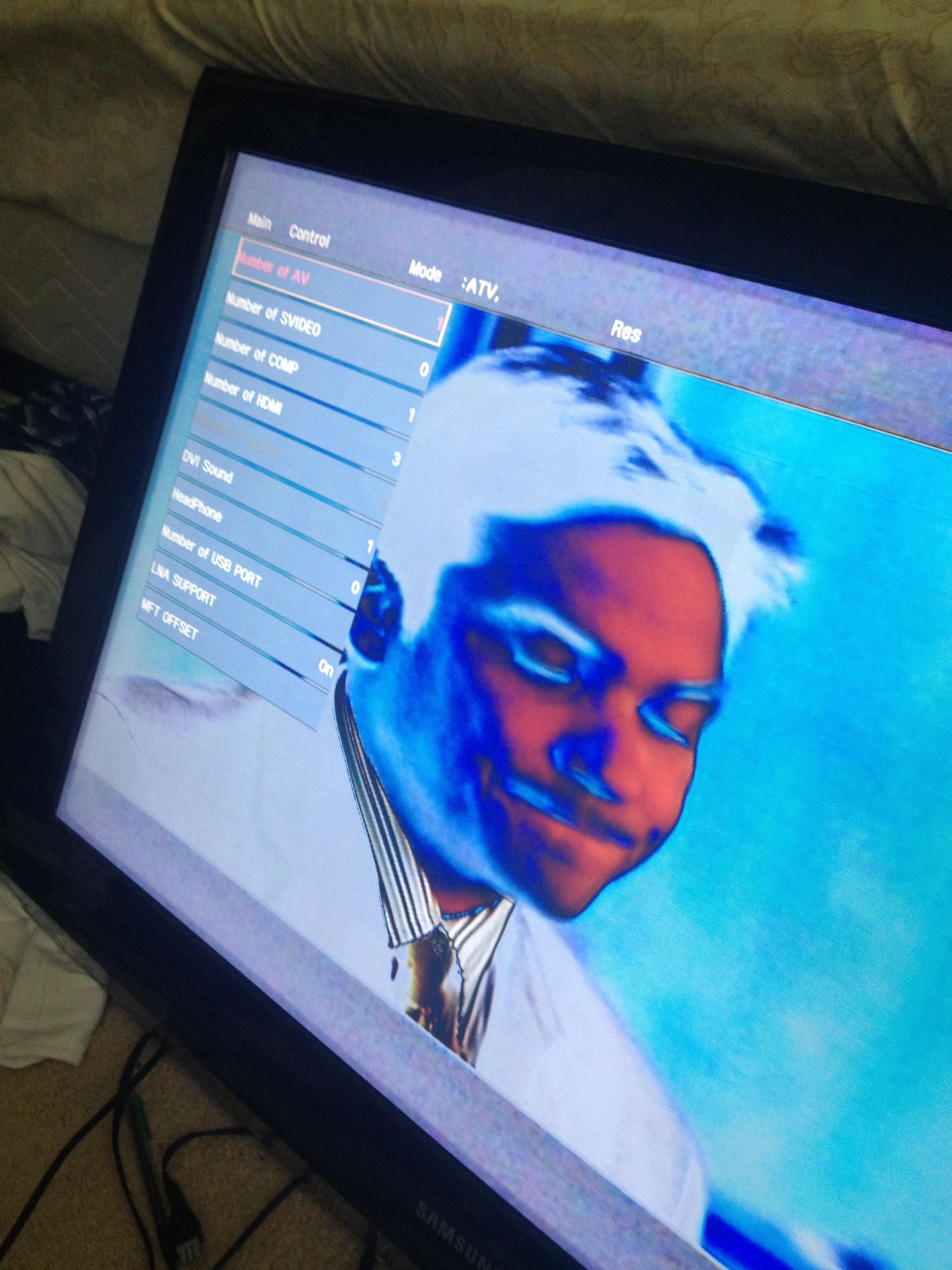

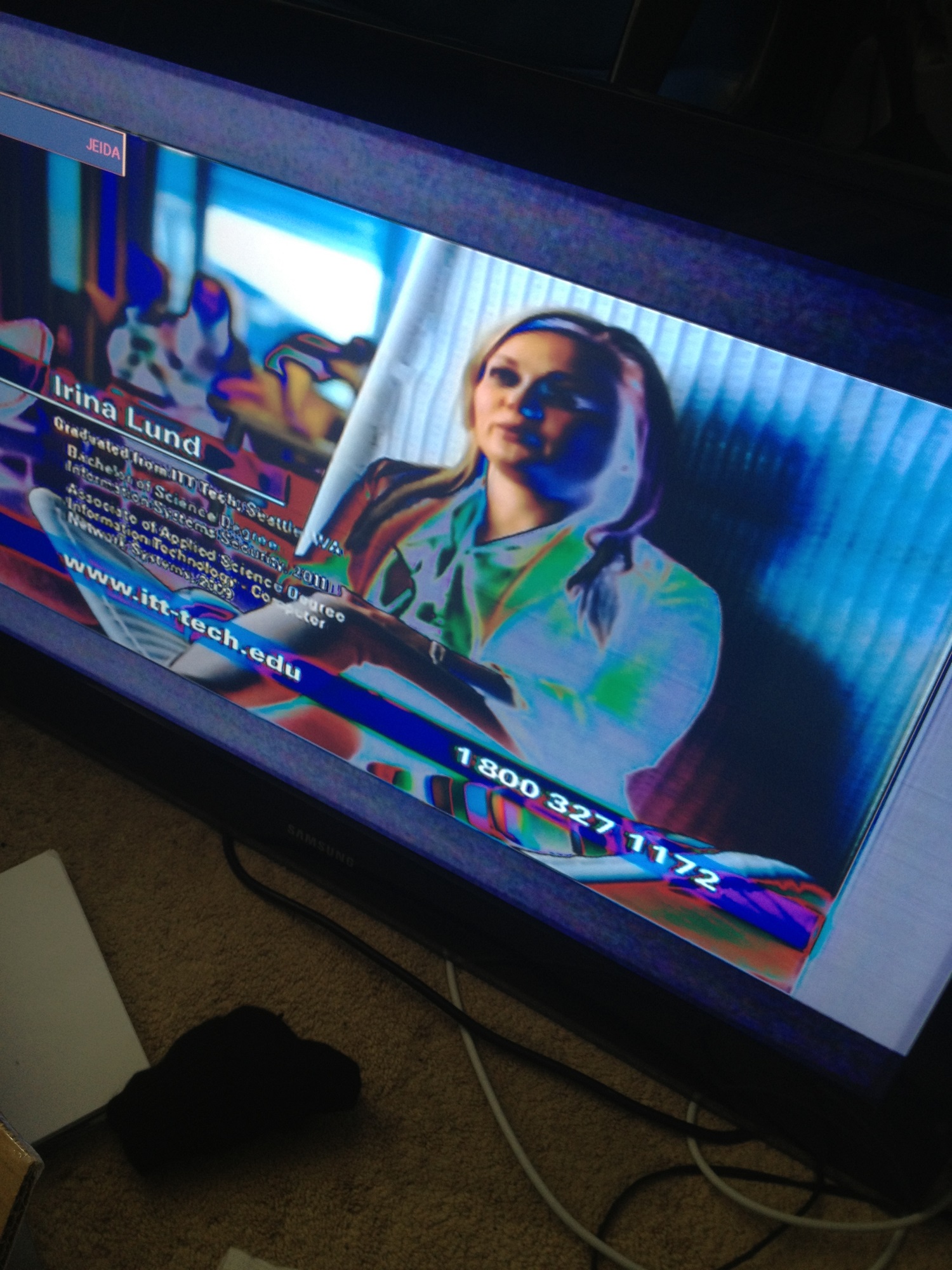

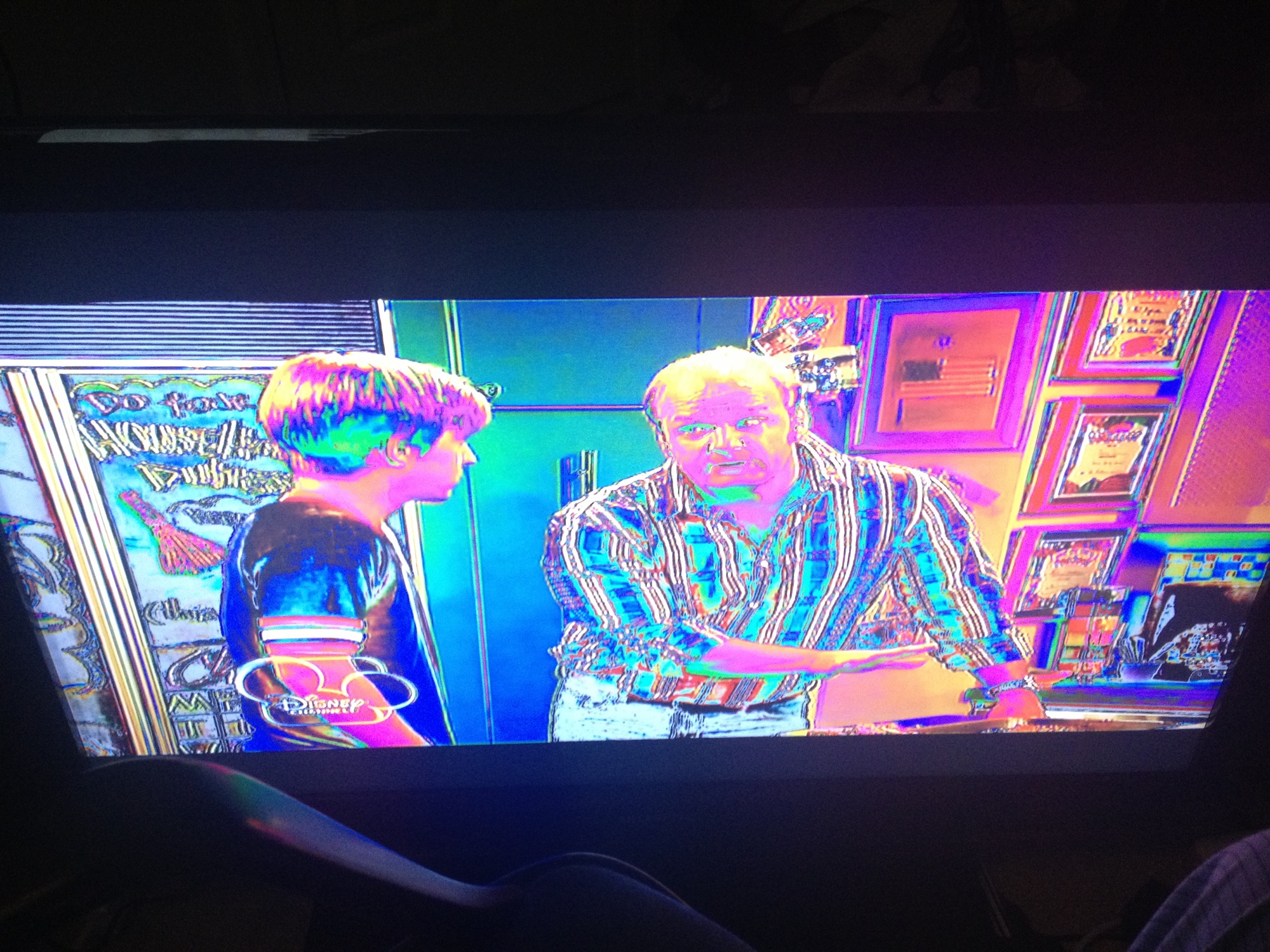

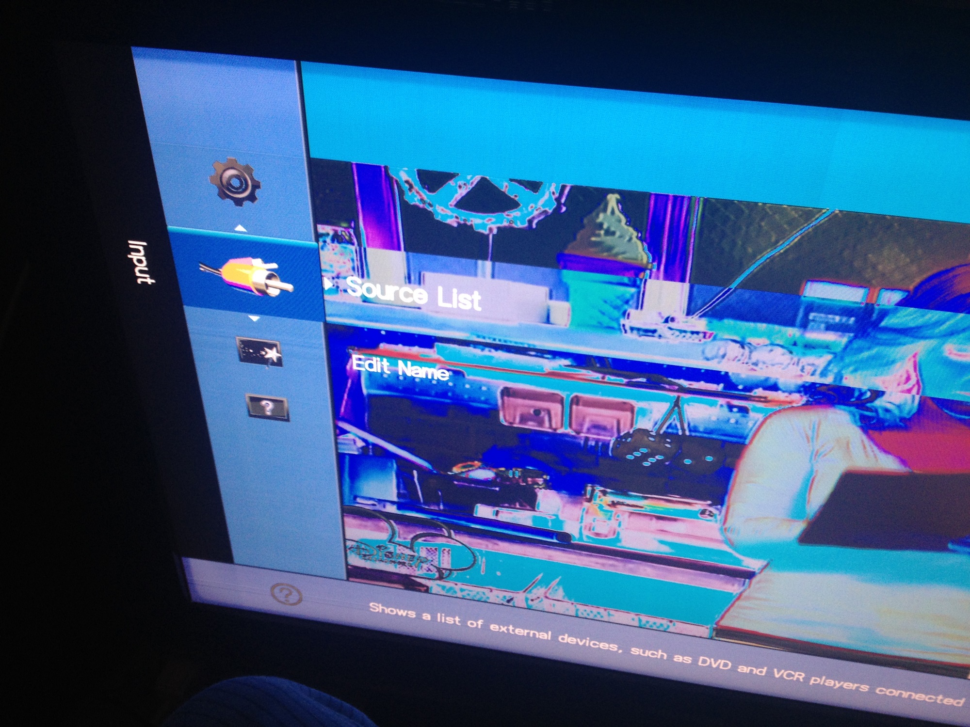

    I have a 40" Samsung Model: LN40B530P7N
    The color of the picture seems extra contrasted or distorted like. It would actually look kind of normal only when cartoons are playing. It affects all the inputs.
    If I'm seeing it right, it seems to be getting worst from when I turn on the Tv from cold and leave it on for awhile. A thermal issue? Should I check the Tcon or the Mainboard first?

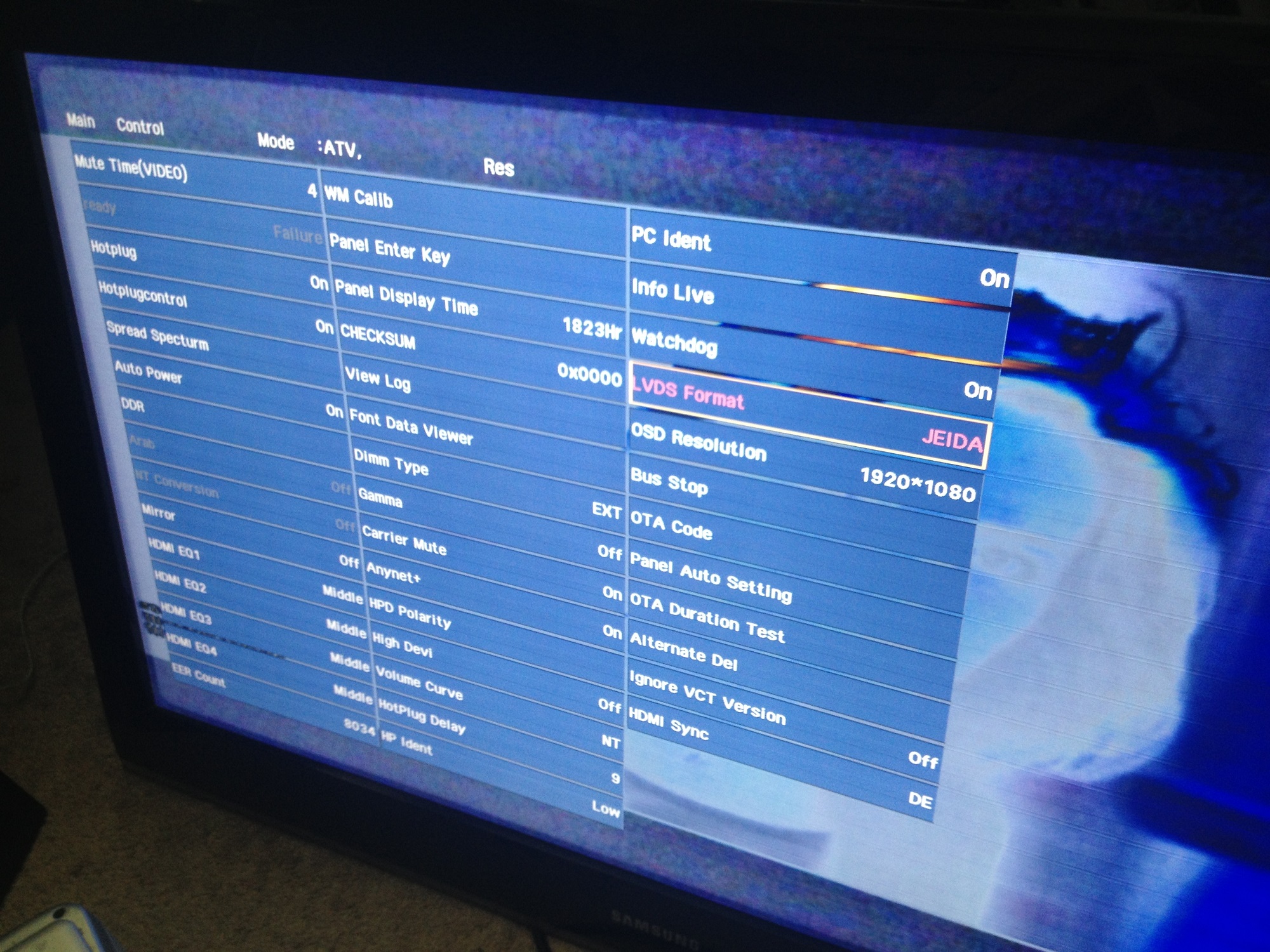

    Select a source which shows the issue.
    Turn TV off, leave it in standby.
    Press, on remote, Mute, 1, 8, 2, Power in quick succession.
    TV turns on. Service menu appears.
    Browse the menu. Look for options marked LVDS format. If you need help, take a picture of the service menu. If you find an LVDS format option, change the value using the remote to one of the other values until the picture comes back normal.

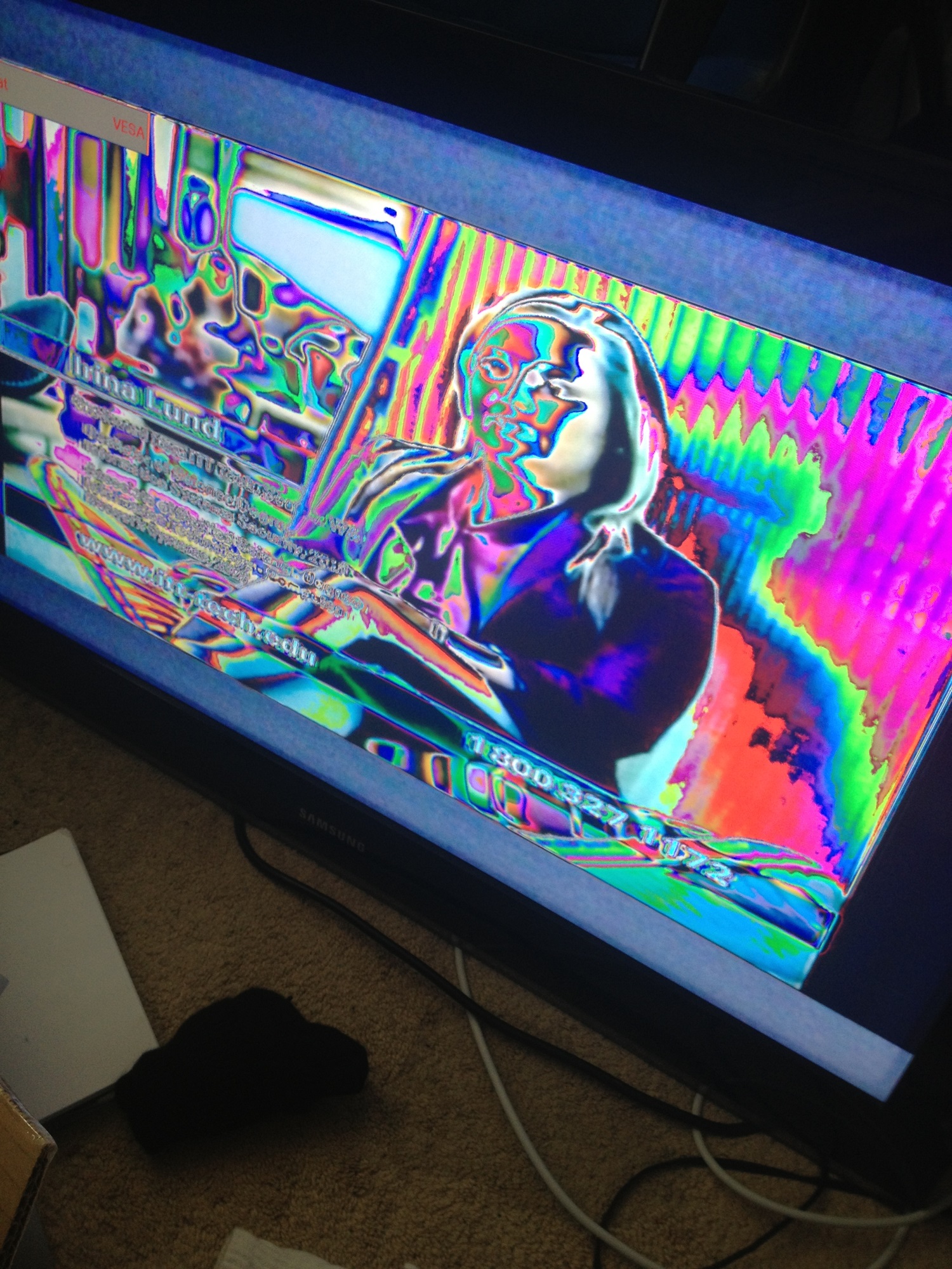

      Got to the service menu, I found an option "LVDS Format" There was only 2 settings for it, JEIDA and VESA. It is default set on JEIDA, but changing it to VESA seem to make it worse.
        Re: Samsung LCD TV LN40B530P7N Distorted Color Picture
        OK, set it back to the original, then look under Panel Enter Key. What appears when you select that?

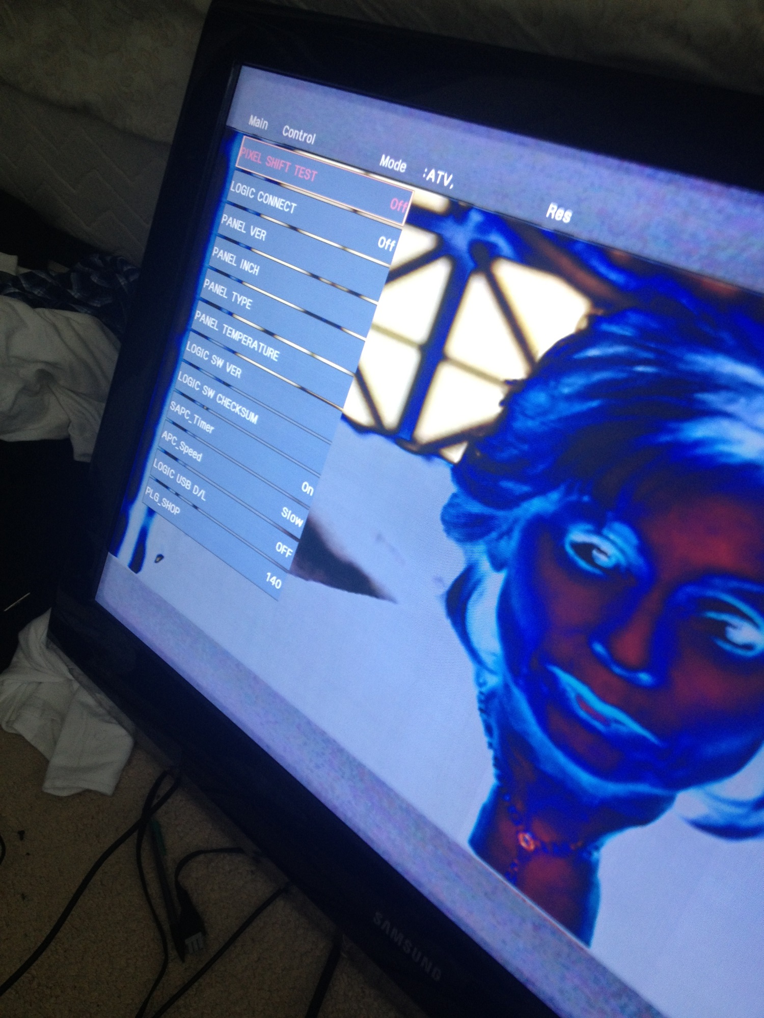

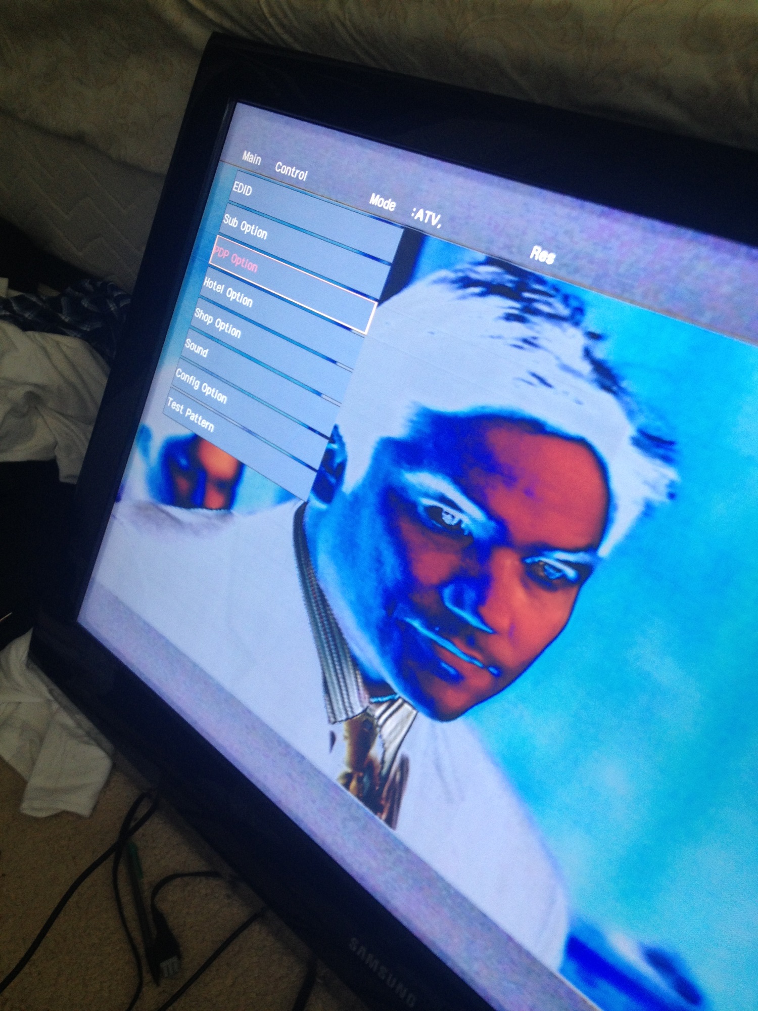

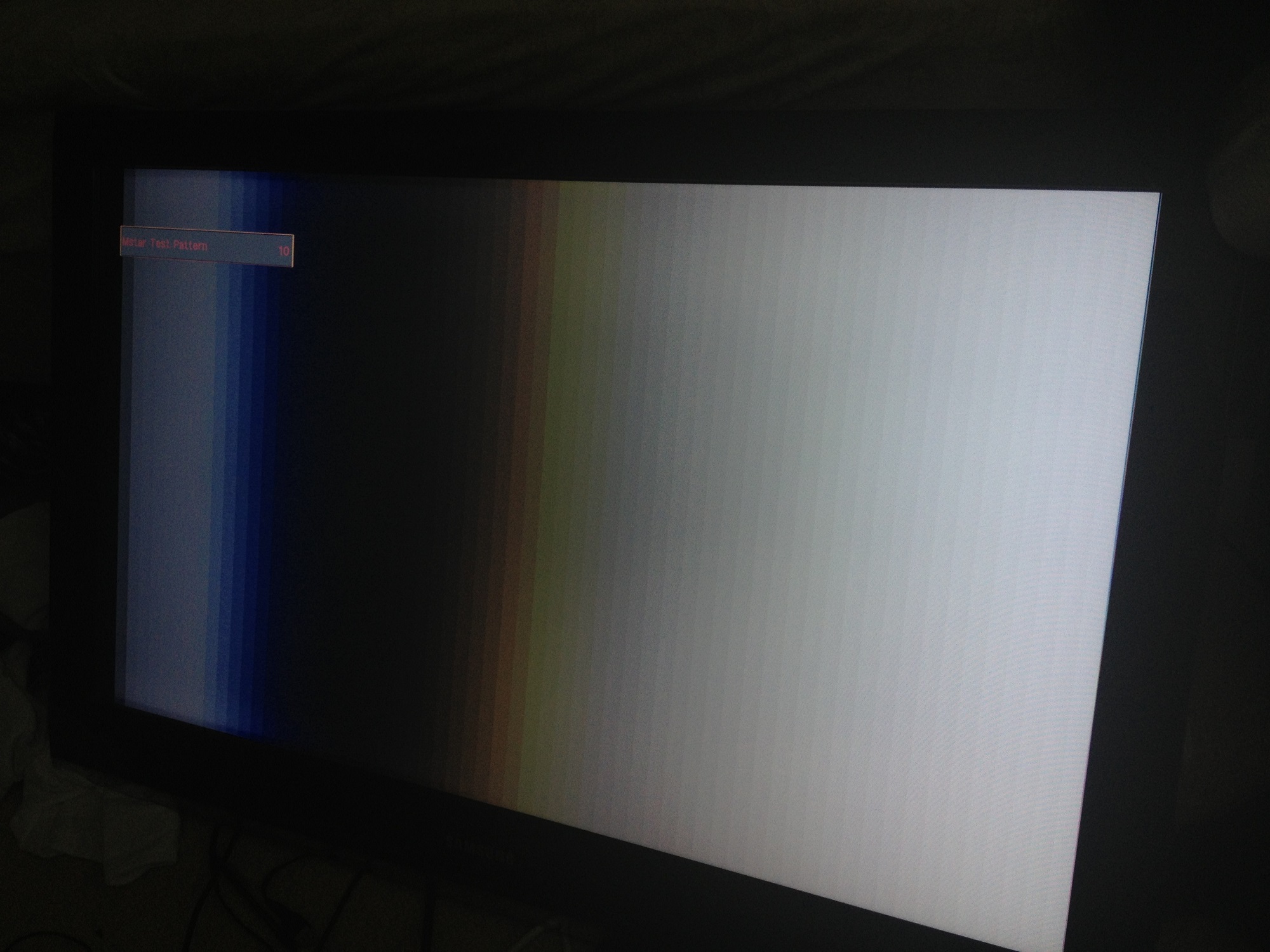

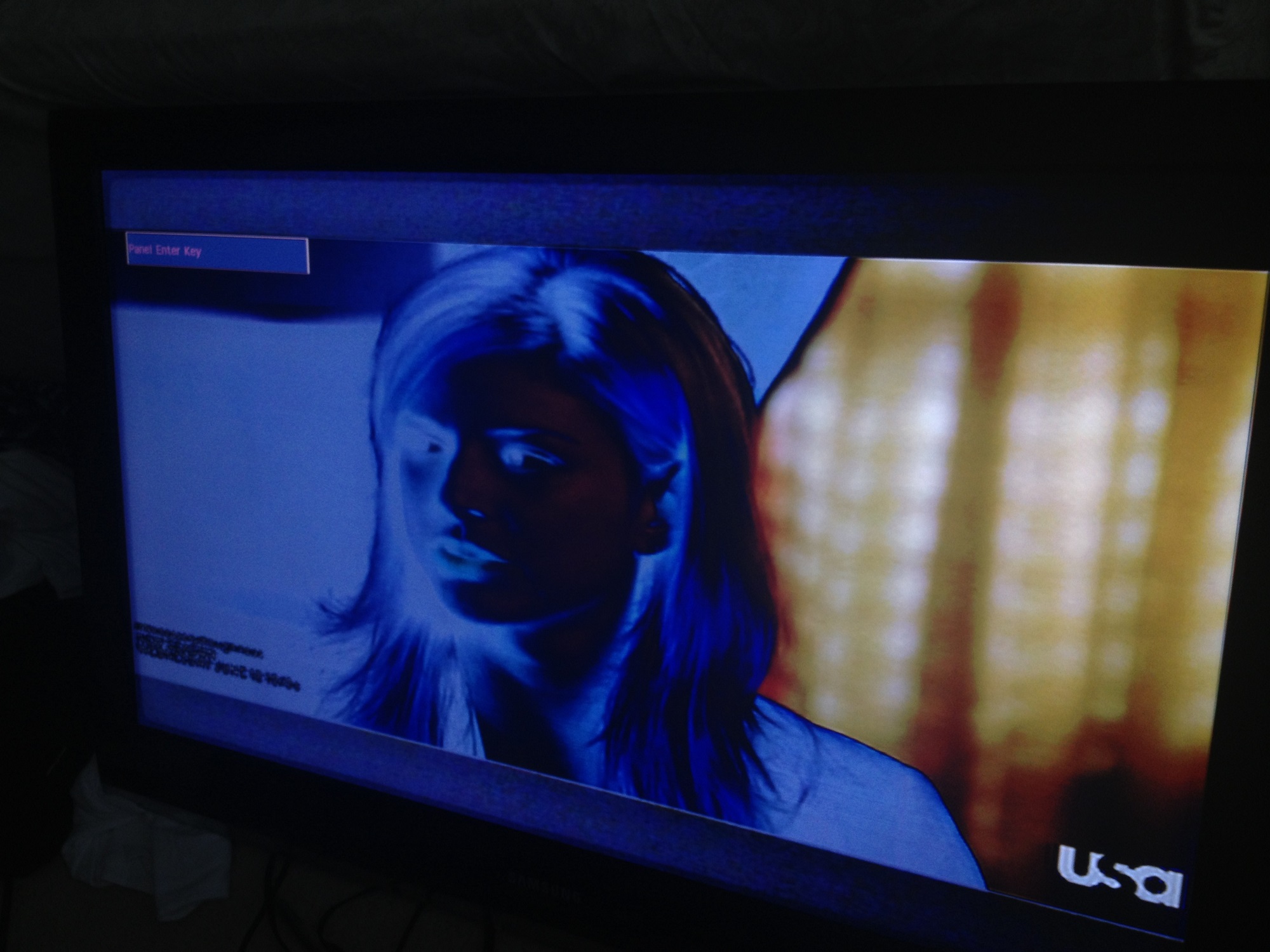

              Yep, nothing happens pressing left/right, enter, buttons, etc. Heres a couple more options I found.
              The picture actually looks like its becoming negative. When I first turned it on I thought to my self that the problem wasn't that bad, but now its really obvious, so I think it has been getting worse.
                Go down to PANEL TYPE and try selecting it.
                There is a chance it is GAMMA IC problem.
                • Glitcher
                  • Mar 2013
                  • 673
                  • USa
                  Just tried selected it, and I can't do anything with it either.

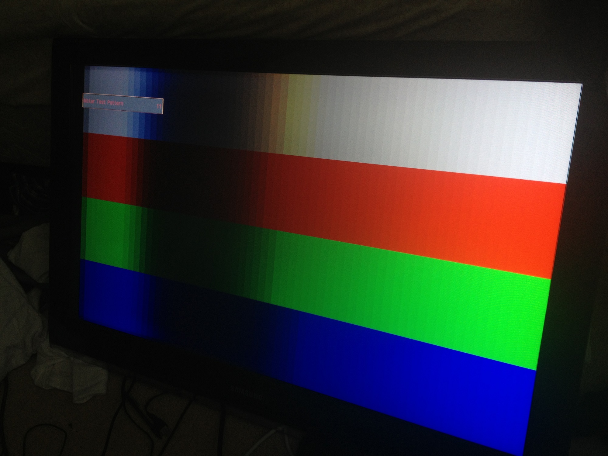

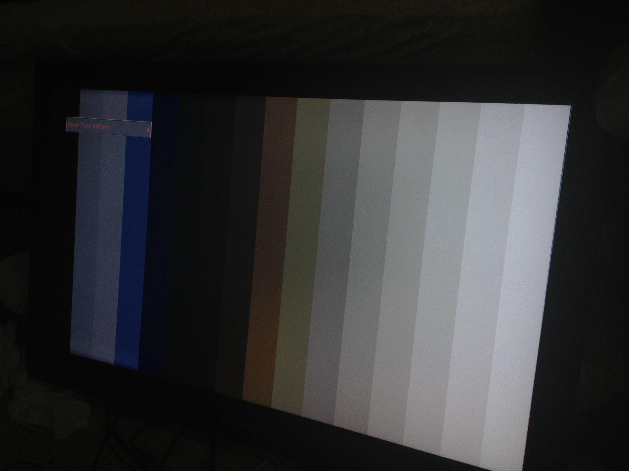

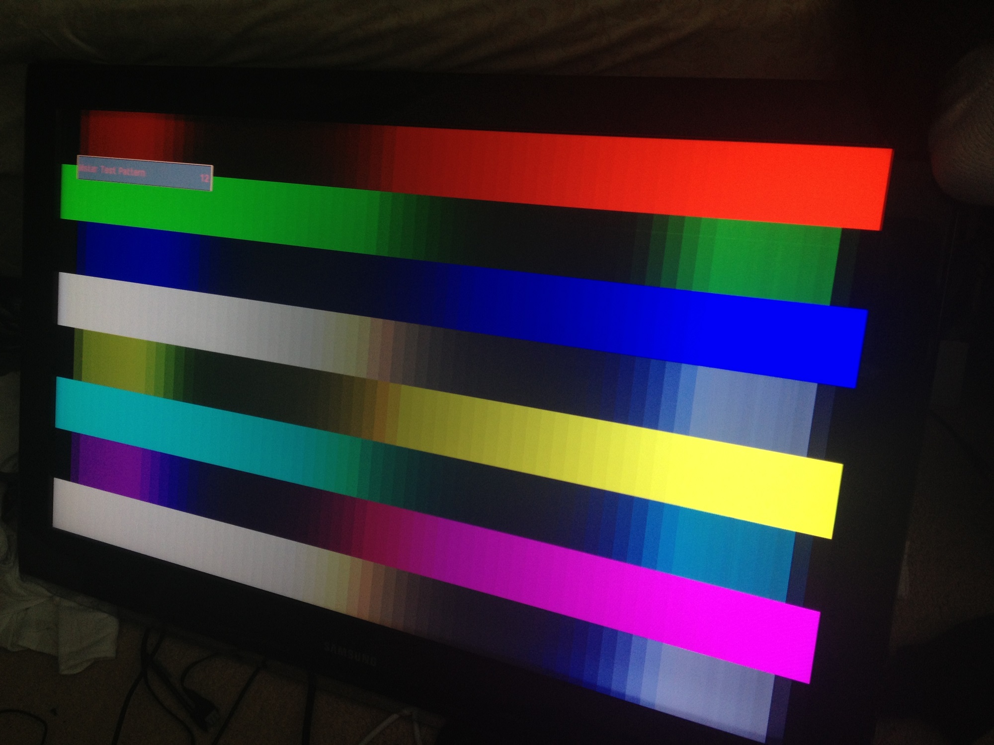

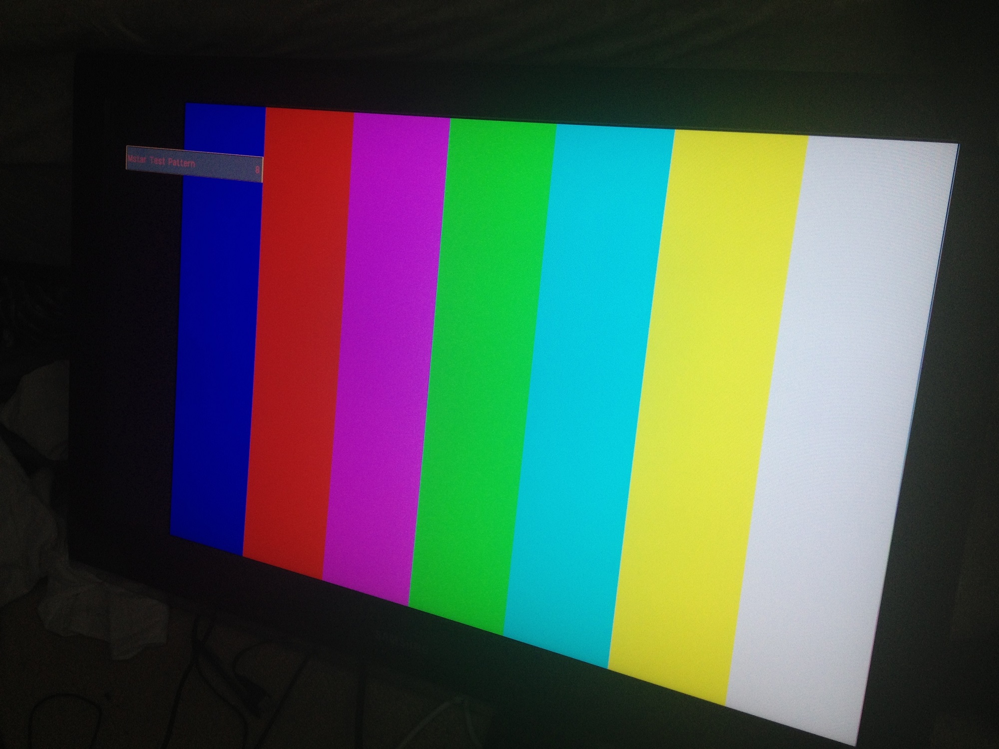

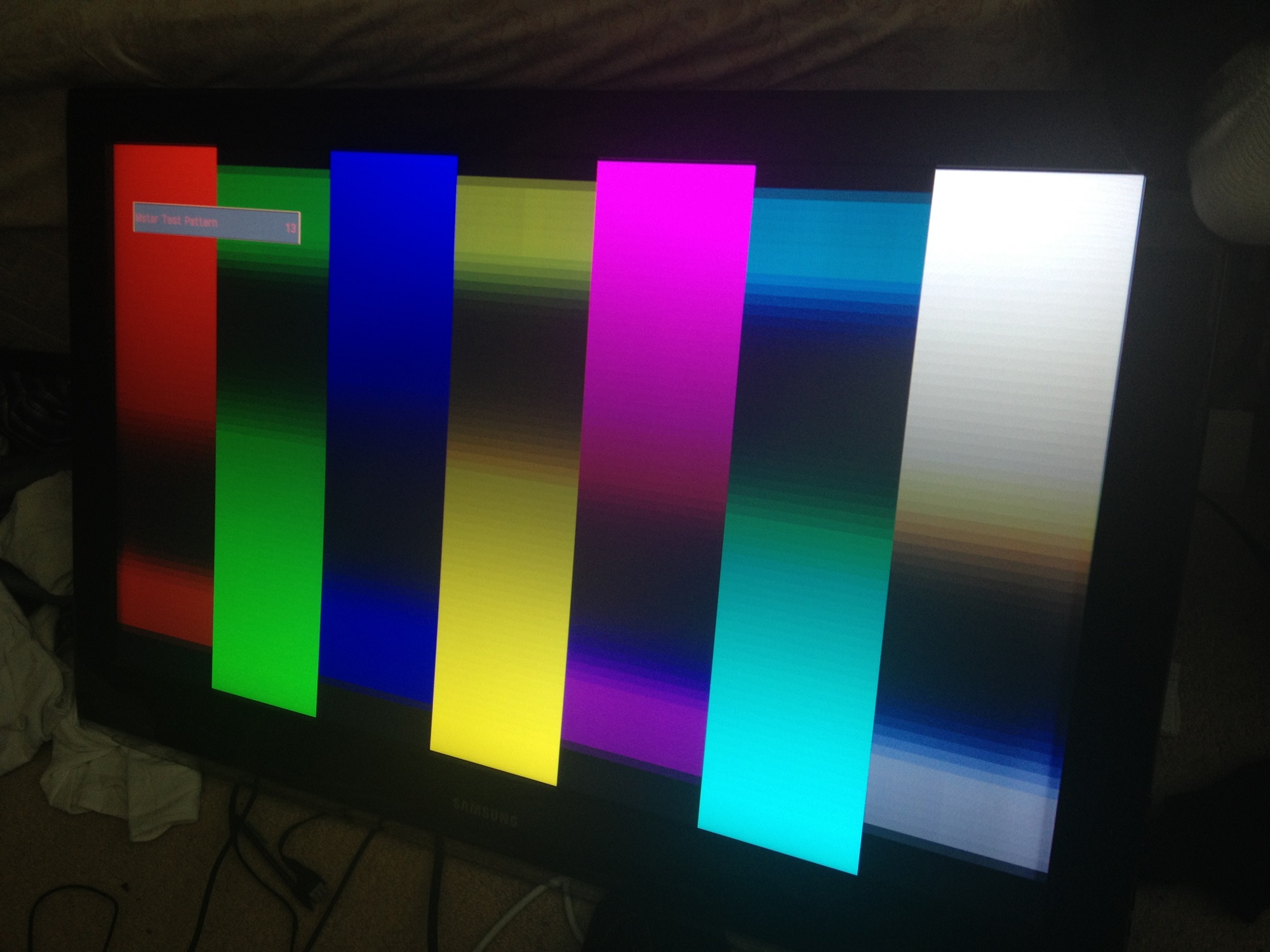

                    Very strange, can you go into TEST PATTERN and see what each test pattern looks like?
                    • Glitcher
                      • Mar 2013
                      • 673
                      • USa
                      All the solid colors seem to be good (black blue red, etc) until the later colors.

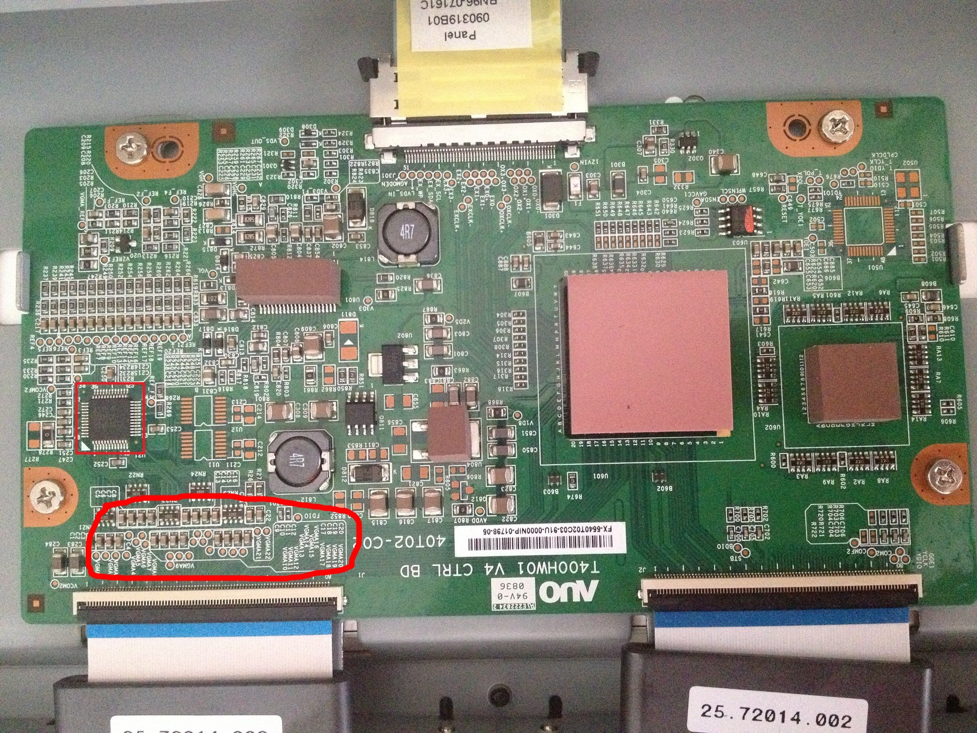

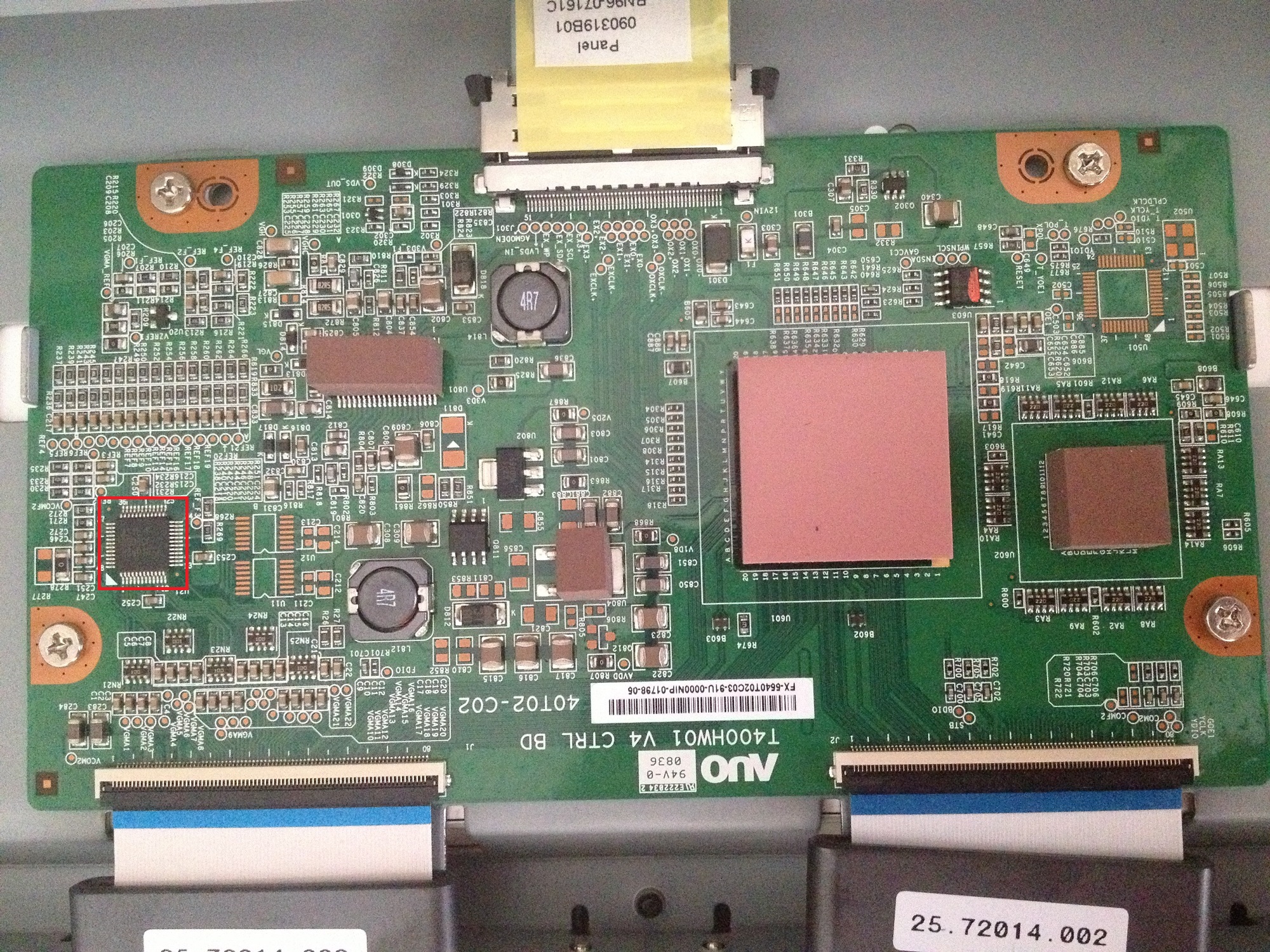

                        Personally I still think main board but can you take a picture of the T-con? May have common AS15G IC on it which fails and can cause a similar fault.

                          Here you go, The T-con does have a AS15-F chip. Trying to find my compressed air spray.
                            See the points marked VGMA1, VGMA2 ... VGMA20?
                            Use your DMM to measure each. Put your black probe on the chassis of the TV and red on each pad from 1 to 20. DC20V range. See what readings you get, post them here.

                              Heres all the measurements I got from pads 1-20. (In volts)
                              1: 15.46
                              2: 15.17
                              3: 15.04
                              4: 12.82
                              5: 11.9
                              6: 10.82
                              7: 10.17
                              8: 9.86
                              9: 8.51
                              10: 8.35
                              11: 7.90
                              12: 7.09
                              13: 6.86
                              14: 7.33
                              15: 11.44
                              16: 9.29
                              17: 4.66
                              18: 3.59
                              19: 2.65
                              20: 0.61
                                Definitely bad then. The voltages should decrease or increase one way only. That spike around 14-17 is probably the cause of the fault. Replacing the IC or the T-con should fix the fault. I retract my original conclusion of main board; I've just seen so many main board solarised picture faults recently I went straight for that.
