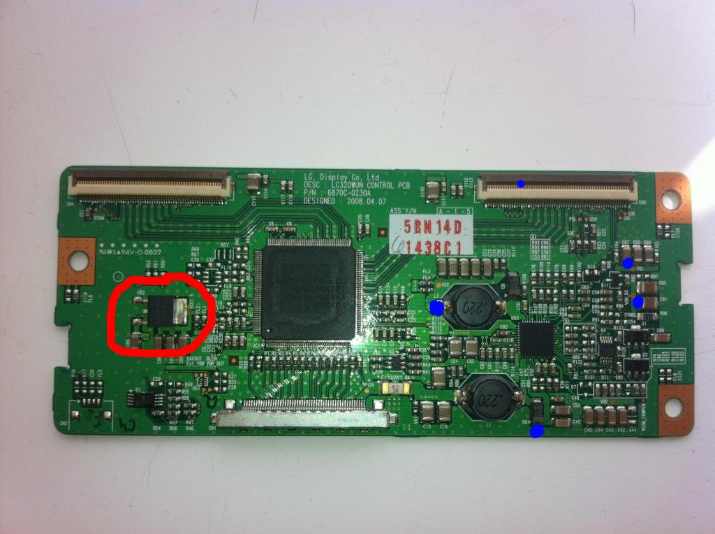

    hi guys
    can anyone help ?
    im having problems with a lg tv
    it has power but cant seem to get the picture to work for example the black screen blinks when its powered up,the back light is lit up but i also cant seem to get the remote to work with the tv
    im thinking possible tcon board problem ?
    thankyou

            How's about a picture of your T-con?
            • sordids999
              • May 2013
              • 2152
              • uk
              Re: LG 32lg7000
              there u go m8
                Re: LG 32lg7000
                See the short white object with the two gold pads at either end? Set your multimeter to 200 ohms and stick it across it. What do you read?

                                  OK, I've highlighted some test points.
                                  RED circled device: Report part number e.g. AB1117-33 and measure the voltage on each pin (DC 20V, red probe on each pin, black probe on chassis, TV switched on.)
                                  BLUE test points: Measure voltage at nearest exposed metal, using same method.
                                  Also, try seeing if disconnecting one ribbon allows half the screen to work, try with one ribbon removed at a time.
                                  edit: Ignore the blue dot on the ribbon connector.

                                    Re: LG 32lg7000
                                    part number but so small i think is RT9154A/16GLA38TN
                                    but i must say the 15.3 volt reading i really struggled to get a good reading
                                      Re: LG 32lg7000
                                      You are getting +7.7V on the point near VGL, or -7.7V?
                                      You can ignore the connector ribbon test point (top right), I drew that accidentally and saved the file before it was too late.
                                      The regulator readings don't make much sense, and unfortunately I can't find a datasheet for it.
                                      Please try with half the panel ribbons disconnected and see how it goes.
