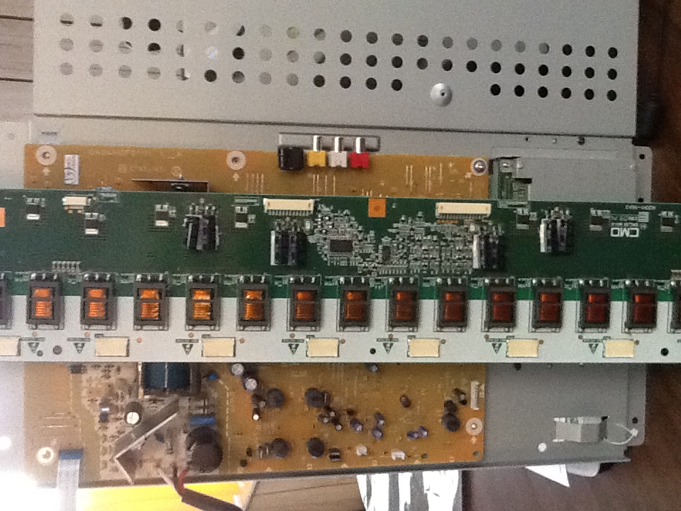

    I have a 42PFL3704D/F7 that will turn on and off but there is no video\backlight at all. I have read all posts related to this model. I have downloaded schematics and all voltages seem to be accurate with whats posted on schematics. I have pulled all caps on inverter and verified, checked 2 fuses and reflowed all connections on transformers/coils on inverter. I get 24v @ inverter connections. Could this be a T-con issue or the board after the t-con. I do not believe it is the power supply or main board but could be wrong? Any suggestions?

    When you say it "will turn on and off", do you mean that you can hear audio? or can you see the outline of the image on the screen using a torch? If there is stable 24V on the inverter rails then the backlight should be coming on. Is it backlight coming on and then shutting down, or just not coming on at all?

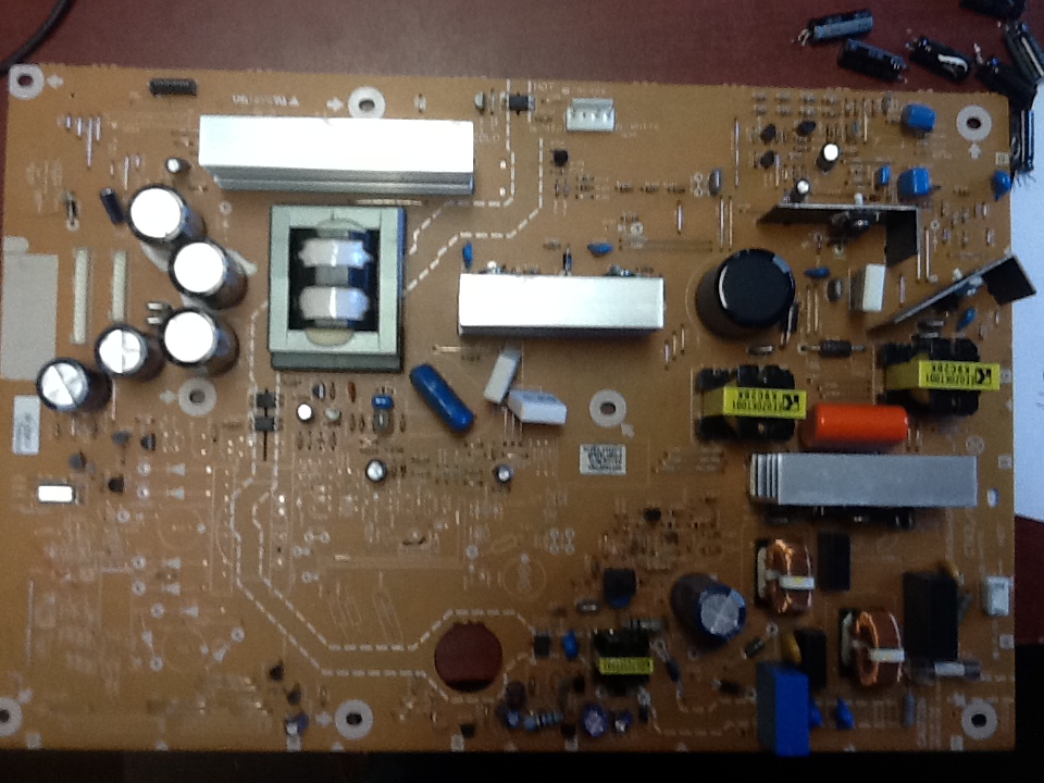

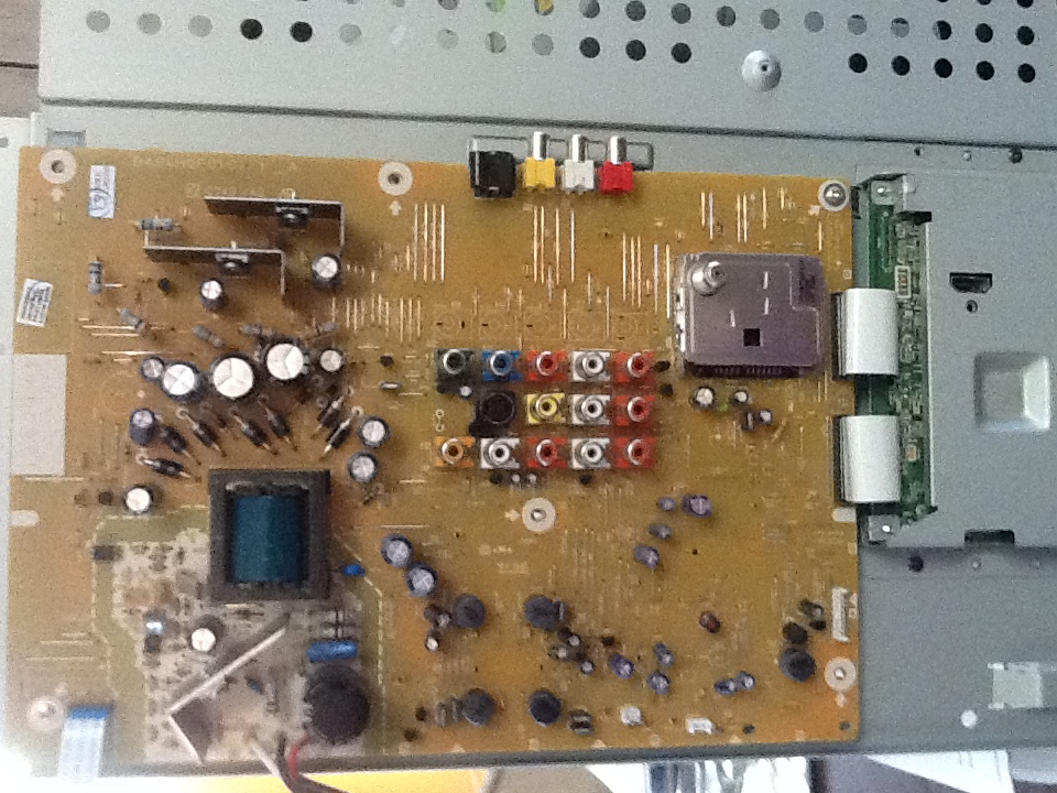

    Can you post pictures of the relevant boards, back and front.. A video of the fault might also be of use.
      Re: Phillips 42PFL3704D/F7 no video
      Yes, good pictures of all the boards. The inverter board is getting 24Vdc feeding it, but it will not turn on the backlights until it gets the BL_ON (or INV_ON, or ON/OFF) signal from the main board.
        I will take pictures and post. There is no video at all, using flashlight in dark room there is nothing on screen. I can turn on, i hear a click and white power light. Pics have been added to original post, Thank You

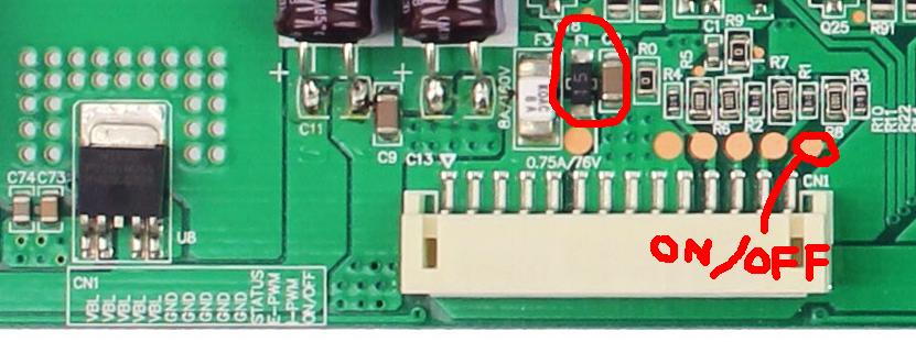

                        You need to check the fuse as circled, and the DC voltage on that ON/OFF (same as BL_ON, or INV_ON) pin.
                          Thanks Budm, I was only checking the 2 white fuses on inverter board. I completely overlooked the little black fuse, It was bad. No the million dollar question is does any body now the value off hand
                            It's written next to it. 0.75A/76V. As it operates on a 24V circuit any fuse rated more than about 24V will be fine.
                                The white fuse carries the main backlight current, 8A at 24V, the black fuse is for the low power control circuit.
                                  I used PICO II fuse 1A for my repair.
