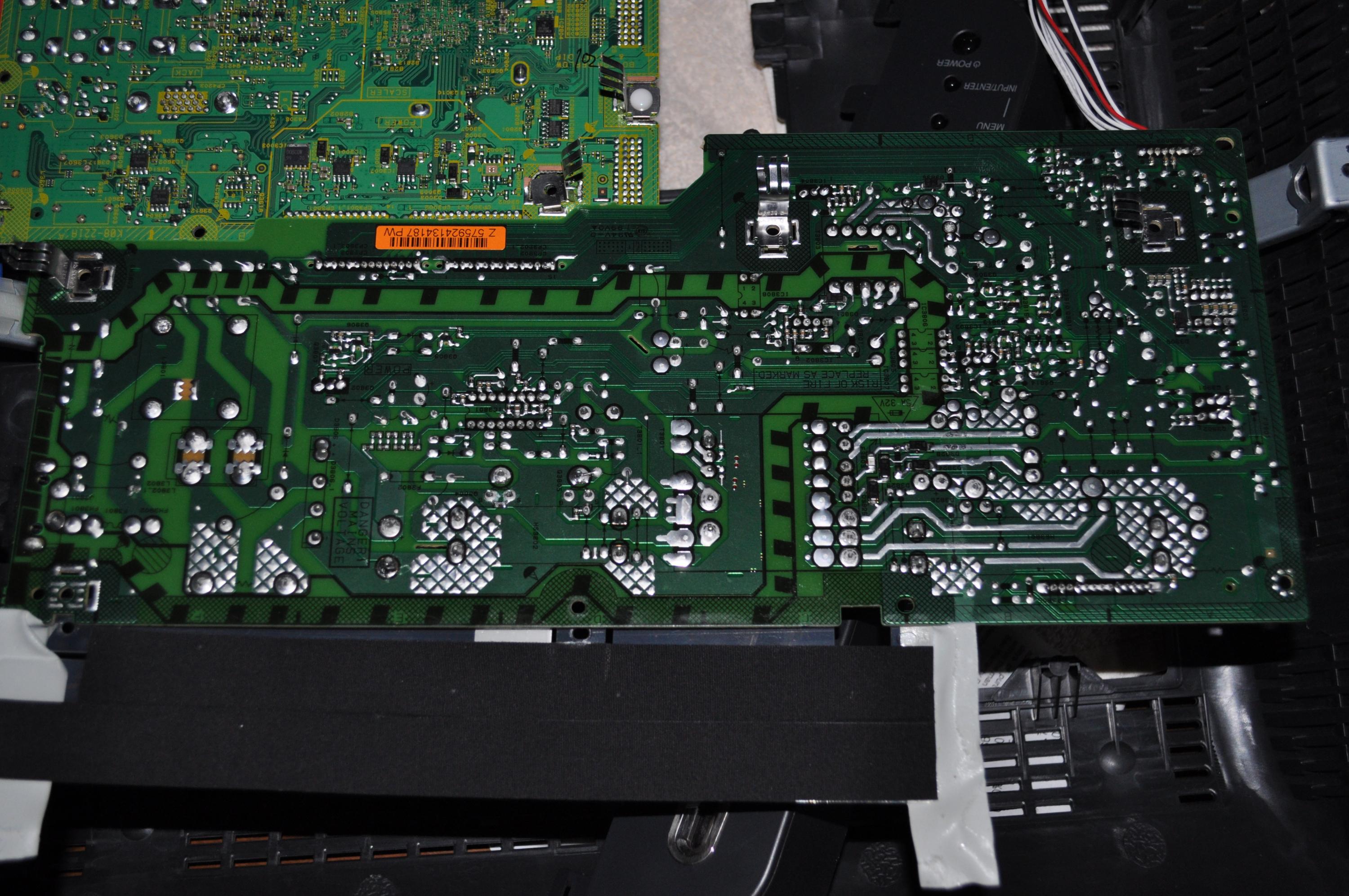

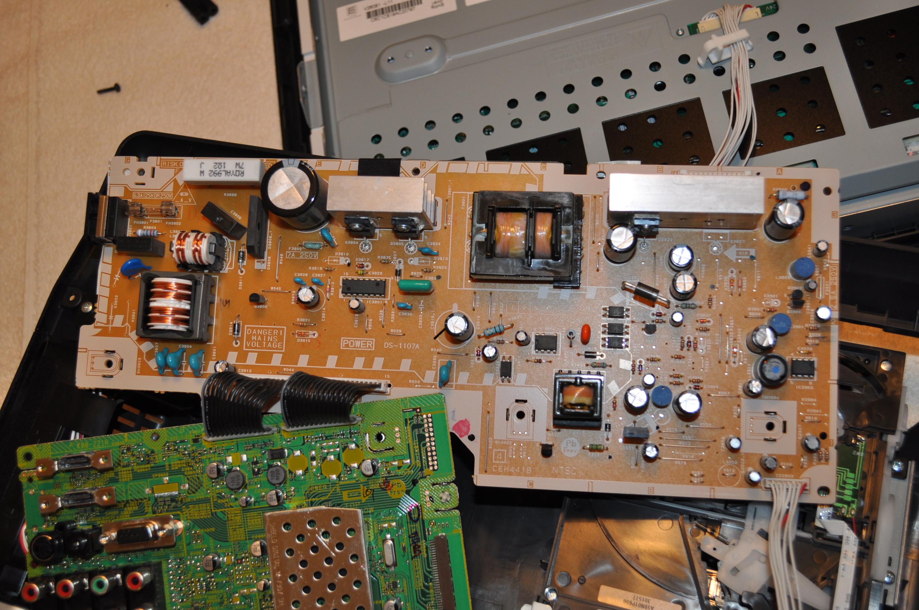

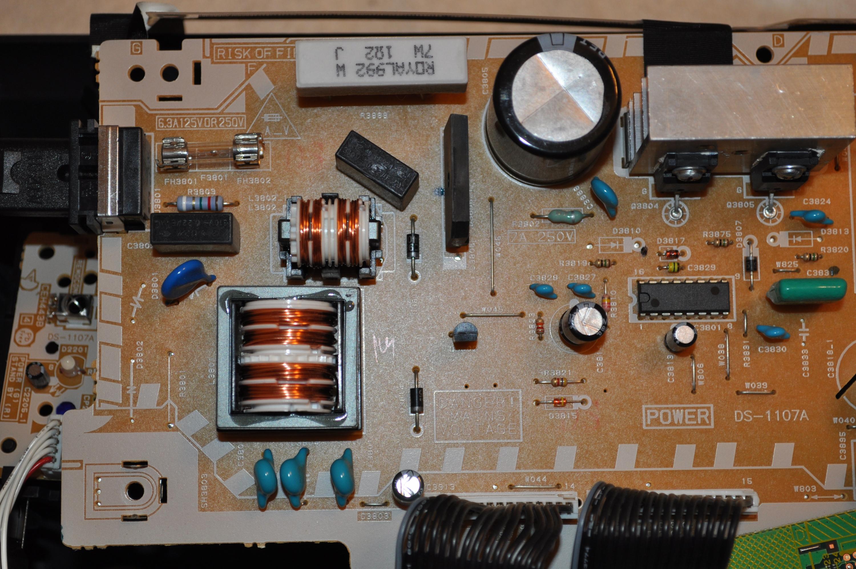

    I picked up a Toshiba 26LV61K that wont power on. It doesn't do anything. I checked the main fuse and it is good with the correct AC voltage but I can not find any DC voltage present anywhere on the board.
  • landyboy
    • Apr 2013
    • 443
    Re: Toshiba 26LV61K Wont power on
    Also checked Fuse 3802

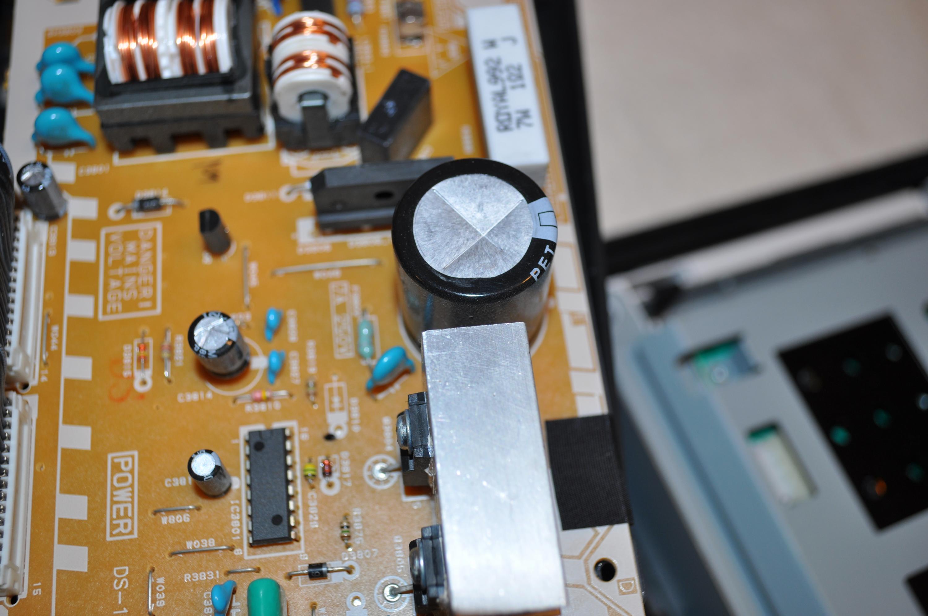

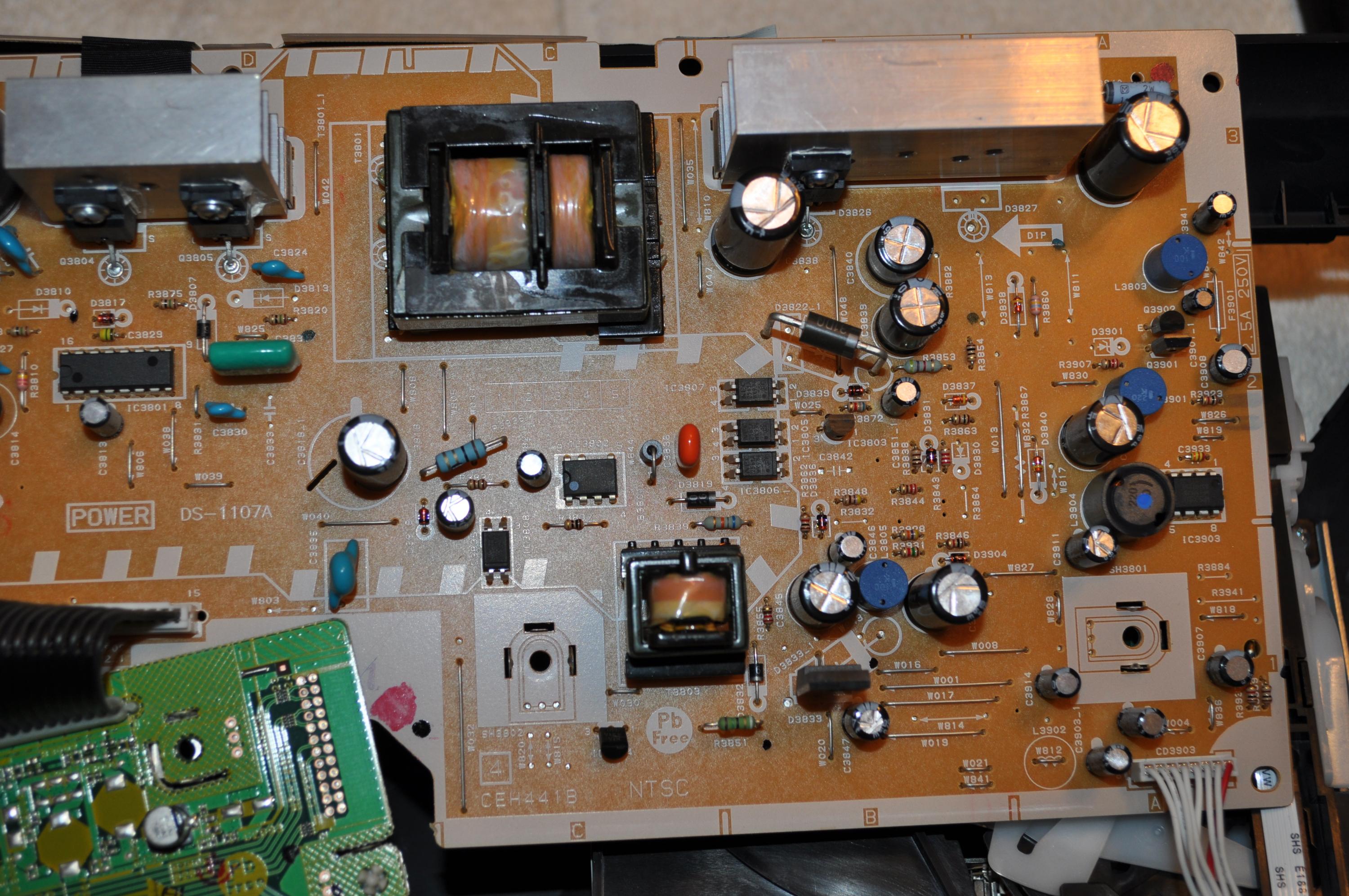

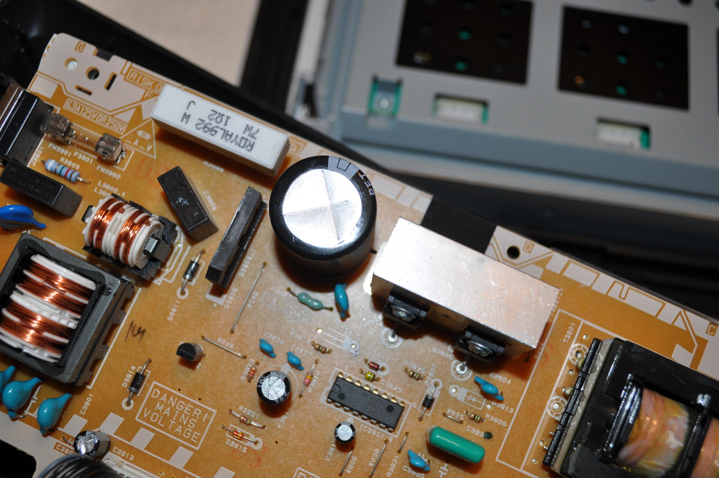

      Could just be an optical illusion, but that main filter capacitor (the big cap on the left side of the power board) looks awful strange... Can you take a closer picture of it..
      • landyboy
        • Apr 2013
        • 443
        Sure Here you go,
          Check that big white 1.2 Ohms resistor to see if it does show 1.2 Ohms or so.
          Do you get any voltage on the that big cap at all?

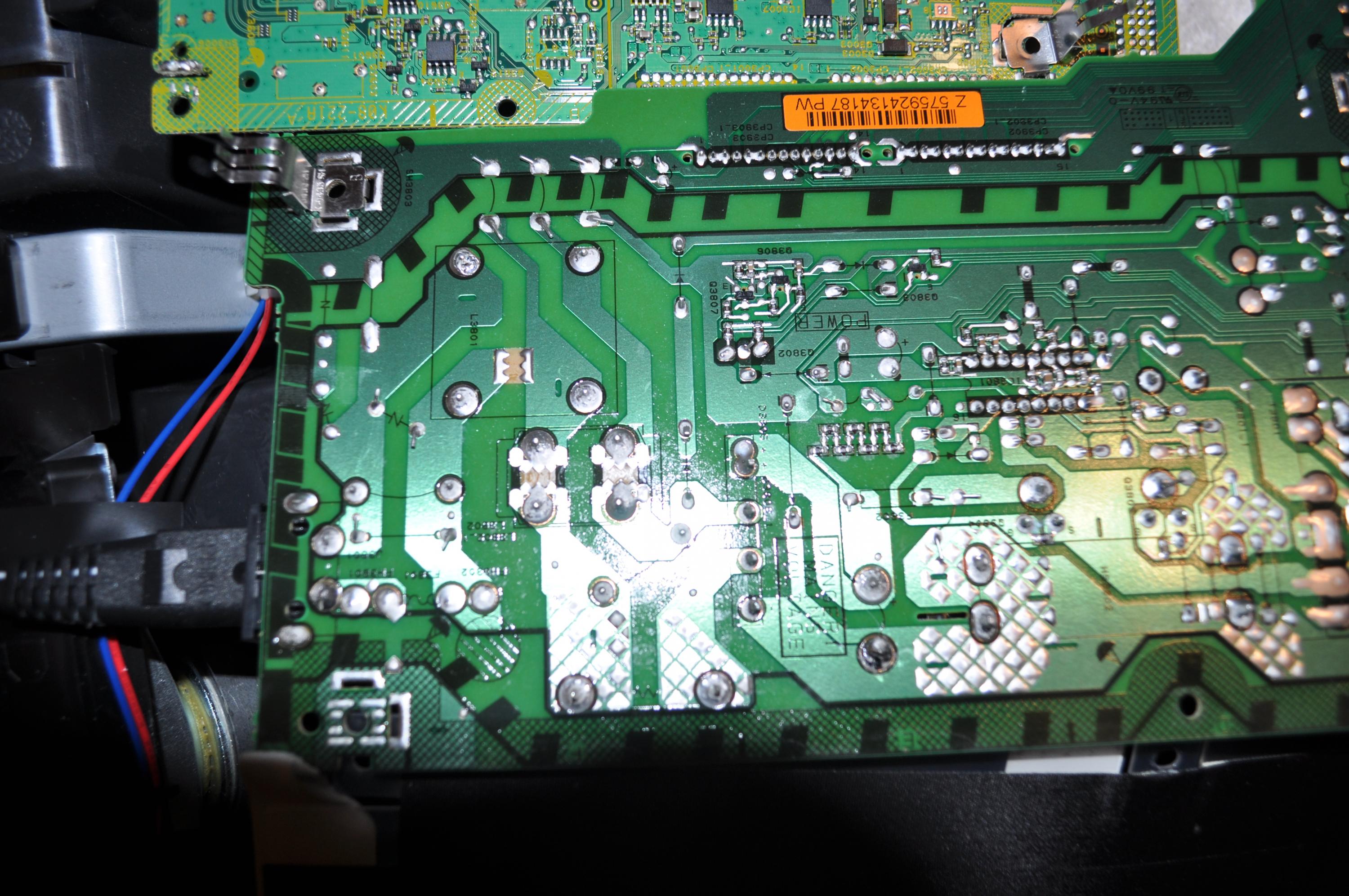

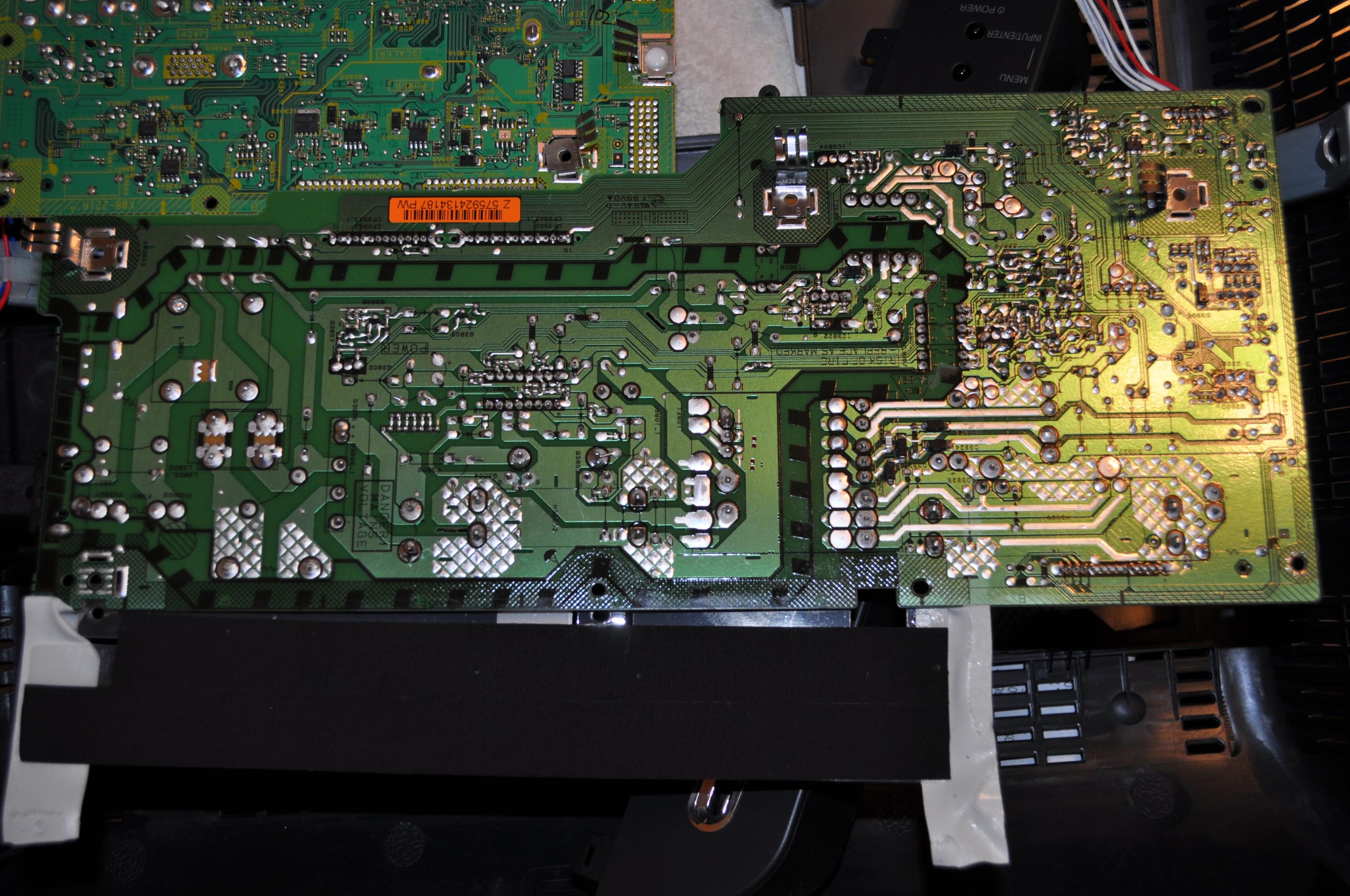

              OK, time for good clear pictures of the board both sides, and also in 1/4 sections (both sides) so I can trace out the connections.

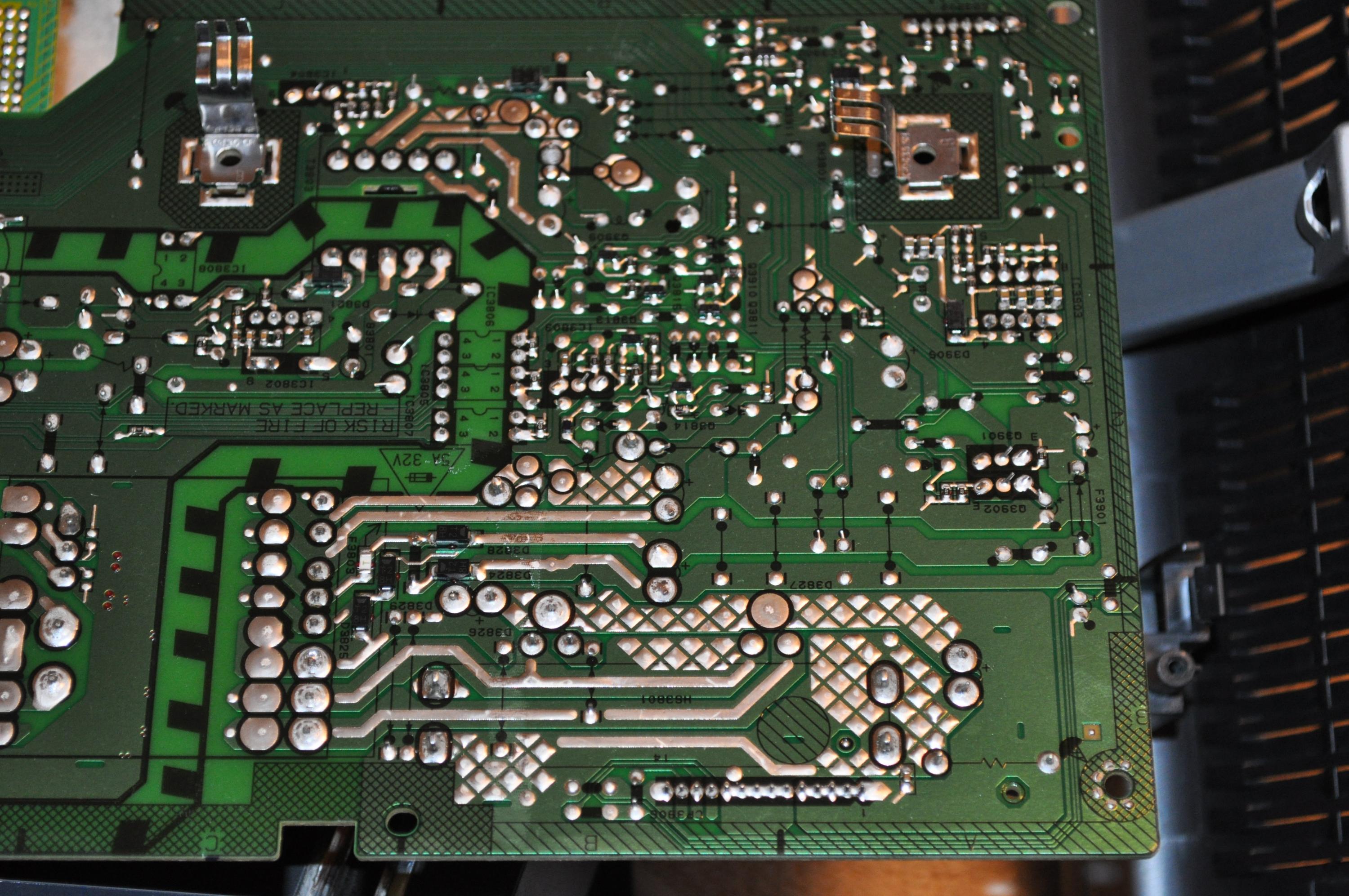

                  More Pics
                    OK, just to be sure, you are getting 0V on all connector with black wires, same on the connector with white wires?
                        I test 170vdc between these two points
                          OK, there is a 6-pin IC next to the small transformer, that is the standby power supply IC. Can you read the numbers as printed on it? We need to get the spec sheet so we can check the resistance and voltages on its pins.
                            MIP2K4 .998 IC3802 but it appears to be a 7 pin?
                              Sorry, you are correct, it is 7 pin for the creepage and clearance of the Source and Drain pin they had to remove one pin. That part number does not come up right.
                                  I'm not sure if this matters but there is no voltage on the source pins.

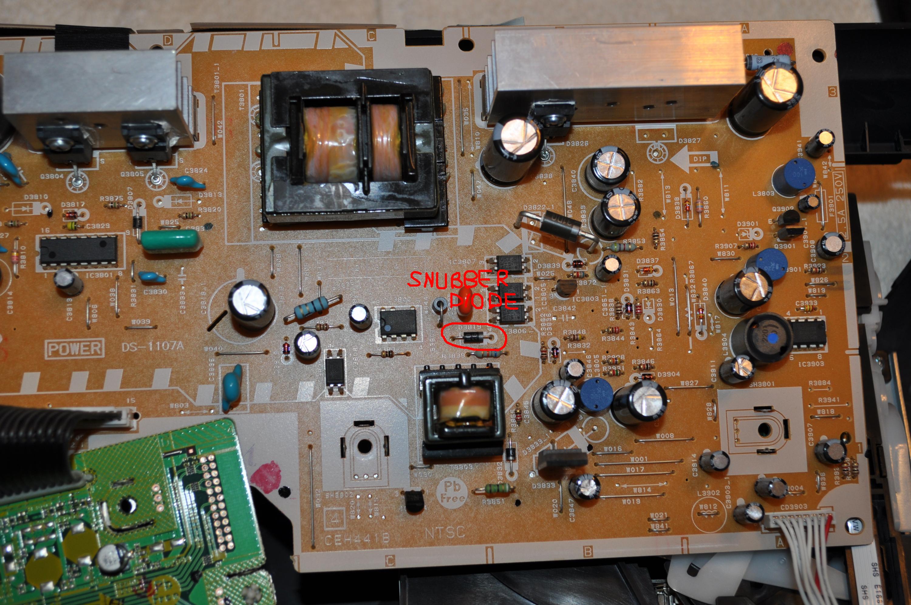

                                        First thing first, you need to get the standby power supply working first, as you can see in the spec sheet, check the Drain pin of the IC, it should have 160VDC on it since it is not switching, then check the Source pin of the IC which should be around 0V.
                                        The start up cap as mention also should be check or just replaced.
                                        I need better pictures of the bottom side around the area of this IC, straight shot, not at an angle.
                                        There is snubber Diode at the Drain circuit area that need to be checked. Then you need to report the resistance reading of all the pins of the IC against the Ground pin of the IC.
                                        By the way, since you are working in the Primary side (Hot side) of the circuits, the negative leg of that large filter cap is the ground ref point, also do not touch any part of the hot side with you hands or body.
