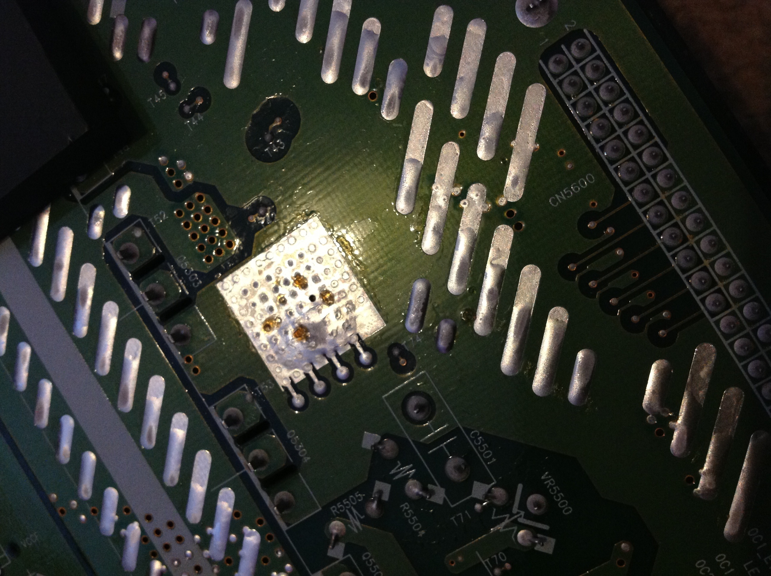

    I give it another go and what i think was a couple of fets popped and a capacitor got bulged.
    One of the fets on the new board looked a bit dodgy underneath like the same one on the original board so do you think the ysus i purchased was already knackered and blew the new buffers as well or am i looking at a dodgy panel?

    You are probably looking at a bad buffer board (from eBay) which has damaged your Y-main. This is one of the reasons I don't trust used buffers on eBay. They're mostly pulls from cracked screen TVs, but the act of cracking the screen can damage the buffer.
    That FET looks fine to me.
    Would be very strange if a bad buffer bloated a cap on the Y-main. Perhaps the Y-main you received was defective as well.

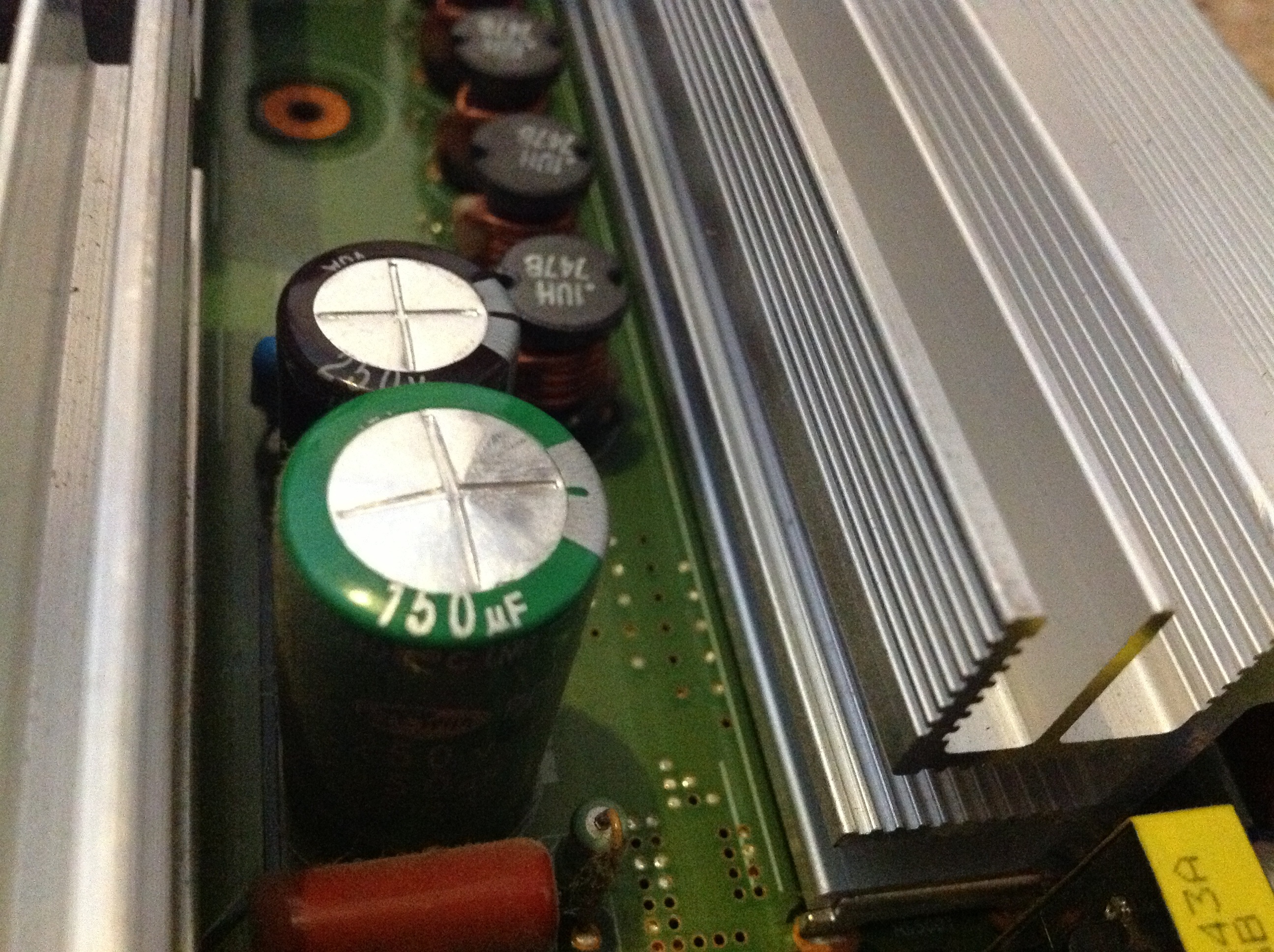

      Thanks for the reply so you wouldnt think its a bad panel then, is it possible the power supply is bad and caused the buffer to burn out then the ymain on both the new and original boards? The voltages were ok to all boards though. If i turn it on without the ymain attached it stays on standby. This is the cap that bloated.
        Re: Need some help with sammy plasma
        Wow yeah, if that cap's popped you've probably got a WAY too high Vs. More than 250V. Rating is around 200V for these panels. Your X-main may also be bad due to excessive Vs.

          Yep, looks like you're another victim. Not quite sure what you're trying show in the photo but the soldering looks factory orignal.
          I always check for shorts now on any secondhand buffer or ysus board I get regardless of where it comes from including the major sellers.

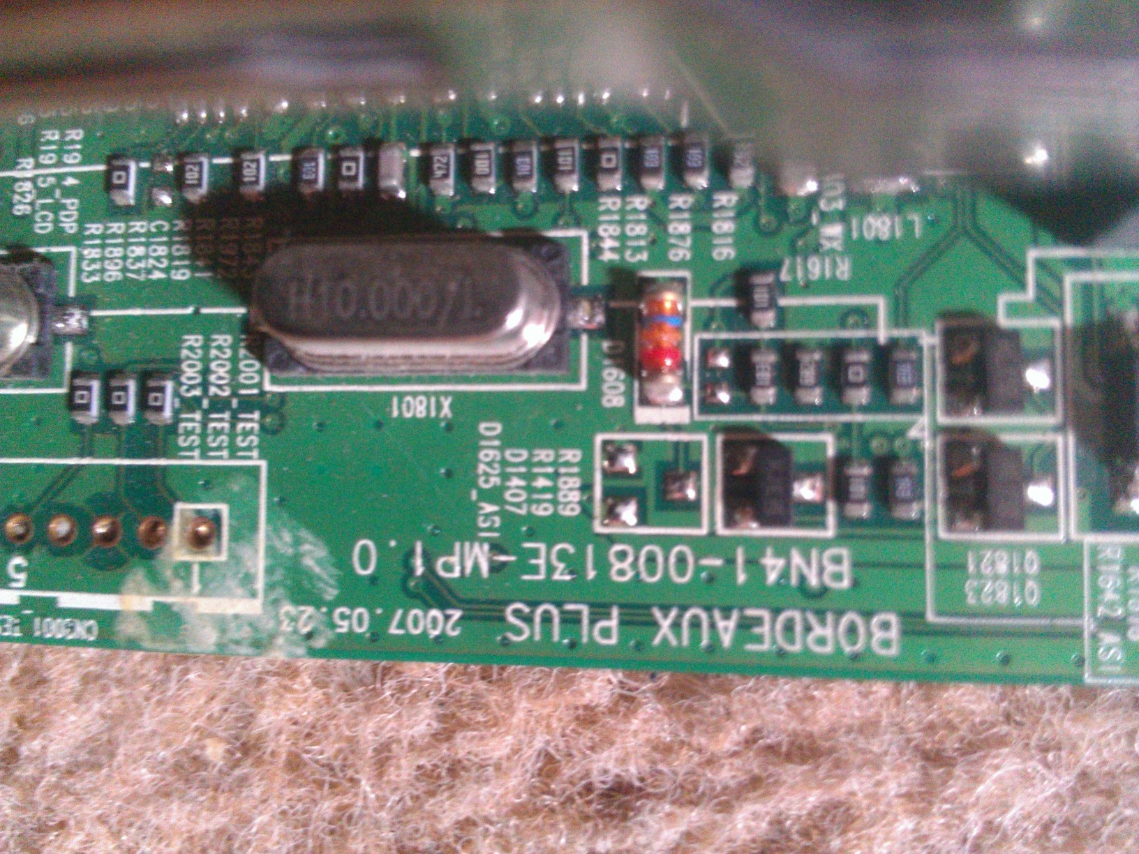

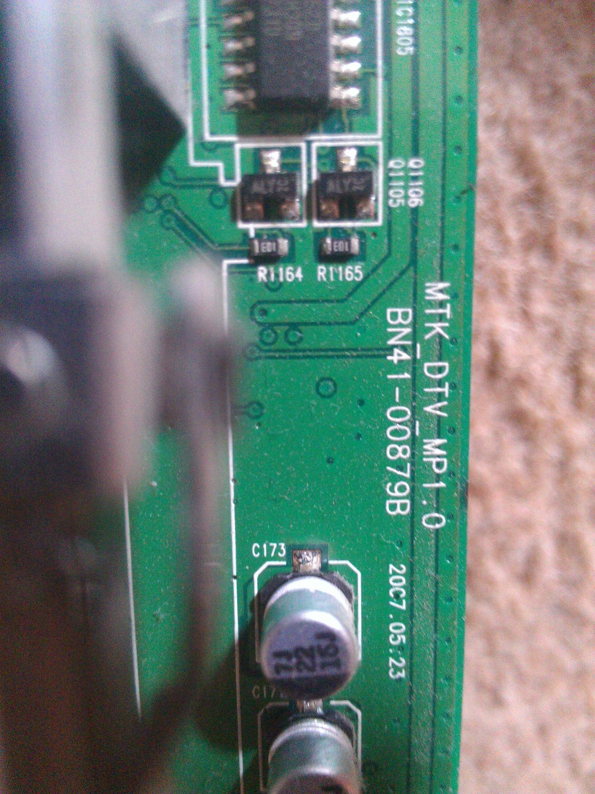

                                So i thought i might aswell change the av board and in doing so fired it up whacked the hdmi in and i got sound out of it, so im thinking the av board may of shorted the y-main or buffers previously is that possible? Also the av boards look different and have different numbers can anyone shed any light on why changing it gave me the sound back.

                                      Heres the other board
                                        Yeah did that but only uploaded one im on an ipad if that helps
