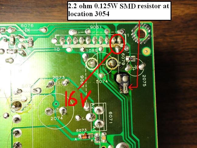

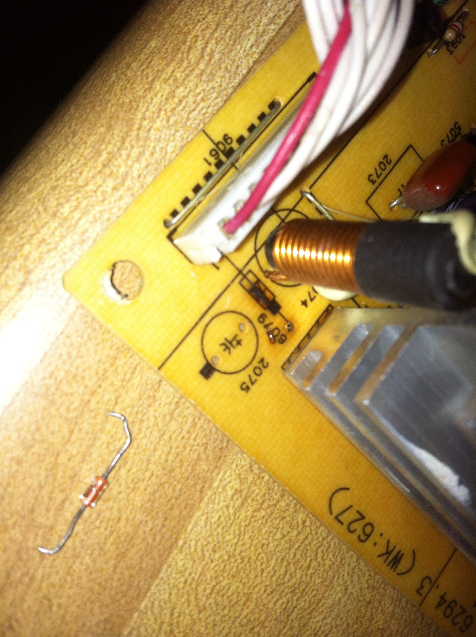

    I've gone through several threads regarding this model television. I replaced four capacitors (one of which was obviously bad) with no change in the problem. I pulled the diode referenced in the picture below. With my meter set on diode setting, I get ~160 (not sure of the units) on the meter regardless of which direction I test it. Does this indicate a bad diode?
    Re: Magnavox 37MF321D/37 No Power, No LED. Testing a diode.
    John, of all the people, you can upload a good picture right?
    I can't see where the diode is on that board... I doubt anyone else can.
    It might not even be a diode you removed?
    Almost always a diode conducting in both ways is bad, but it's quite rare for them to fail leaky like that, and not dead short (000 both ways.)

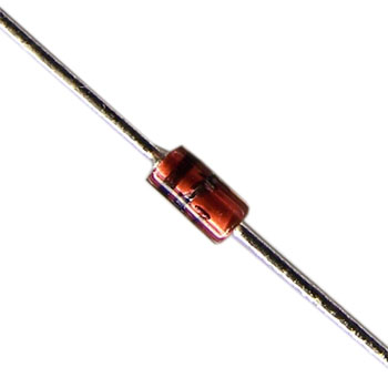

      I know, crappy picture. I ran home for lunch and forgot my camera/phone at work. I'll get good pictures when I get off in a couple hours. It is a diode, a zener diode. For now, it looks just like this. I'll look online for a good picture of that area of the board.

                Not all diodes that look like that are zeners, and Philips has an annoying habit of using four digit numbers instead of letter-number.

                        Bud, if you zoom in on connector 1089 in the upper left corner of the pic, you can see the anode lead of the diode between the label for pin1 and the connector name 1089. The diode is not in the schematic because the schematic is for the other PSU available for this set.
                        Here's a pic of my PSU.

                          It certainly looks burnt under the board there.
                            Yeah, the little blob of hardened burnt PCB right at the top of the 0 in 6079 caught my eye. It wasn't until I pulled the diode that I realized how burnt the board was.

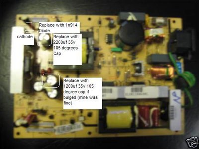

                              I swapped in a 1n914 diode from an electonics kit that i had from school per the first pic. It's working now.
                                You replaced a zener diode, which has a 9.1V breakdown voltage, with a 1N914, which has 75V breakdown voltage.
                                Obviously the circuit works fine, but you'll probably find that you've lost some over-voltage protection or regulation circuitry.

                                  That's kinda what I figured. I haven't buttoned it up. From the link in post #5, which one looks to be correct? Specifically, out of the two that can be ordered one at a time. I might as well order all of the small caps and replace them while I have the thing opened.

                                      Honestly, without looking, I believe it's a 16V line. I know the diode is only rated at 9.1V, but I don't think this power supply has a 5V line and the anode is connected directly to both of the 16V pins on connector 1089.

                                        I think it's the 18V diode for the 16V line. The 16V line might rise if 24V becomes unloaded (inverter failure) or if the backlight is dimmed to a low level. The supply is group regulated on 5V(?) and 24V only.
                                        i.e. 9.1V is wrong.
