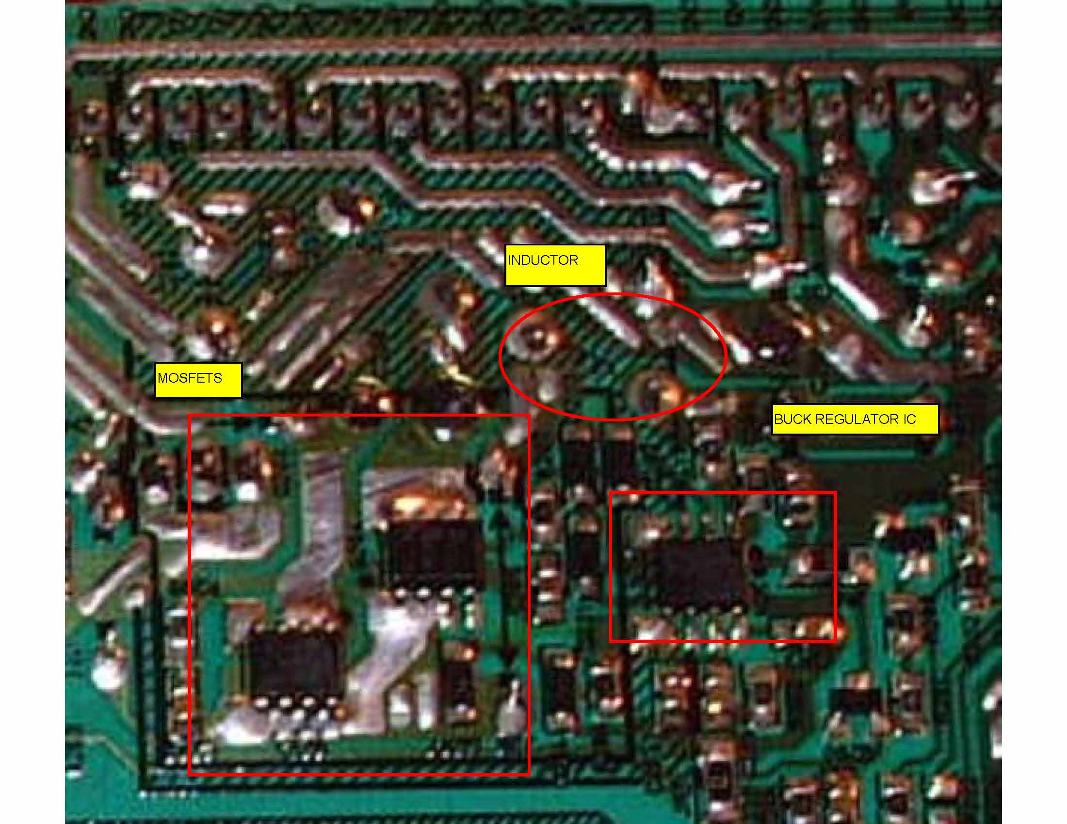

                  Sorry should of added my 3.4 line is down at 1.83v
                    Re: LG 37LC2D Major S/C Testing F9223L
                    If your 3.4V is low, you will get those problems.
                    The controller IC on 3.4V is failed or the capacitors around it are bad.
                      Cheers Tom
                      I have changed the two fets and regulator on the underide of the board but still the same.
                      Any other pointers
                        Did you change the ones for the 6V or 3.4V?
                        • signup
                          • May 2013
                          • 189
                          3.4 as shown in budm diagram on the other post..I will just go an check the 6v line now
                          • signup
                            • May 2013
                            • 189
                            I am getting 6.1v
                              Check what 3.4V rises to when you disconnect the main board connector -without- the POWER ON signals (PSON, BLON etc.)
                              • signup
                                • May 2013
                                • 189

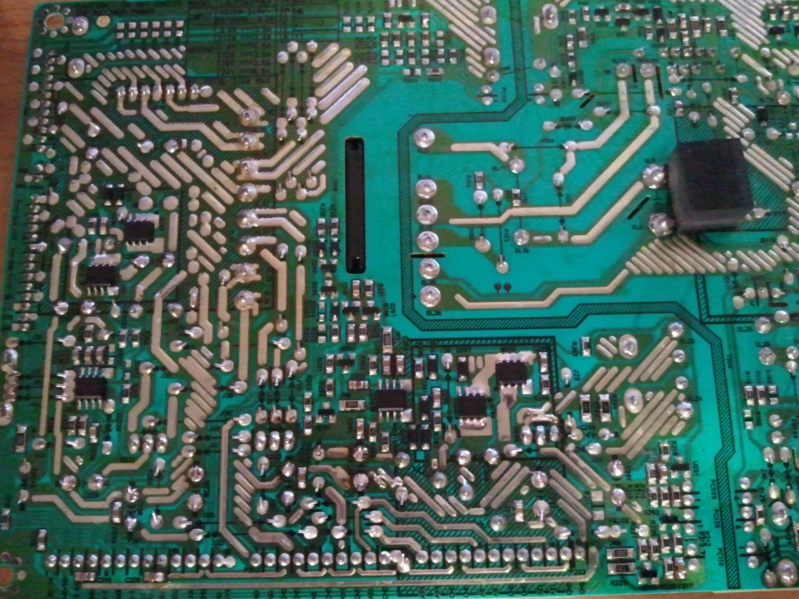

                                I have just been looking throough the other thread regarding this tv and there is a little contradiction Budm shows a picture of 3.4 buck and fets but then later in the post you say this is the 6v line and the 3.4 volts is to the left of the board...bit confussed now
                                Is the 3.4 v line by the inverter plugs or is that the 6v line...I think I have replaced all the 6v fets and ic
                                • signup
                                  • May 2013
                                  • 189
                                  Budm Put
                                  https://www.badcaps.net/forum/showth...t=18218&page=5 post number 81
                                  You put
                                  https://www.badcaps.net/forum/showth...t=18218&page=6 Post 103
                                    You can trace it through the inductor and capacitors and find the 3.4V one. I no longer have this TV or board in my possession.
                                    • signup
                                      • May 2013
                                      • 189
                                      I have uploaded the two pics, on your pic you say the 3.4 is to the left but budm says his pic is the 3.4v ic and fets which is the one on the right of your pic...confused...I am too.
                                        In the middle/right of the first pic.
                                        Budm's left is different to your left?
