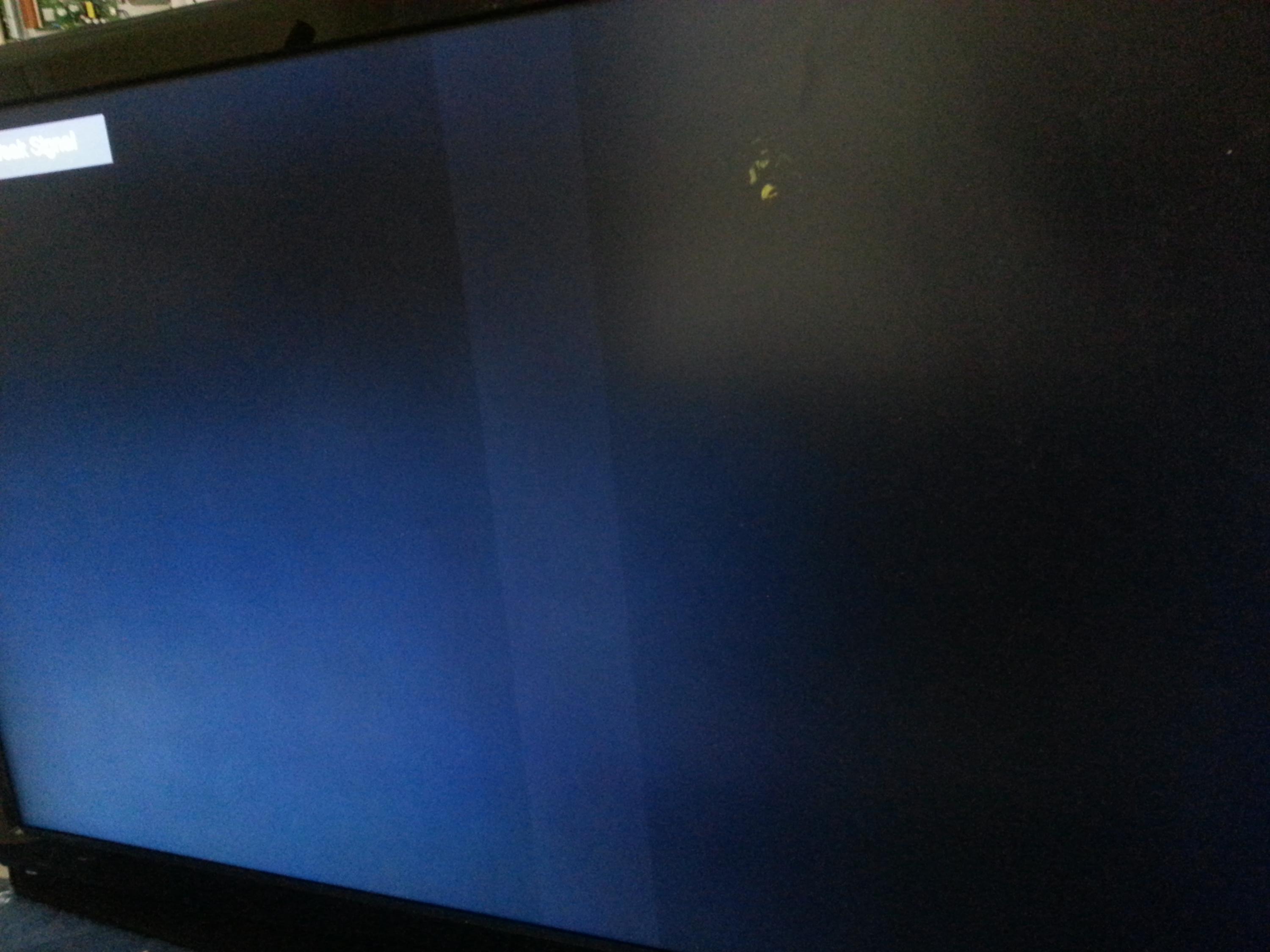

    Jvc lt-47em59
    Hello everyone. I'm a rookie tech so all the help will be very appreciated.
    I have a JVC LT-47EM59 that has like a 3-inch wide dimmed vertical line in the center of the screen. And sometimes half of the screen shows picture and then only half shows. I have attached a picture.
