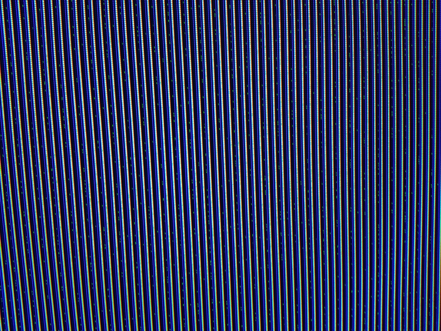

    I'm back now with another one, I've looked into it as much as I can and I'm guessing its a t-con board problem. But before I order a new one, I wanted to get your thoughts on these photos.

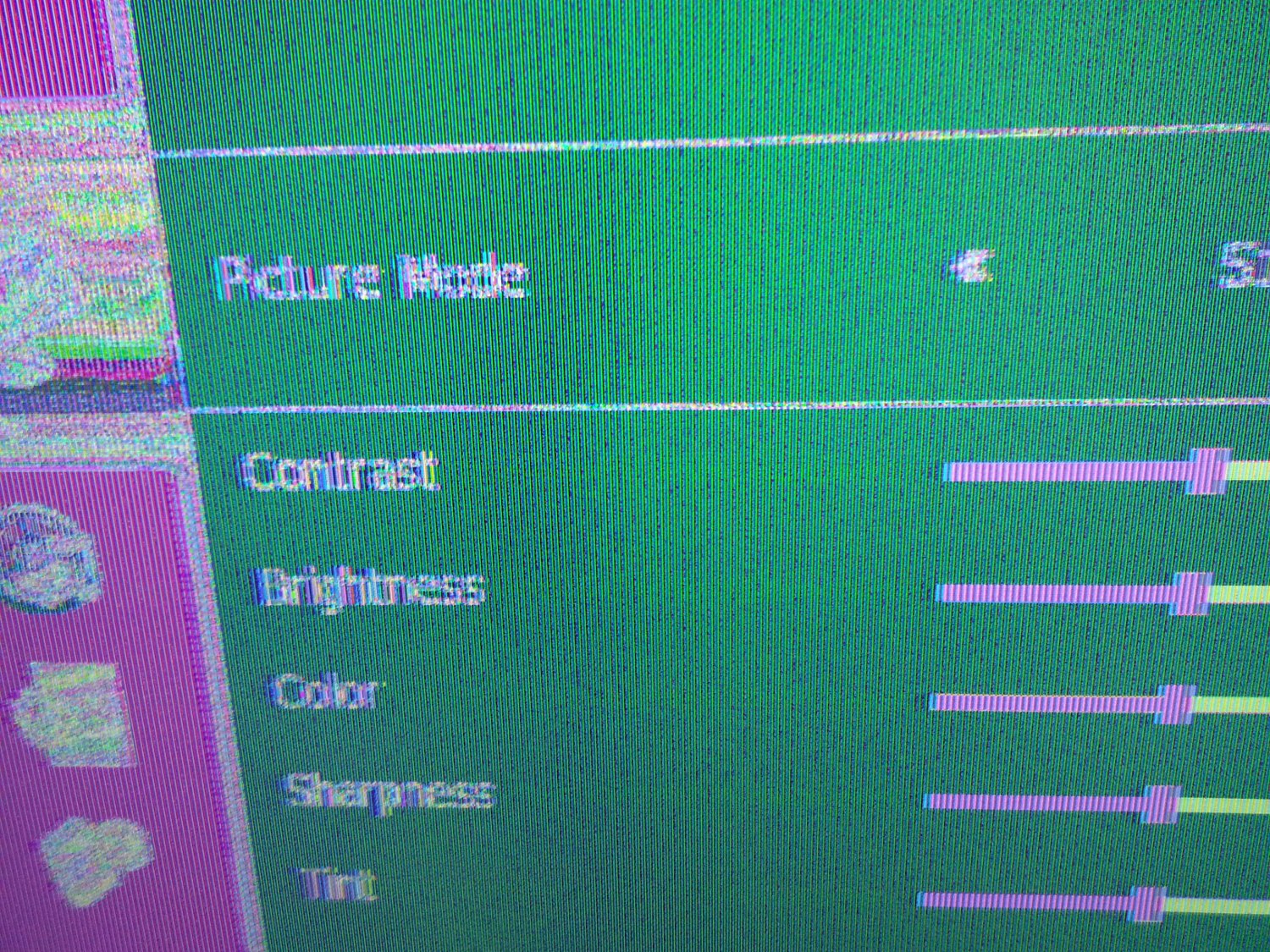

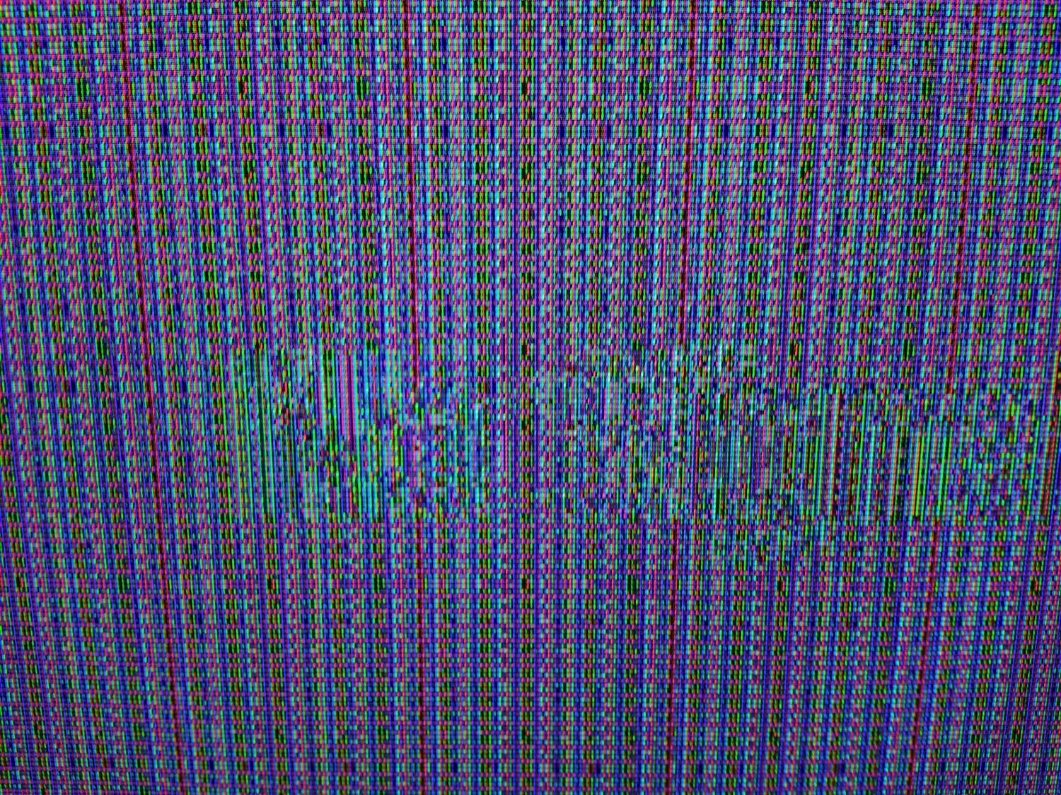

    On black screen we see vertical lines evenly spaced across whole screen. with a few other green pixels. Another photo has what the "No signal" message looks like, and on the final photo we see the menu with all funky colors.

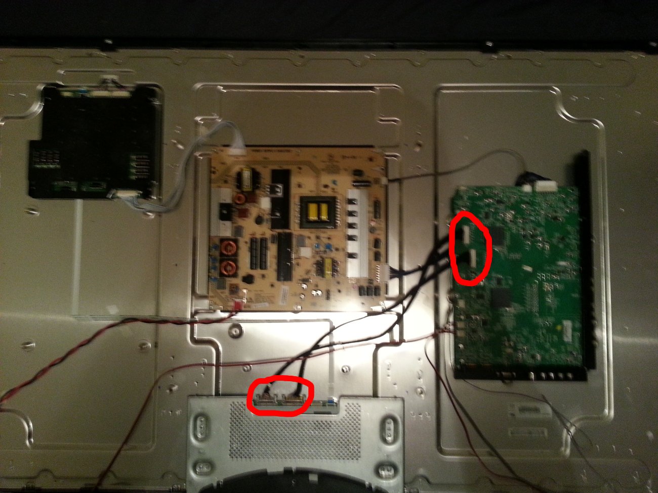

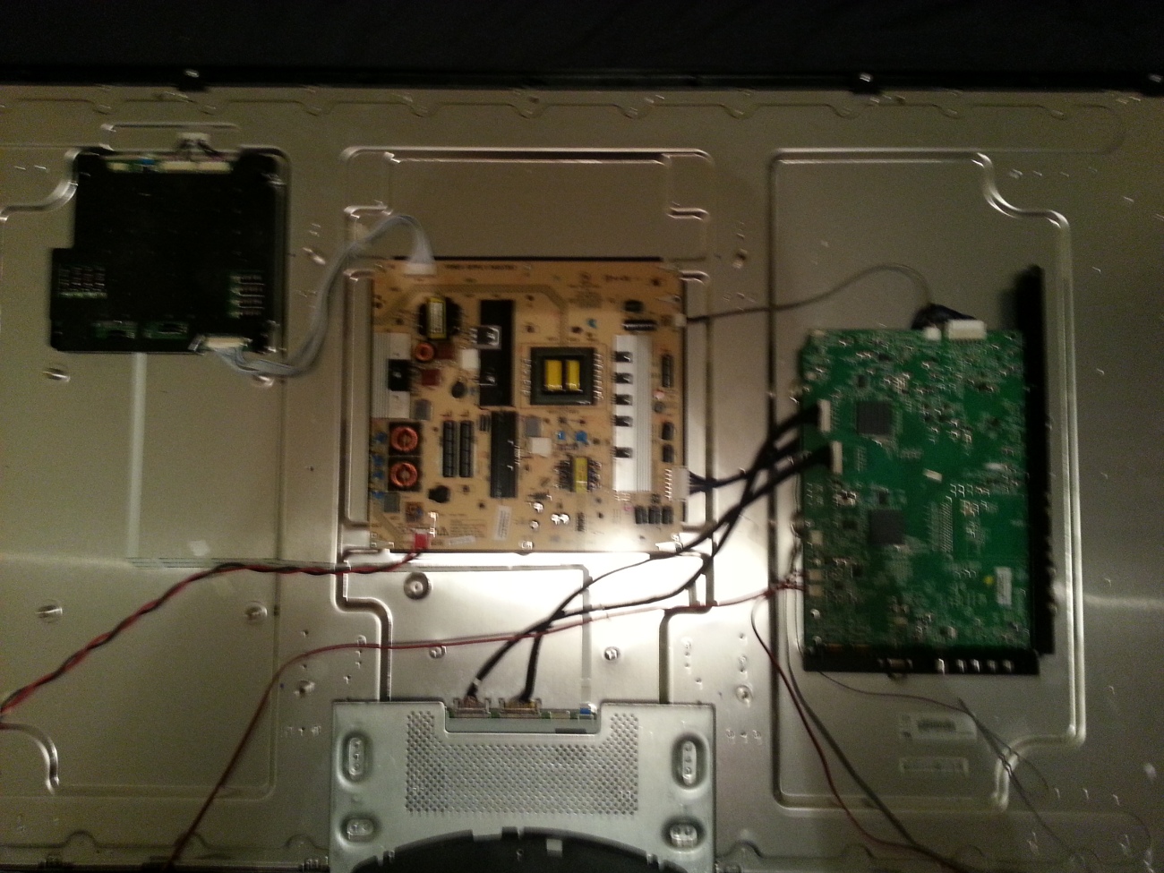

        Can we see some pictures of the chassis layout?
          Re: Kogan KALED553D1A vertical lines and pixelation
          yeah sorry for the late reply, its not the greatest photo. :/ thanks man

            ok, I've jiggled LVDS1 and LVDS2 while tv was on, seems to change the picture but never fix it.
              Have you removed and plugged back in all of these connectors?
                yeah i did, nothing.
                  When you fiddle with those the lines change and go away briefly?
                    they changed color and what not but never left. they do go away when i go to menu but the picture is still scrambled as per screenshots.
                      Tough one. I'm thinking the cables are defective since you really should see no change when wiggling them -- assuming the cables stay seated. Either that, or the main board is defective. It's hard for me to be conclusive -- sorry...
