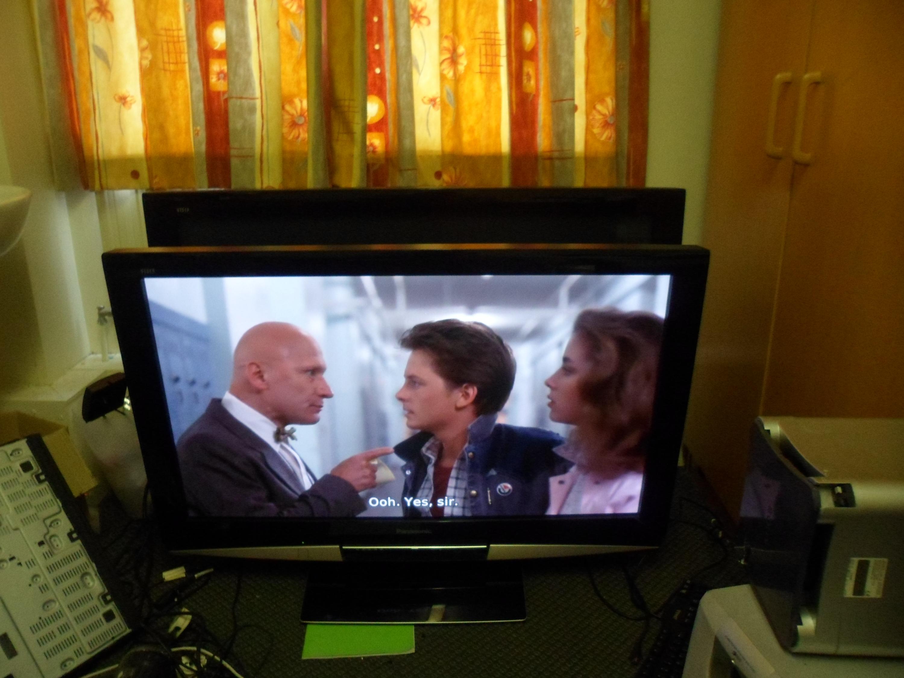

    Just picked this one up on eBay. Was mis-listed as 37" plasma (going to be 720p), so I thought it wouldn't be worth it -- but upon getting the model number I found it to be a 42" 1080p. £50 plus fuel, not bad (to Manchester from Leeds and back.)
    It has no power at all, no standby LED.
    Same as my 46" TH-46PZ80B (except a little smaller.)
    Check the 5V standby from PSU: missing.
    So checked the output from standby transformer: that's OK, 5.1V.
    Traced the diagrams and found that the 5V standby is only switched on if no faults are detected. Tried jumping it and got 5V standby but it didn't proceed further (no clicks -- but didn't check power LED, silly of me I guess.) One detected fault is AC_DET, which measures 0.11V, on the MC552 module. I think it should be high (~5V.) However, Panasonic have not provided schematics for MC552 (only for the power supply as a whole), and do not indicate what AC_DET should measure.
    Has anyone encountered this issue? Anyone who has a TV with a working EXT2MM702MF power supply who can measure AC_DET? It's on pin 16 of MC552.
    I'm on the verge of tearing apart my 46" to measure AC_DET :P. I'm going to try and avoid that, for now.
    When I get this working I face the hard decision: Do I put the 46" in the lounge and 42" in the basement, or the other way around?

          So, I was working on the PSU today, and I had MC552 out for testing. Decided to check the optos on it with the help of a friend, and they appeared OK (got 0.2V diode drop across output when LED driven with second meter, OL when not.) So, I decided to do some tests, reinstalled MC552, and plugged it in.
          Click-Click. Red power LED... Uh, OK. This didn't happen before.
          So, cautiously, I hold the CH- down, to turn the TV on. The heatsinks aren't screwed in, so the transistors could overheat. But it powers up, and shows "NO SIGNAL". Wow, umm, that... that's good, I guess.
          Take the PSU out and install about 50 million screws... Power it up and run test patterns. Panel looks great, no burn in or stuck lines. And I've been using it since... it hasn't skipped a beat.
          My guess is, MC552 had a cold joint on the connection going to the P board, and the removal of the board and reinstallation (new solder applied) has helped it. However, I'm probably going to put this in the kitchen for the other guys to play with for a couple of days, to see if it lasts. If it does... well, that's not bad for £50 + £15 fuel!
          Too small for the living room though when put against the 46"!
          And to anyone who said you can have too many plasmas... you were right. It's hard to move in this place any more. Luckily, we move in soon, so I'll have some more space.
