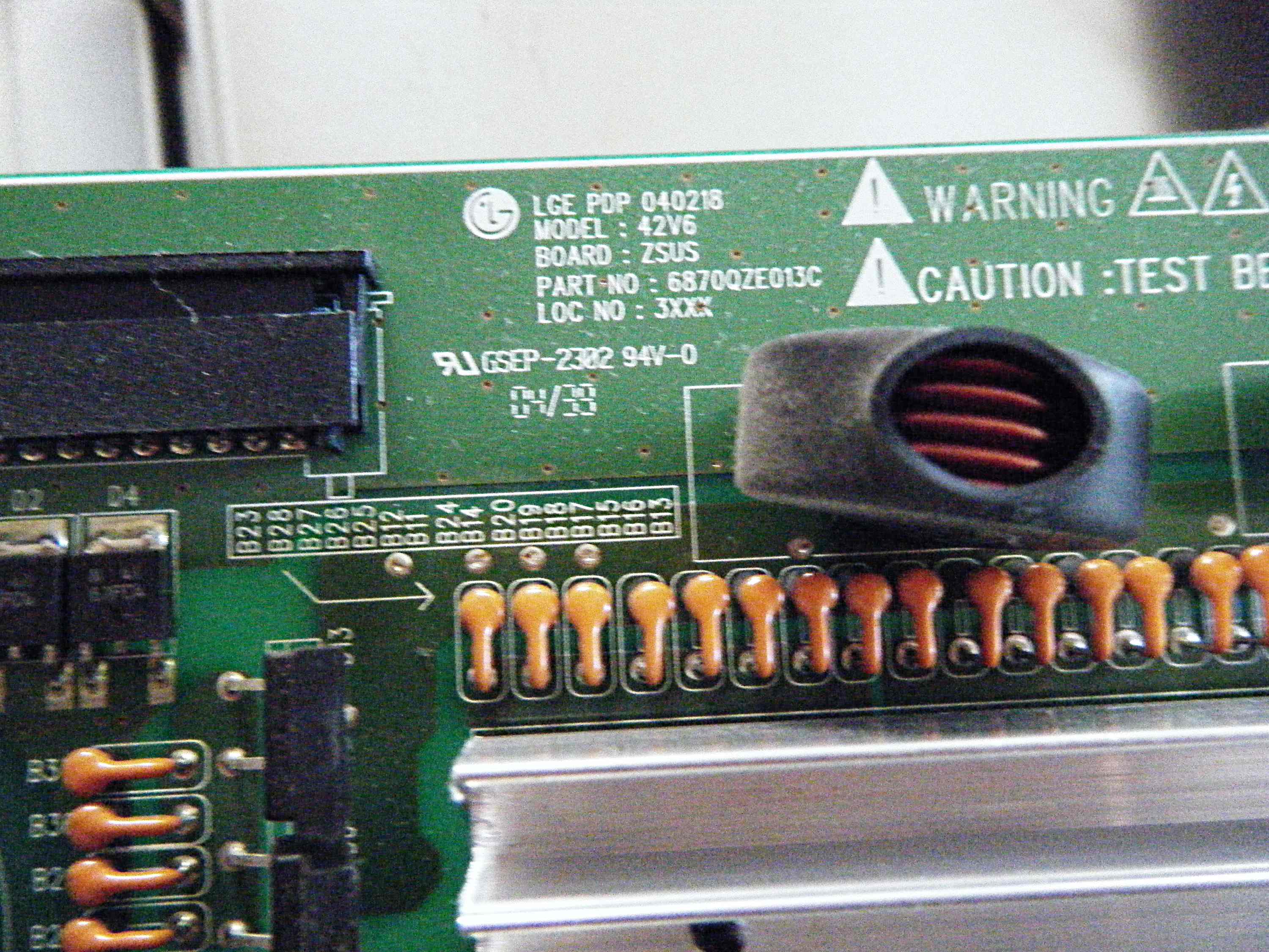

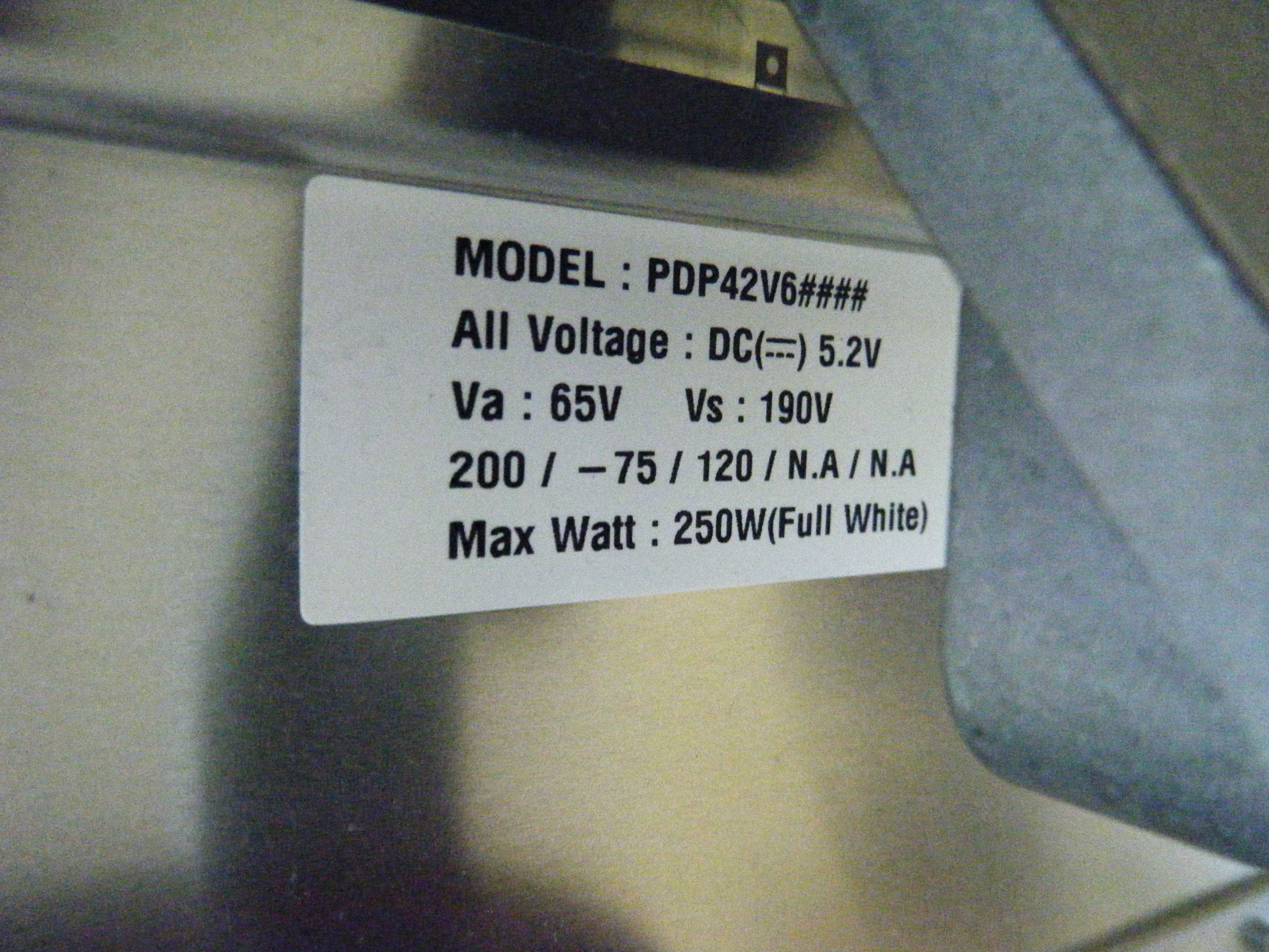

    Just got a trash-picked tv to repair. As the title says, it's an LG RU-42PX10C plasma TV. Date of manufacture is november 2004.
    Plugged it in and I got no signs of life from the set. (had a sign on it saying "broken")
    The ZSUS board model is 42V6.

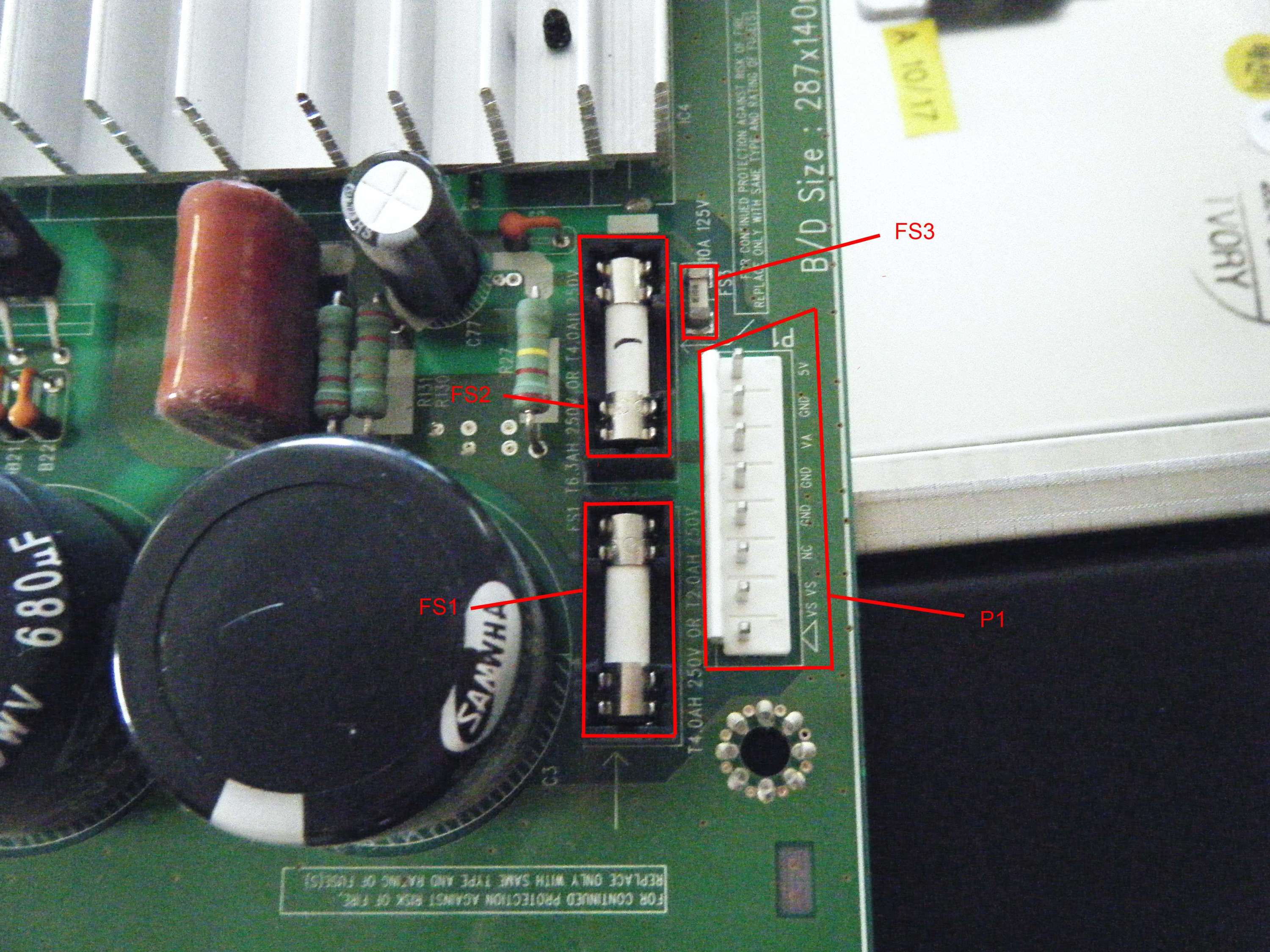

    FS1 (T4.0AH 250v) is bad. There is also a short from the 5v pin on P1 to ground - I am assuming that is why the TV didn't show signs of life. The 5v pin on P1 is connected to FS3 (10A 125v), however it isn't blown.
    Is there a possibility that something else in the tv has gone pop? I unplugged the ZSUS board and turned the TV on, and it came on - power supply clicked, but I couldn't see the power indicator light since the tv is resting on its front side.

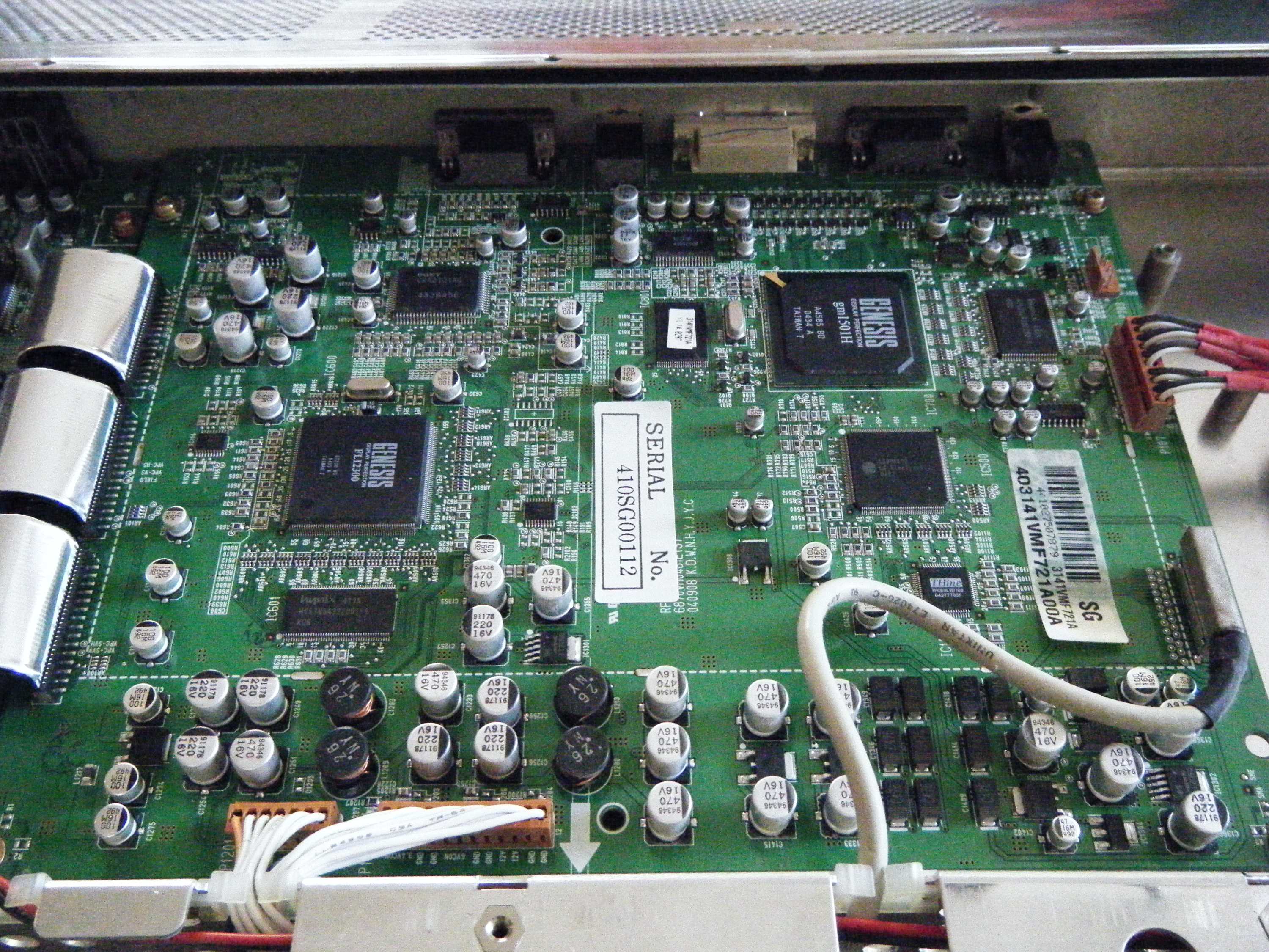

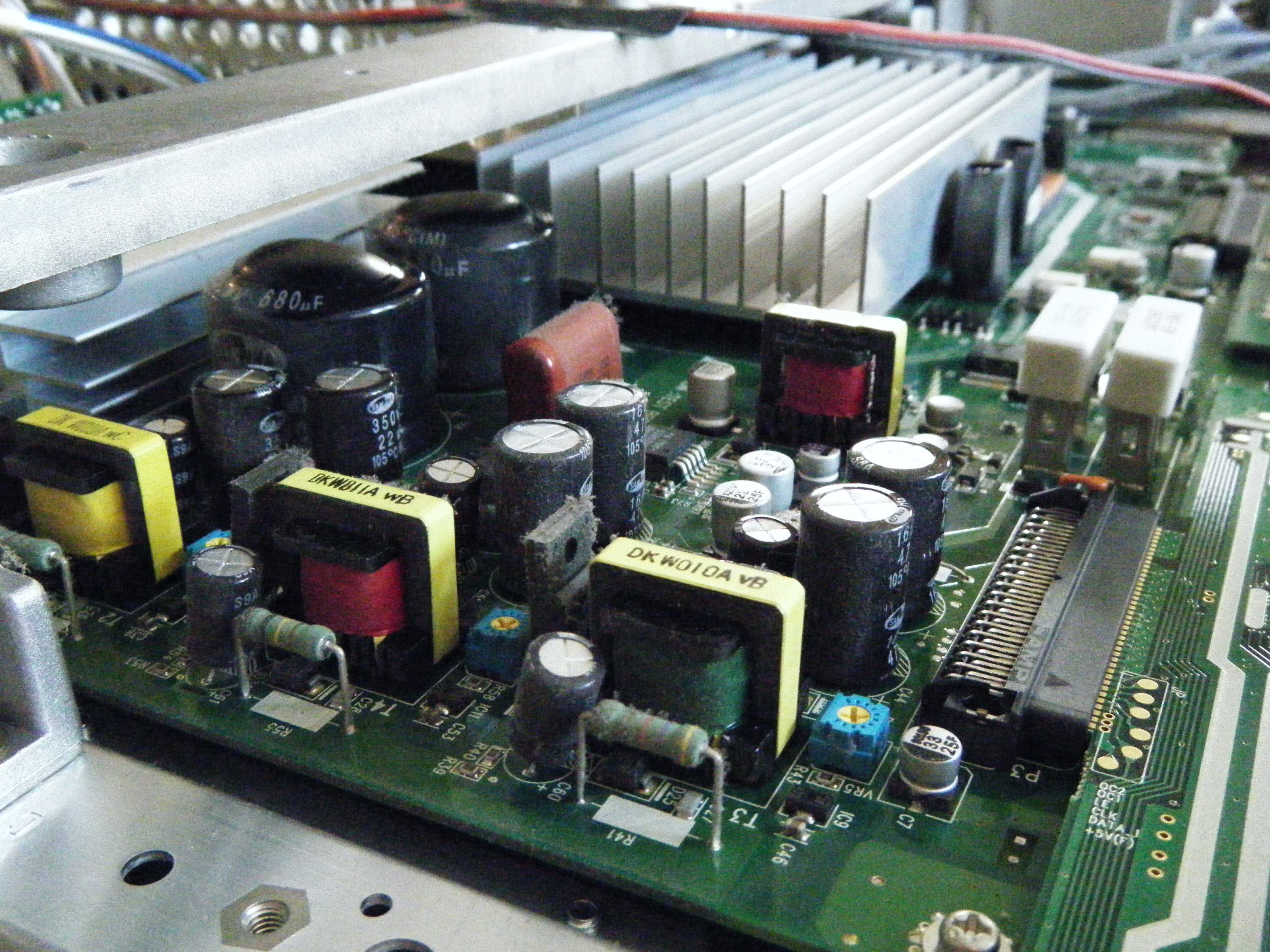

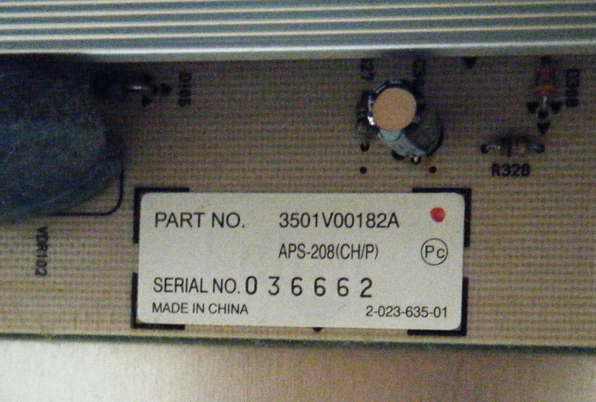

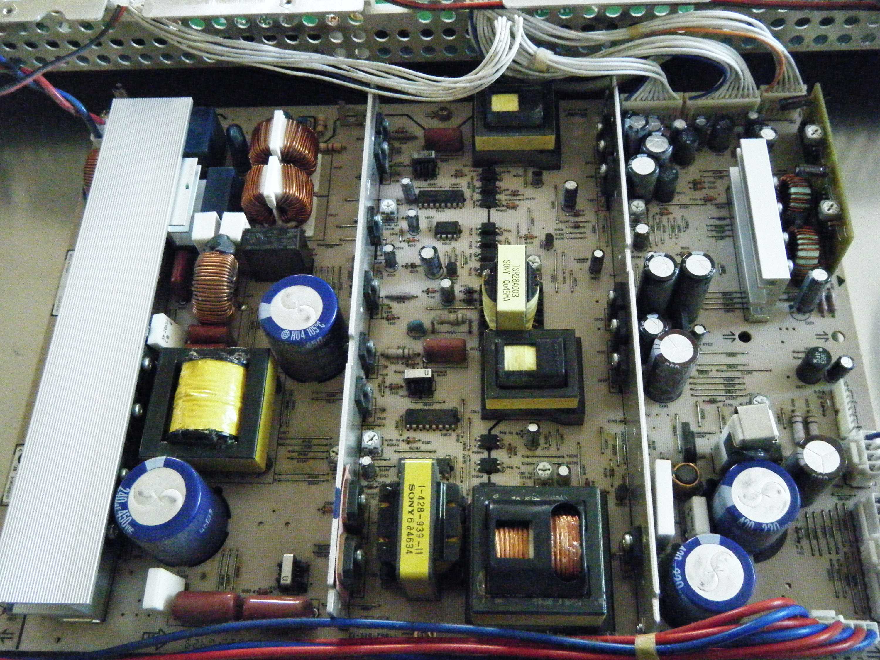

    Here are some pictures.
    The two capacitors on the YSUS look bulged but it seems that it is just the plastic disc which has warped...
    Oh, and FS1 is 2A fuse, not 4A
    Muh-soggy-knee
      Re: LG RU-42PX10C -- Bad ZSUS board
      Replace the fuse... common failure on these boards. Often the IPM is OK. Don't expect much from these. Just 480p really old plasmas.
      I'd be surprised if there is a 5V short. There is a lot of capacitance on that rail (like 15,000uF from memory) so it could just be taking a long time to charge up.

        I measured it with the board out of the tv...

          I don't think the IPMs use 5V, so look for the logic buffers, MLCC ceramics. Of course I could be wrong, if these are older IPMs, they may use 5V and that may be short. Normally they use 15V for FET drive. Could be using both.

            The pins of the IPM are marked, underneath the board. There is one that is marked 5v lol. Didn't measure to see if that pin is connected to the 5v pin yet, I will do it tomorrow.

              Update.
              So I replaced the fuse FS1 with a 2 amp fuse. Powered on, and it didn't blow ... Vs and Va don't come up.

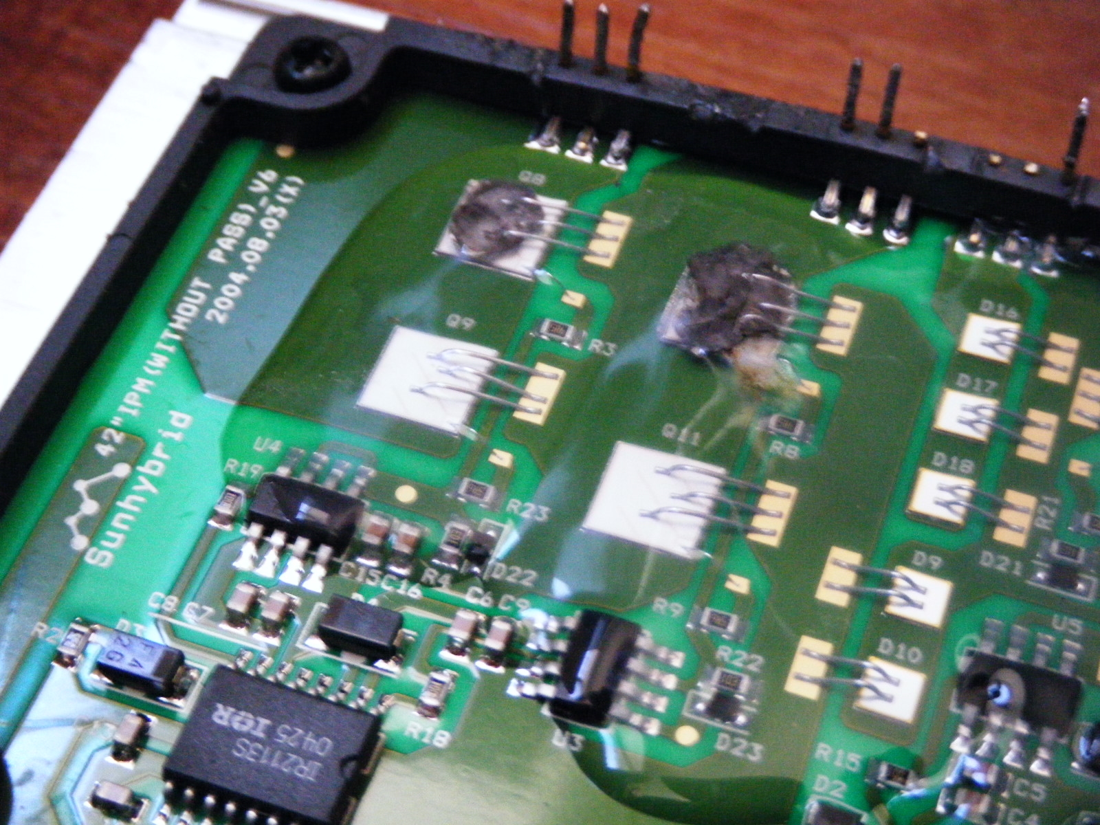

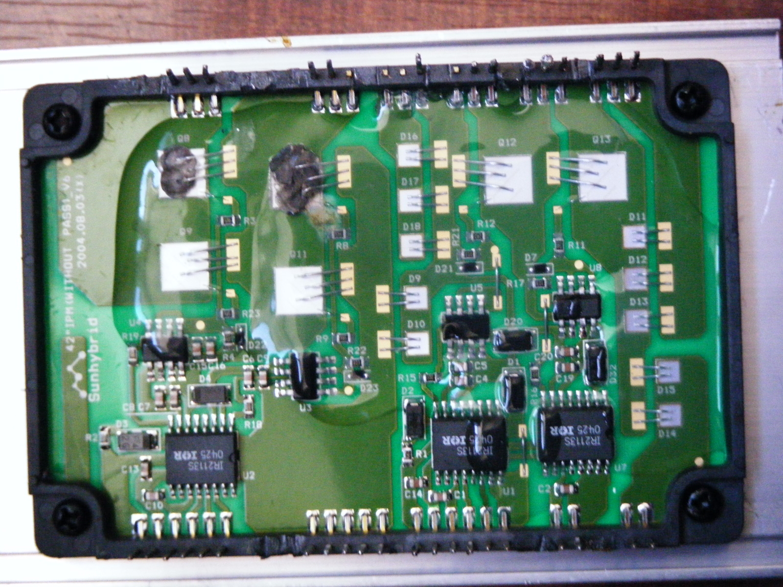

                        Anyways, I desoldered one side of the IPM and saw that it was indeed toasted. I basically used more force to get the other side off, but I don't care if it is not worth fixing.
                        Pics:
                        Overview:
                        Closeup of fried transistors:
                        I can't understand why they wouldn't use current balancing resistors for the transistors, that is likely why they failed. One probably conducted too much current, shorted, and popped the other one, and the fuse too.
