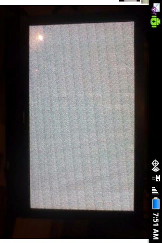

    samsung 50" snowy picture with lines
    Thinking about buying this one , anybody ever seen this. powers on normal but has this picture
    Re: samsung 50" snowy picture with lines
    50" is a PDP. Plasma. So probably this is a main board fault, or a control board fault. Could be an easy fix, if the parts are cheap; it'll be unlikely you can do a component level repair on this.
      Can i be assured this is not panel, already lost out on one samsung lcd, would u buy this to repair to keep.
        99% this is not a panel defect. However, do inspect the panel carefully for permanently stuck or dark lines. They are common on some Samsung models.
        I would not keep a Samsung plasma for myself, they are too unreliable. I would only keep a Panasonic... I've got a 46" one in my bedroom right now... or a newer higher-end LG plasma.
          They say this is a samsung hp-85033, i cant find any info is this
          an old plasma or what.
            If it is a 50", it should be at least 720p.
              perhaps HPS5033, the outer frame profile looks close but the bottom, impossible for me to make out
