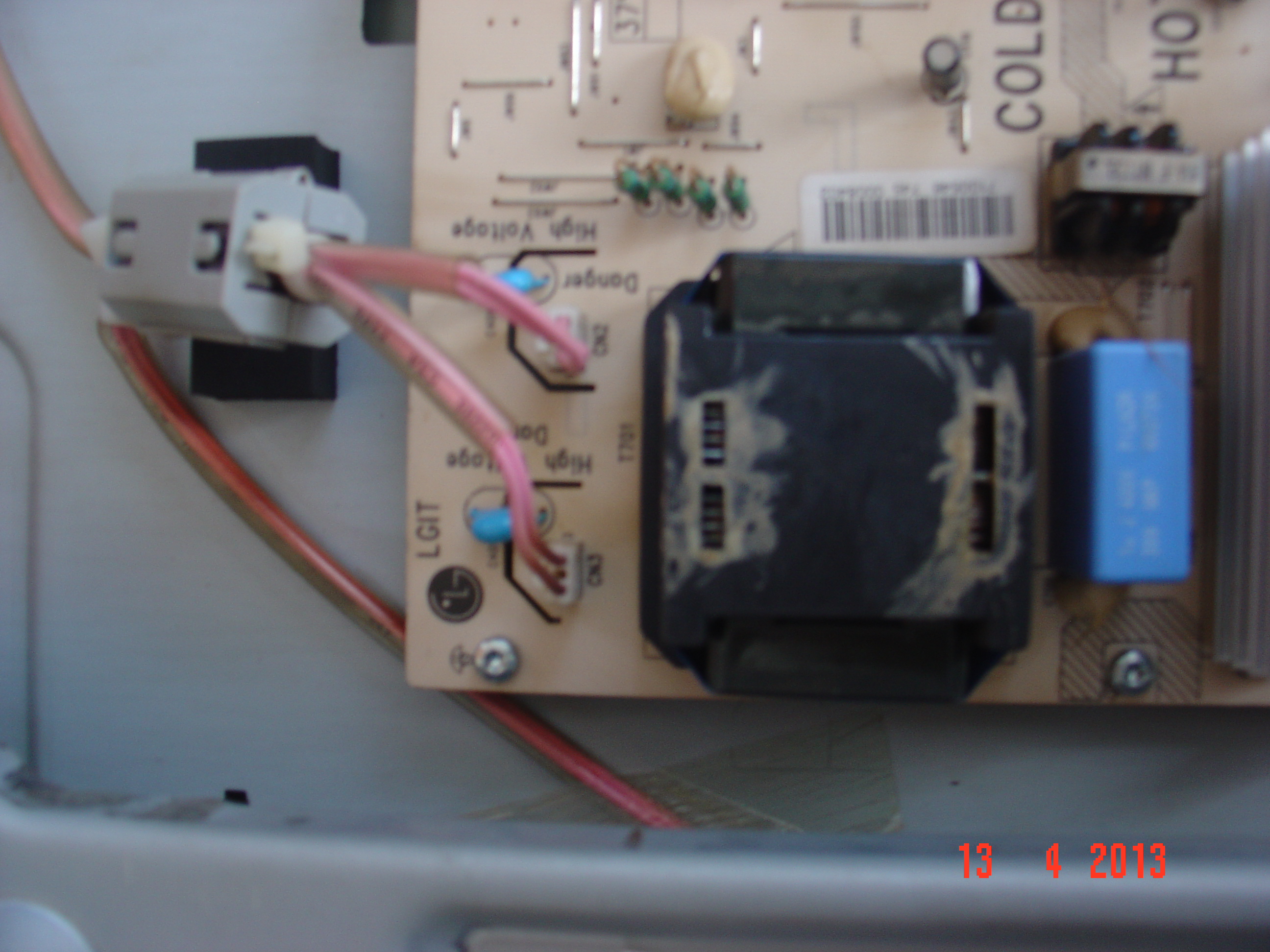

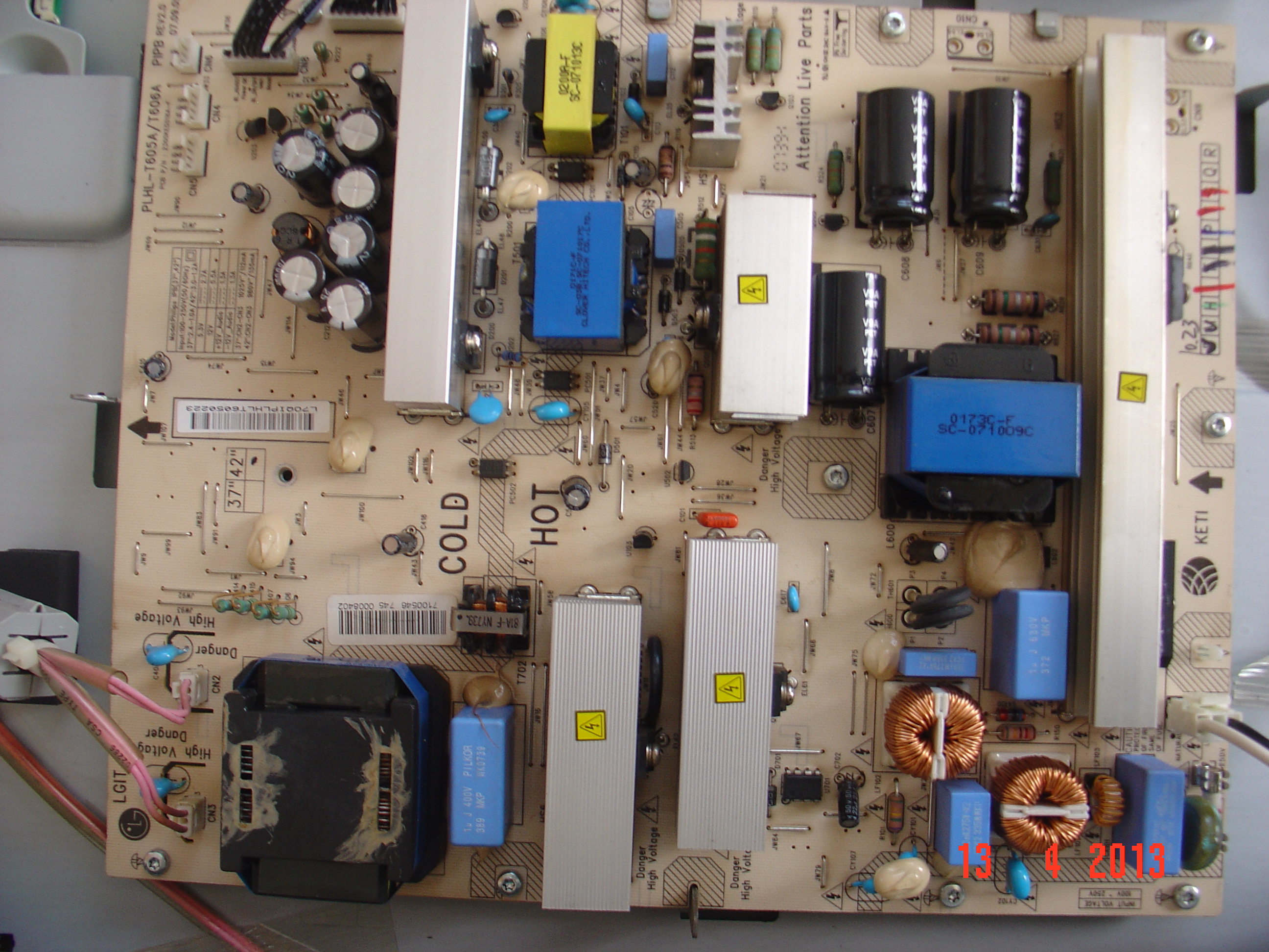

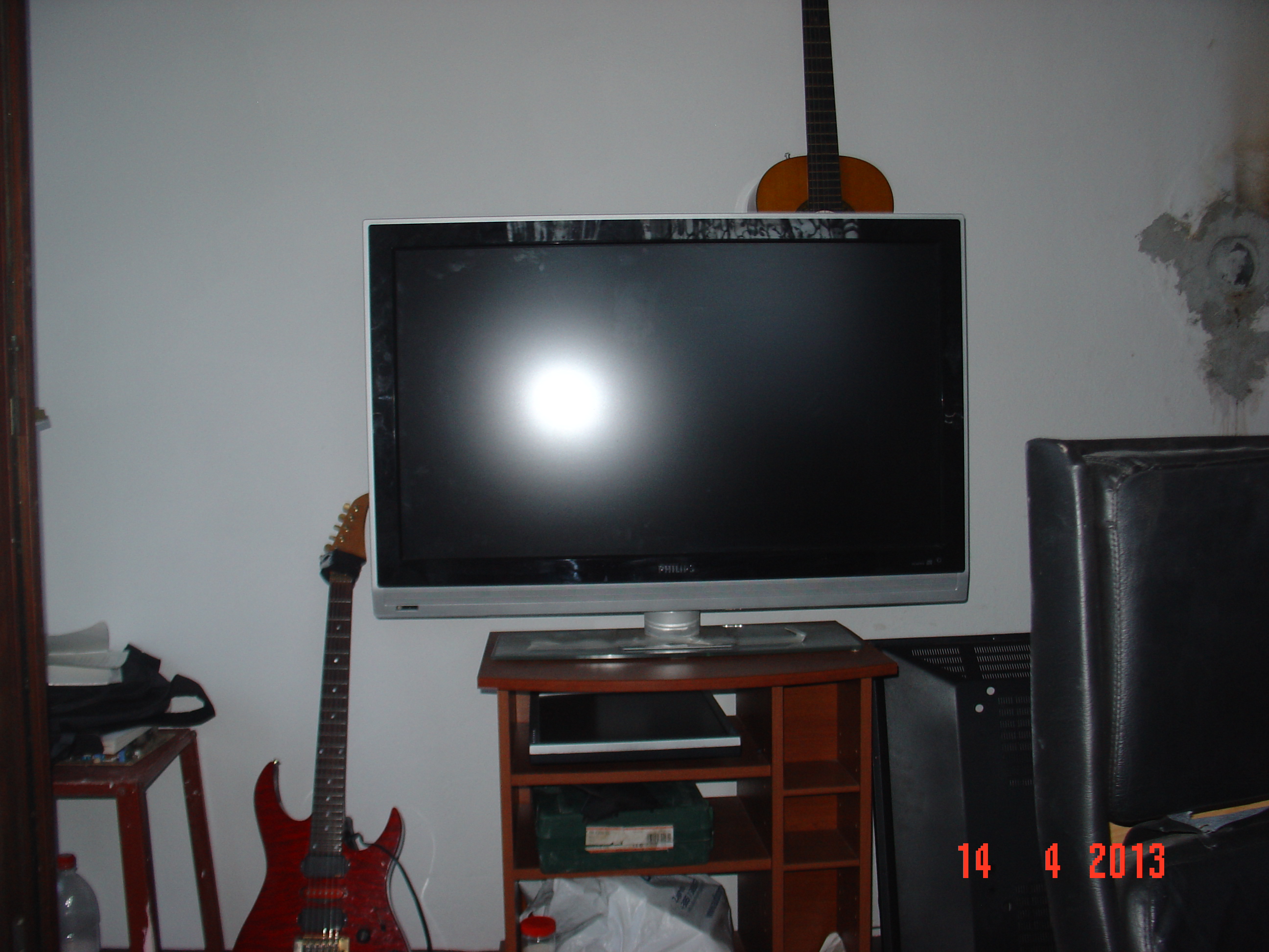

    Hi there, I have a philips 42pfl5332/10 which was at first hard to turn on, it took some time to turn it on (I know that sounds a lil bit dirty ) joke aside, a few days ago it would not turn on at all...
    I knew the problem was with the capacitors on the power board but I was too lazy to replace them before this happened. Finally I have replaced them and now the TV turns on instantly, at least the LEDs but there is only sound and no picture.
    What could be the problem?
    I checked the fuses on the power board and none have been blown, I checked the voltage regulator and it is fine (3,29V on the middle pin)... I also checked the transformer, although I am not sure if that´s the way to check it.
    The pictures will give better description than me blabing...

    Make sure the pink insulated connectors going to the power supply are well connected and seated properly. Check if the backlight lights correctly by observing the LCD in a dark room.
      Re: Philips 42pfl5332 no picture
      I rechecked them several times, I thought it has to be the problem but no luck...
      Also I thought of backlight, could it be that the picture is there but there is no brightness, still no luck, there is definently no picture.
        You need to see in a dark room if the screen is lit or not because that is very important in determining where the fault is.

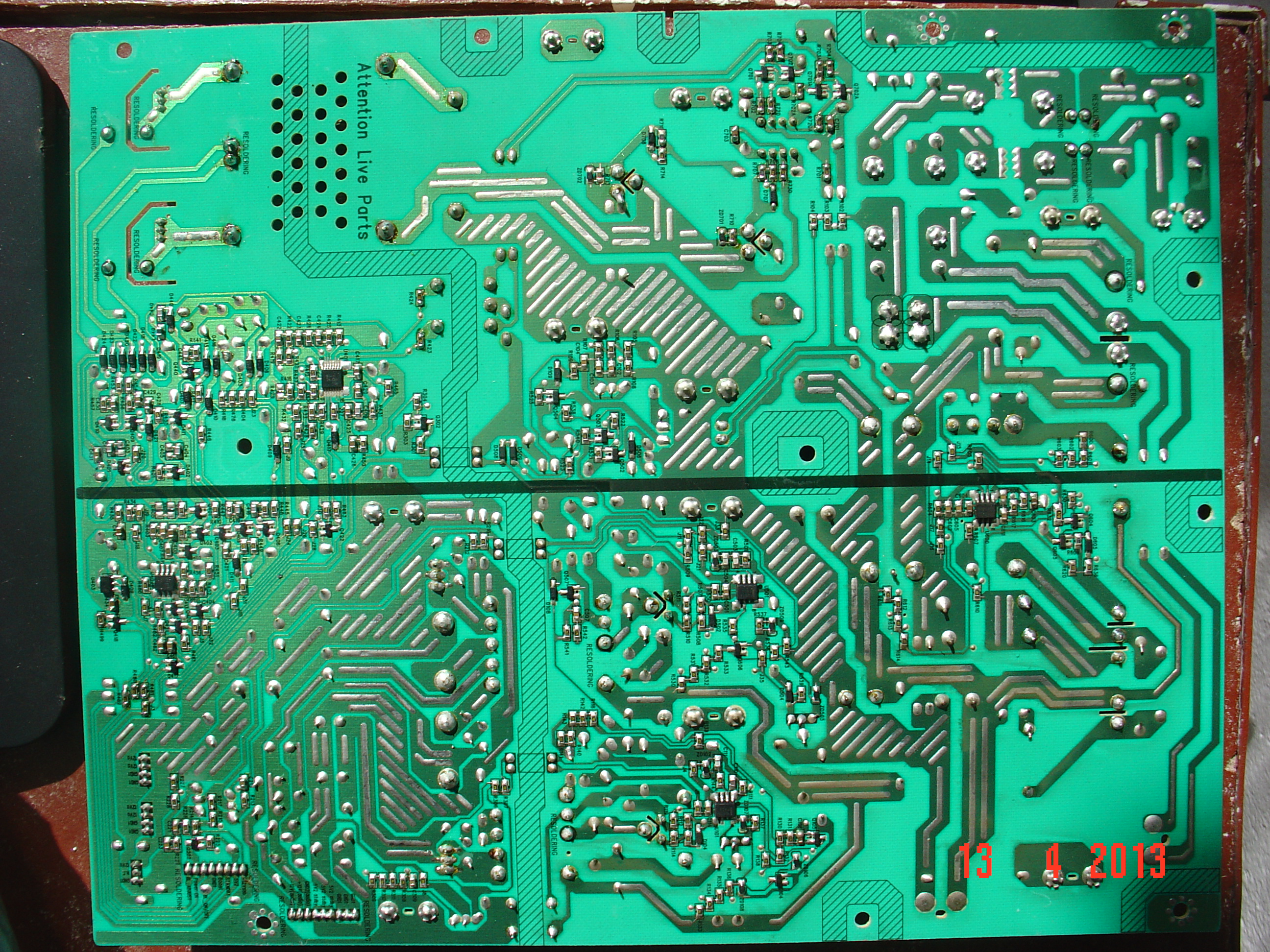

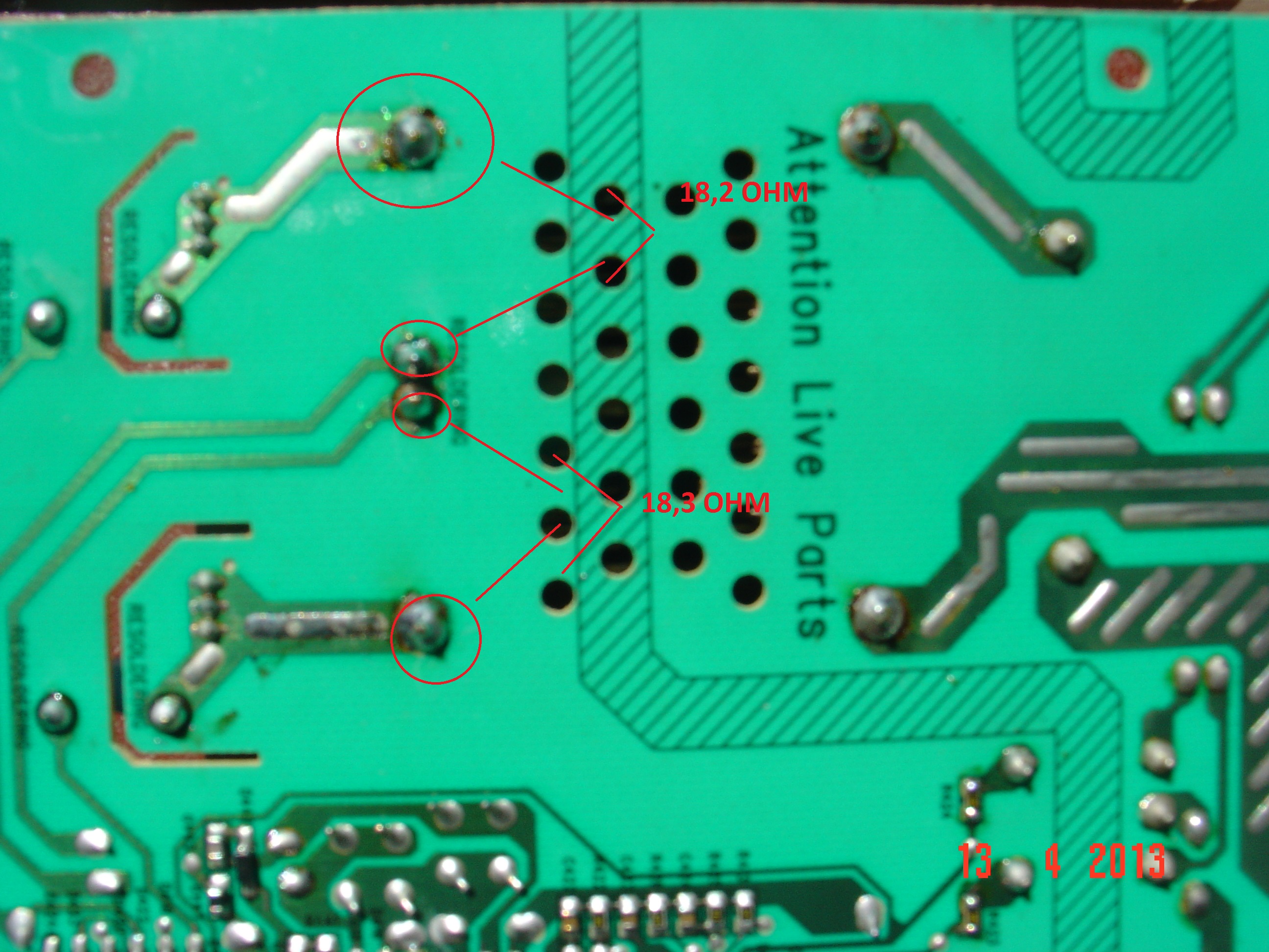

          Can anyone verify if I checked the transformer secondaries right?
          Picture #3 is transformer´s upper side, and picture #7 is the solder side
          where I measured the impendance.
            That would appear correct; however, the resistance check on single-transformer inverters is generally unimportant, apart from the windings not being open (high resistance.)

                Not really until we know what the fault is, no backlight or no video with lit up screen, diagnosis is completely different.

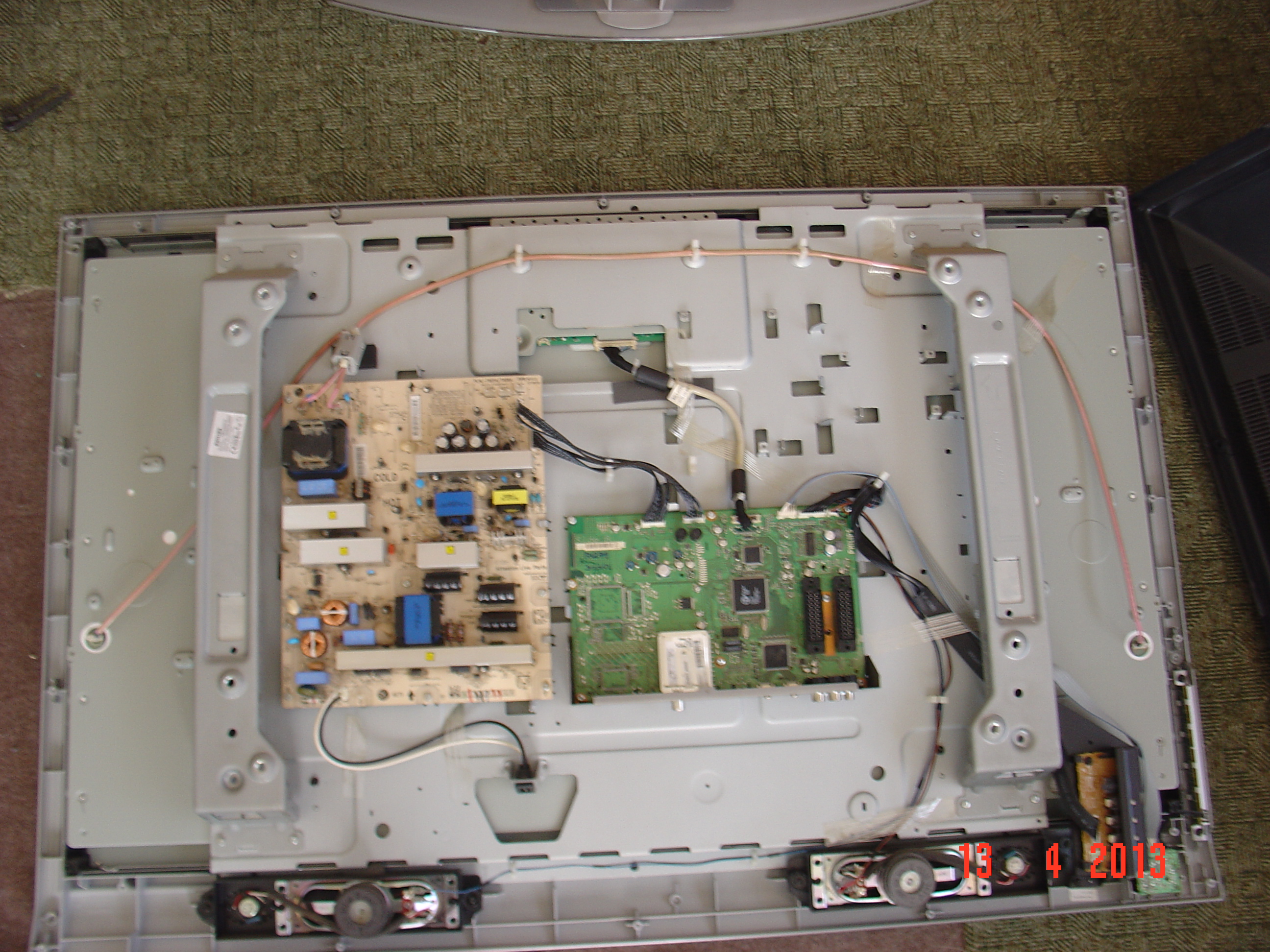

                  I put the power board back on and connected all the cables, turned TV on, it was almost midnight and the sound was on but absolutely no picture, no backlight no picture.
                  Then I took down the logic board, noticed a little bulge on the 470uf 16V SMD capacitor, replaced it with gluxon 470uF 25V put the logic board back on tried turning it ON for several times and nothing, then all of a sudden TV worked just fine.
                  Now, I have the problem that when I turn it off I have to keep pushing power button on remote for like 20-30times and then I get the TV working again.
                  What could cause that problem?
