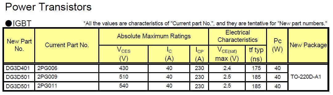

                      All the panasonic transistors i've had from there have been pre cut/bent. Going out on a limb with this remark but i suspect the only users of panasonic IGBTs is panasonic. can't say i've seen them in any LG, Samsung where as Toshiba, Renasas etc i have.
                      As far as pulled components, some may be. I had a batch of RJP63F3A which looked pulled.
                      Those Panasonic IGBTs do come pre cut and bent. If you have a search through GTVWATFORD on Ebay, you will see, they're OEM supplied.
                      To my knowledge most are obsolete out of production, The 2PG011 was superceded by the DG502LW and then they went SMD from what I see.
                      On the plus side, at least whether they are used or new, they work. The price is ok and postage is dirt cheap, just slow.
                      I guess it's better to get a working pulled than a fake, dud or not at all.

                        So a DG502LW would have worked in place of the 2PG011? Good to know perhaps for next time.

                          To my knowledge, yes also would do for 2PG009 too. I did manage to find some data sheets, I'll see if I can have a dig just in case. May not have full specs on the DG502LW.
                            #33
                            Re: Finding replacement bits for a Panasonic Plasma SC board
                            This is where I think i got the idea from. no datasheet but suggests similar.
                            http://www.datasheetarchive.com/DG3D502-datasheet.html
                            Edit: as close i can get
