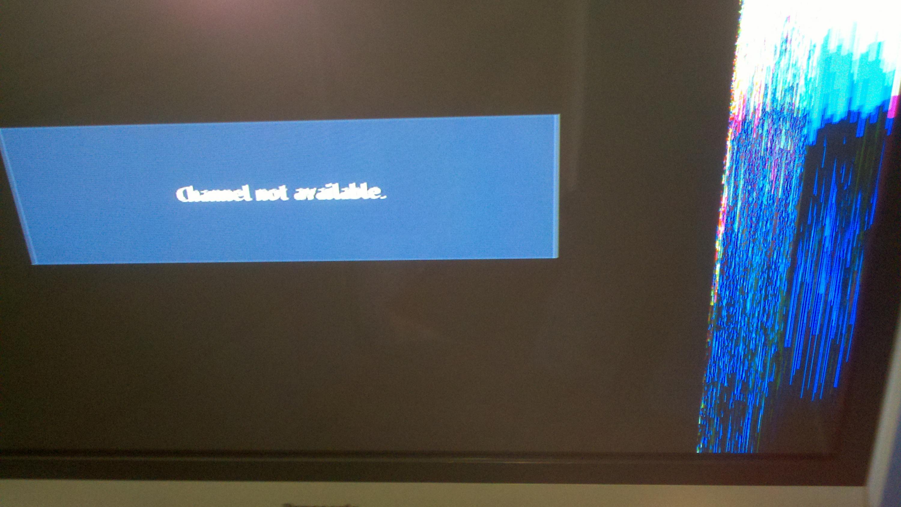

Hi Guys Can You Take A Look At This Pic TH-42PX60U Vertical Lines Panasonic

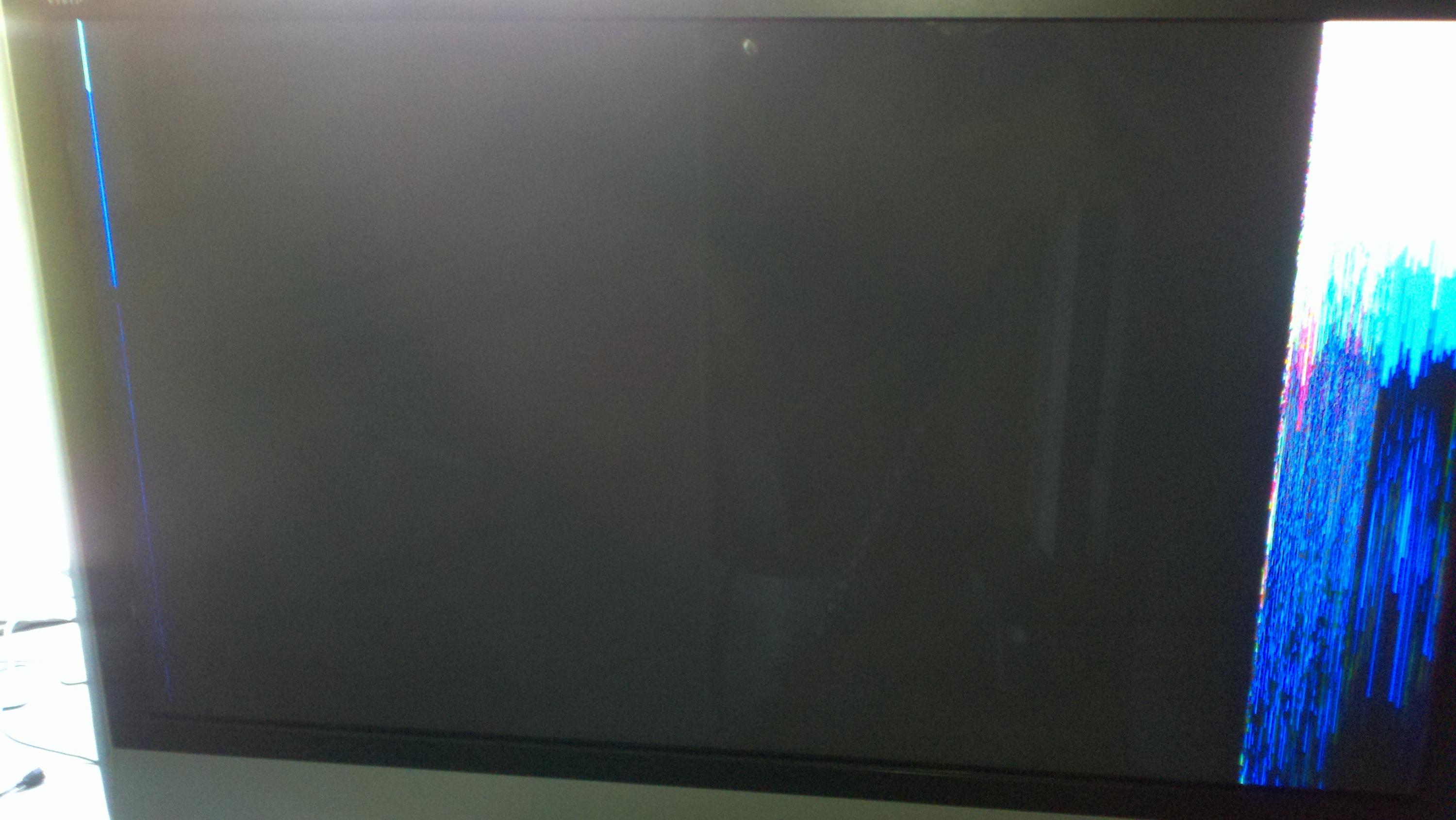

    hi guys panasonic TH-42Px60U
    vertical lines....they also move around when changing channels

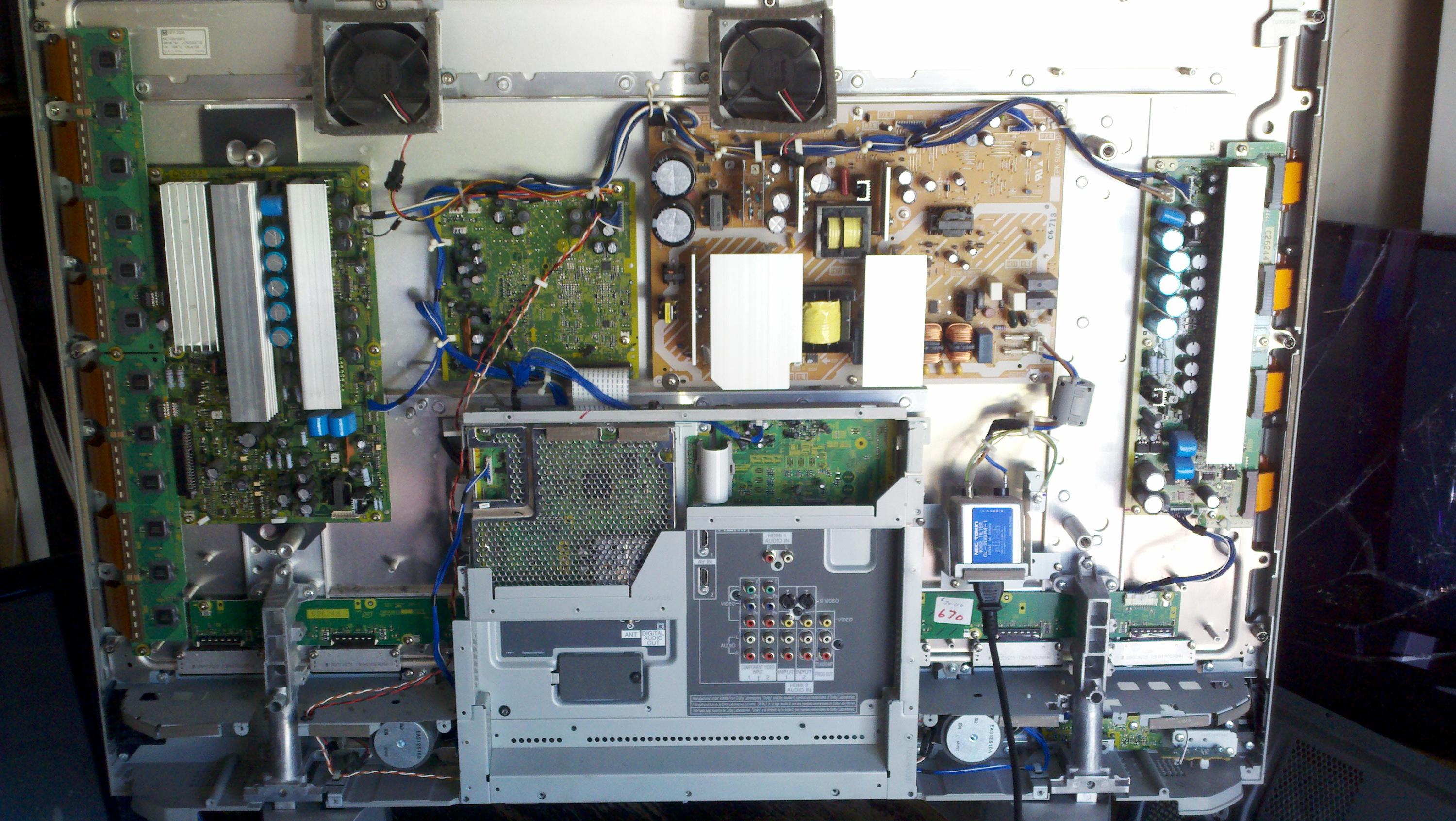

    dont know where to start on this one...no bad looking caps
    thanks dave
    Re: Hi Guys Can You Take A Look At This Pic TH-42PX60U Vertical Lines Panasonic
    The panel is failed and possibly the vertical connections are loose.
    Disconnect and re-seat connections on bottom. POWER MUST BE OFF WHILE DOING THIS.
      Hmm, lots of nice teal colored Rubycons rated at 135C.
        Yes, these plasmas are excellently well made, but sadly suffer from panel failures quite often. I've considered picking a few up, but panel failures are basically the only problem these suffer... too well made otherwise!!
