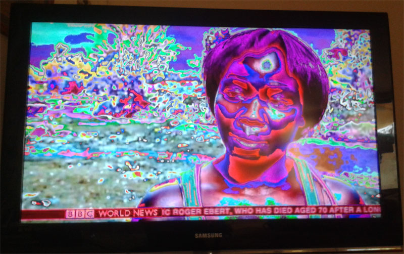

    Had this TV since new, turned on today and colors are messed up. Tried all sources, same problem. Did a reset (exit button for 12sec). Took back cover off, caps on PSU look good, reseated all cables to main board and tcon.No Luck. Any ideas to help with diagnosics. Thanks in advance.

        Looks to me like LVDS setting is wrong:
        Panel setting needs to be changed. I have seen this on the LE40A656 when panel setting is incorrect for whatever reason.

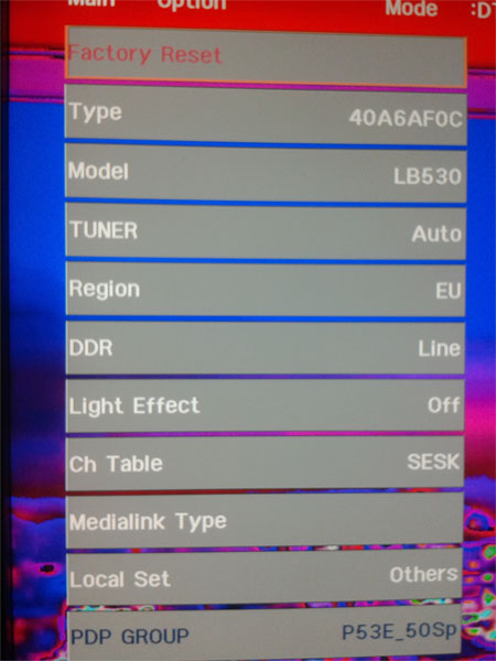

          I did a factory reset from the service menu, but nothing improved. After I was looking through the service menu options and when I selected "DDR" which was set to "line" it showed two options samsung and etron (there was no "line" option) so I set it to "samsung". Powered off then on and the picture was normal again. Hope this helps others in the future. Thanks for your help.

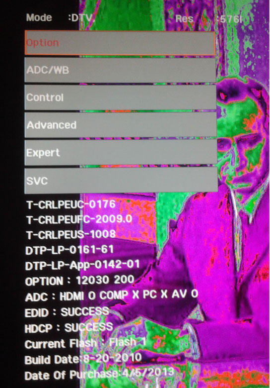

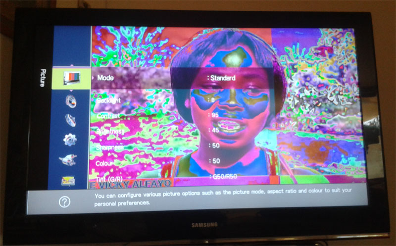

              I went into the service menu, hoping to find a further country setting. I did a Factory Reset, and now colours from all sources (DTV, USB, Bluray) as scrambled like in the original posters picture.
              I have found the DDR setting, but this has no topins.
              I have found the LVDS setting, this is current VEGA (or WEGA, the scrambled colours make the menu text is hard to read). There are two other settings, which seem to be worse.

                Do you see an option for PANEL, maybe marked AMLCD or CMLCD?

                  I cannot see a 'Panel' option. Under SVC, I see an option 'T-Com Checksum' which says 'Not AMLCD'
                  My screen is hard to read - where in the menus would you expect the Panel option setting to be ?

                    I was starting to take the back off, to get the panel info, and hence the Type. Then I realised my tech-savvy daughter had taken a photo of the Service Menu opening screen, which has the Type shown 40A1UF1E.
                    I re-entered this in the menu (there was 1 in place of a 0, which I had missed because of the hard-to-read text), and the TV is back to normal.
