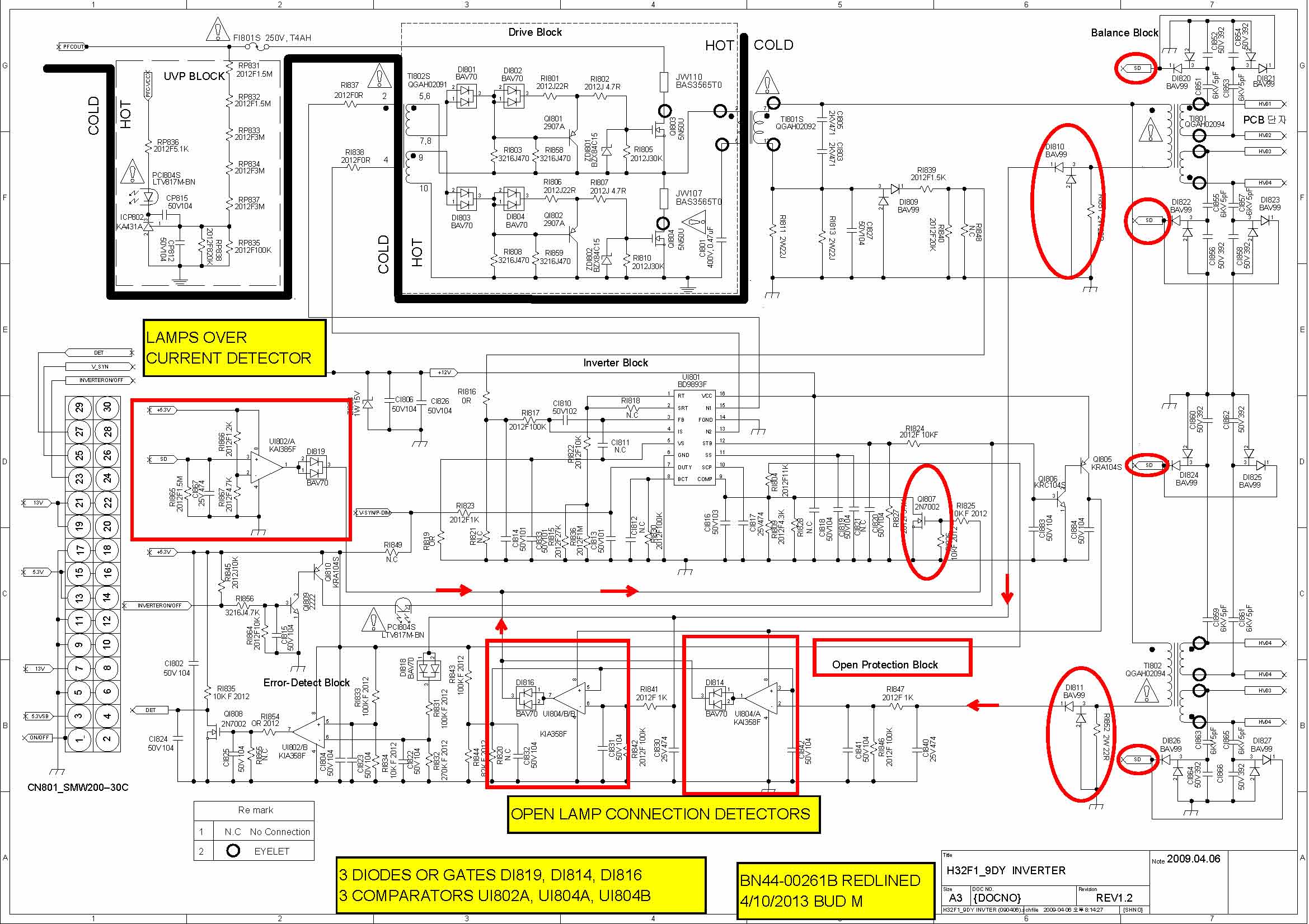

              Could be a bad backlight tube. The schematic has several OVP points; check those.
                Re: Samsung BN44-00261B power board backlight inverter fail
                Waht do you mean with "OVP Point"? It is a test point on the board?
                  There are diodes DI820, DI821, DI822, etc. which go into the point marked SD. I think you need to solder a wire to the common point if this is not easily accessible then measure it. It is relative to cold ground. Any more than a few volts is bad.

                    So with the help of the scheme and your informations, I solded 1 cable to the SD point and another to the COLD mass.
                    Miracle, with this 2 cables, the backlight looked to stay ON, with a value of 3.2V, and this value is decreasing little by little (look photo).
                    I turned it OFF, turned ON, the backlight worked normally.
                    Anther try and now, the backlight goes down after 3 seconds. Impossible to get it staying ON.
                    Do you think there are the neon backlight tubes or the inverter board?

                        Per diagram on page 2:
                        There are 3 comparators and 3 Diode OR Gate for open lamp connections detectors and lamp over current detector.
                        UI802A is the comparator for the lamp over current, the output at pin 1 is normally LO due to +4.22V at the + input (Pin 3) of the UI802A, if the Negative input (Pin 2, DC signal SD) goes higher than 4.22V, the output at pin 1 will swing HIGH and will be fed through Diode DI819 OR GATE (one of the 3 Diode OR GATE) which will turn on MOSFET QI807 which will ground out PIN 9 (COMP) of UI801, then the output of this IC will shutdown.
                        The other 2 comparators work the same way, you can easily calculate the Voltage at the Negative pins to find out what the voltage at the + pin has to be to cause the output of the comparator to go HIGH.
                        Right now it may be one of the three detectors has trigger the shutdown.

                              I made more tests, everything was unsuccessful... I removed the resistor RI825, and I tried to saturate the mosfet through a 10K resistor with the 13V output and it was unsuccessful... And I tried too to put directly the pin 9 of the BD9893 to the ground (I suppose when the mosfet 2N7002 is saturated, it will act as a closed interuptor so directy connects to the ground...)

                                If the MOSFET is bias on, that will cause the inverter to go into shut down, you need to ground out the GATE of the MOSFET (using 100 Ohms resistor) to keep it from turning on by the error signal.
                                That MOSFET is normally OFF if there is no error. You are turning it ON instead of OFF.
                                If that MOSFET is forced off and the backlights still will not stay on, then you have to locate the cause of the problem some where else.

                                  I grounded the gate of the transistor QI807 trough a 100 ohms resistor and the problem continues to be here...

                                    In which case it is not an over voltage detect (open lamp) but possibly an over current detect fault. For this you need to look at UI802/A in Bud's highlighted drawing.
                                    Also, if you can, check pin COMP (compensation) #9 of the main inverter IC, UI801; if this is going low it could indicate the protection is still firing but if it's staying high it indicates some other problem like lack of PFC voltage, bad inverter IC, cold solder joint, etc.

                                      Hi everybody, I read carefully the overall thread as I am having the exact same problem. After a lot of unsuccessfull searches around the security circuits, I found the reason of the problem which is that the IS (pin 4) input of the feedback circuit is not correct, about 650mVolts. According to the IC BD9893 datasheet this pin is comparing with internal 1,25 volt. If higher, it will decrease the duty cycle of the IC output lowering the inverter output. If lower, it will do the reverse. The problem is that I do not see any failing component around and when I apply 1,25v to pin 4 using an externa power supply, the inverter works and the backlight fires up and the duty cycle varies with the applied voltage.
                                      If I connect pin 1 of either DI810 or DI811 to pin 1 of DI809 then the backlight is quite dark but works. I wonder if the problem might be due to a bad transformer.
                                      Can anyone tell me the resistance measured on TI801S out put and of TI801 in parallel with TI802 ?
                                      To make it work, I replaced R1811 parallel with R1813 by a 22 ohms carbon and placed a 1,5nf in parallel with R1840. This provides a stable backlight but very dark.
                                      Any idea about this problem ?
                                      Regards.
