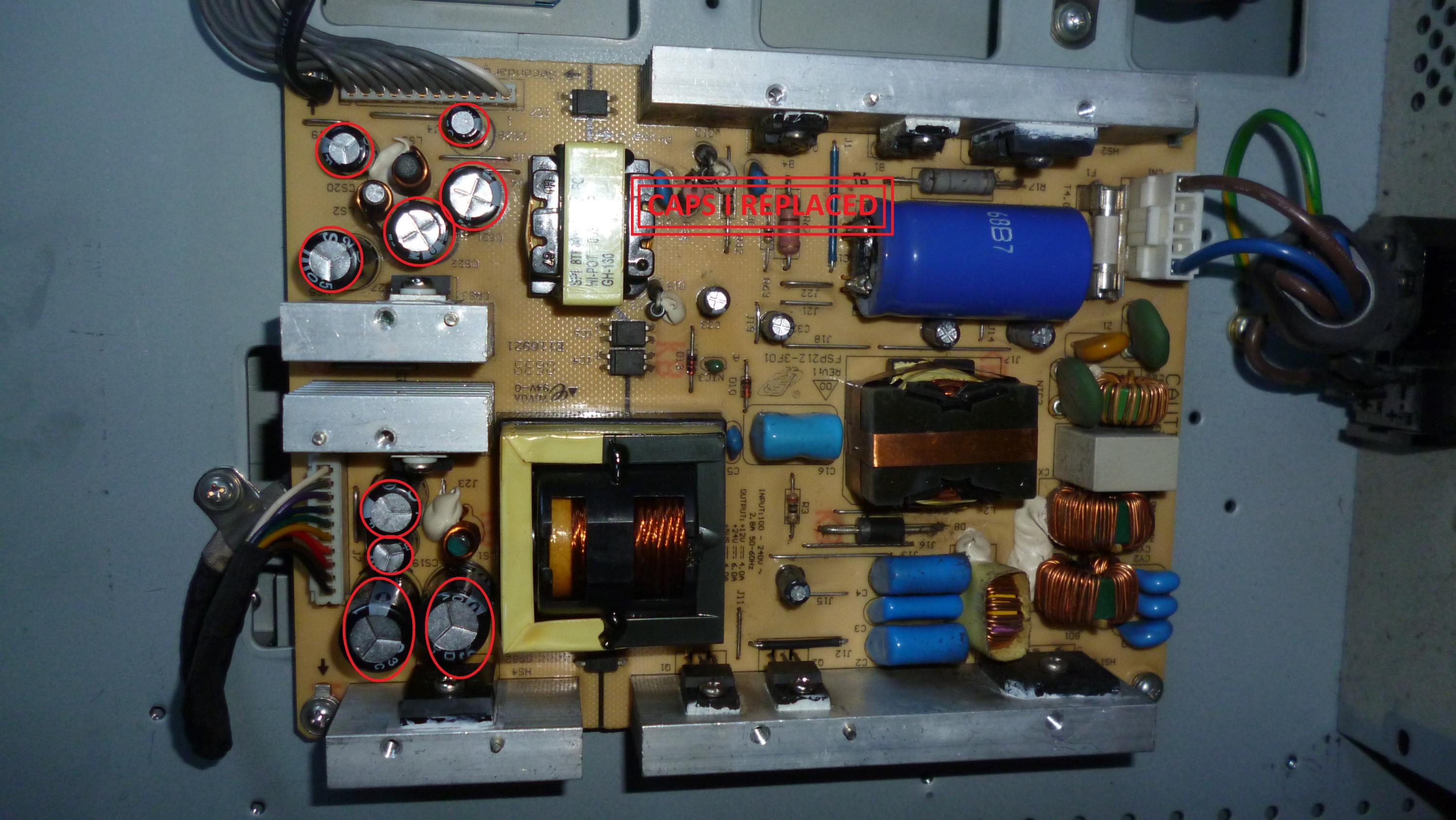

    Hi guys got a Hanspree model number as in title. no power whatsoever, opened the tv and every cap inside was bulging and some had popped so replaced all of them (in picture) placed the power board back in the tv, hooked it all back up, switched in plug and flicked the on/off switch and.......NOTHING
    any ideas guys ?
    Re: HannSpree JT01-32E1-000G
    Well, you used a mix of crap and poor quality capacitors (apart from the Nichicons), though they would probably not cause a completely dead set, you really must use good capacitors or it will fail again in short order.

      what can be the coz of the set though as its totaly dead, no power light or anything
        Any 5V and 3.3V rails coming out of PSU?

            Have you multimeter, can you check voltages coming out of PSU?
            --At the moment, it could be literally anything without knowing if the small side of PSU is running or not!
            You Have checked the PSU fuse --haven't you!

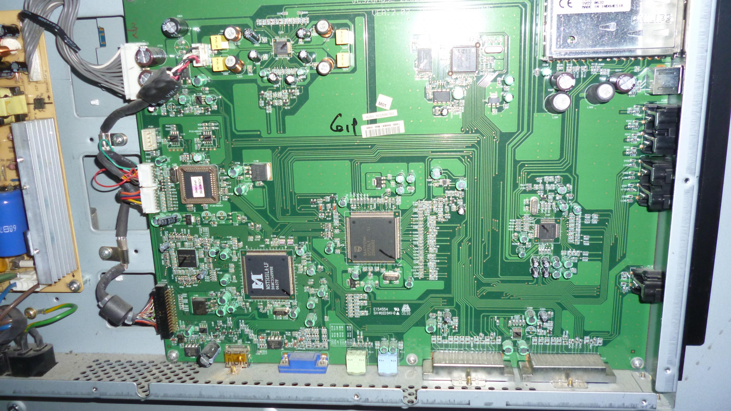

                Is that picture after you replaced the caps or before. If it is before can you post a picture as it is now.
                    picture after i replaced the caps.

                                      Small PSU not functioning.
                                      (There's two distinct supplies on these things. One supplies the processor and low volts stuff, the other, the lamps and higher power stuff....)
                                      Plasmas are even worse! Up to 5 separate supplies from different sections--5 PSU's on the same board in effect.
                                      I suspect your PSU has a faulty chip or other semi that is supposed to supply the small-side of things. Without those small supplies--its as dead as doornail.
                                      Should have a 5V at the very least somewhere to the control-board.
                                      Best way forward--Replace psu board, as I said--Could be anything in that small supply section.
