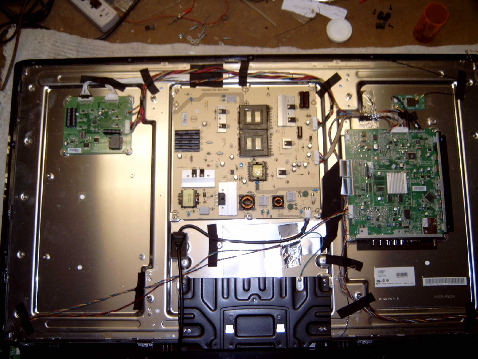

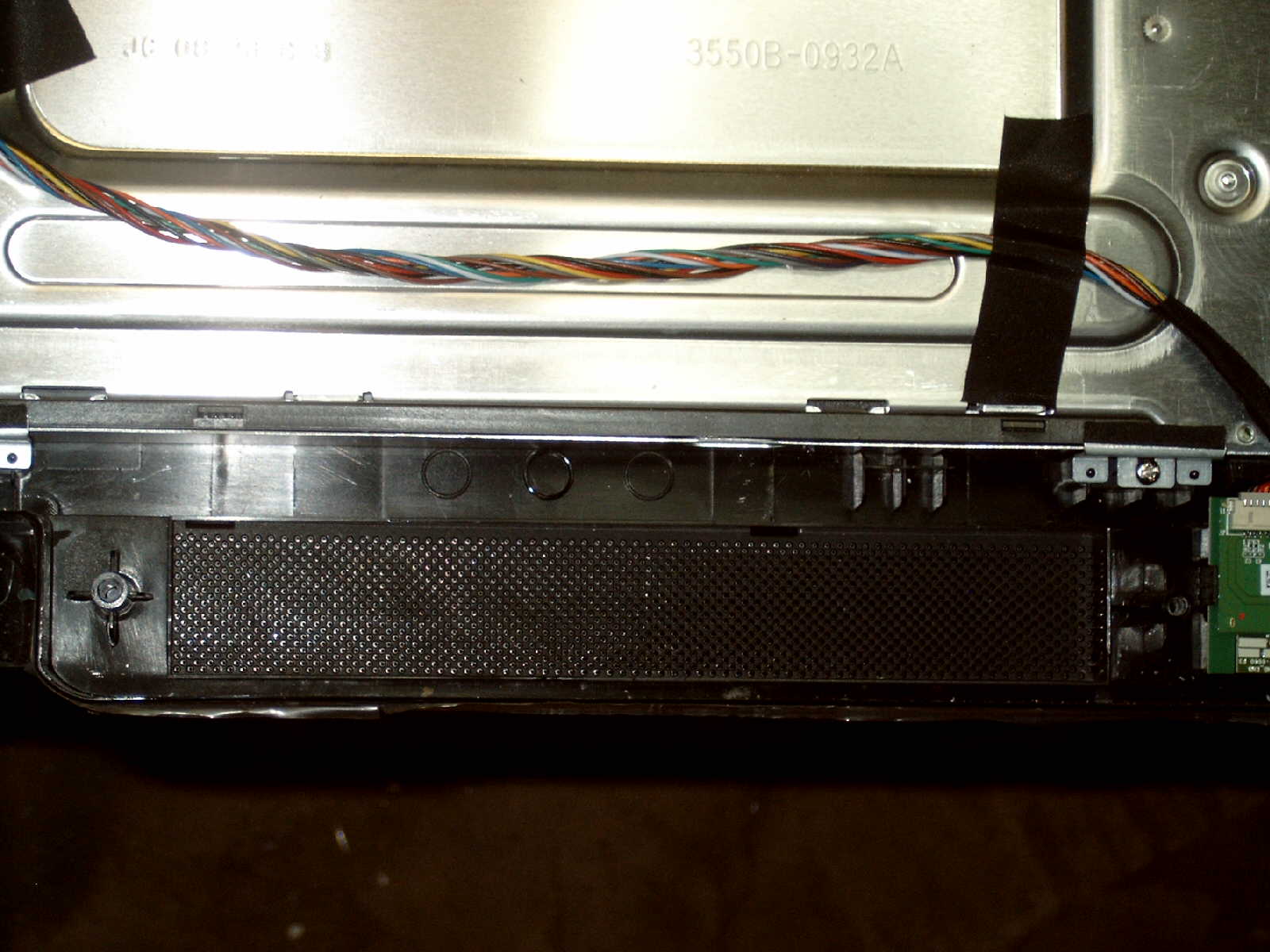

    Vizio M3D421SR speakers needed
    I recently acquired this Vizio M3D421SR tv. The main board was just repaired by a service advertised on e-bay (great service by the way!).
    The internal speakers are missing from the set. Everything else works on the set including the external audio jack. I want to install the speakers.
    Since it's an led edge lit set, the area for the speakers is not very deep.
    Does anyone have:
    Vizio part numbers for the speakers or a model number of another Vizio with the same speakers. There are some on e-bay but I don't know if they will match.
    The other option is that someone out there has the same model with a broken screen that they are stripping for parts - in that case please contact me.
    The two photos show the rear of the set and speaker area below the main board.
    The speakers fit in an area that is 7 1/8" long and 1 3/16" wide. The mounting holes are 8" center to center and looks like they are centered to the width of the speaker. It's a little tough to determine the maximum height of the speaker but it looks to be about 1".
    Any help would be appreciated.
    Thanks,
    Mike

    Re: Vizio M3D421SR speakers needed
    This is the best thing I could find:
    http://cdn.avsforum.com/1/10/10f3881e_P1040730.jpeg
    Can't make out any numbers but at least you can see it somewhat.
      post a picture of the plug for the speakers on the main board. What is the height and width dimension for the speakers? I have a 47" and 42" vizios with cracked screens that i have already ebayed the boards.
        Mr. Bill and Marty,
        Thanks for replying to the post.
        Regarding the plug - I've put the back on the set already, but it's a 4 pin plug and the spacing of the pins looks like 2 mm apart. The connector is on the edge of the board. I'll make something if I have to or adapt another plug. Not that concerned about them plugging in without modifications.
        Since the speakers are missing the only info I can give you is what I wrote in my original post.
        The speakers fit in an area that is 7 1/8" long and 1 3/16" wide. The mounting holes are 8" center to center and looks like the mounting holes are centered to the width of the speaker. It's a little tough to determine the maximum height of the speaker but it looks to be about 1".
        The other Vizio speakers I've seen look like they have little enclosures built around them. However, in the picture that Marty posted it looks like the magnet is exposed. My guess is that they fit snugly in the above area.
        Thanks again,
        Mike
                        Update
                        After a lot of searching on Ebay I finally found speakers for the M3d421SR.
                        I purchased speakers from a broken screen M3d550SR and they appear to be an exact fit.
                        The M3d421SR speakers have the part number 78G120A-43-YA
                        and the M3d550SR speakers have the part number 78G120A-43-Y
                        The above speakers fit correctly in the opening, the mounting holes match, the cable is long enough to reach the main board and the plug is the same.
                        Hope this helps someone else.
