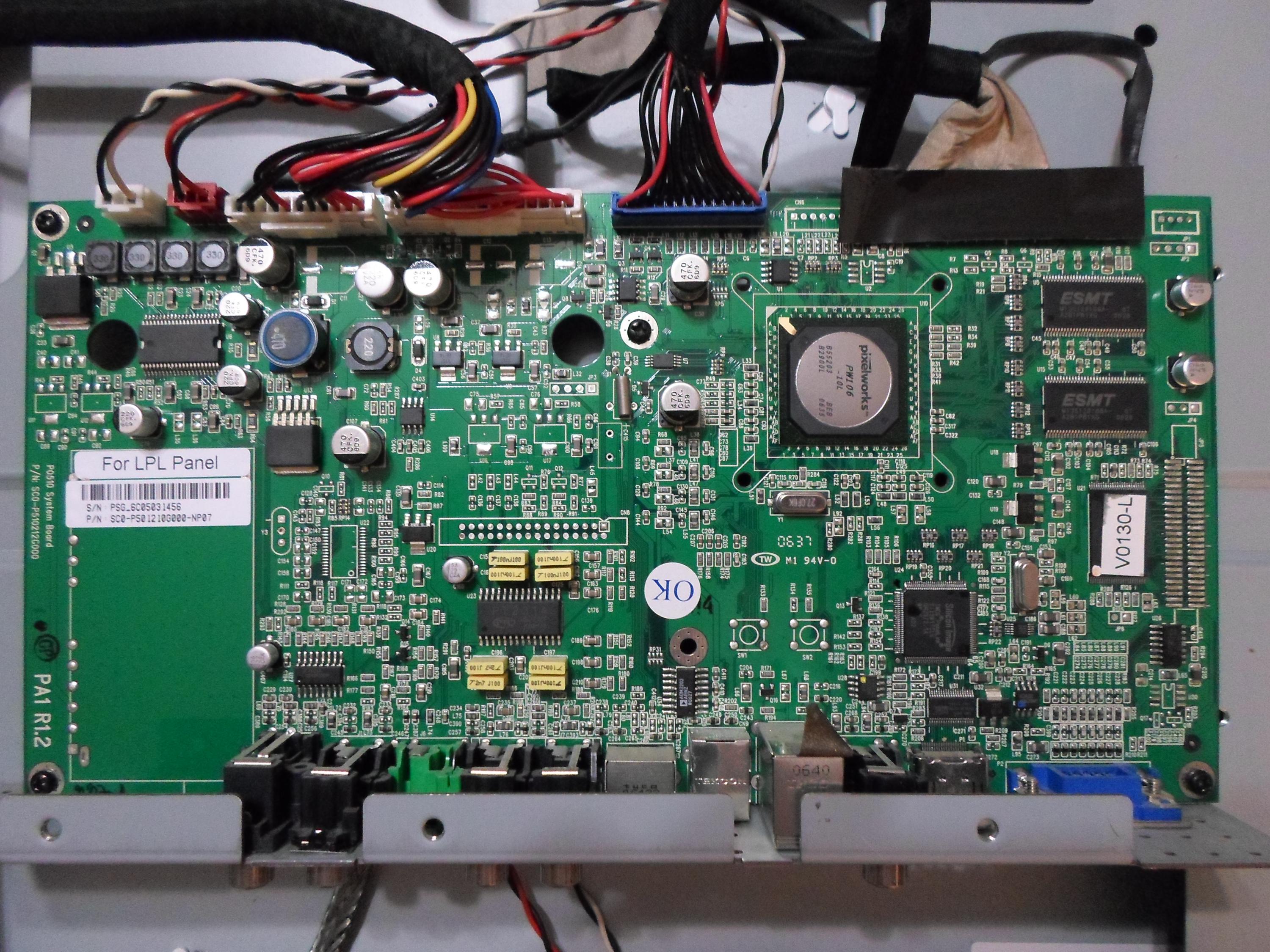

    I thought it may be the main board so replaced it with a new one, but same results.
    There are no labels on any connectors either so have no idea where to check things..

              I see some 3-leg LDO regulators on the main baord, you might as well check and report the voltage reading.

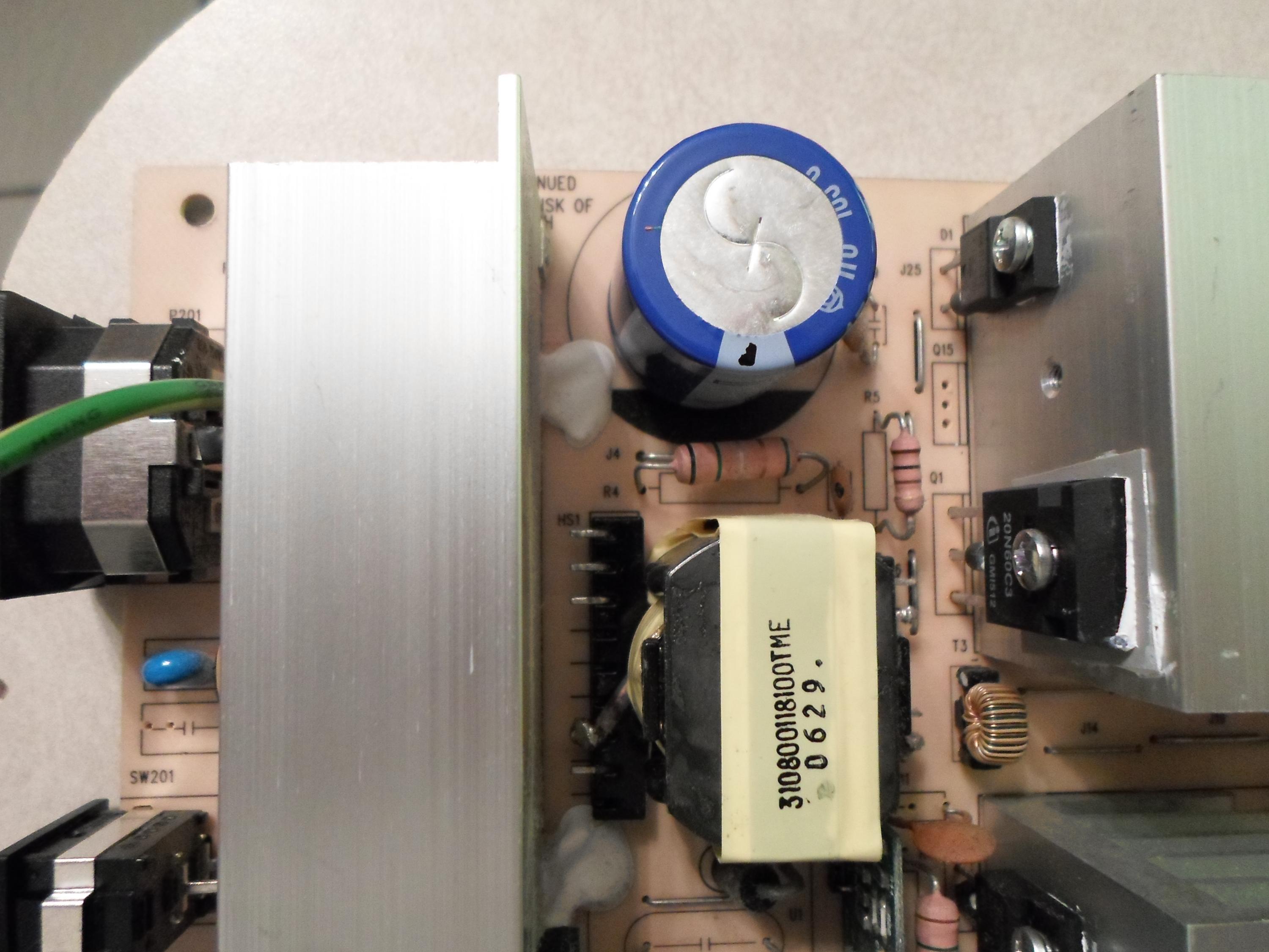

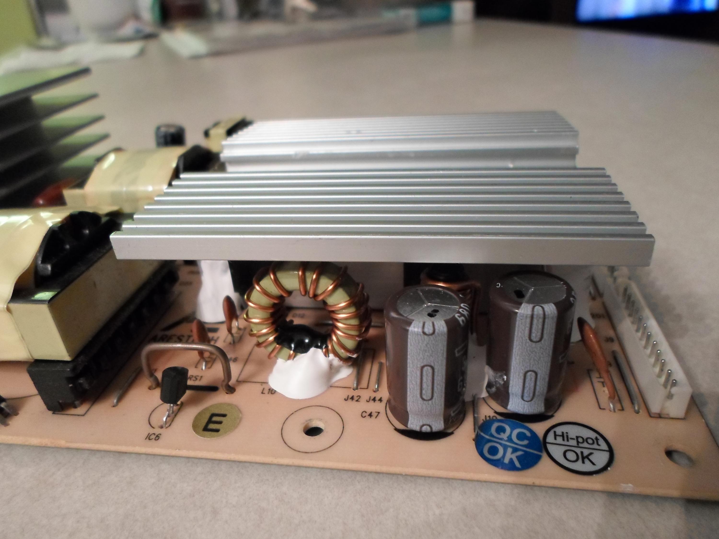

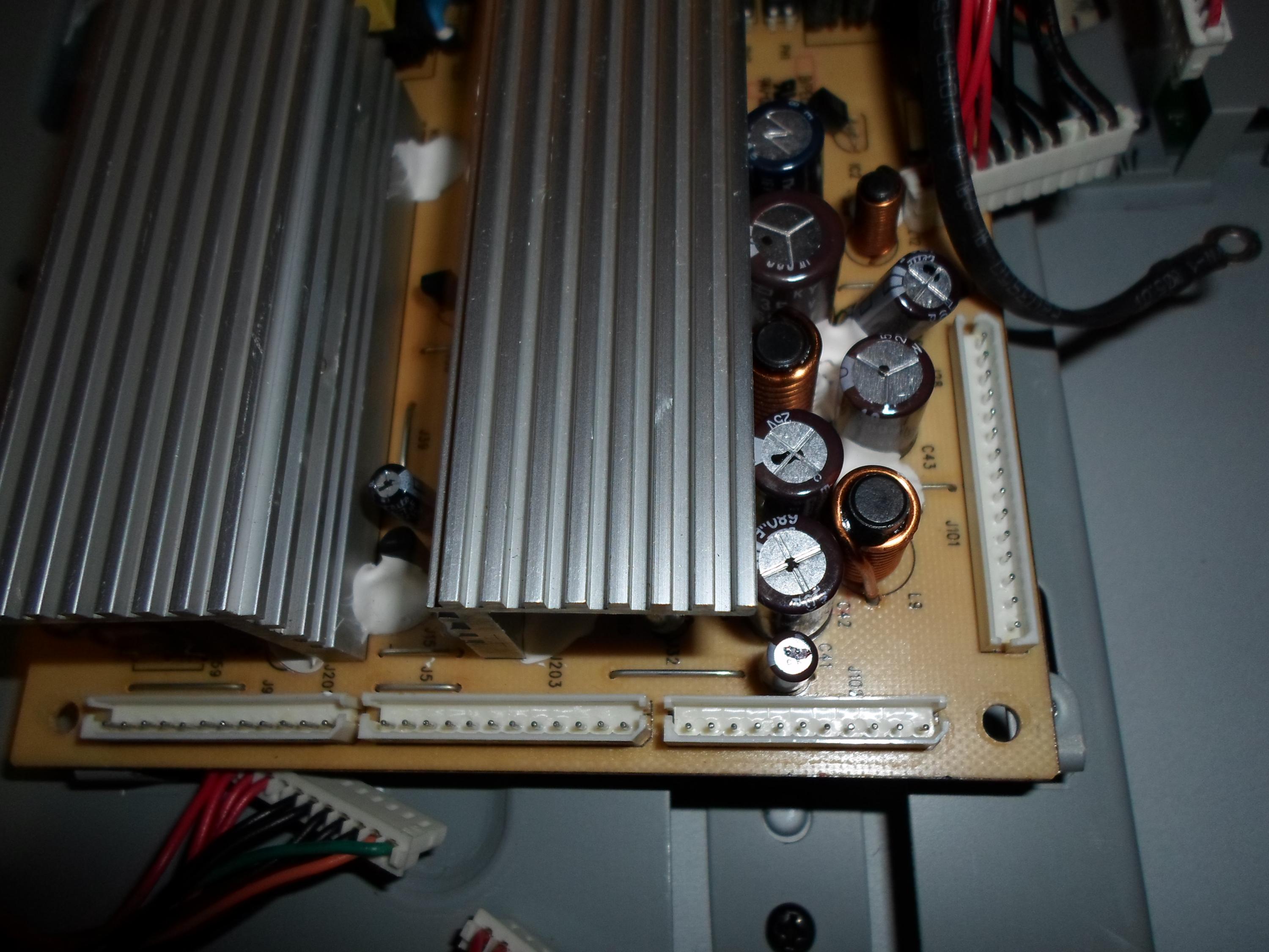

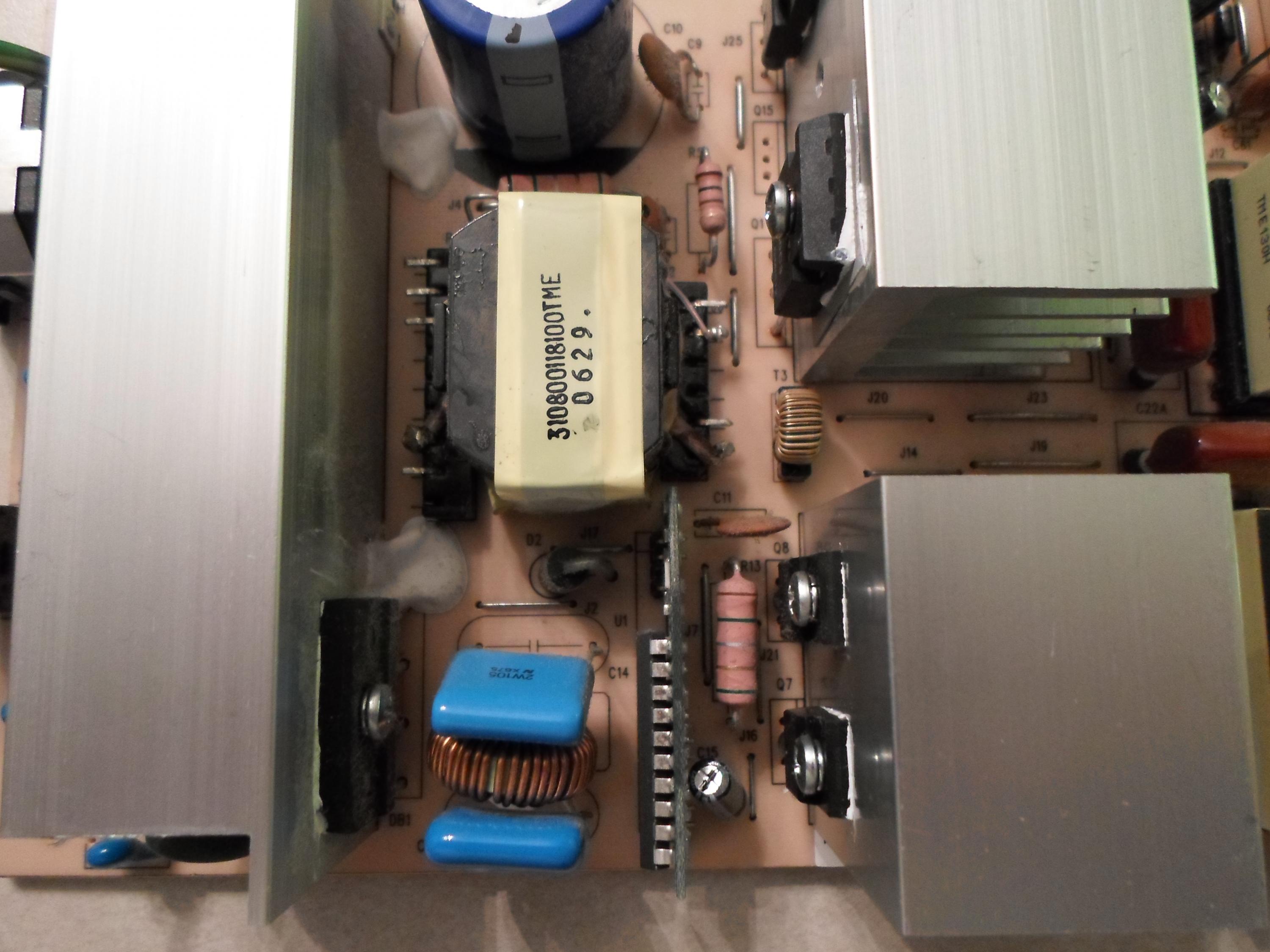

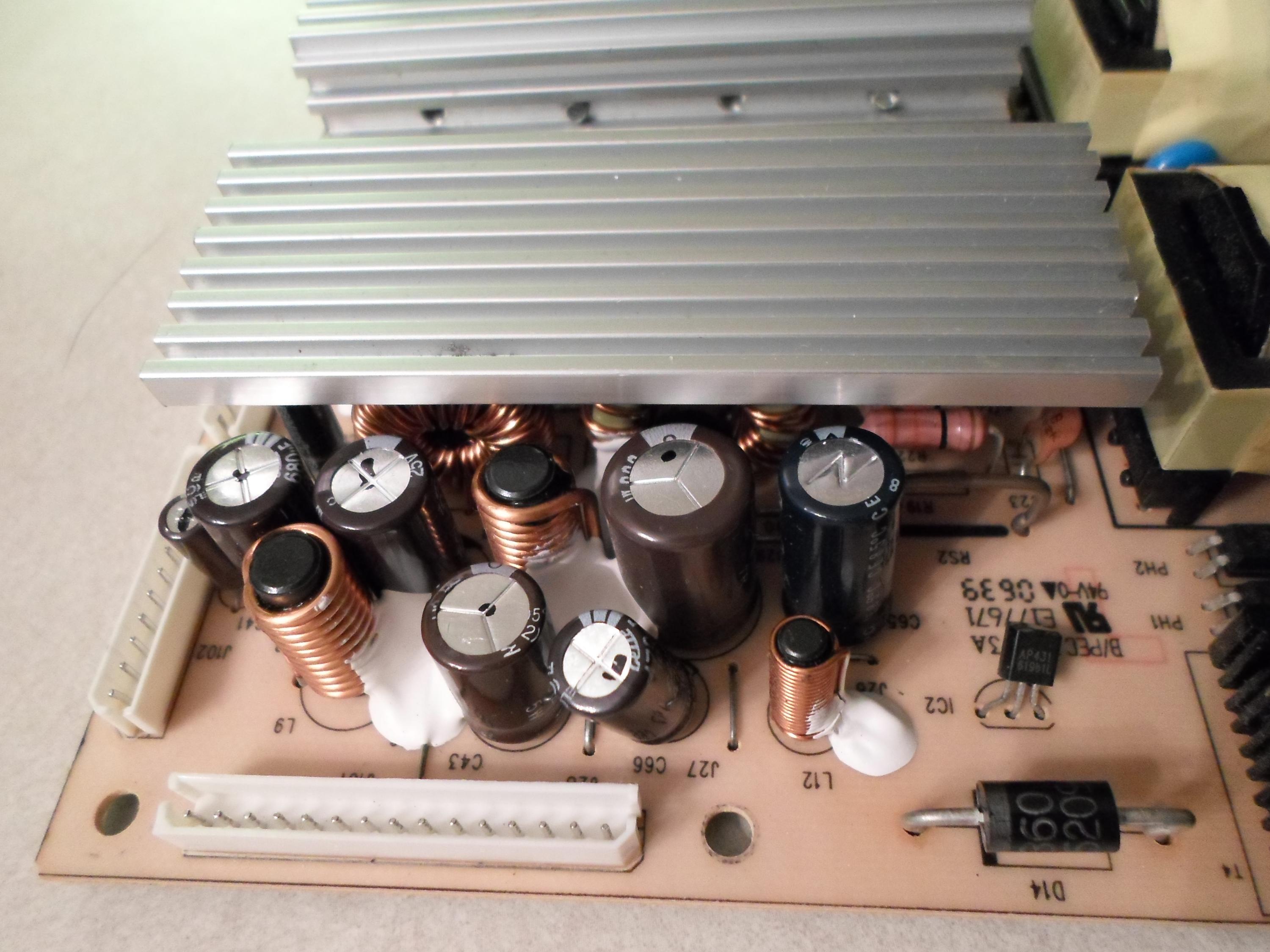

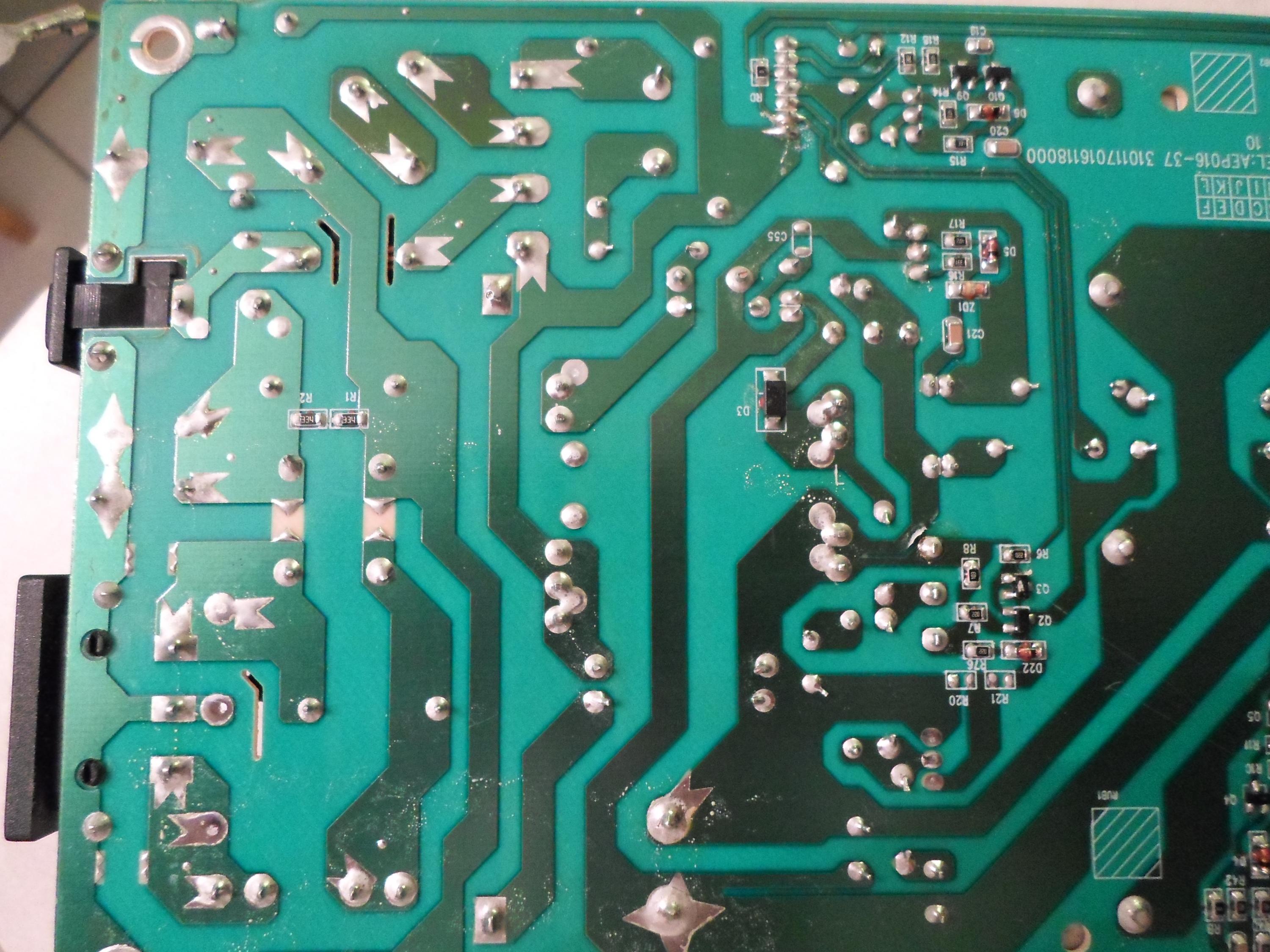

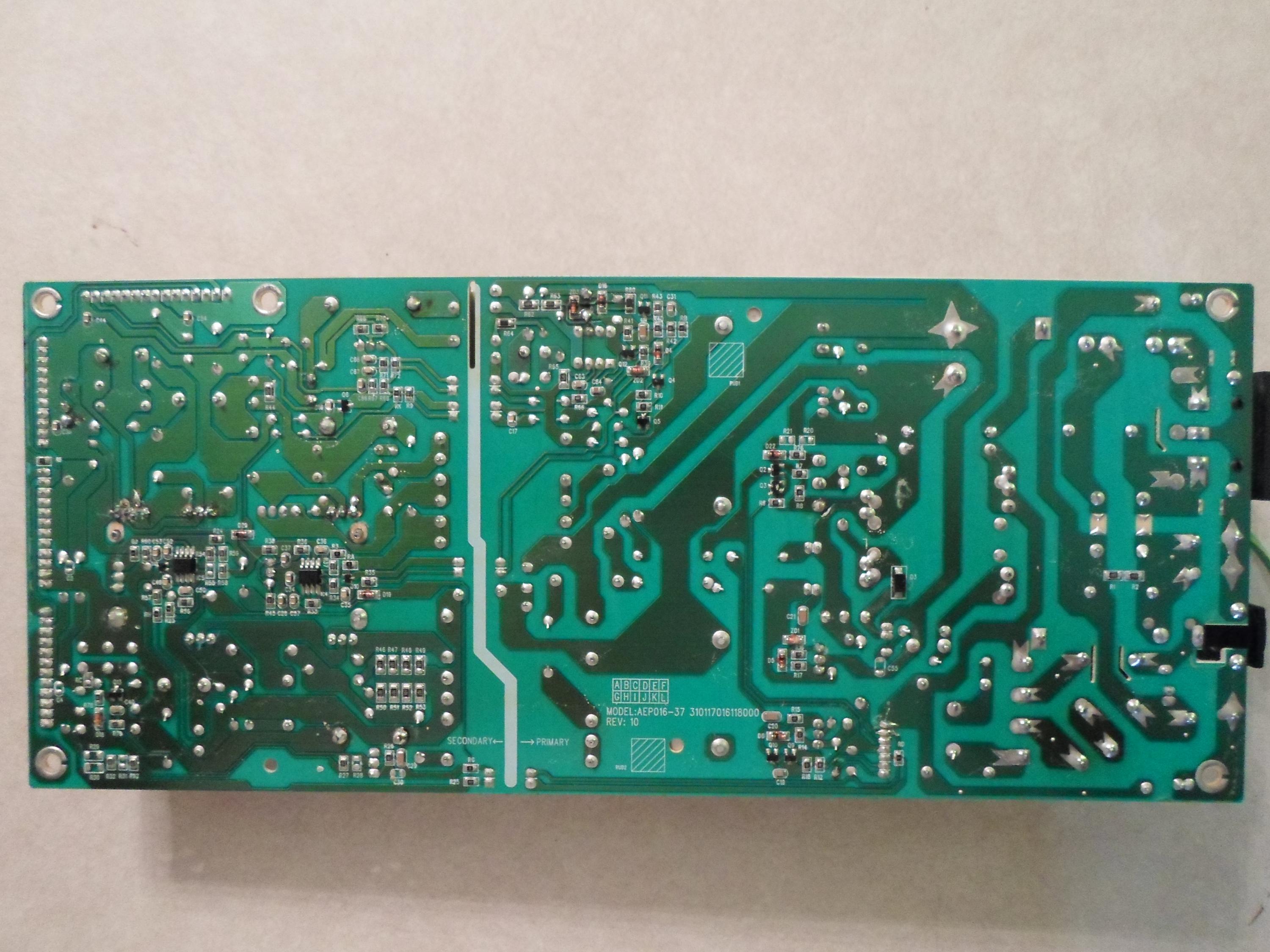

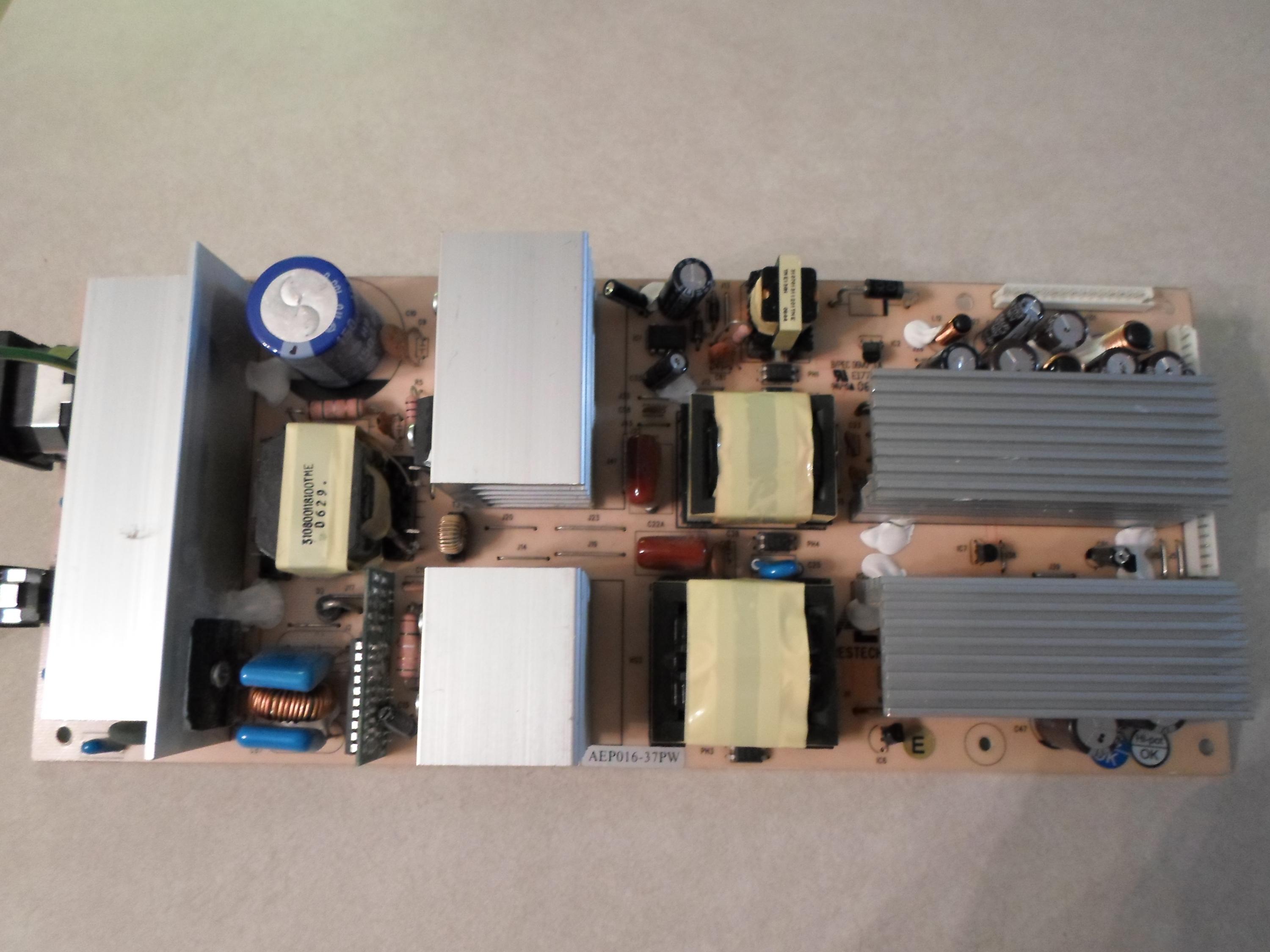

              Can you also take real good pictures of both top and bottom side of the power supply board in 1/4 section each?
                Re: Olevia 337-B11 Need some help with this one please!
                I checked the 1117 regulators, there are only 2 that have voltage, from the 5v standby and they tested good on both main boards.
                I will post the pics when I get home from work, thanks..

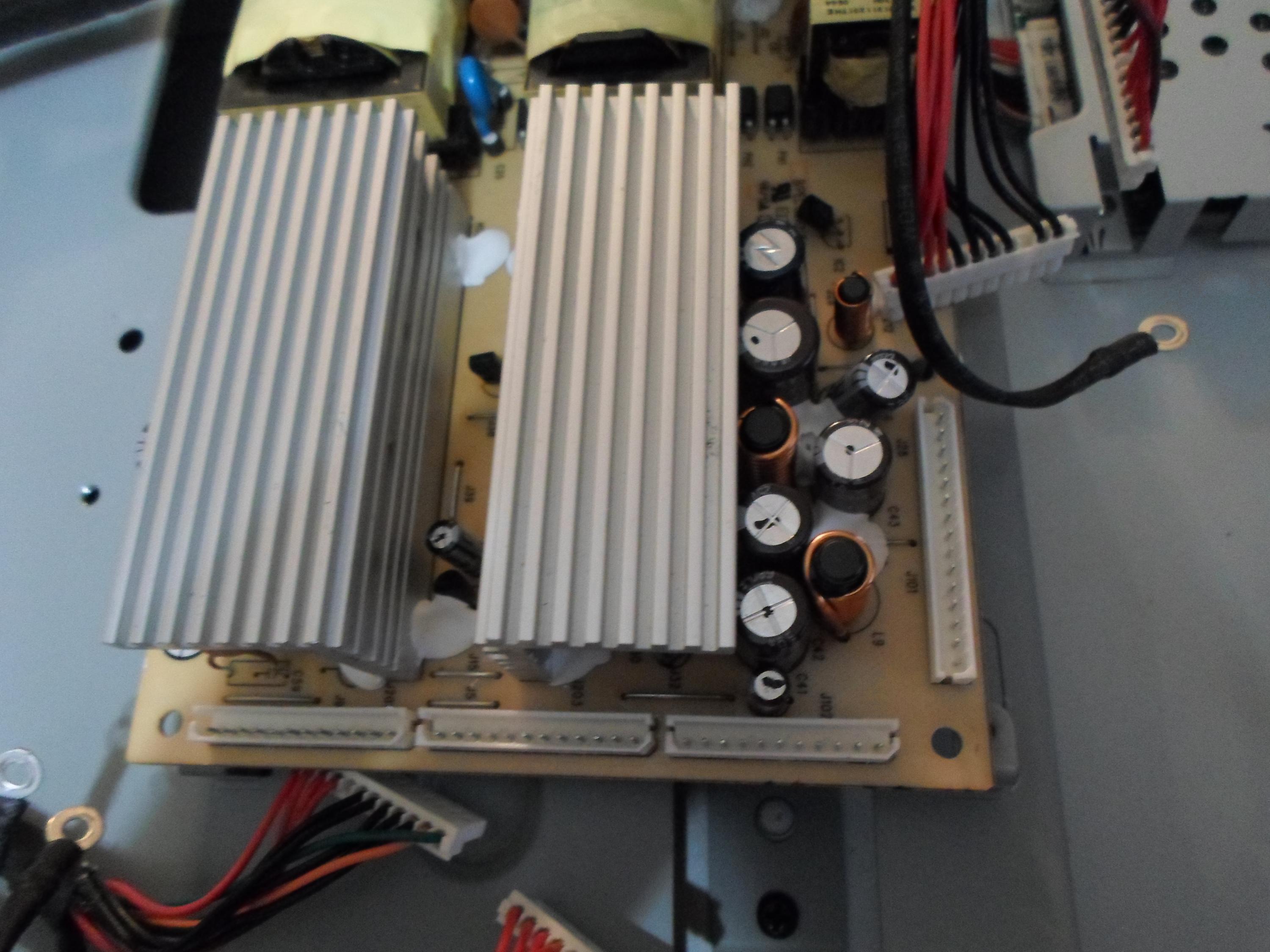

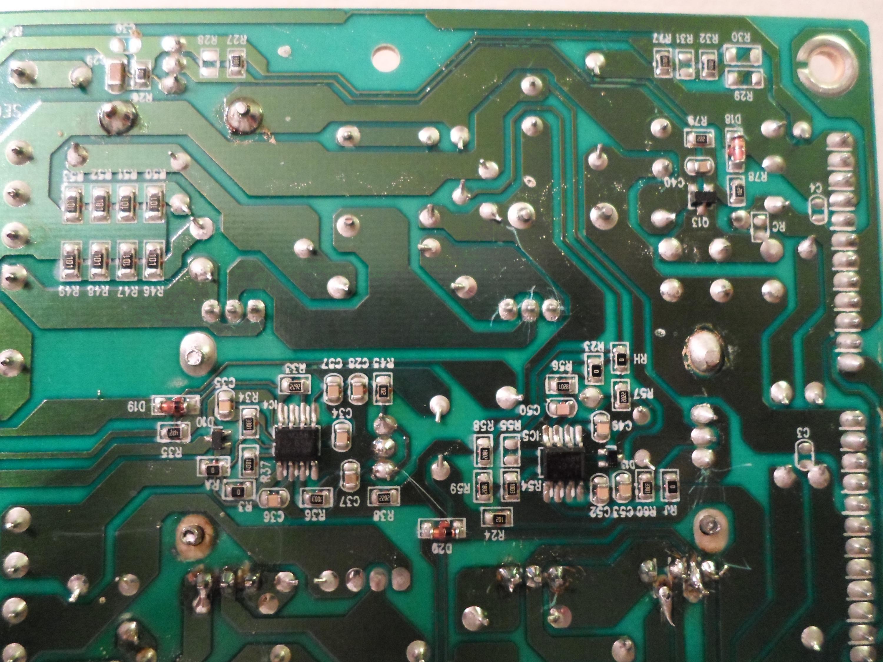

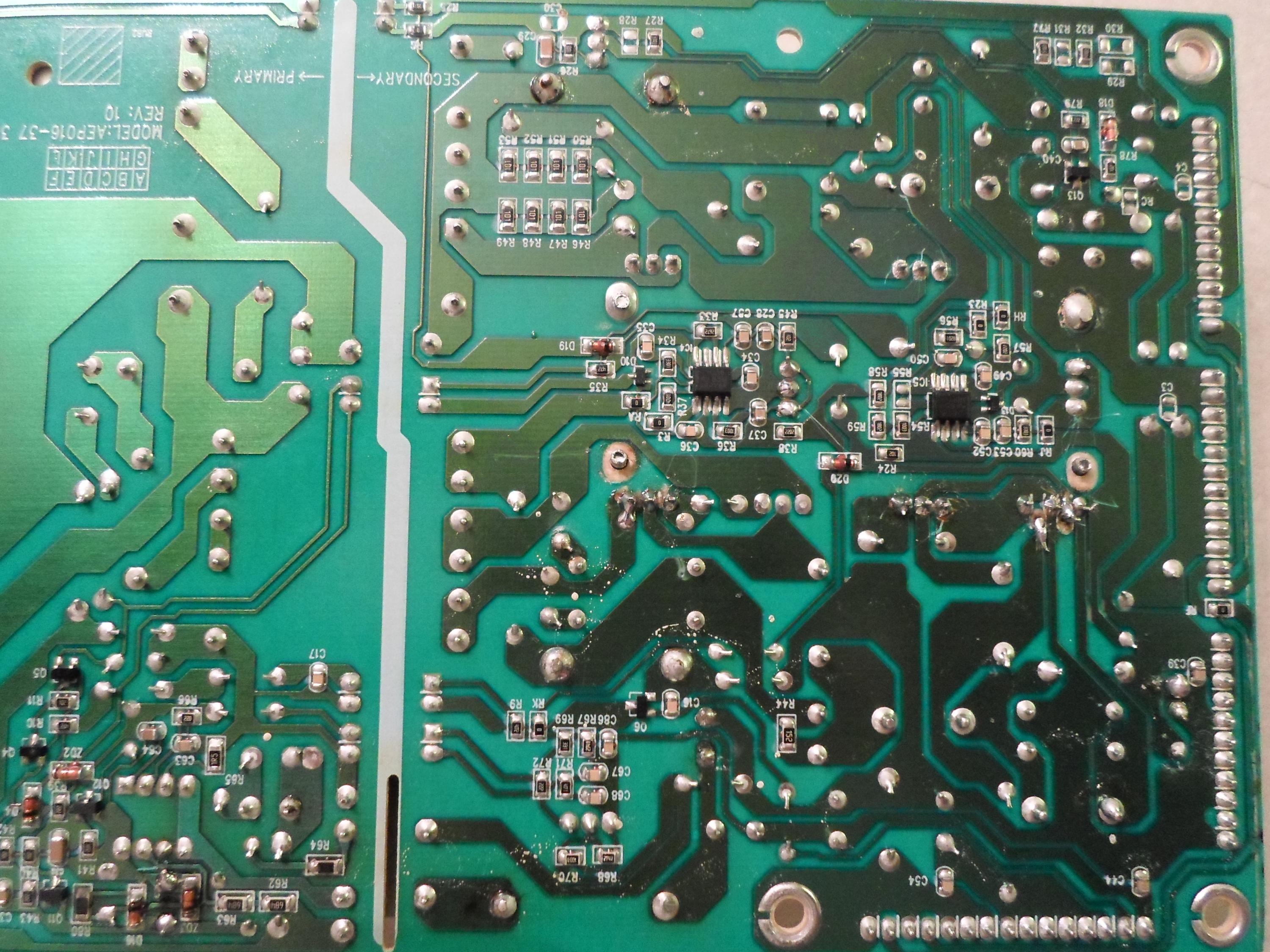

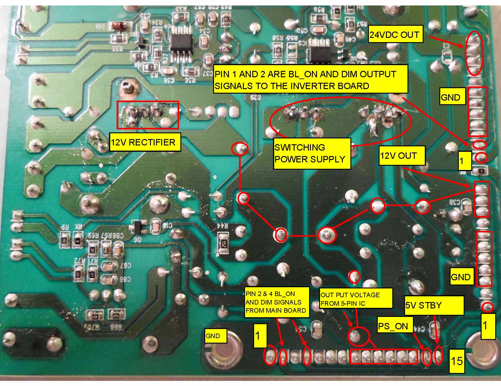

                  Here you go Bud, let me know if these are good.. Would like to find which pin is PS_ON..
                    OK, let me download all the pictures then I will be able to section out each section of the board.

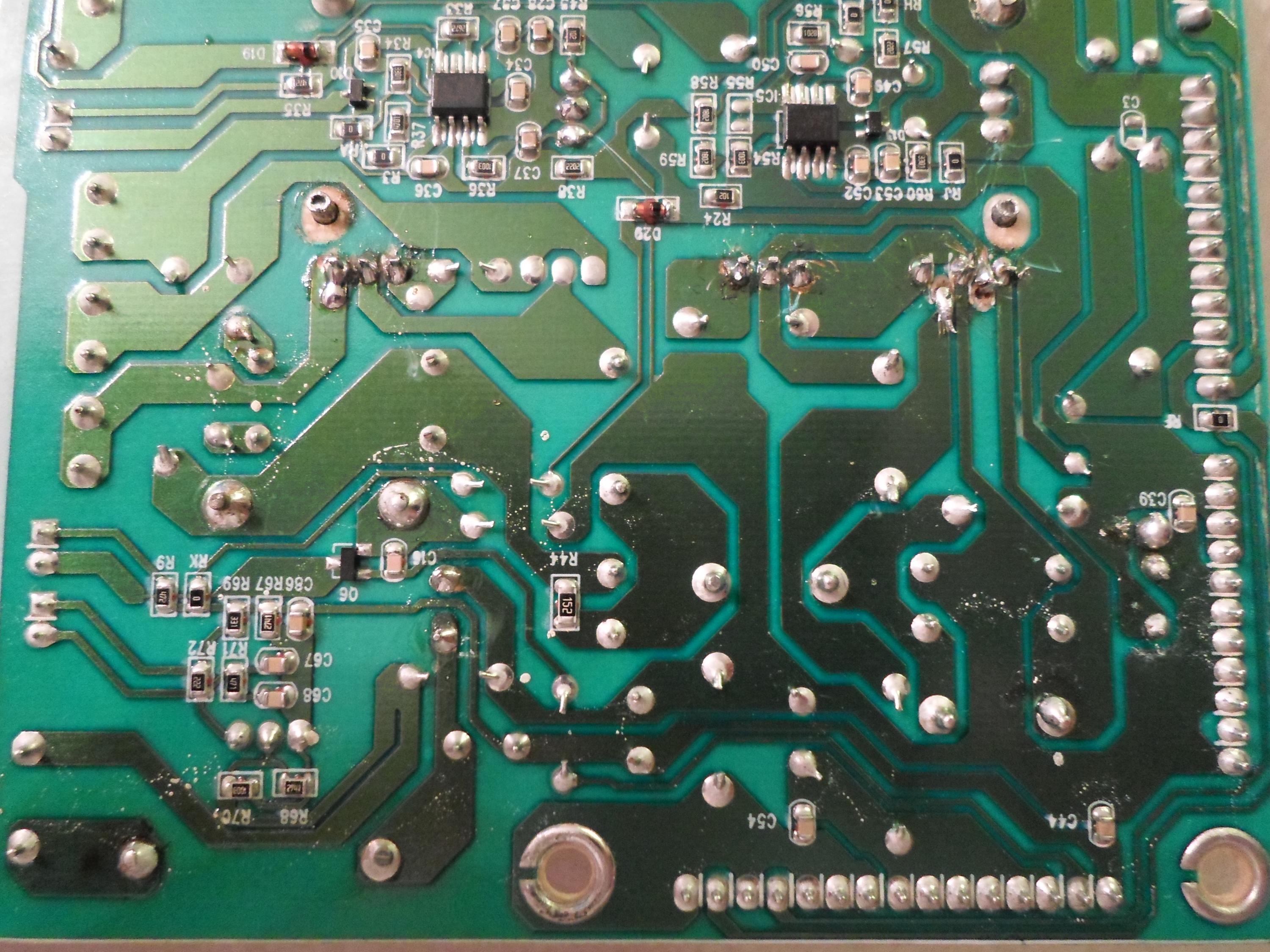

                    Did anyone work on this board before? I can see some damaged traces on the three devices mounted on the heatsink on the last picture (SAM_0481). The worst one is the device with 5 pins, the traces look real bad.
                      Yes I saw those too it looks like a few caps were changed and it was obvious that whole heat sink assembly was removed with the 2 diodes and that 5 pin IC. So I scraped back the board to get to the traces and put some more solder on the ones that were damaged.. The caps all seem to test good with the ESR meter but it does act like bad caps.. And I think the previous owner told me it started to turn on intermittently before it died but I can't remember for sure.

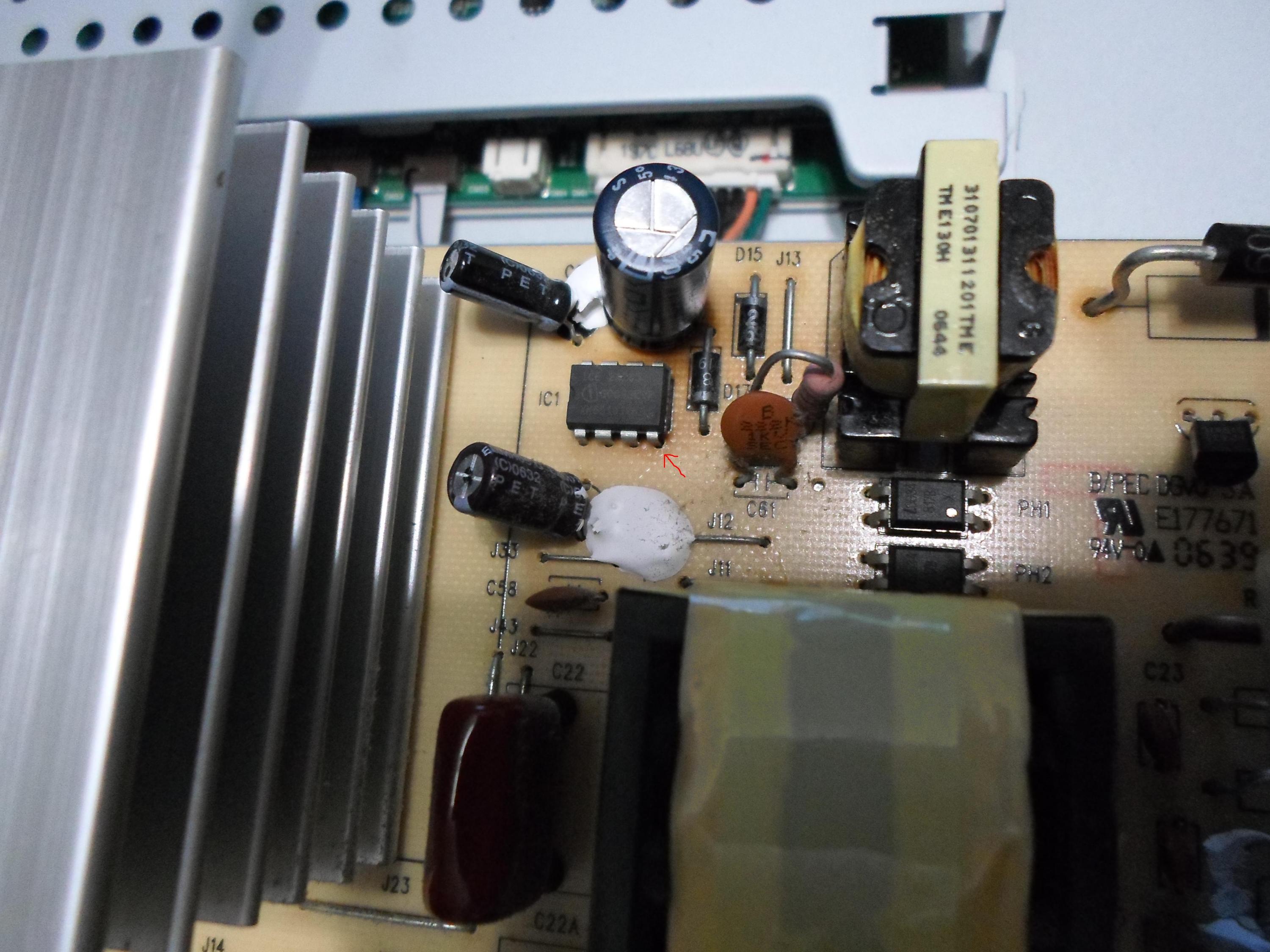

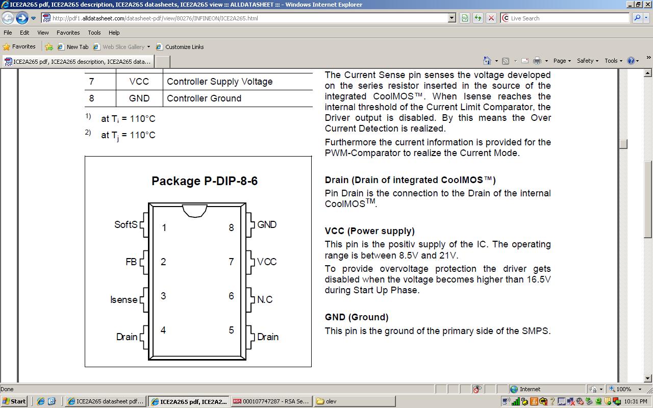

                        Also it looks like I didn't get a pic of IC1 (ICE 2A265) which I attached. I noticed when power TV on and off would get 166v/0v respectively on pin 4.
                        Unfortunately before I got datasheet to test the VCC...
                        http://pdf1.alldatasheet.com/datashe.../ICE2A265.html
                        I touched pins 3 and 4 by accident and -spark- followed by burning smell and light bulb is now on..
                        I will now need a new IC Based on the above does it now seem like a PS issue that is causing the missing 12v/24v voltages?

                          So it does sound like the power supply problem. The PS_ON is OK, since the PS has PFC voltage booster, so the voltage on the big main cap should jump up to around 380~400V.
                          Just have to wait until you get the new IC for the Standby power supply, should check all the devices mounted on the heatsink to see if they are shorted or not. You can also remove the ICE IC to see if the lamp will no longer glow.
                            I checked the 4 diodes on the large heatsinks beforehand, they tested good. That 5 pin IC Im not sure about but did not show a short. The large cap voltage never went above 168v when turned on. Do you know what controls the PFC to kick in? Is IC1 just the standby power IC then?

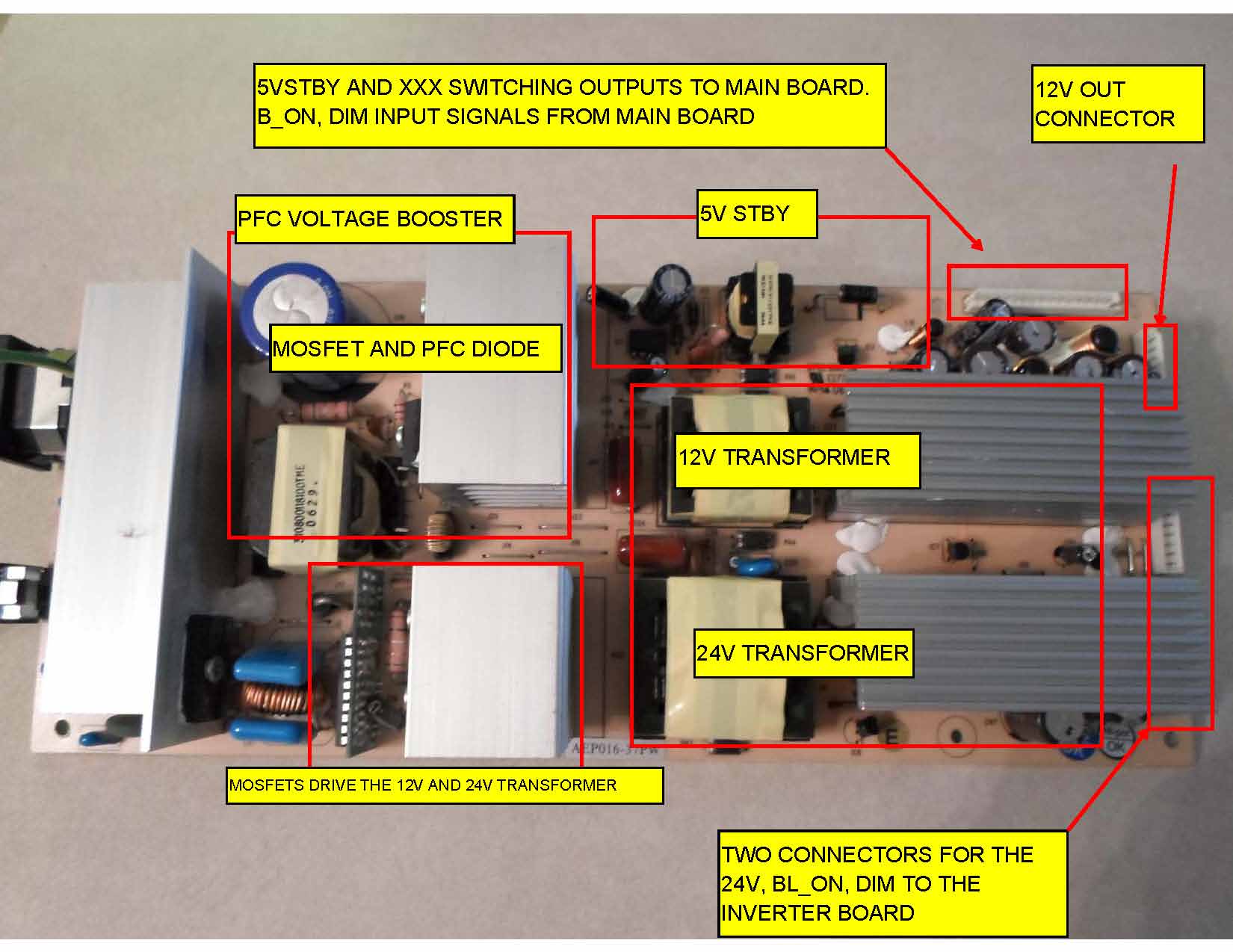

                              OK, I traced out the board just to see what is going on.
                              J101 (15 pins connector), if you look at the top, one corner of the connector is cut 45 degree for indicating pin1. The other two connectors are connected in parallel for supplying the 24V. The BL_ON (Inverter_on), and Dimming signal (these two signals are routed through J101 (pin 2 and pin 4) to PIN 1 and 2 on one of the two connectors (I cannot read the connectors numbers).
                              The third connector on the side is for 12v output to the main board.
                              J101 pin out:
                              Pin 1 is Ground (with 45 degree corner)
                              Pin 2 is either BL_ON or Dim (if pin 2 is BL_ON, then pin 4 is Dim). The signal comes from main board to feed this pin.
                              Pin 3 is Ground.
                              Pin 4 is either BL_ON or Dim, the signal comes from main board to feed this pin.
                              Pin 5, 6, 7 are Ground.
                              Pin 8~13 is xxV fed by that 5-pin Switching power supply IC (P/N???) on the heatsink.
                              Pin 14 is PS_ON
                              Pin 15 is the standby 5V output for the main board.
                              This is what I see on your board.

                                Thanks Bud that is awesome, it's like having the service manual!

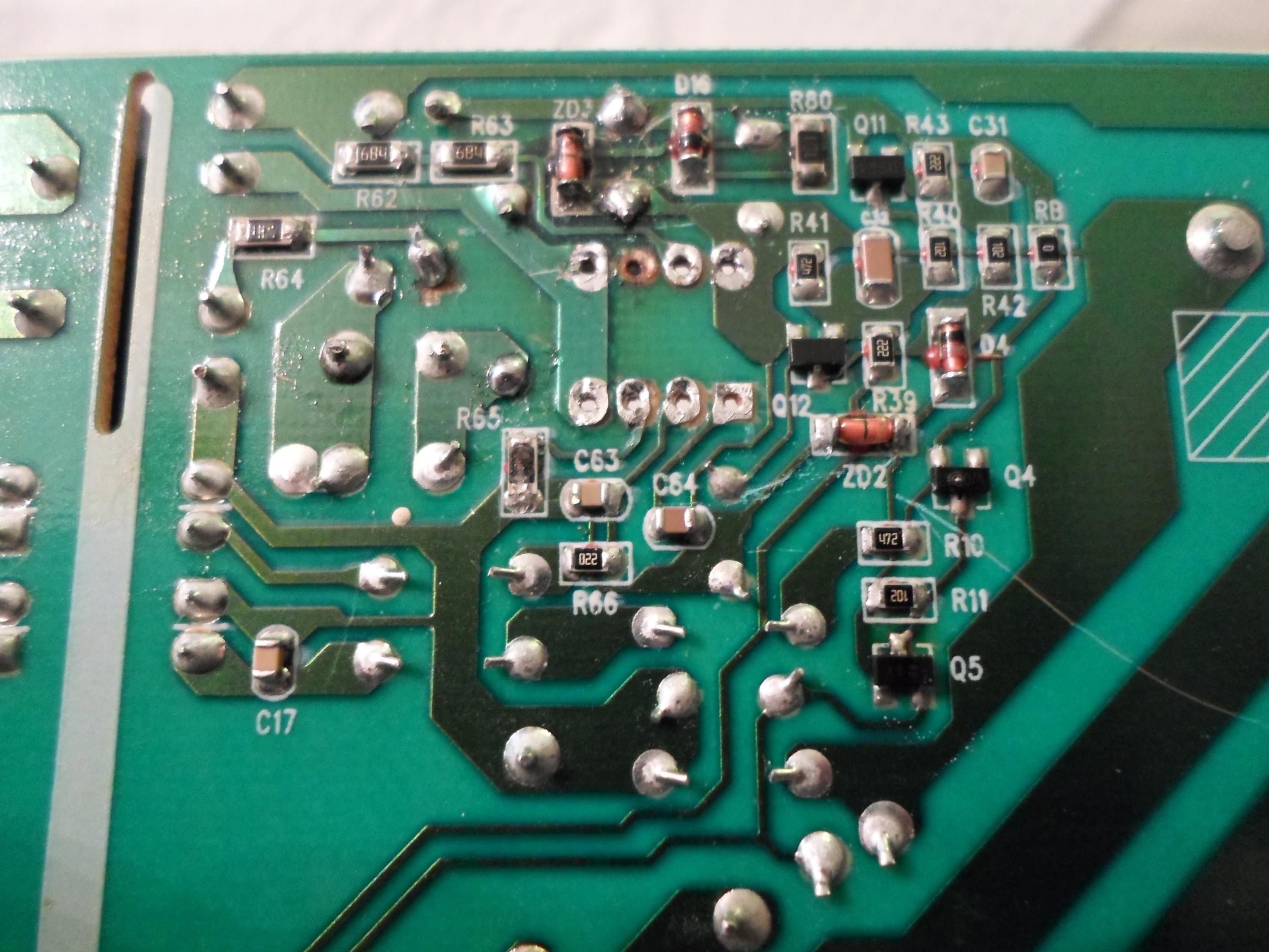

                                  Now I had already ordered that IC and all new caps for this board.. But look at this area around the IC on the bottom, there's some pretty good damage (probably due to my slip up).. R65 for one is open, and ZD3 and D16 do not test good in circuit, as they do in the working board.
                                  Do you think we can get this board going again, I have no idea what those diode part #'s are..
