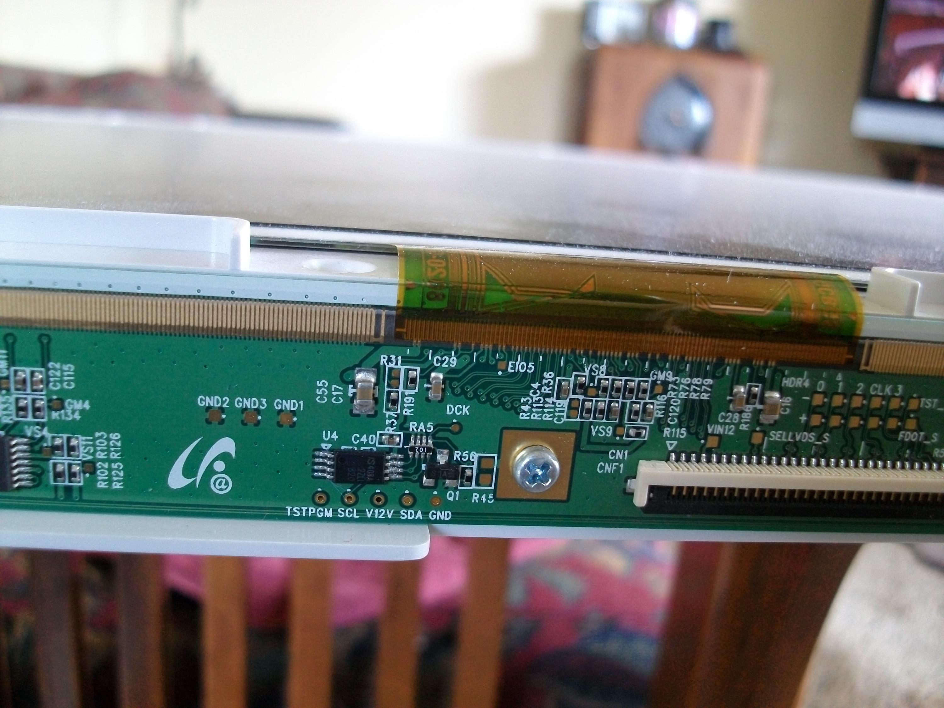

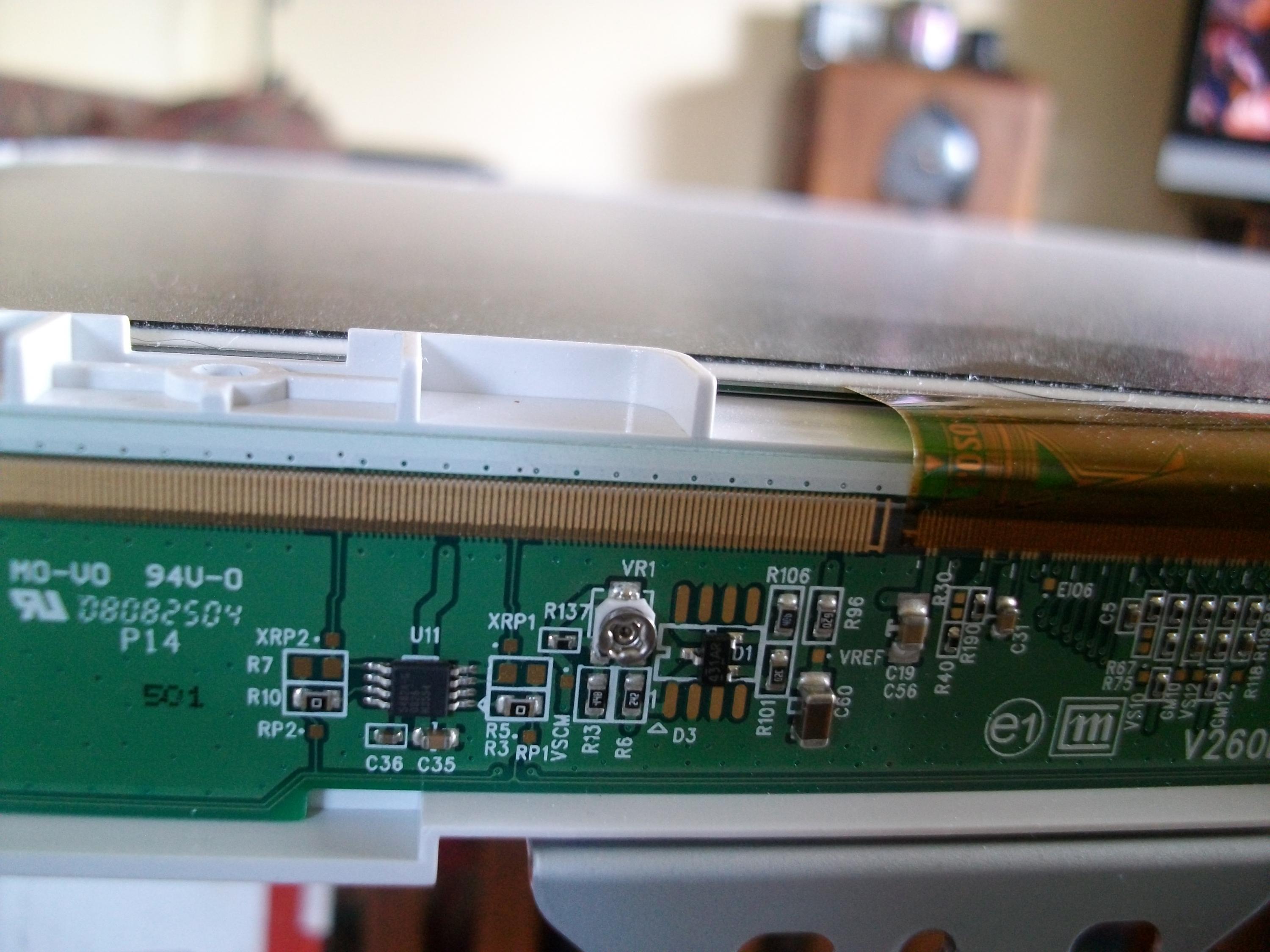

    Budm ,Got It torn down, I spotted this mosfet. discoloring on top of component. Here are the readings also see picture

      Forgot to post picture

        Here's the number on the mosfet .
        S408A
        2ZL1
        820

          Need to search for the pin out.
          • CR Designs
            • Dec 2012
            • 430
            #45
            Re: Vizio 26" VW26L Flickering white screen
            O.K budm you lost me on the pin out. I'm still learning this stuff.
              #46
              Need to search for the spec sheet of that IC which will tell us what the pins are for that IC.

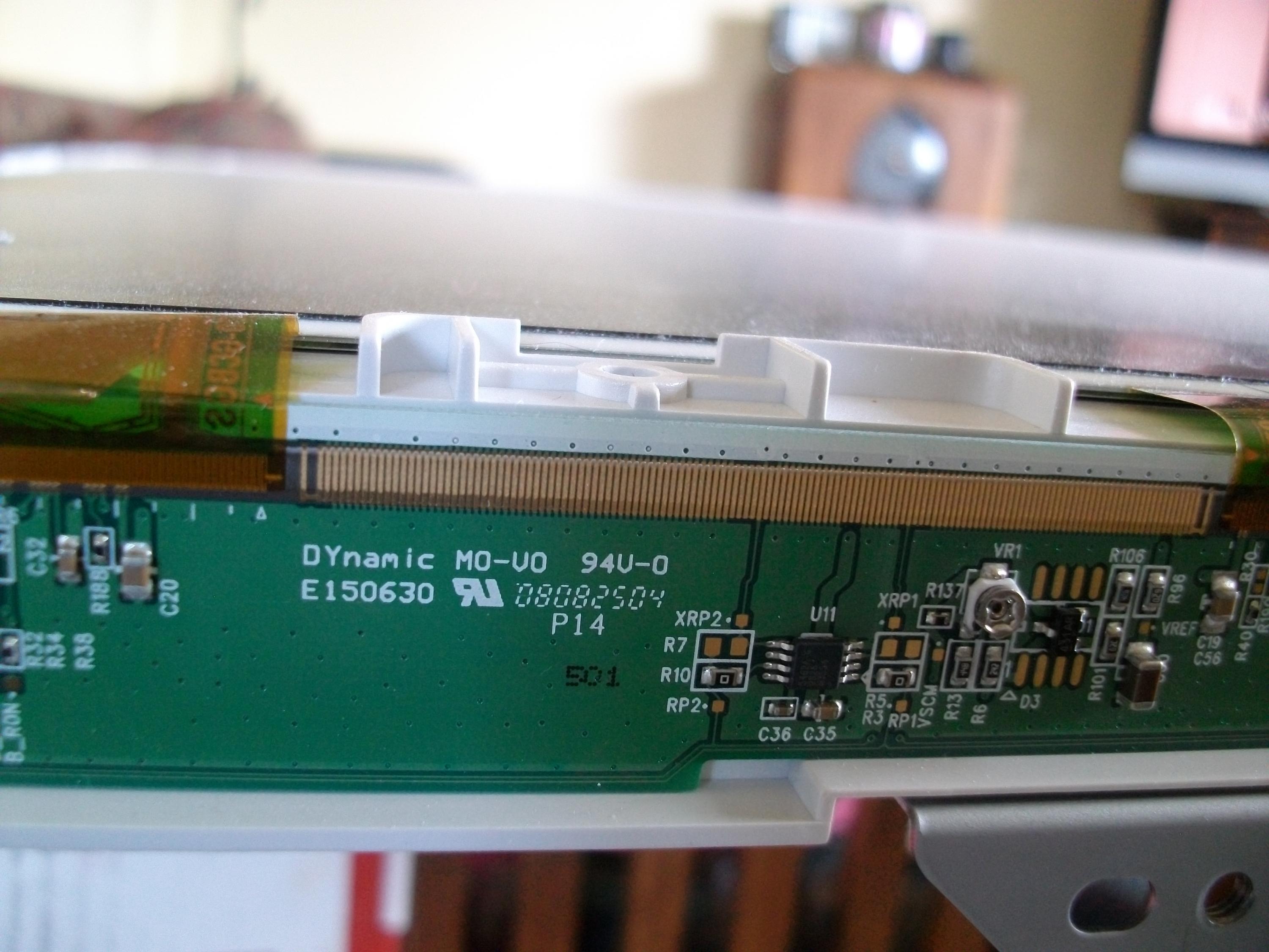

                  Can you check the number - perhaps post a close up pic showing it, as I cant find anything.
                    selldoor,I will get a picture. I have been looking also no luck

                      #50

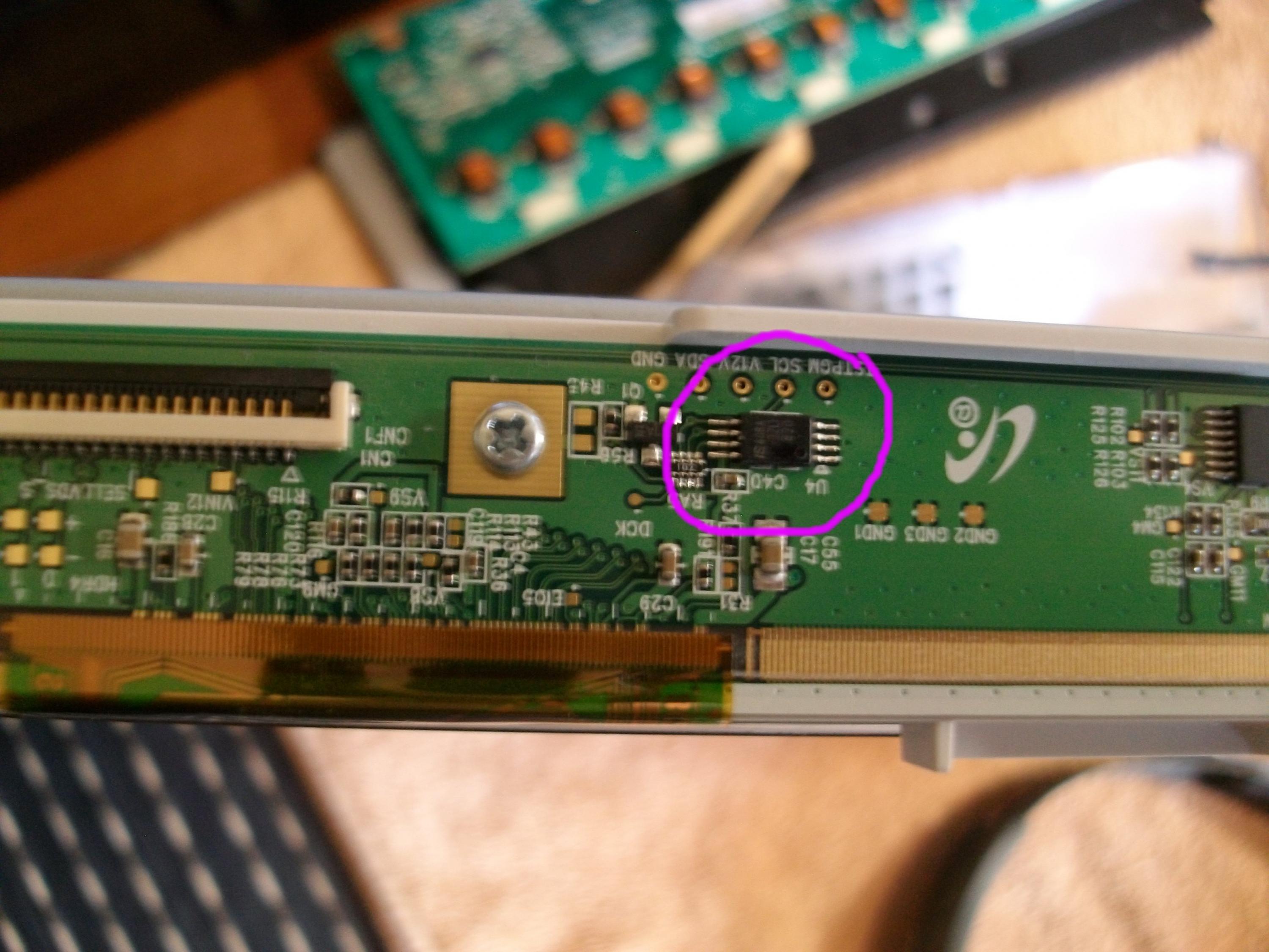

                      Here's the pictures

                        Can you try cleaning it with Isopropyl alcohol see if any more letters?
                        It may be proprietary part
                        Any more the same on the board?
                          Selldoor, Cleaned the component off This is the number.
                          /S408A
                          2ZL1
                          820
                          looks like a slash mark in front of the S. I can see the number very cleanly now.

                            #53
                            Only one on this board

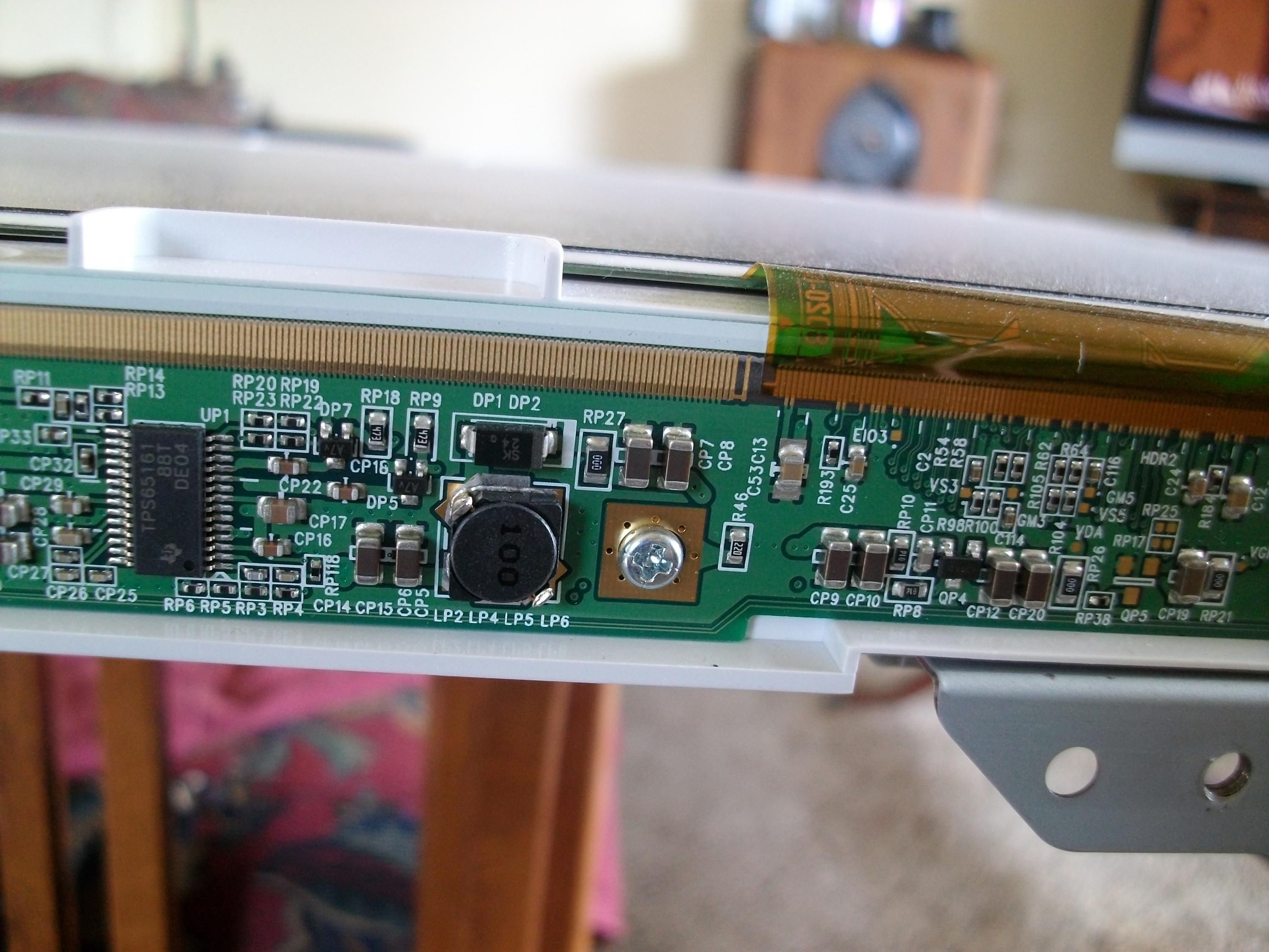

                              Found this http://www.aliexpress.com/item-img/5...464161981.html
                              So IS looks like the manufacturer logo. and the middle line might be 2ZLI not one - Good Hunting

                                Im going to be in trouble now!! - cant leave it alone!!
                                http://www.alibaba.com/product-gs/54...408A_2ZLI.html
                                You could try and contact and ask for a data sheet but I think it could be a site that
                                just builds on your enquiry to make you think they have got one. Who knows?
                                  What you have there isn't a MOSFET or any kind of power device, it's an EEPROM memory. Dead giveaway are the SCL and SDA testpoints right next to it. IS is the manufacturer logo - ISSI made it, and 408A is their code for 24C08A in TSSOP package.
                                  Search for 408A in this PDF and you'll see i'm right. Sadly, i don't think that's your problem.

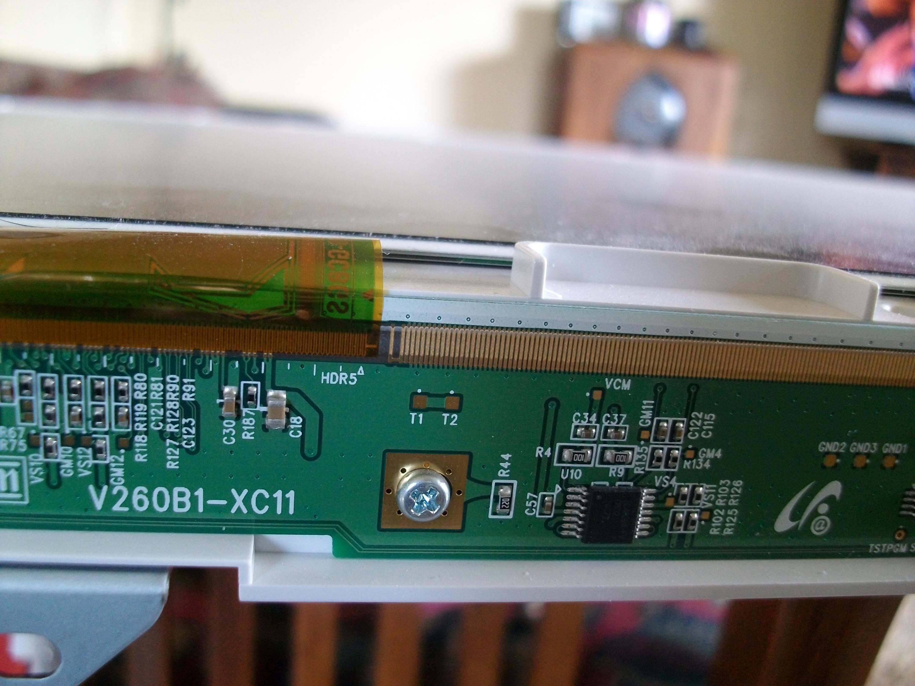

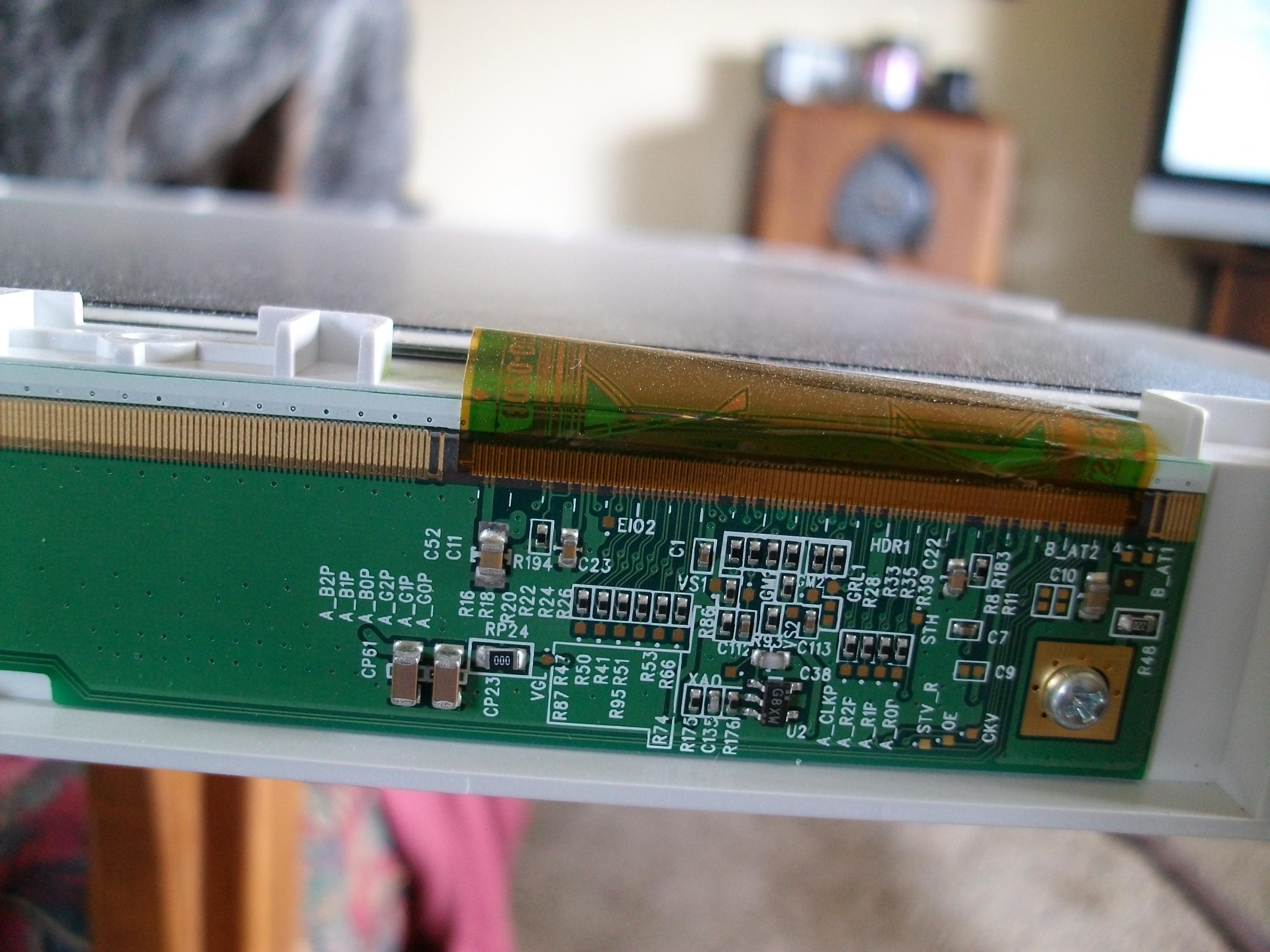

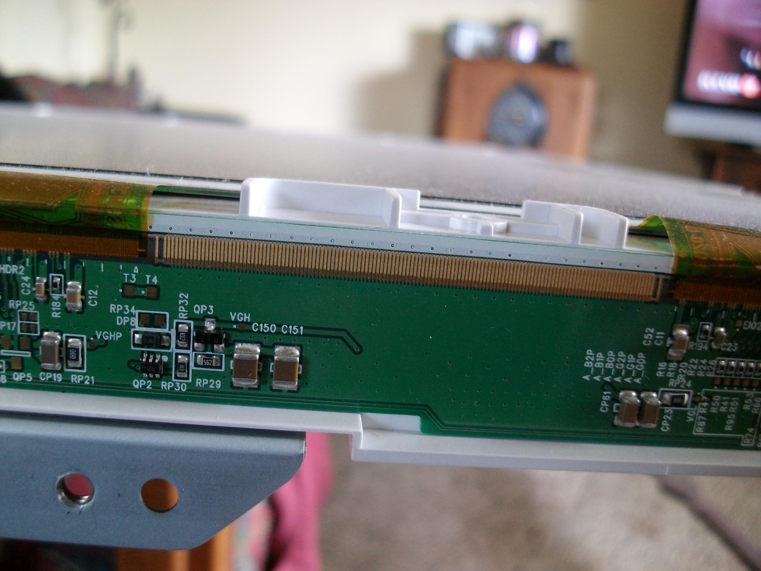

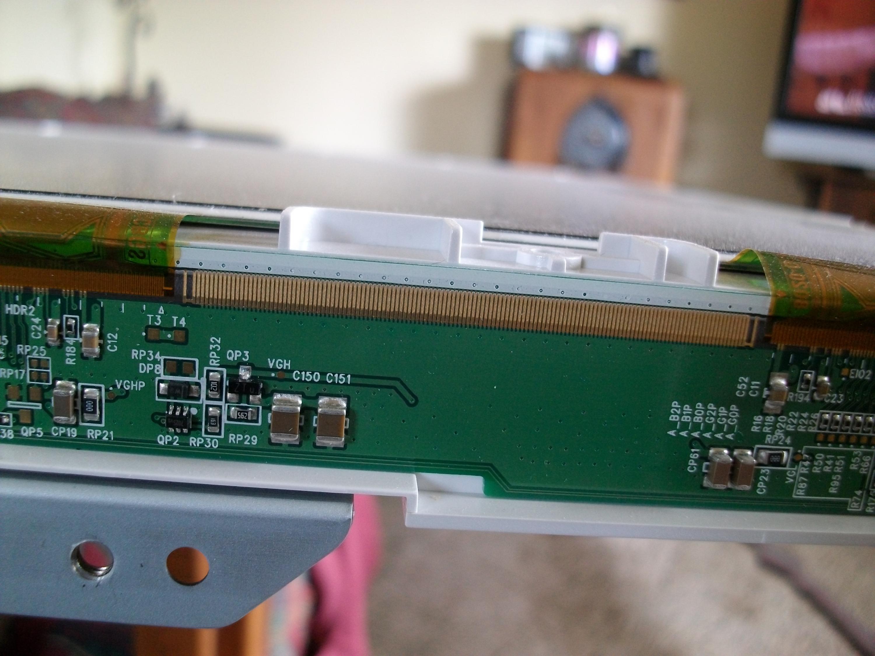

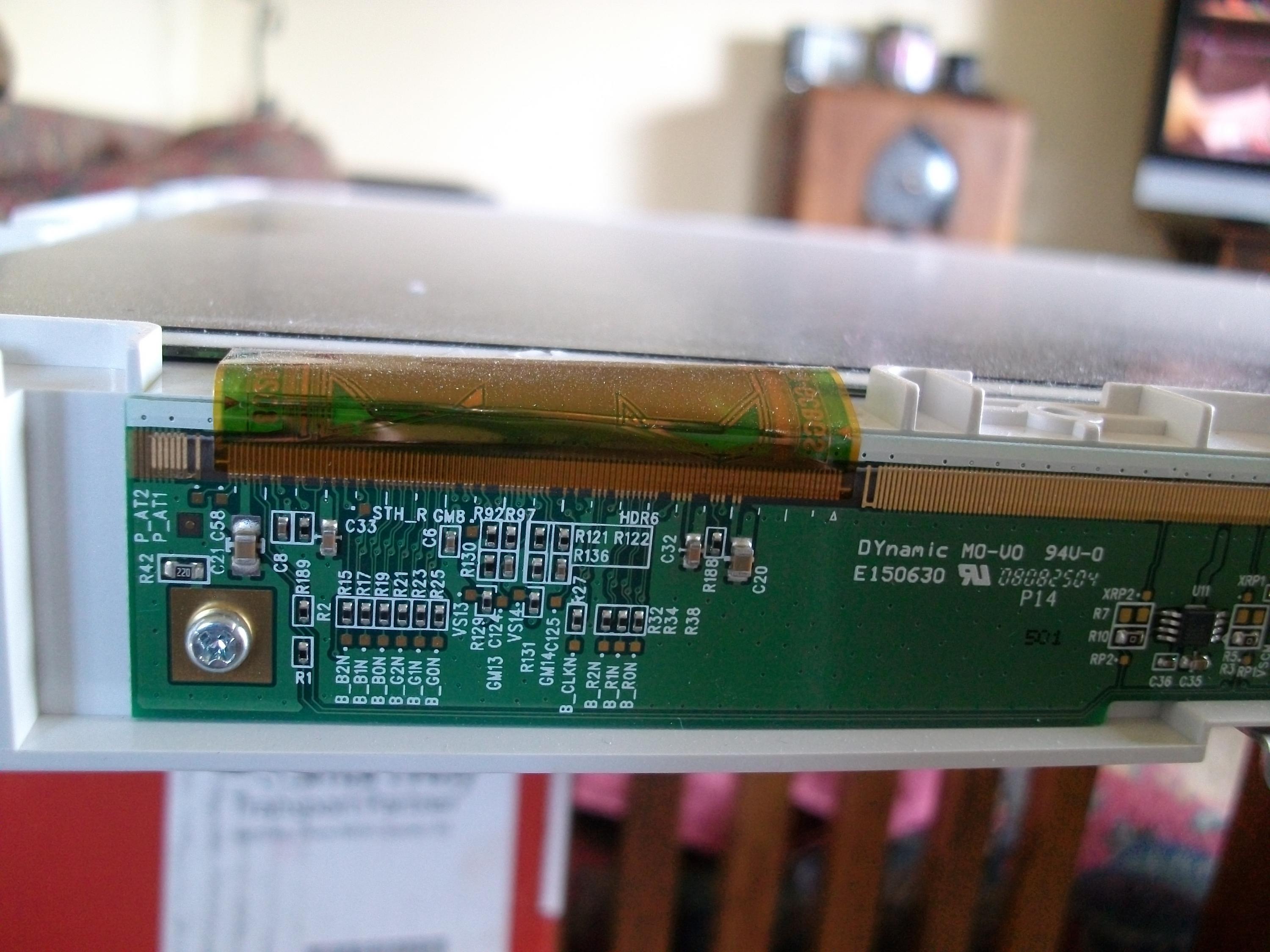

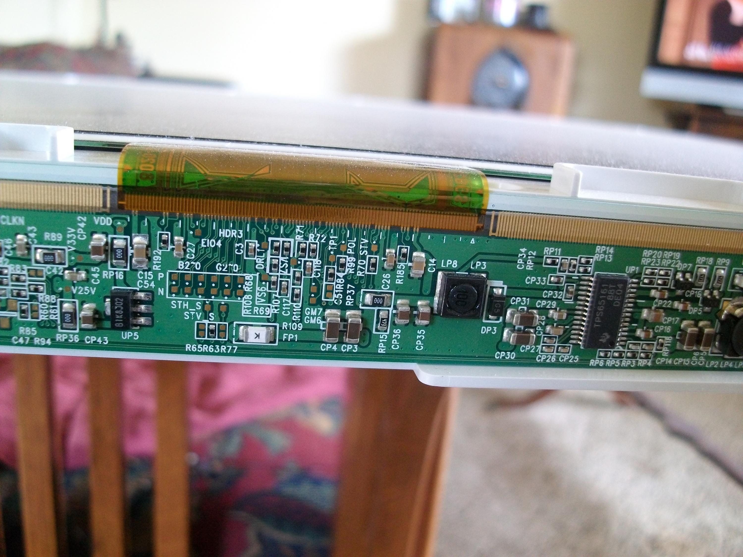

                                      In focus picture of the rest of the TCON in as many pictures as it takes to get
                                      it a decent size. Retest the fuse now you can get at it.
                                        selldoor,here's the pictures

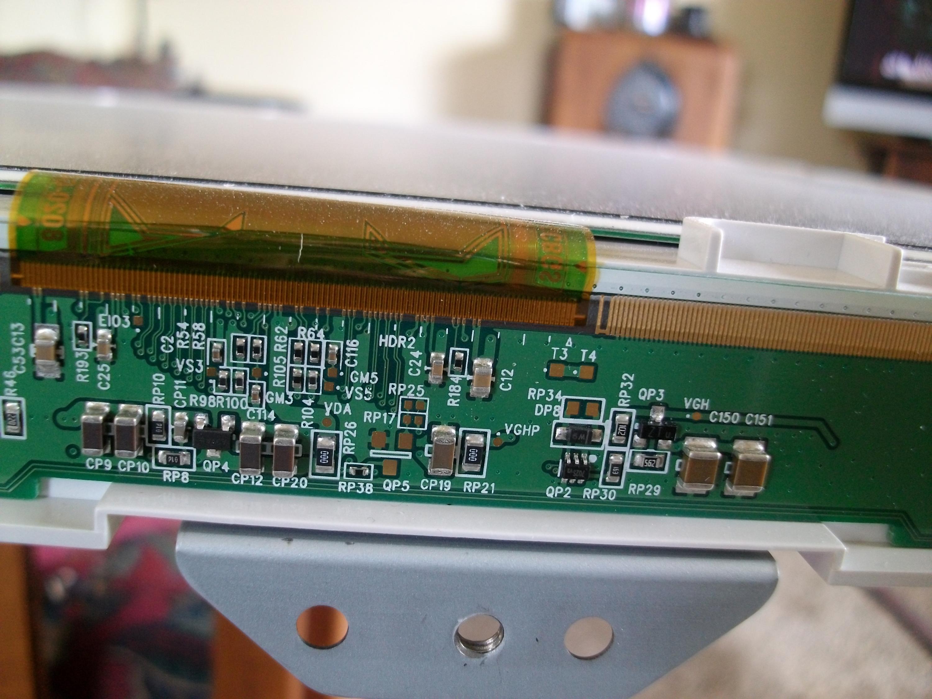

                                          #60
                                          Last 2 pictures
