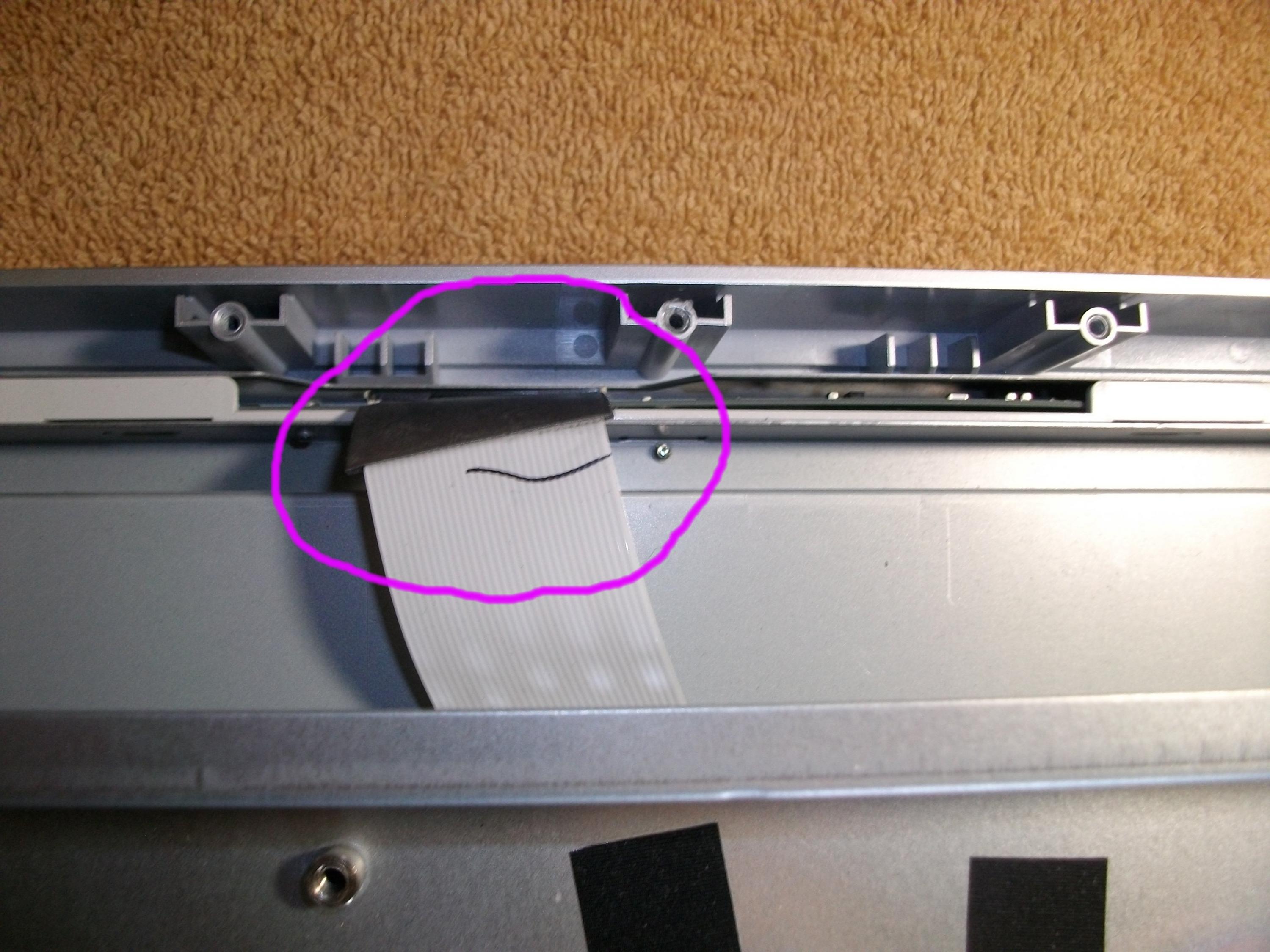

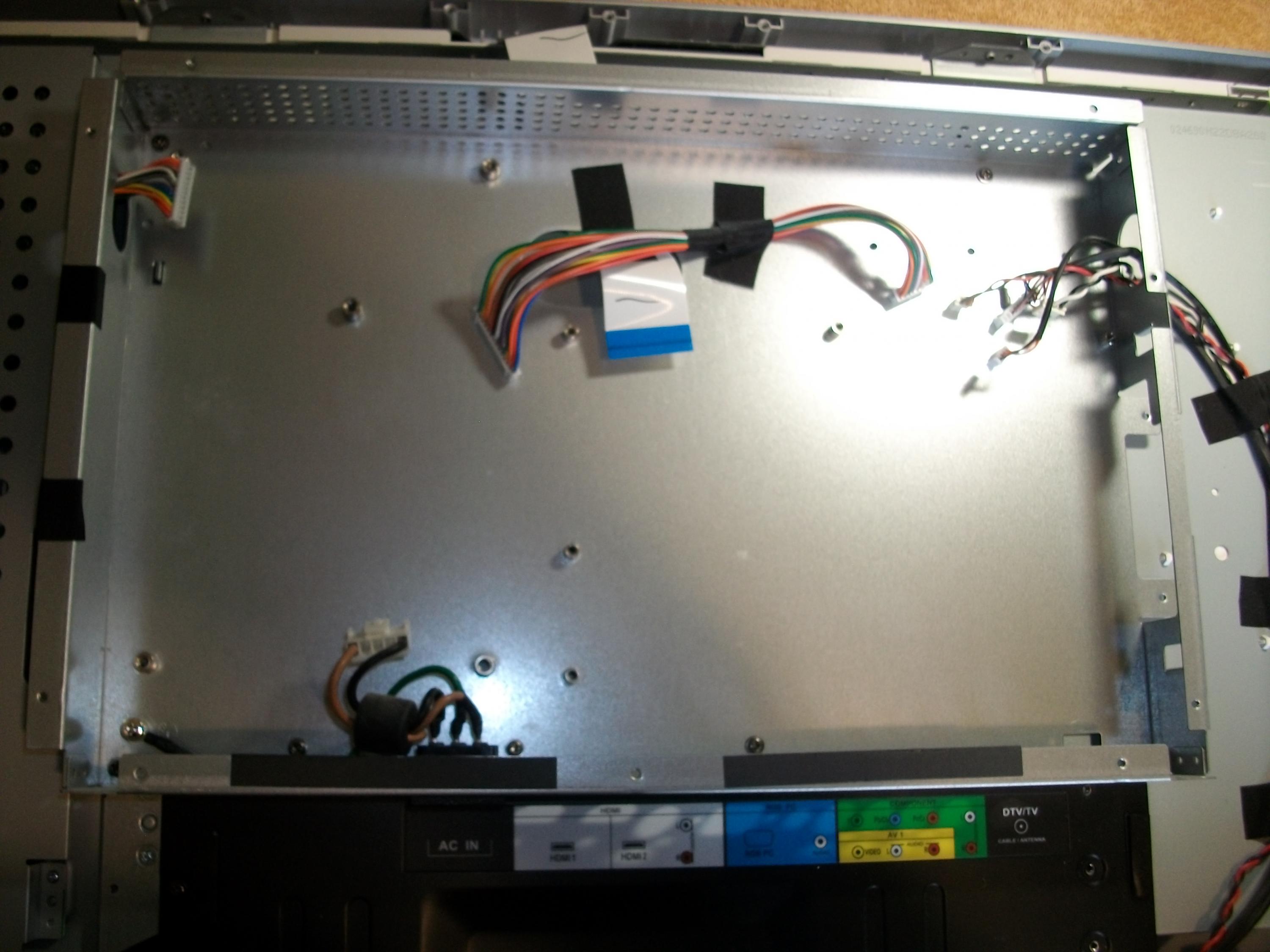

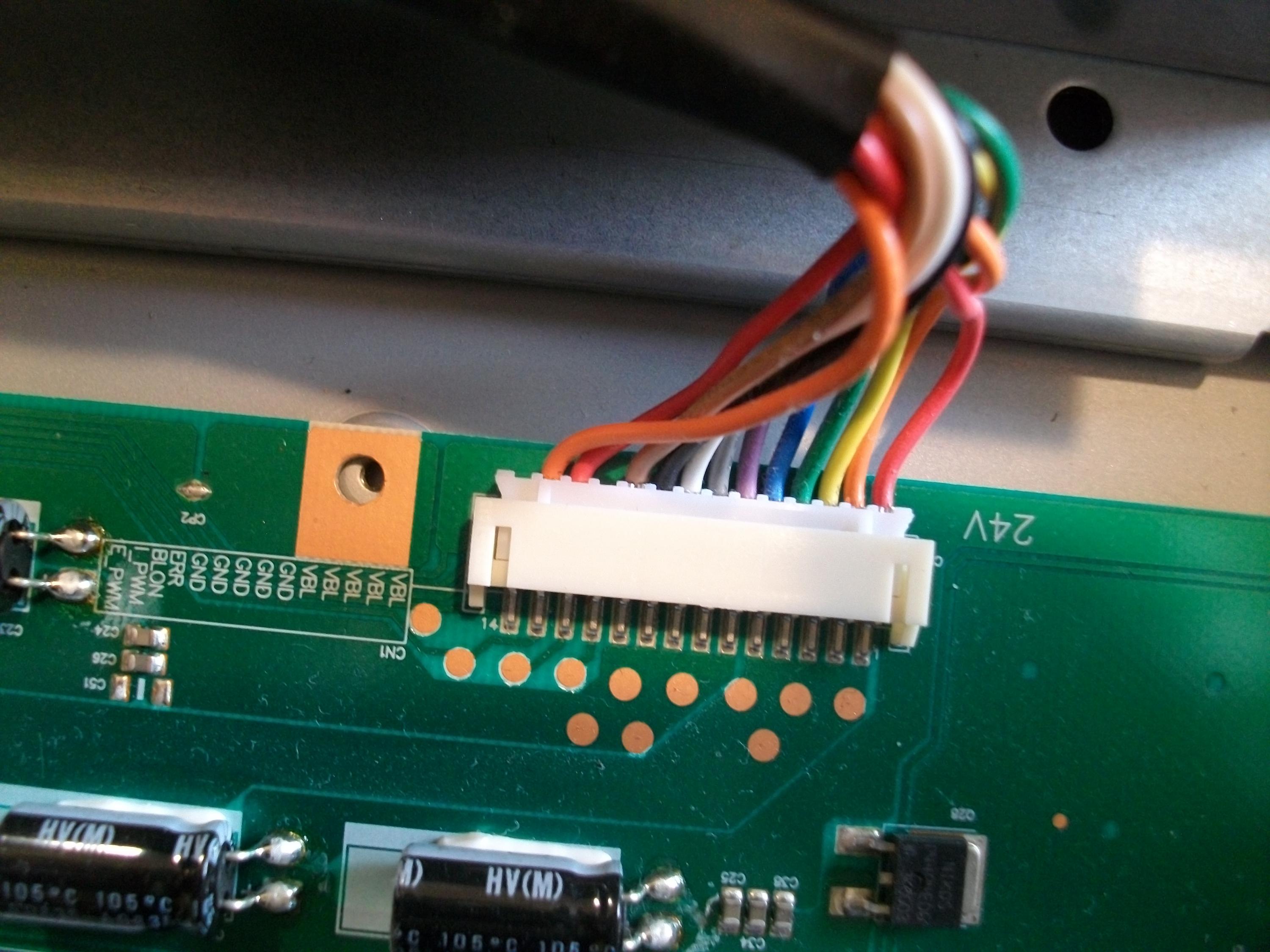

                    Budm, Here's some pictures you wanted of LVD also picture of tear down. any ideas on how to remove the board I circled it in the picture,Thanks

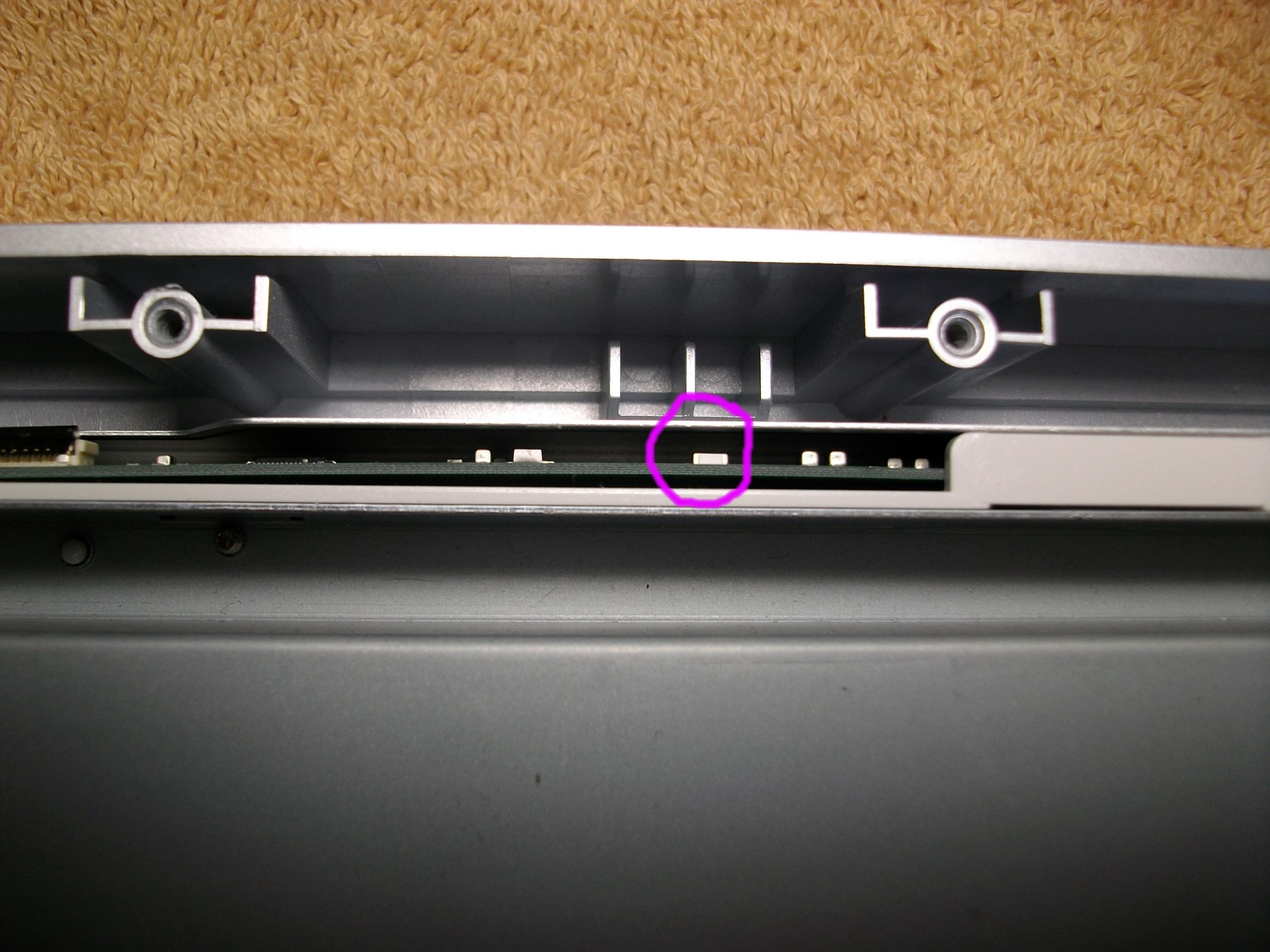

                      Bud wants a picture of the area of the board (Top left Corner in the out of focus picture) where the Flat LVDS plugs into the main board.

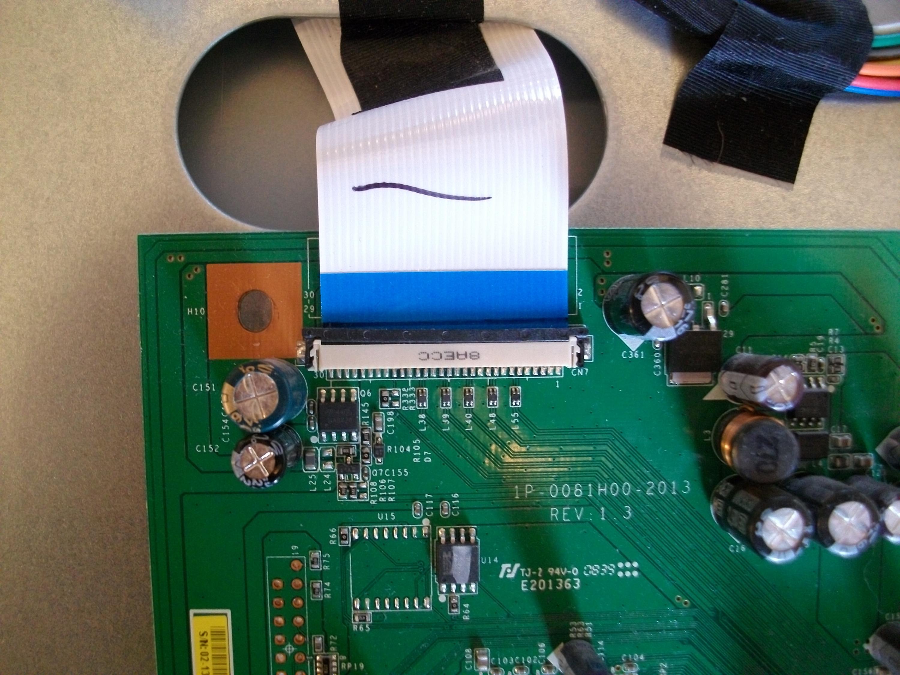

                        Selldoor thanks for the help ,is this the picture budm wants?

                          I think so and perhaps the part number on that Q6 8 legged component.

                            Selldoor Here's the number 4405 BA8Y24
                              #34
                              Re: Vizio 26" VW26L Flickering white screen
                              That is the one, Q6 is the MOSFET for supplying the swithced B+ to the T-CON. Check the DC voltage on pin27, or 28, or 29 of the connector (chassis as ref ground).
                              When TV is off, you will have 0V, when TV is on you should have either 5V or 12V (depends on the LCD panel design).
