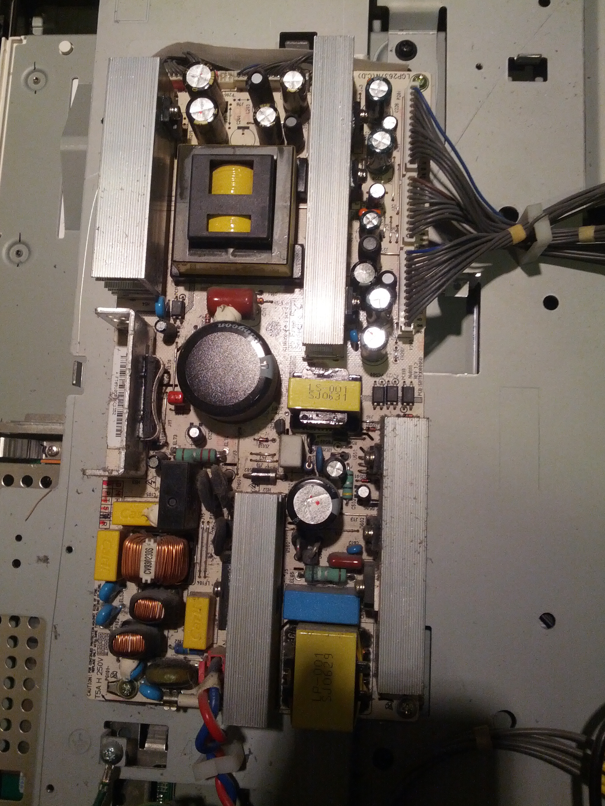

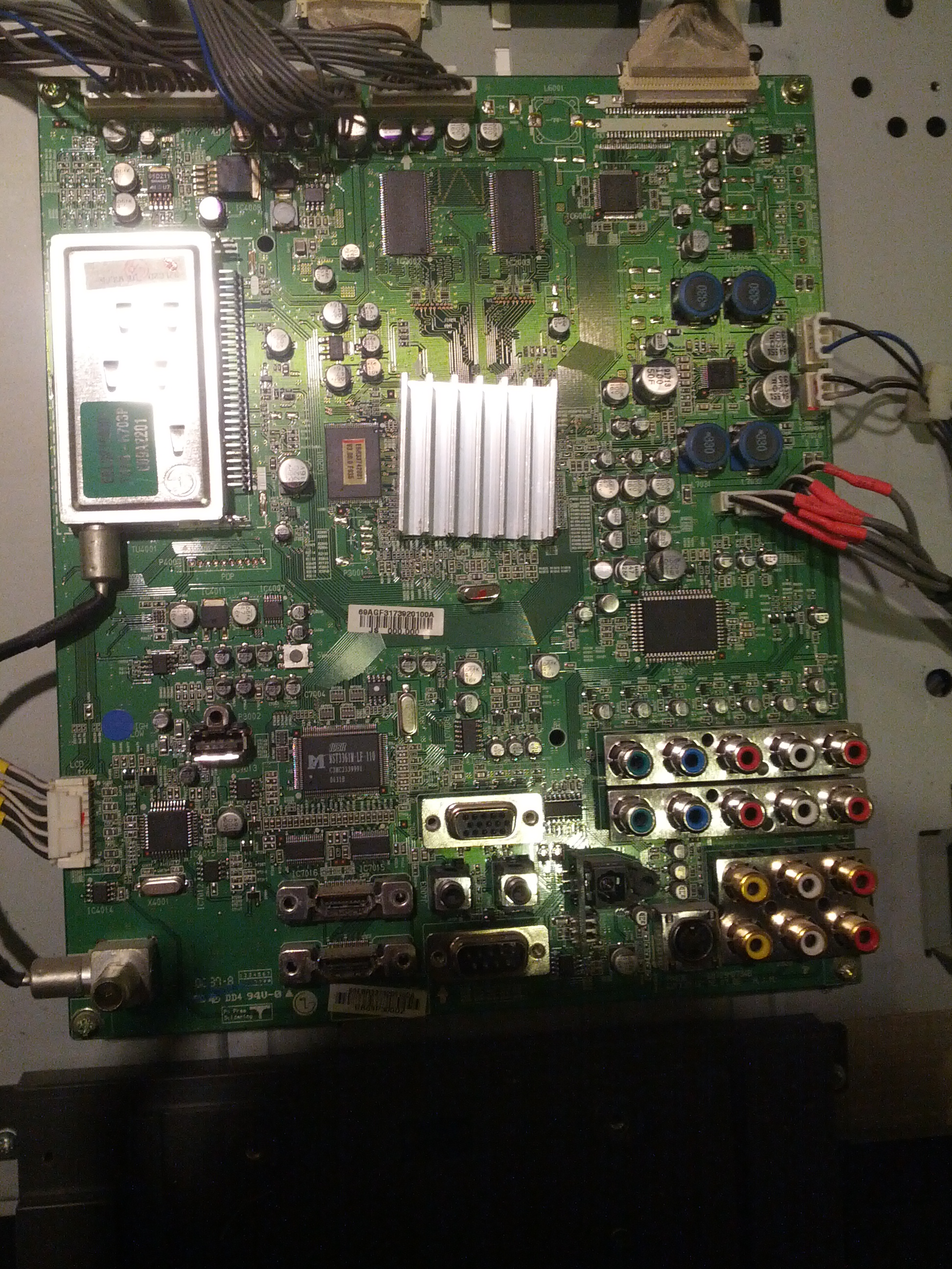

    Re: LG 32LC2DU "Keeps Shutting Off"
    Finally here are the pictures there is one bloated cap on the power supply. I think everything else looks fine to me. The tv will power up and work just fine at first it will play just like it should then it will shut itself off. When you turn it back on the green power light will just keep blinking. There is no faint image on the screen it is just black. If you let it sit it will work but never stays working long. Is that one cap the problem?

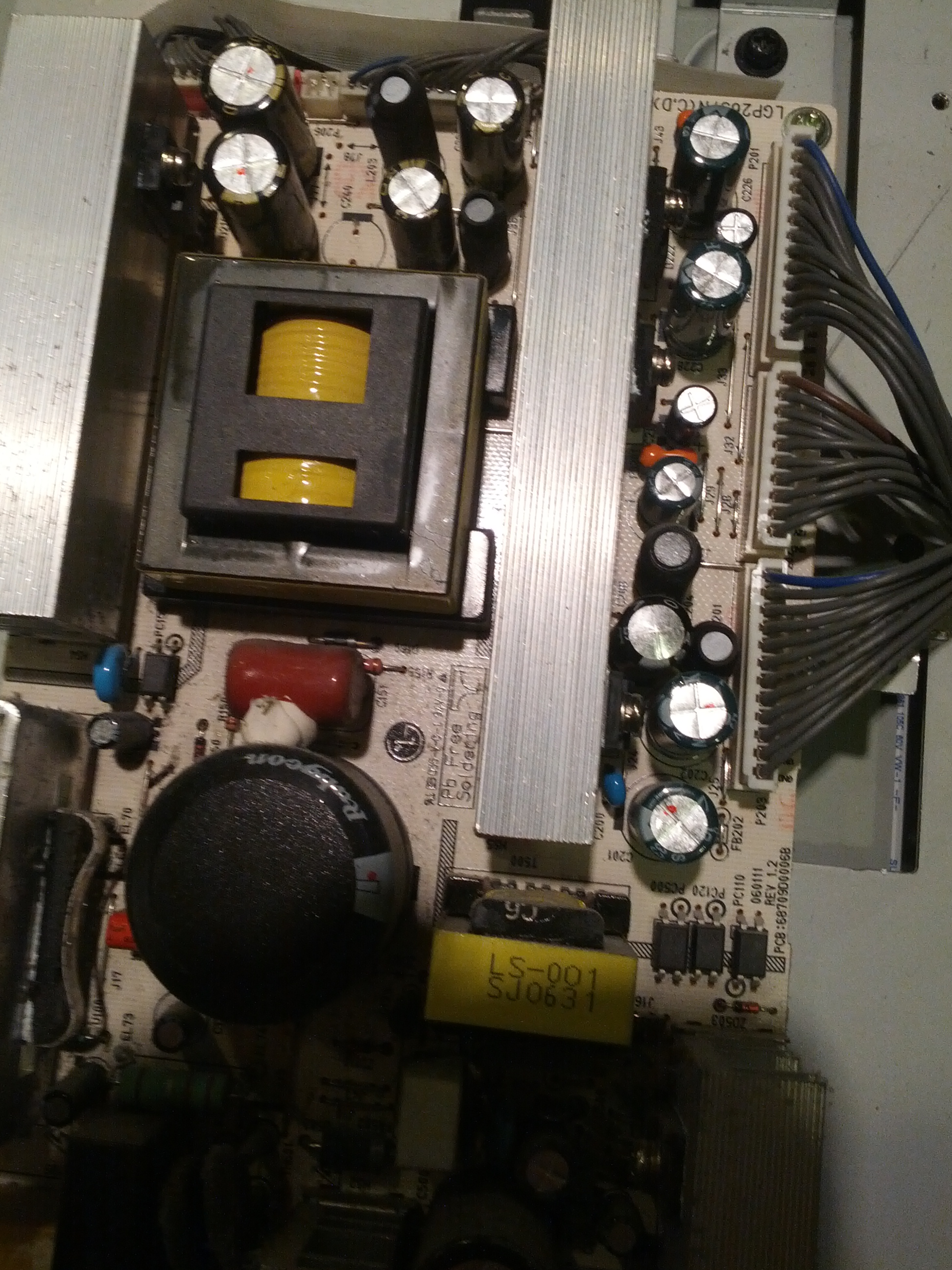

      here is another photo
        Bad caps should be replaced first before going further since bad caps can cause bad DC readings, unstable DC, etc.
        If I were you I would replace them as a set, the big cap in primary side can be left alone for now. Make sure to use low ESR type caps. I use PANASONIC FM/FC/FR series from DIGIKEY.
            Got the caps today and replaced them had the TV hooked up to the Xbox and used it for about an hour without any shut offs or any disruptions. The TV also turns on normally now without blinking alot. So far it looks like another one is resurrected. Thanks for all the help.
