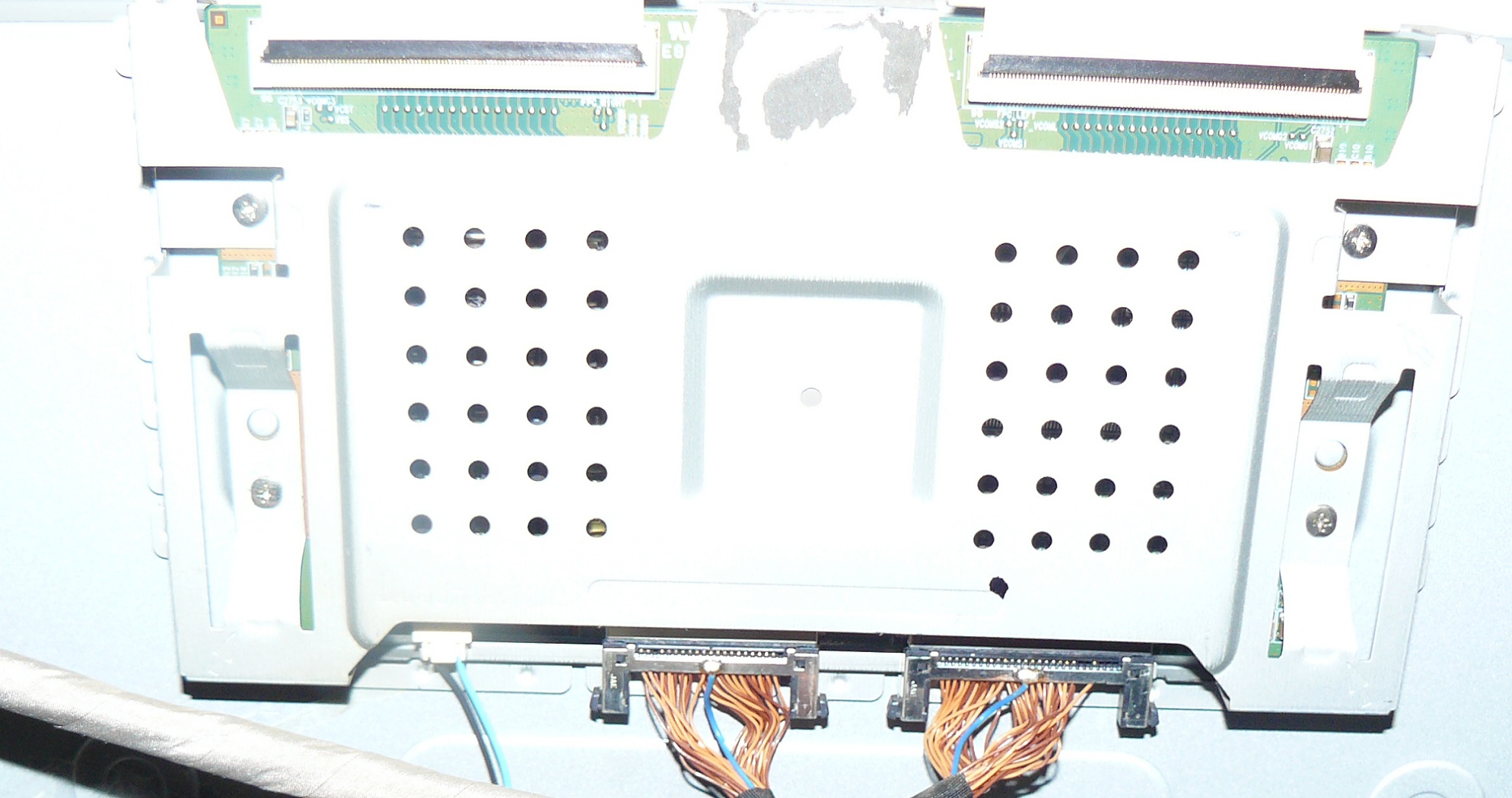

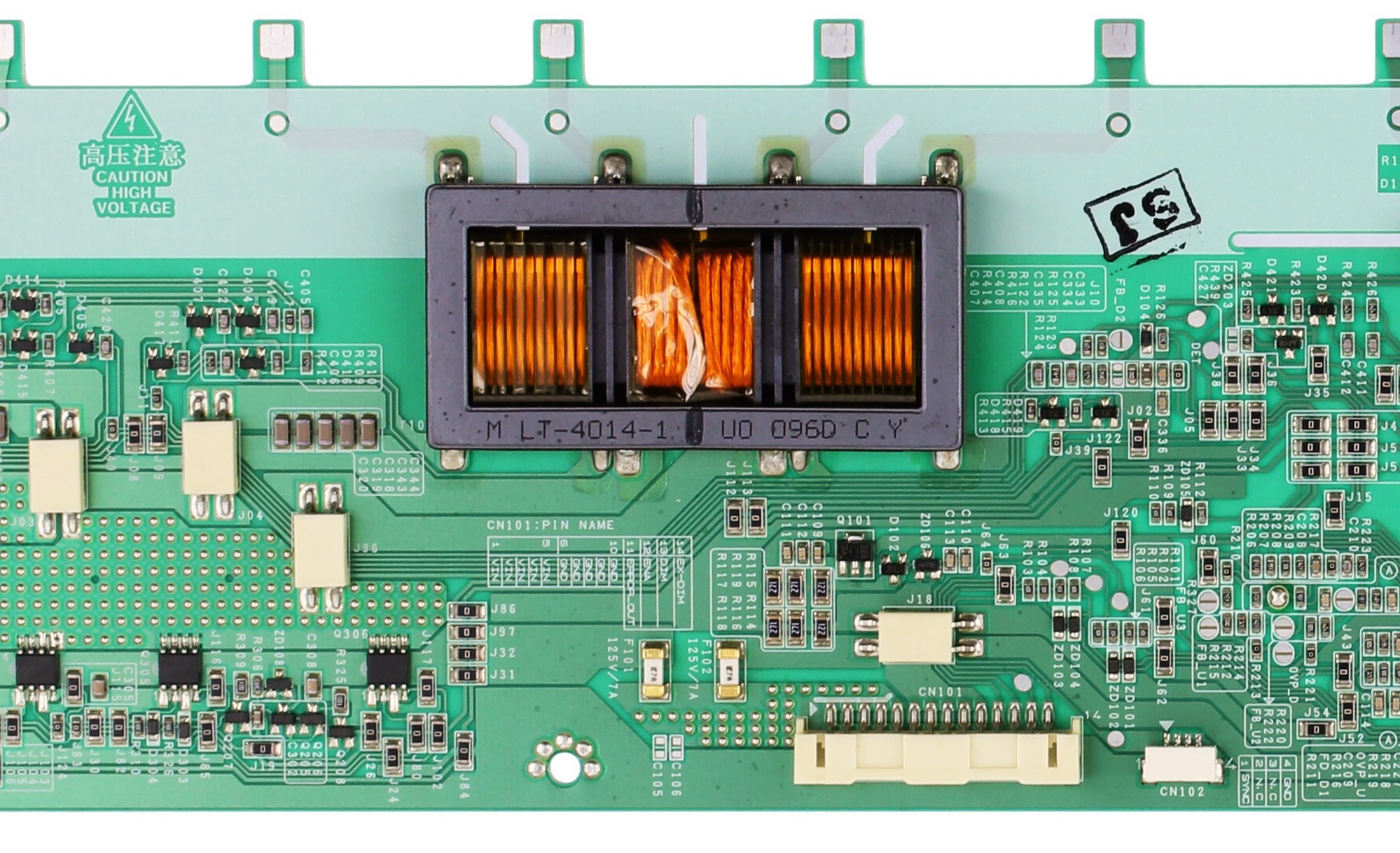

    I picked this one up a few days ago. It had sound but no backlight (not even a flash). Putting my brightest flashlight on the screen showed an image. I thought this would be an easy deal. The inverter board that's in the tv is a samsung LJ97-02098A.

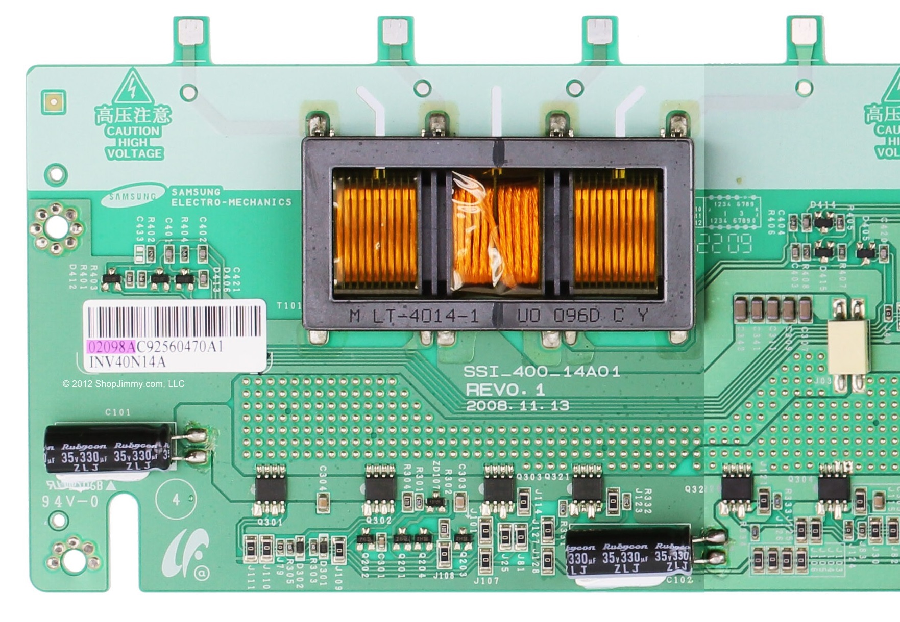

    Now i have a cracked screen 40" proscan in my basement with a LJ97-02098B. Shop Jimmy shows these 2 inverter boards to be compatible substitutes. I tested the proscan a month ago when i got by letting it run for several hours non stop and it worked perfectly. So i pulled the inverter and swapped them out. The tv fired up backlights and all. I thought done....Wrong
    When the tv is cold (off for several hours) The tv will turn on for about 3 minutes. But after that 3 minutes its on for 10 seconds then fully power off then turn back on. It keeps recycling until i hit the power button. If i unplug the inverter board the tv will stay on. There is still an image so the rest of the tv is working.
    The inverter has a 3-4 wire plug that goes to the tcon. Could an arcing bulb cause the tcon to tell the main board to shut down or do you think its a heat issue. I know this inverter is good but i can always put it back in the proscan and see if it's still working correctly.
    The panel is a LTA400HF02. I got the datasheet but i don't know if it has circuit protection built in. Just wondering which direction i should go with this.

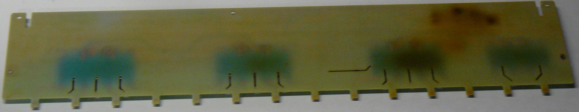

                    The original board was burnt. 1 fuse and 2 mosfets were shorted. It had some obvious browning on the back side of the board where the 2 mosfets sat.

                          Re: Toshiba 40XV645U shutting itself off
                          That means may be sone kind of lamps over current sensing may be happening, try going down as low as possible to see if it will stay on longer.

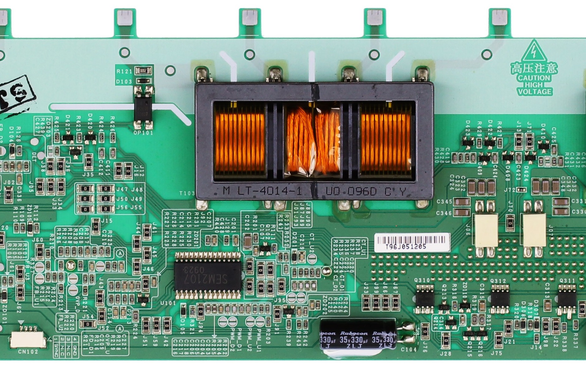

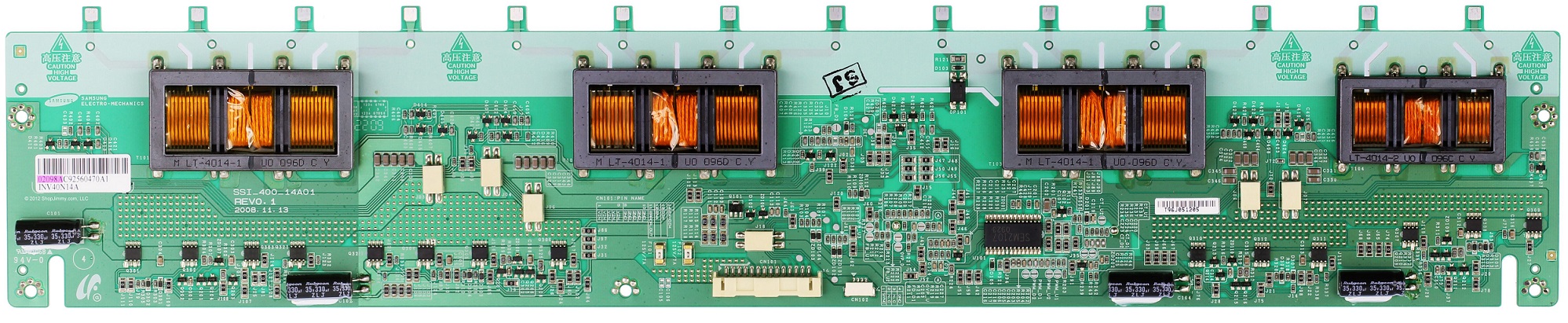

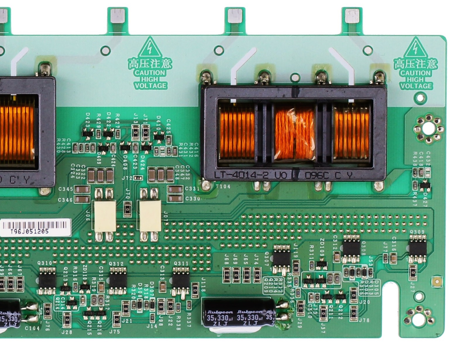

                          I need good close up of the whole Inverter board and also close up in 1/4 section so I can see how the current sensing circuits are setup.
                                    Bud
                                    All 4 transformers are about the same temp.
                                    I pulled another inverter from a working 40" dynex and the tv still shuts off.
                                    I even went as far as removing the lcd and swapping the backlights since i have a broken screen 40" that uses the same inverter and still the same result.
                                    If the inverter senses a fault does it tell the tcon board via the small 2 wire plug to shut down?
