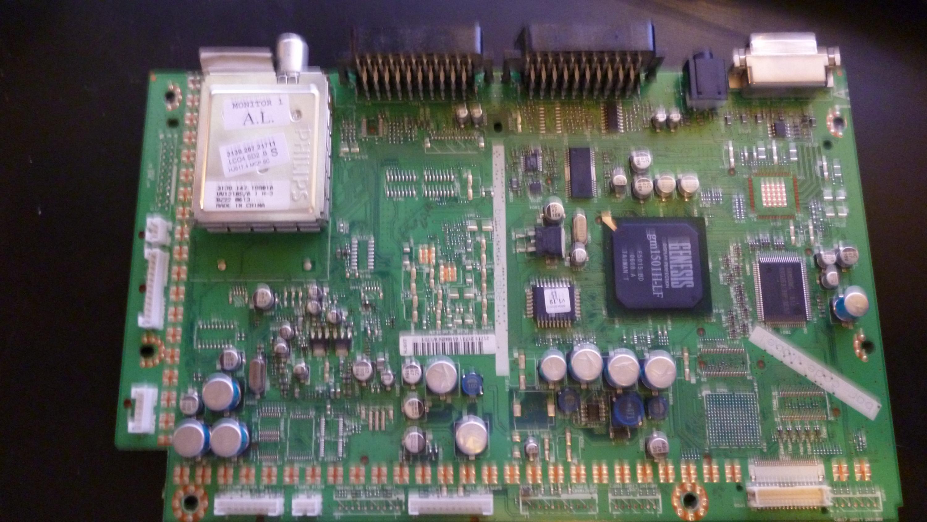

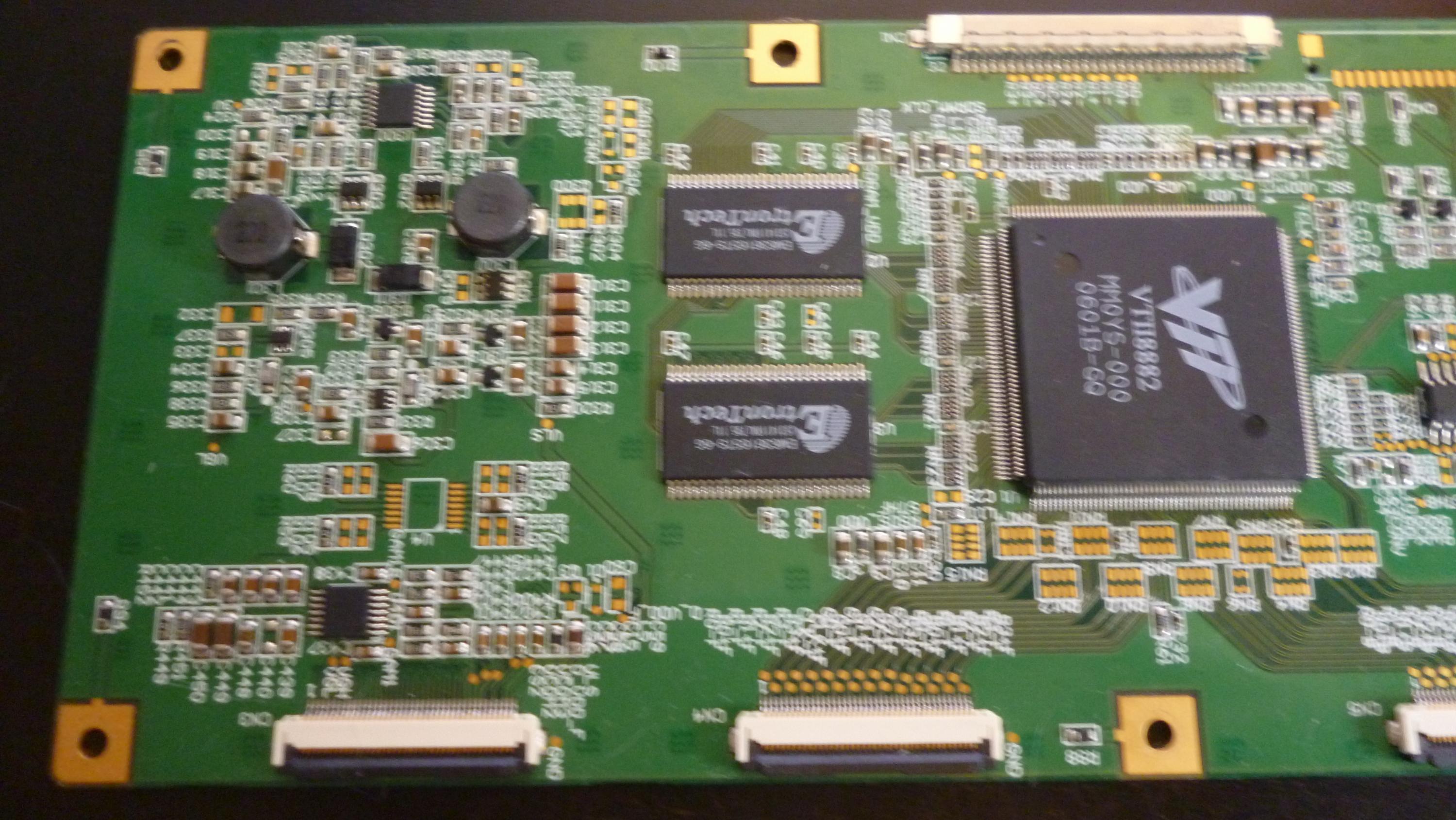

    ok guys got a tv and switched it on, boots up ok, backlights n stuff go on but theres no picture what so ever.. no menu, nothing !
    went onto ebay thinking this was a T-Con problem so ordered one, got it, fitted it = same damn problem any ideas on how to repiar ?

        Re: Philips 32 inch LCD TV - No Picture
        It would be recommended to make tests before swapping boards. Testing takes under 5 minutes.
        To begin testing, post pictures of the T-con board.
        Also, model number.
        Also, chassis number e.g. LC7.9E.

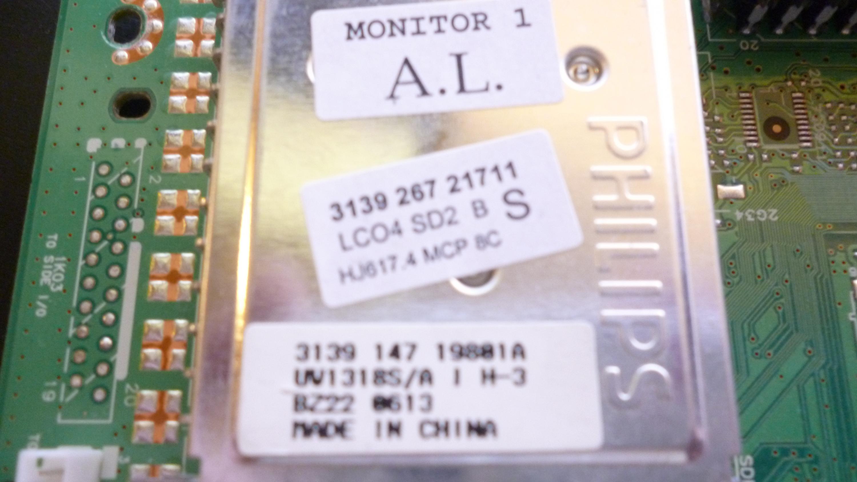

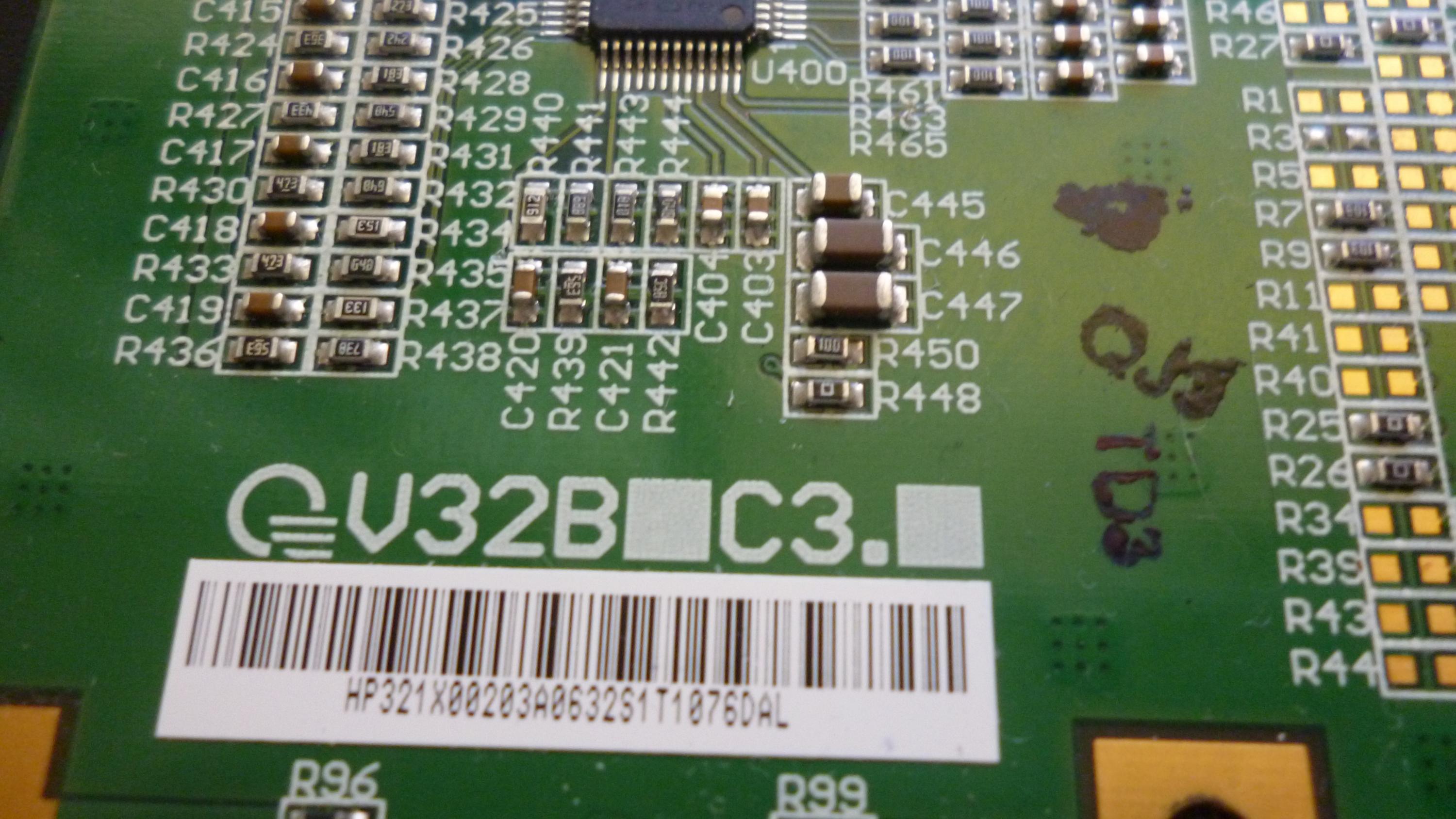

                think the T-Con is V32BC3C3. and chassis number is LC4.3E

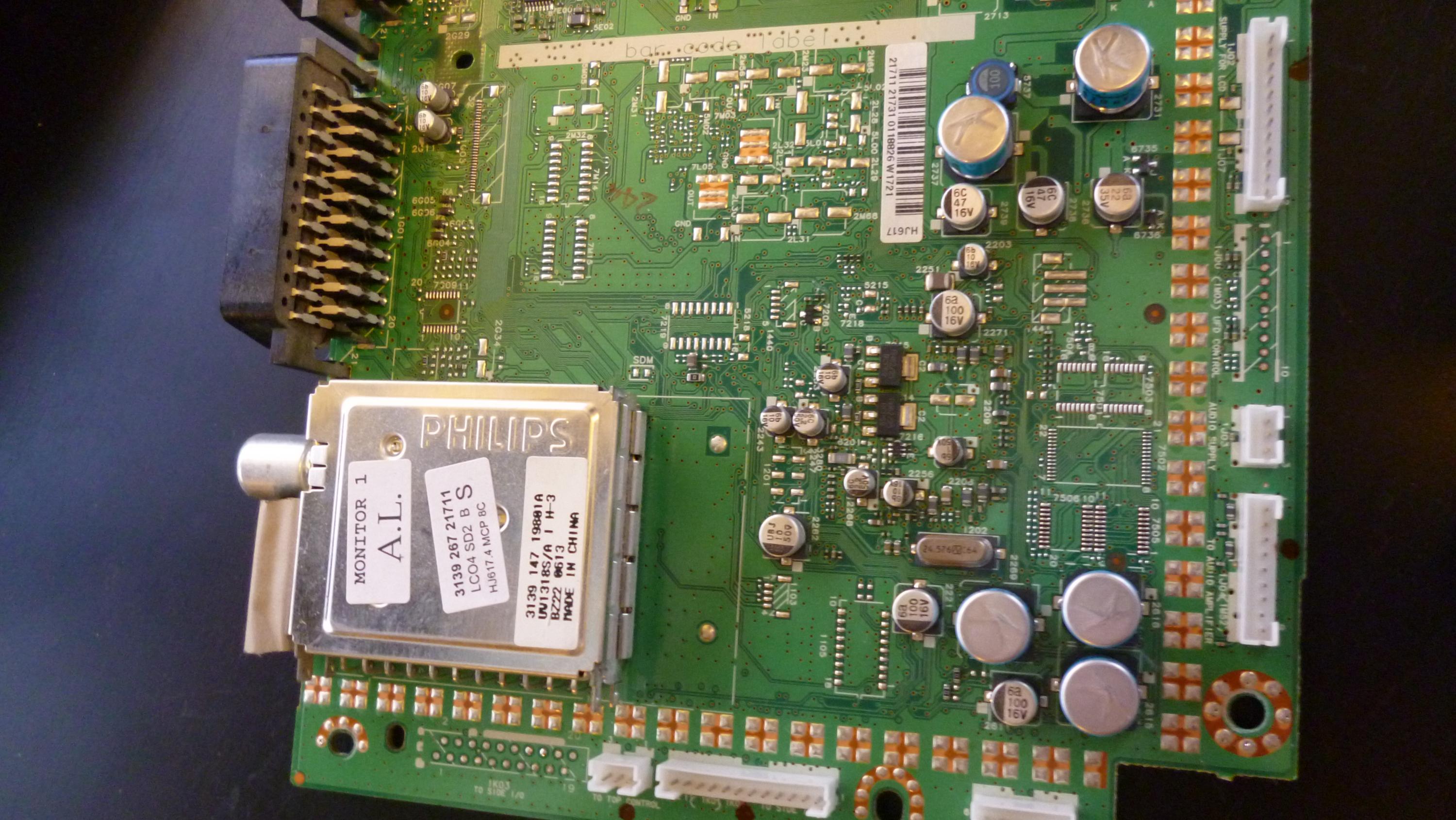

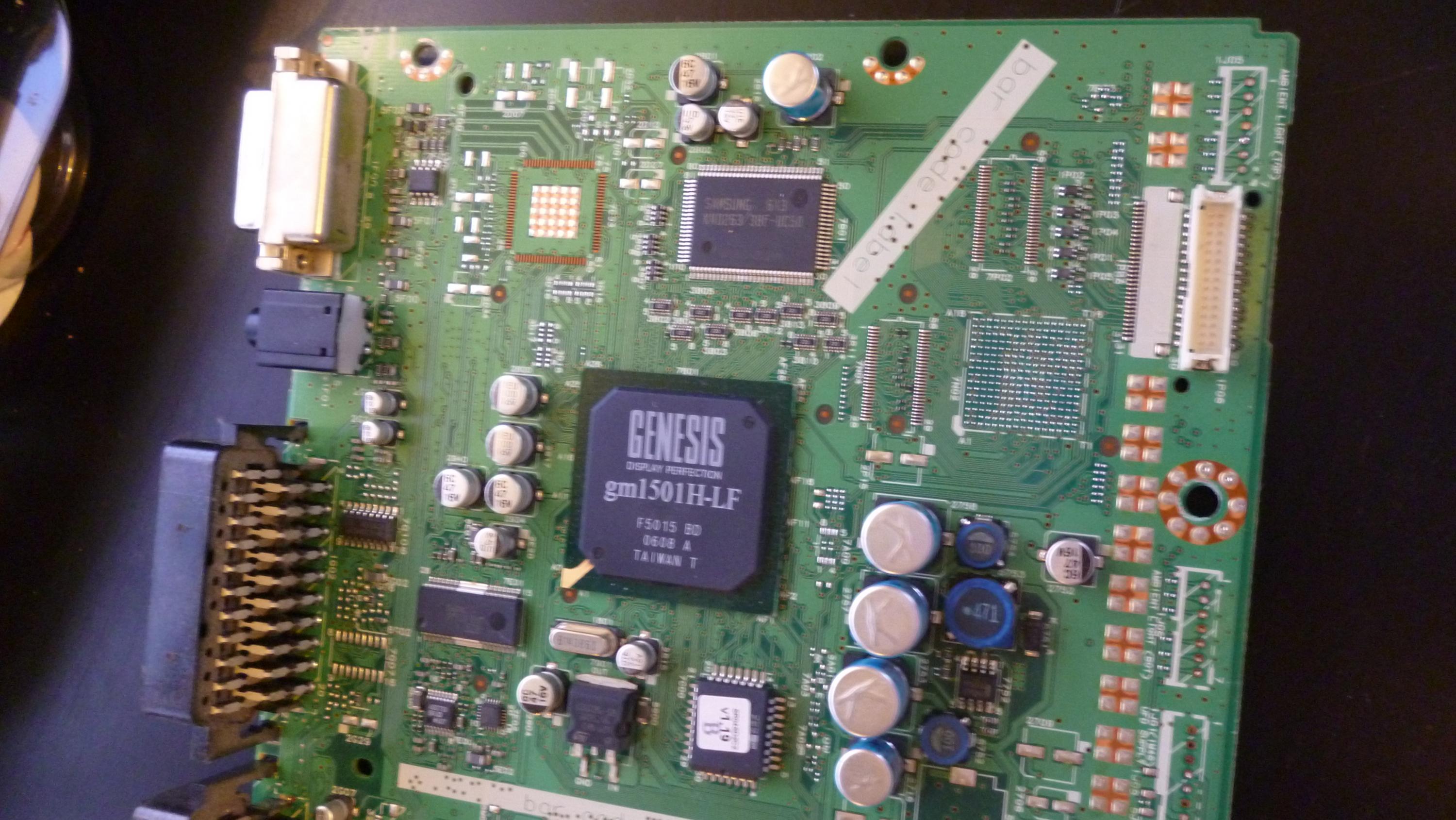

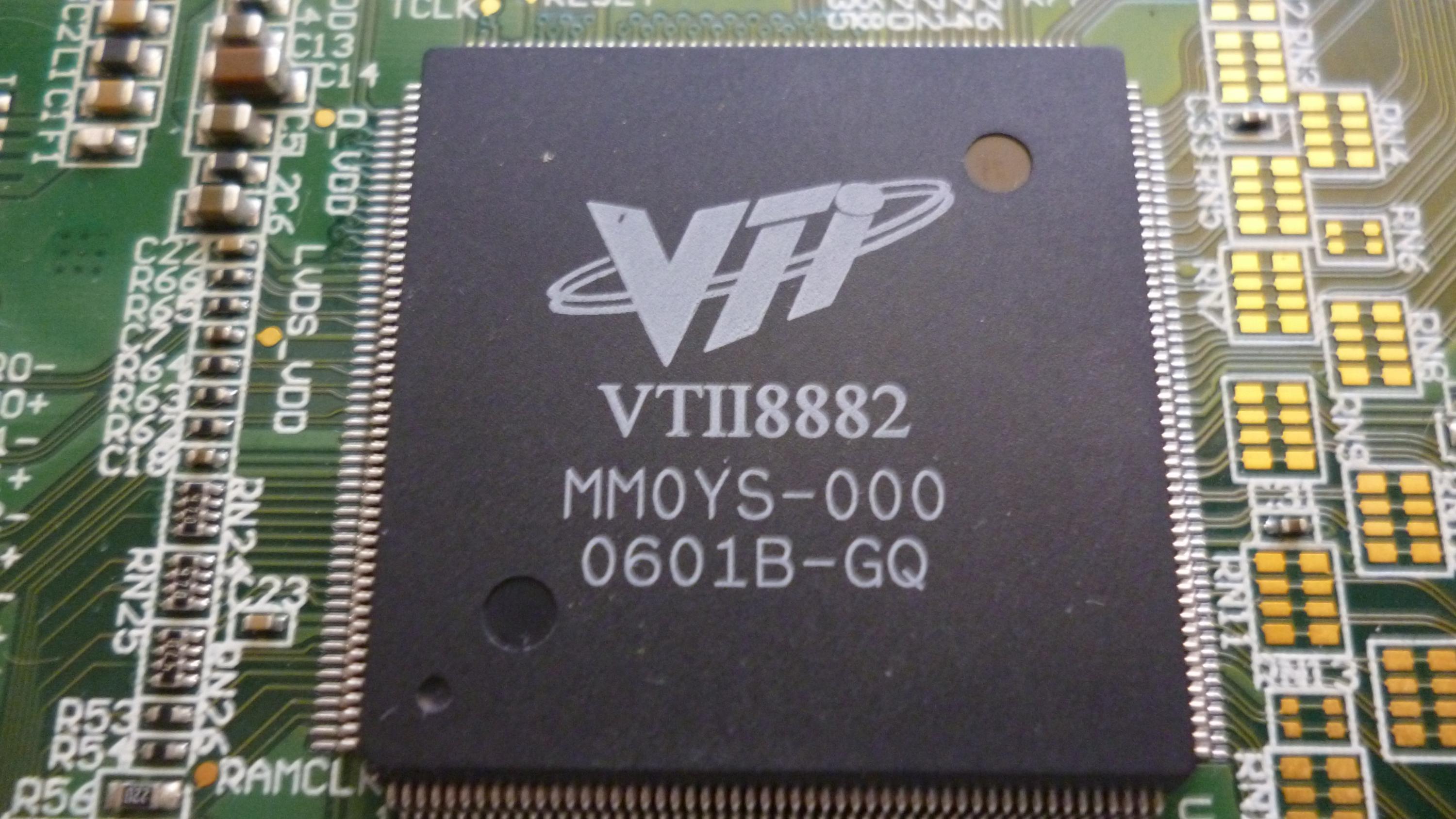

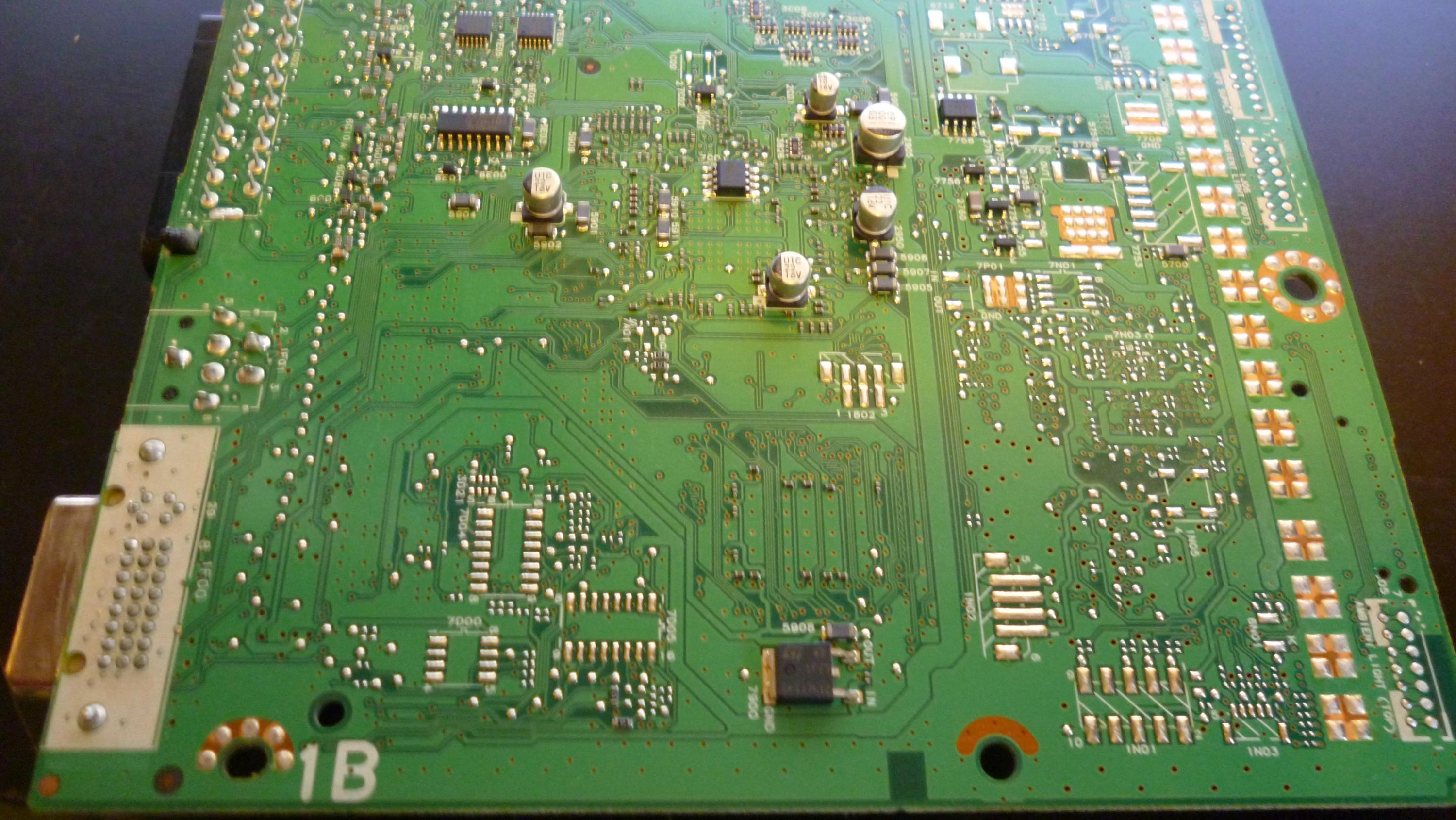

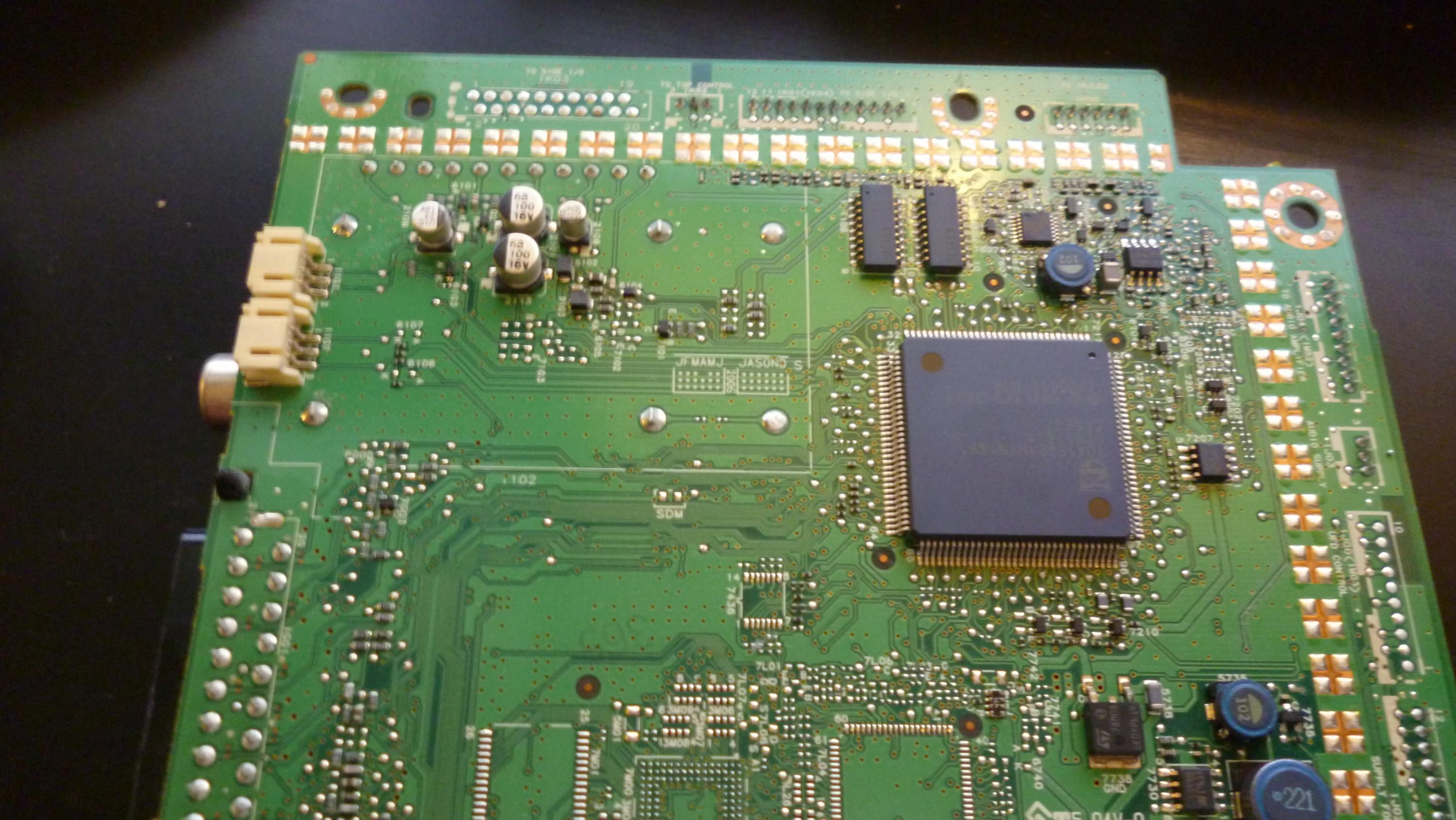

                  How about some pics of the tcon and main board?
                  • Mikeyboy2007
                    • Mar 2013
                    • 745
                    • Scotland

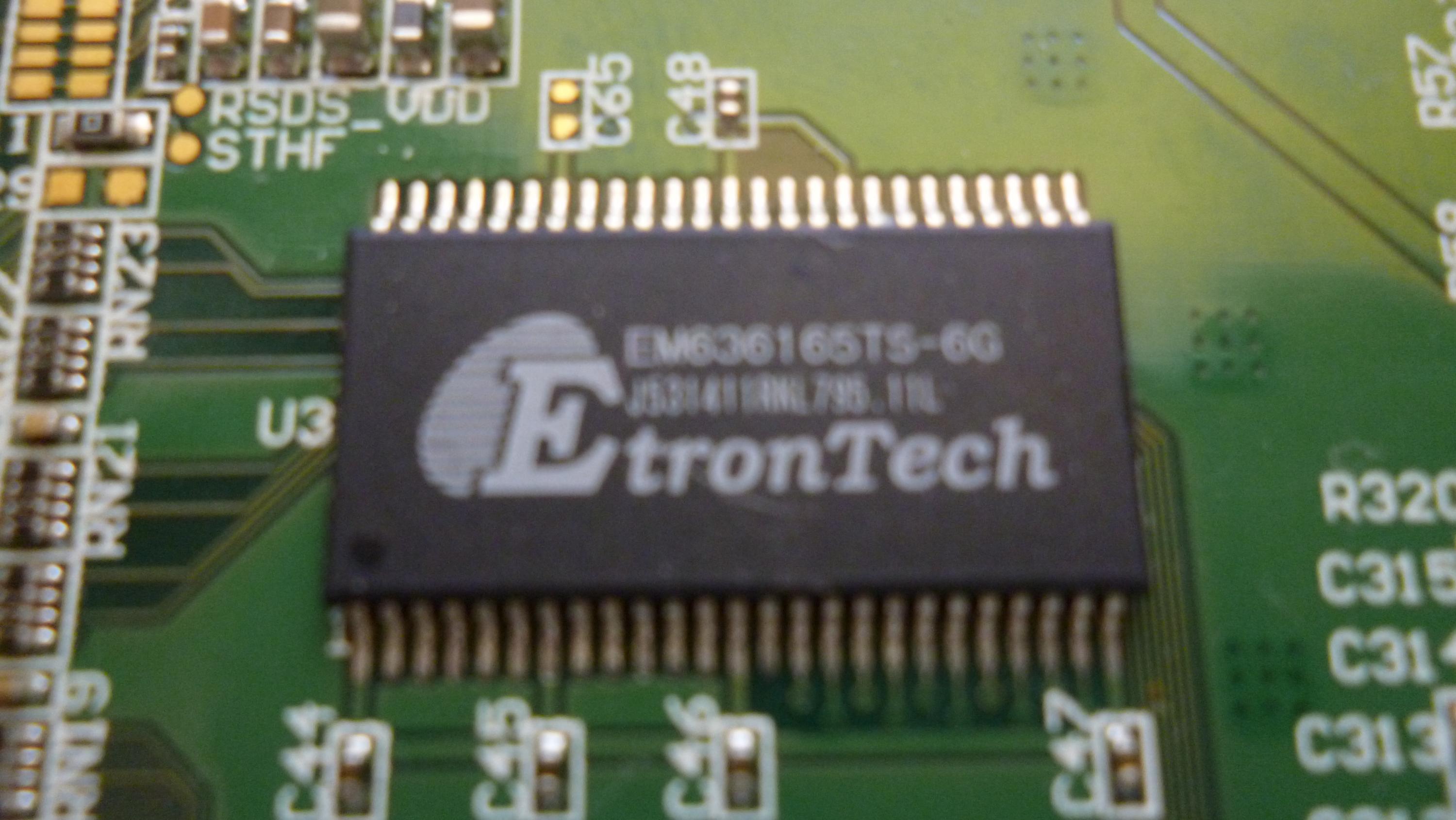

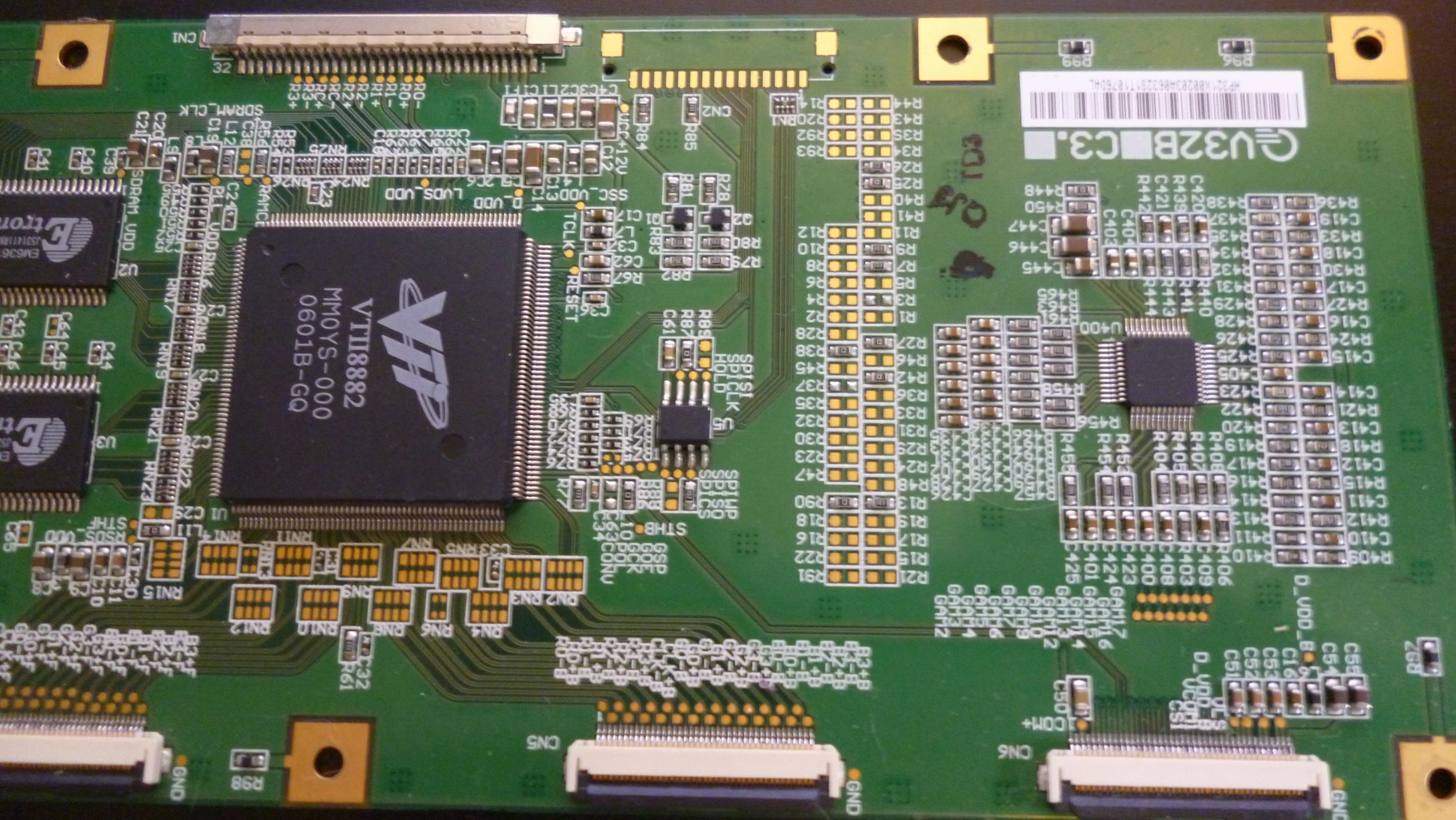

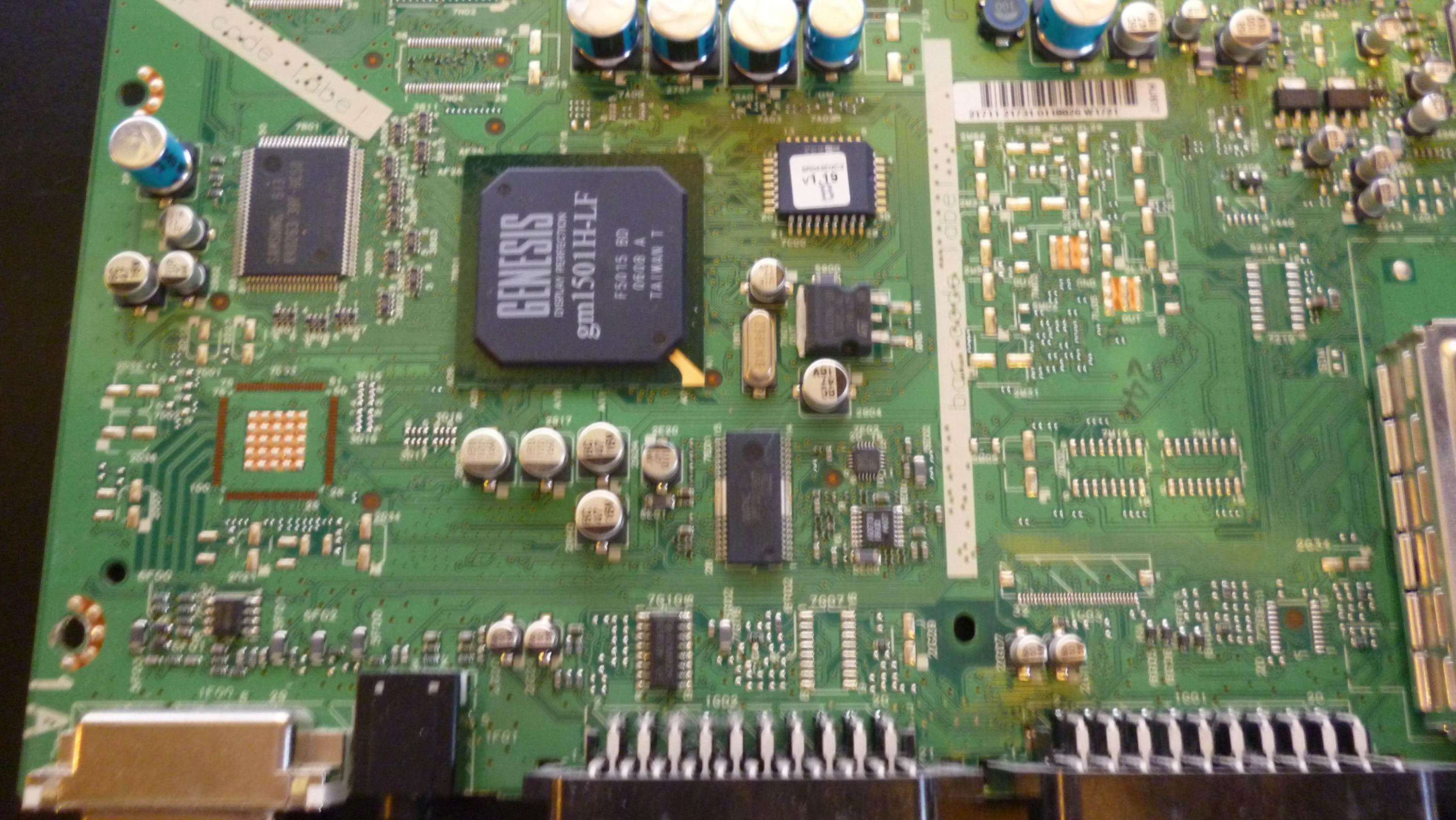

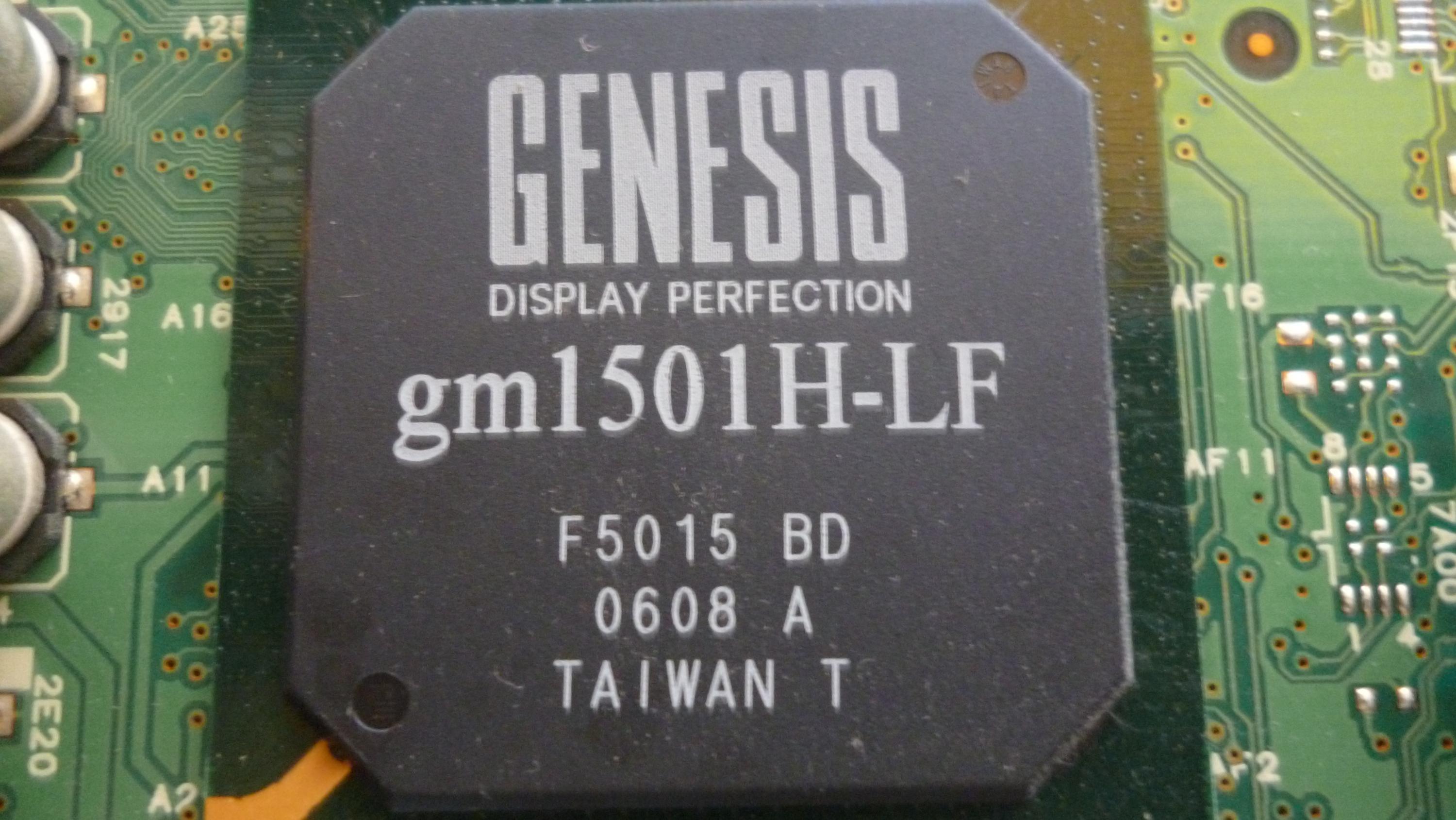

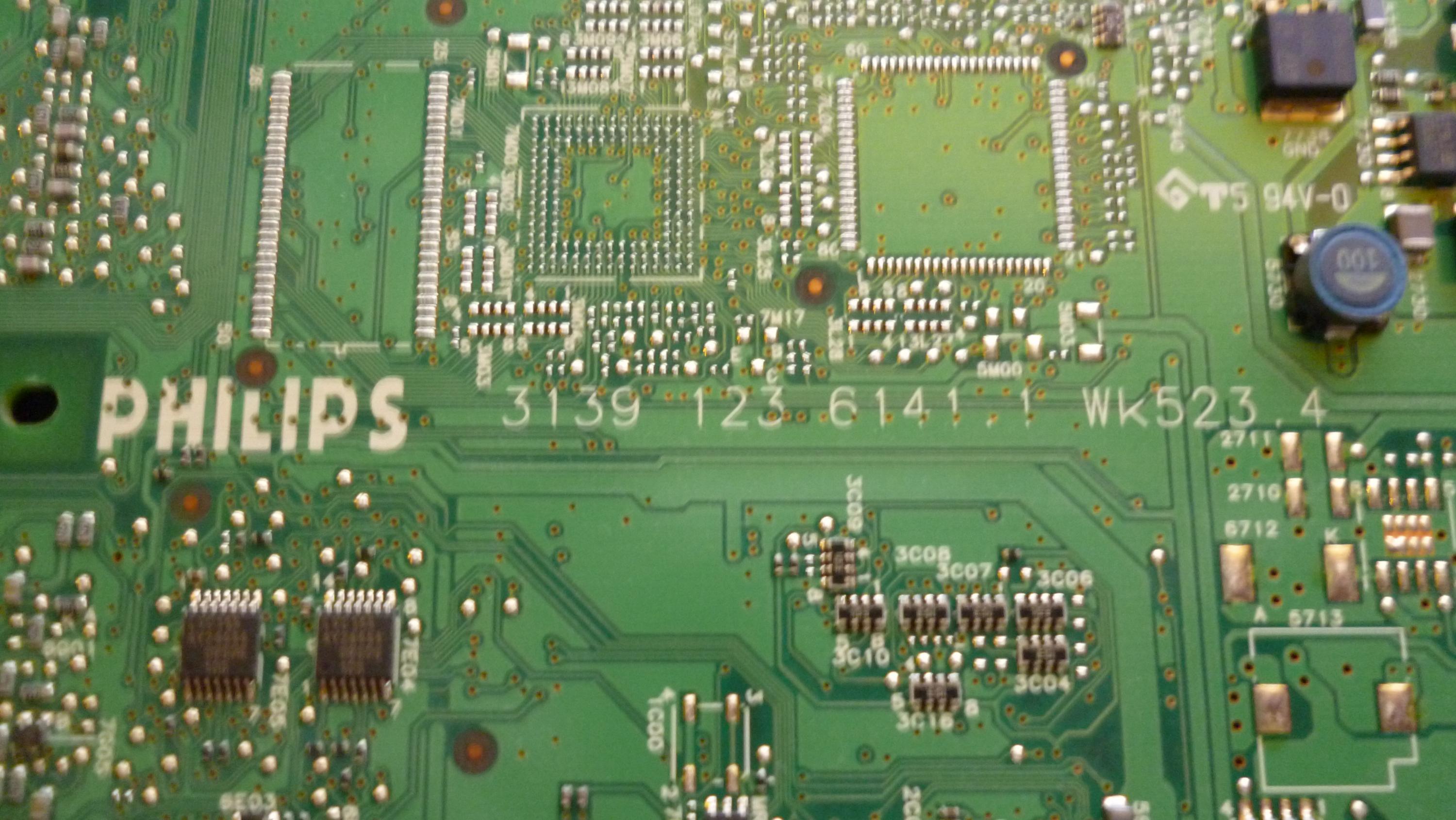

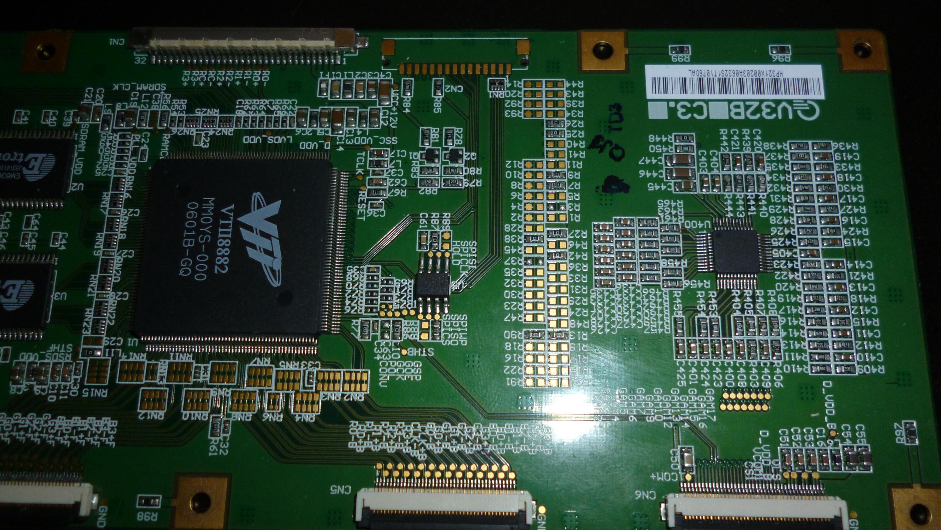

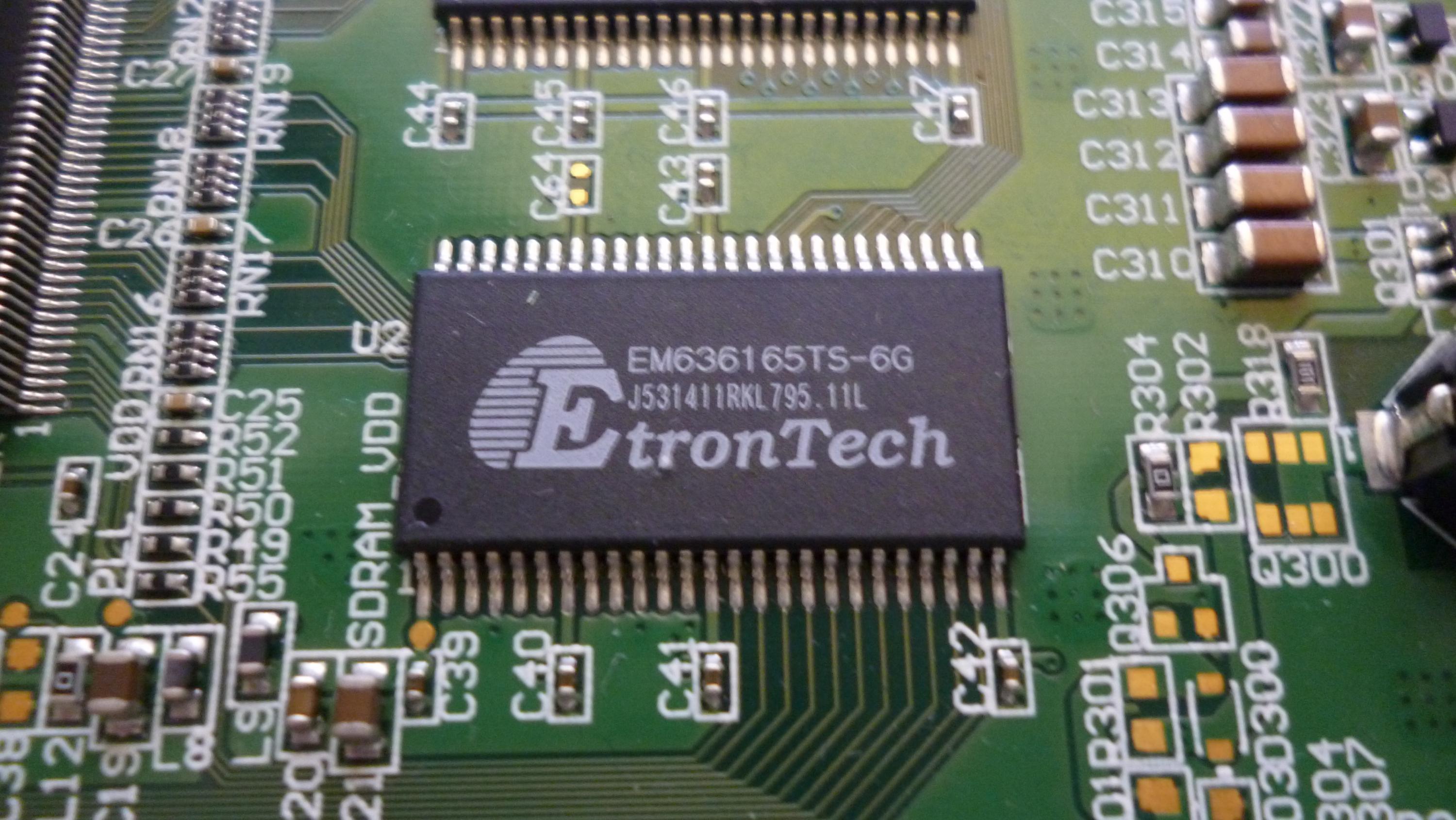

                    few pics of T-Con and MainBoard mate
                      There's a fuse, F1, on the T-con board. Check the voltage on both ends, black probe on chassis, TV powered up with picture failure.
