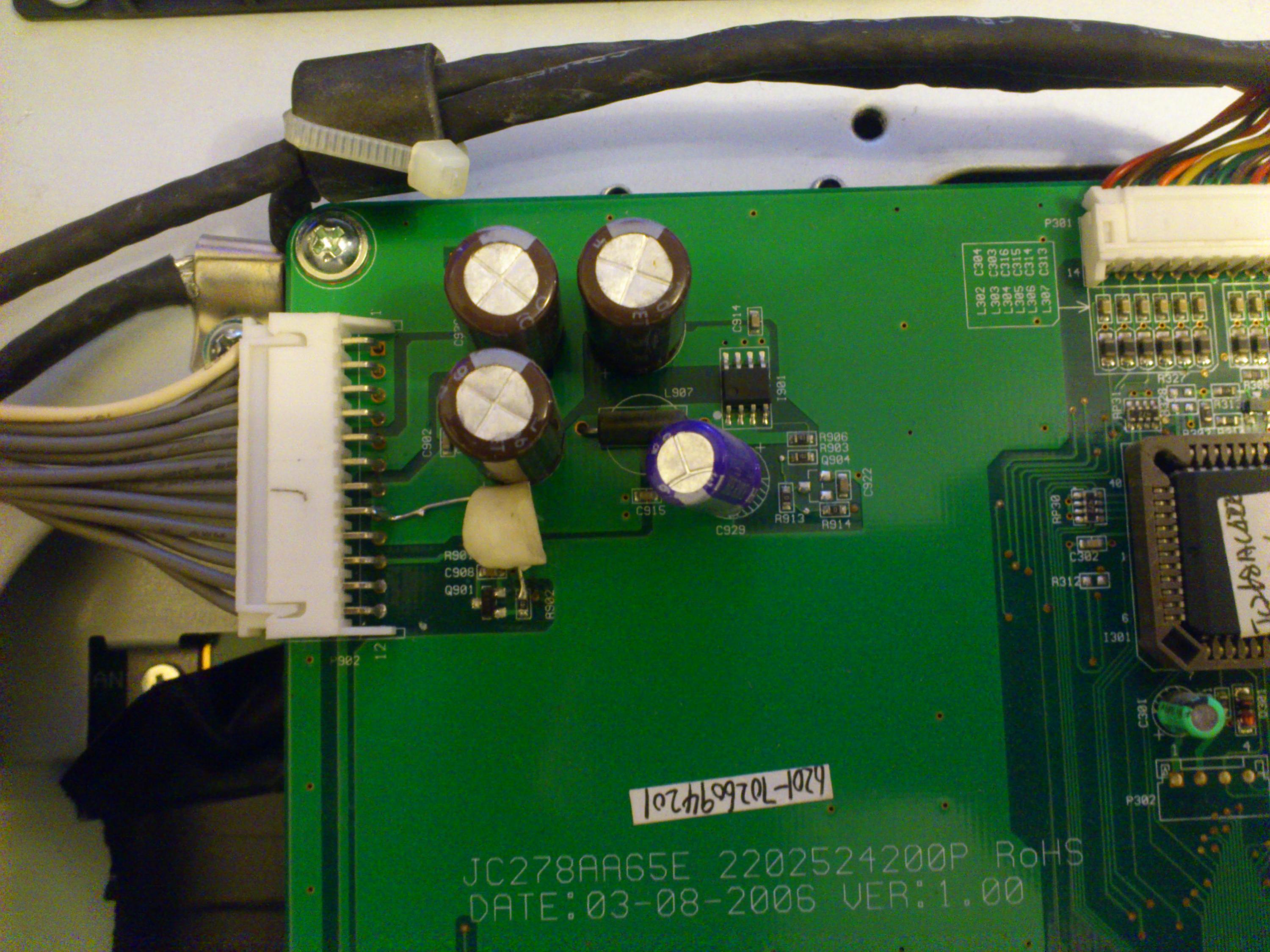

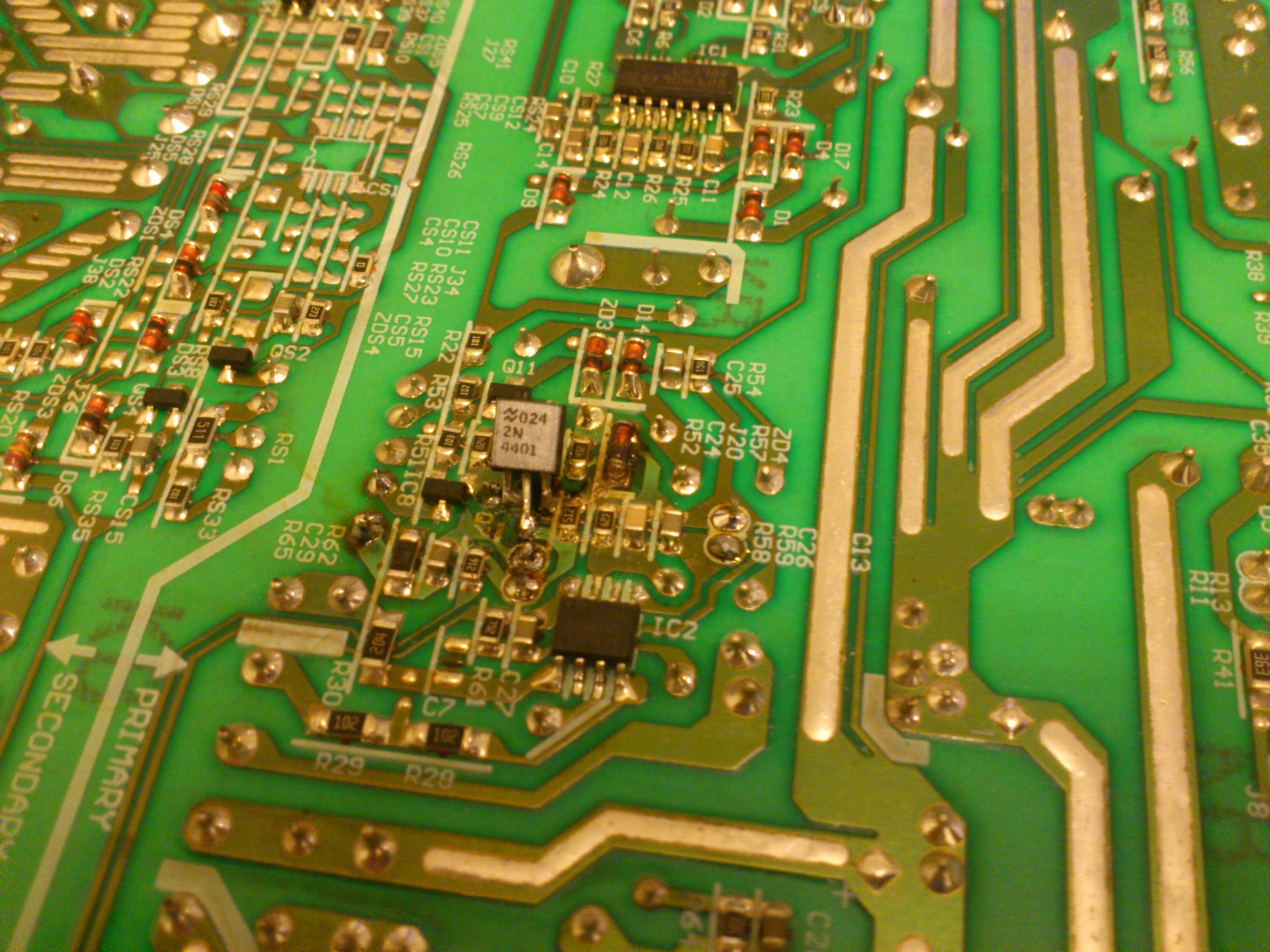

    hi all,
    i bought this tv with bad caps replaced them all and the tv worked fine, so i sold it a friend and a few months later it has returned......
    now the tv comes on fine but then after say 5 mins sometimes the back light goes out.....the sound remains.....and the picture is there...but no back light
    so i order a 2nd hand invertor....it comes i fitted it....tv works a treat
    few days later i ring my mate and tell him im just gonna test it again before i drop it round, put it on and low and behold same fault! now im guessing its the power supply but now when i test it.... it wont fault on me!
    has anyone got any ideas or if anyones had similar issues i could really do with the input
    check out the pictures the diode near the transistor looks a bit suspect but i checked it with diode test and it tests at 880 1 way, so think this is roughly ok?

                right then voltages are as follows:
                in standby for invertor all 0v
                when switched on invertor from right to left see pic
                when on: when fault:
                1 = 4.8v = 0v
                2 = 0v = 0v
                3 = 24v = 22v
                4 = 24v = 22v
                5 = 24v = 22v
                6= 24v = 22v
                7 = 0v
                8 = 0v
                9 = 0v
                10 = 0v
                from top to bottom connector on main board see pic
                mainboard voltages: standby: / couldn't get it to fault again to post these readings
                1 = 0v 0v
                2 = 0v 0v
                3 = 0v 0v
                4 = 0v 0v
                5 = 12v 0v
                6 = 12v 0v
                7 = 5.1v 5.1v
                8 = 5.1v 5.1v
                9 = 5.1v 5.1v
                10 = 3.7v 0v
                11 = 0v 0v
                12 = 4.8v 0v
                  Re: Hanns g 32" JT261 back light fault
                  Yeah, so your 24V measures 22V, this is your problem.

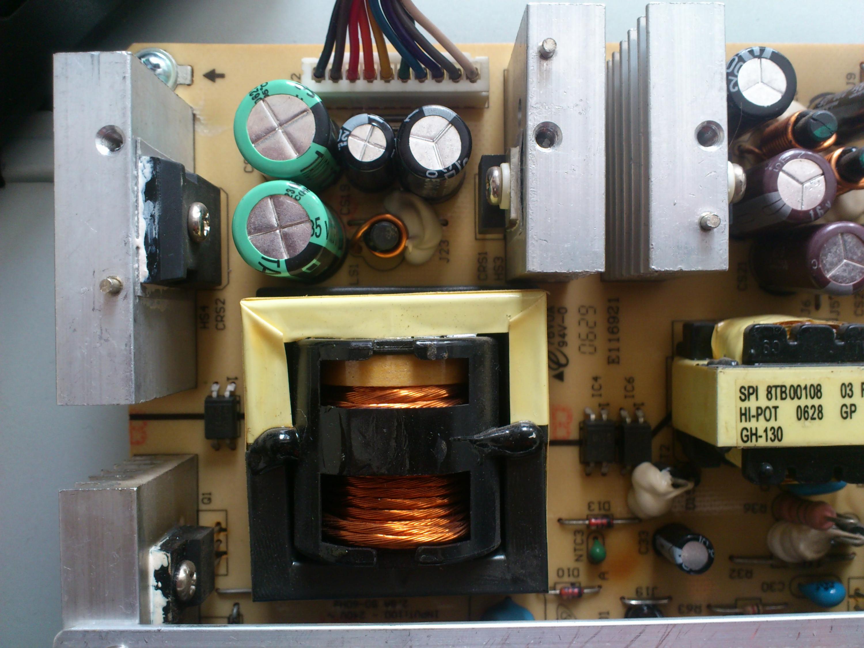

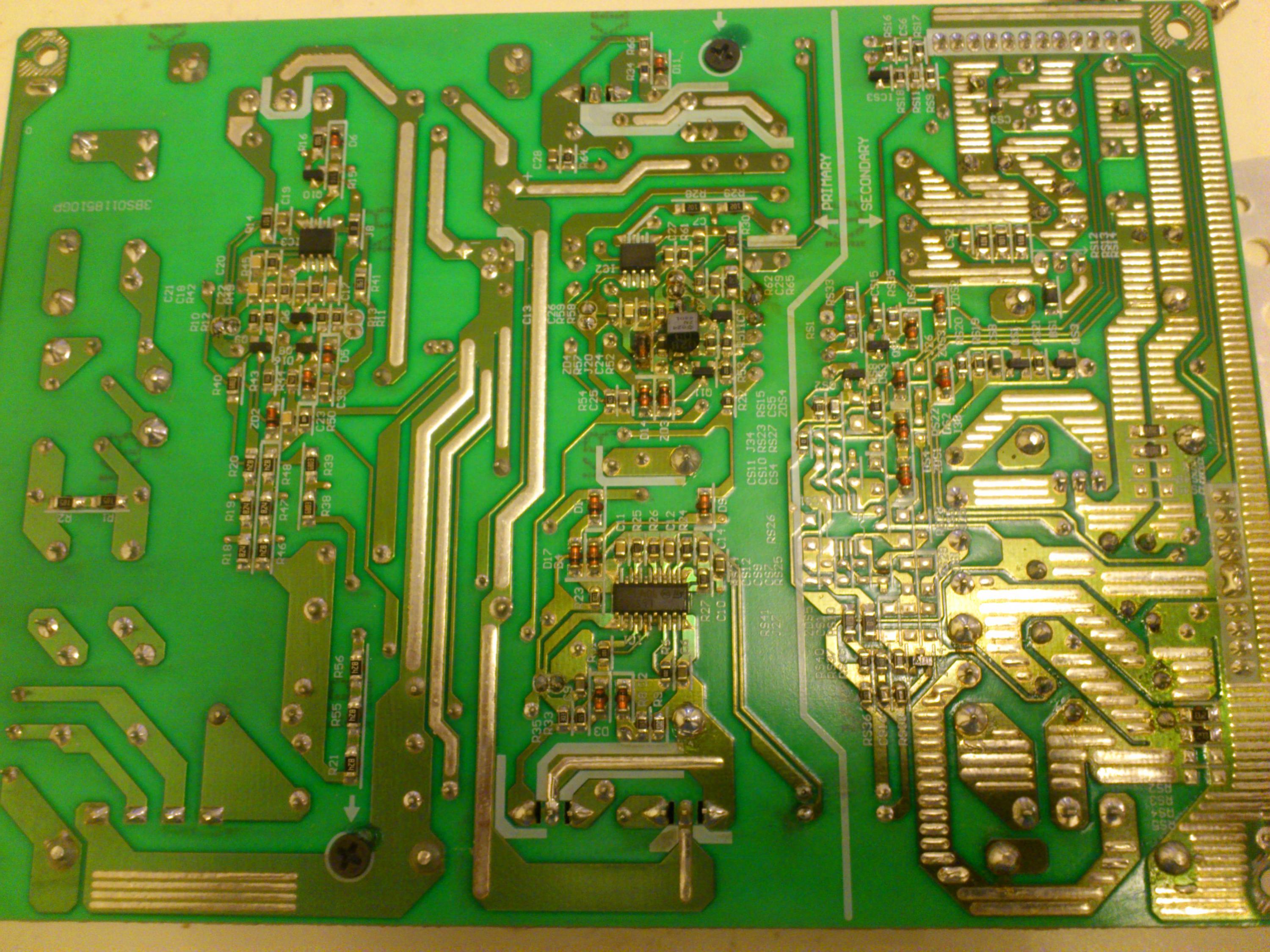

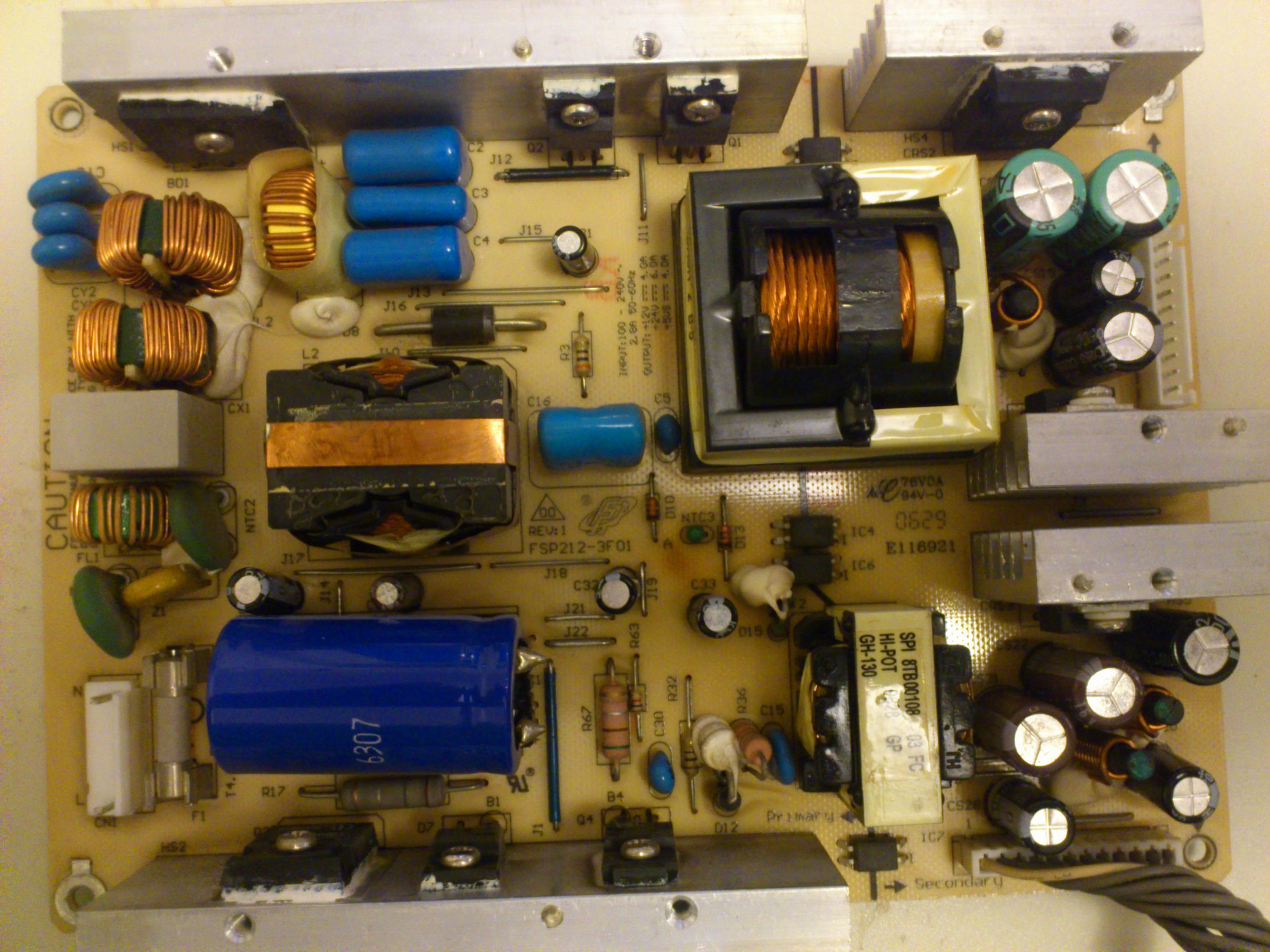

                    round here somewhere? see pic
                    would you say its worth just replacing the caps for the 24v section in the pic, or does it sound like it could be something else causing this problem?
                      First replace the crap caps -- this gives us a base line to work from.
                                      Consider C16 capacitor.
                                      • shepp
                                        • Mar 2012
                                        • 377
                                        • England
                                        where abouts mate, i can see C15 but no 16
