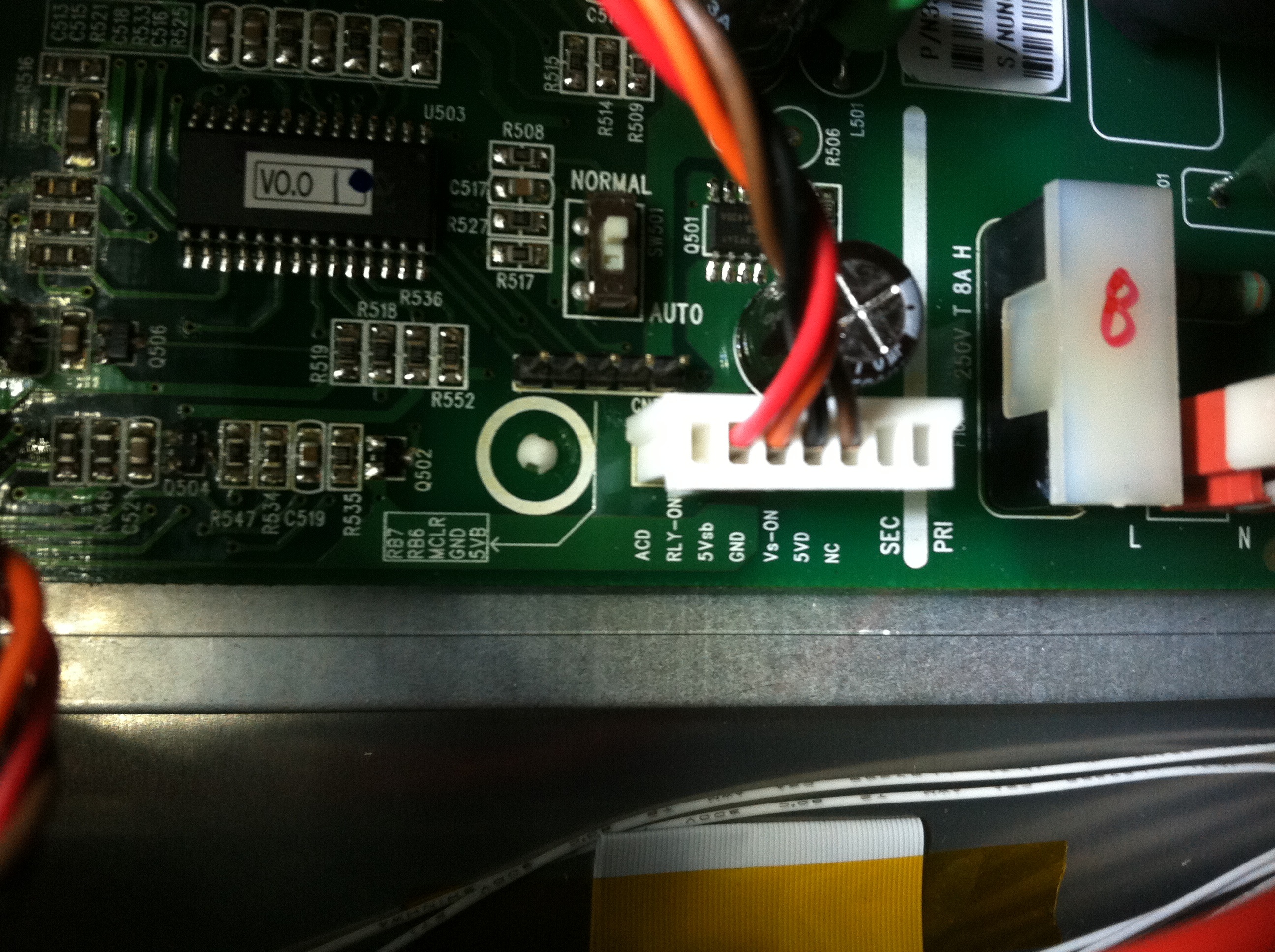

      Well, now it won't power on. I'm not sure what happened. I push the power button, the relay clicks, Vs comes up partially, a relay clicks again, and it shuts back off. Even with the PSU unplugged from the sustain boards it does the same thing. Can't say that I'm too happy about it.
        Re: Is this a symptom of a bad z-sus? Vizio P50HDM
        Check the power button isn't stuck. Check AC-D. (maybe AC-DET)

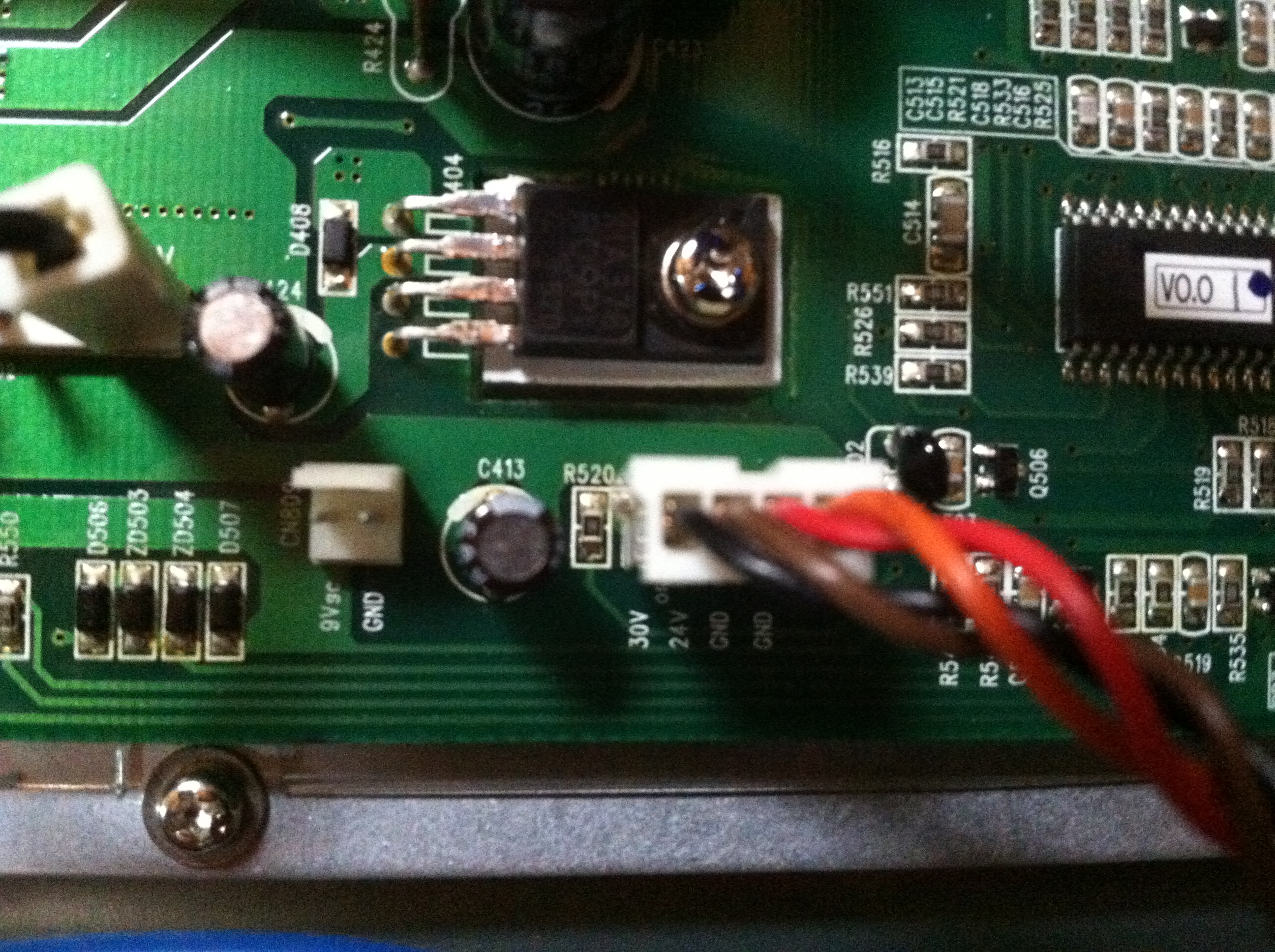

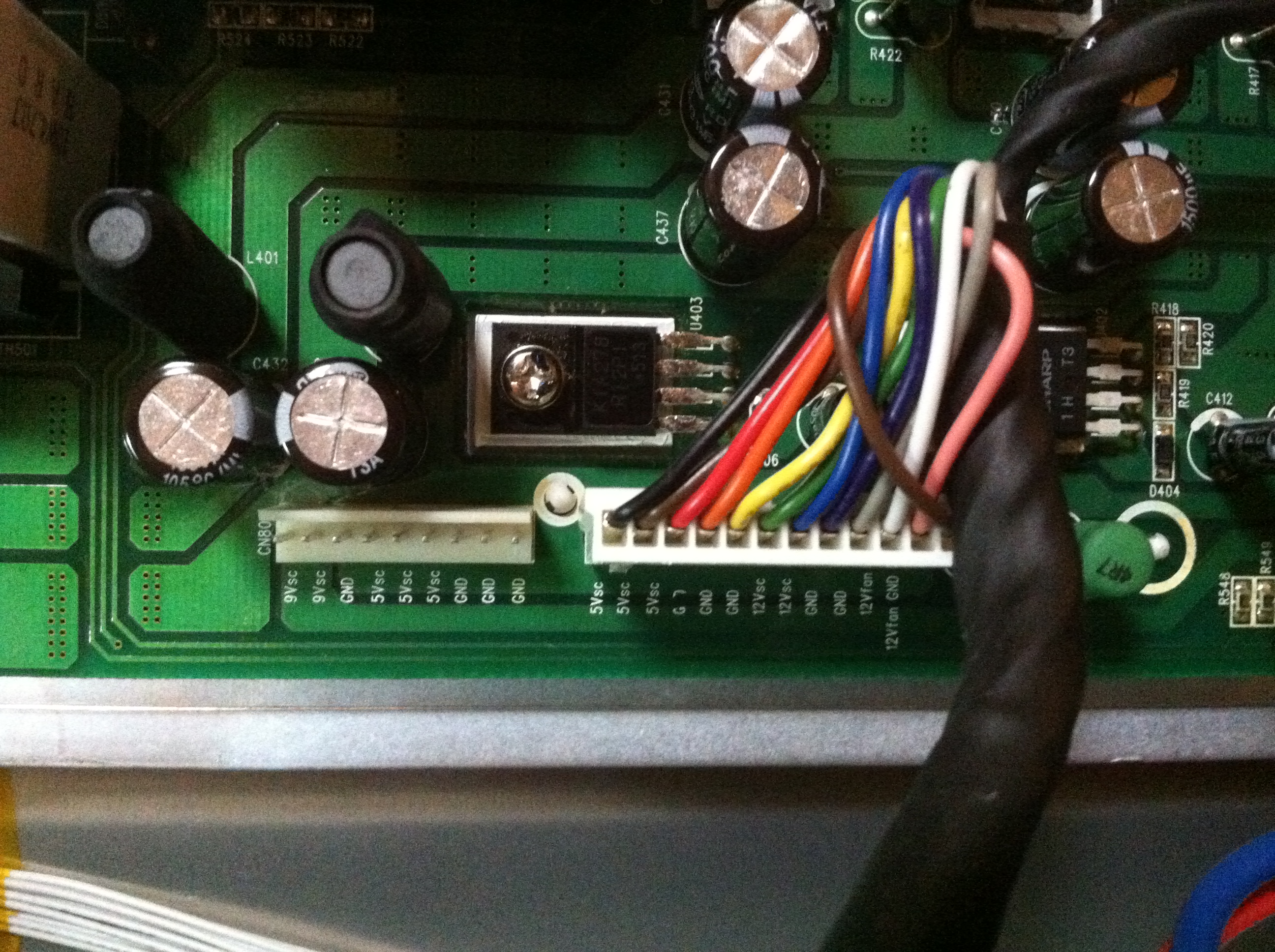

          Power button isn't stuck. I found the AC-D pin but I'm not sure how to test it? It reads zero with the meter on 20VDC. I'm right behind you with these LG/Vizio plasmas.
          There are two or three green LED's on the control board (main board). They both come on when the surge protector is turned on. After the relay clicks, they blink different patterns. I'm not sure what they're trying to tell me so I made a video.
          https://www.youtube.com/watch?v=wLICsQcFnWQ
            0V's bad. It should measure 3V or more.
            Can you cut the wire and feed in a voltage through a resistor? The resistor should go to the main board.
            The LEDs on the control board are normal. All lit is bad, they indicate the panel temperature in binary.
              I'm not following you here. There is no wire to the ACD pin.
                Hmm, odd. Which board is that?
                Check the RLY-ON signal.

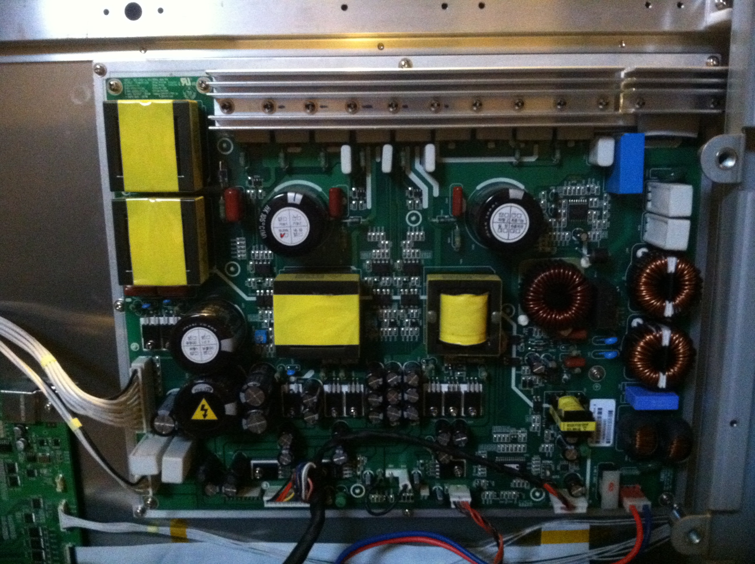

                  I'm watching a movie with my kids. I'll revisit this in the morning. Have a good night Tom.
                  That's the power supply by the way.
                    #29
                    Is it...? Looks quite different to what I'd expect, but I can only see part I guess.
                    • johnboy1313
                      • Nov 2012
                      • 1959
                      #30
                      Here's a pic of the power supply. The plug in the pic I posted last night is in the lower right corner next to the fuse holder.
                      Rly-on = 4.6v at power on, at which point the relay clicks and Vs-on jumps to ~4.5v. The relay clicks again and rly-on drops to 4.3v and stays there while Vs-on drops back to 0v. When you push the power button again rly-on drops to 0v.

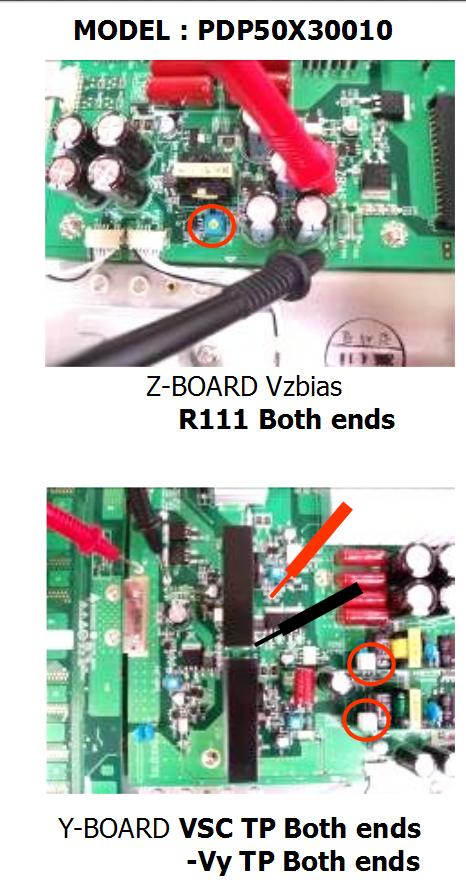

                              I had a breakthrough. I got the PSU to work.
                              Vzbias = 97.3V across both resistors.
                              Va = 60V
                              Vs = 189V
                              I don't know how to check or adjust the other voltages on this set.
                                          I've got the scope, where do I take the readings from? I'm looking at the training manual for this panel (see attached). When checking Vs, Va, and Vzbias, the readings match the label on the panel. When checking Vsc and Vy, my meter goes into overload, even when it's set on 1000VDC!!! I can't believe that this thing is pushing +1000VDC and not smoking. I'm afraid to check it with the scope for fear of blowing something.
