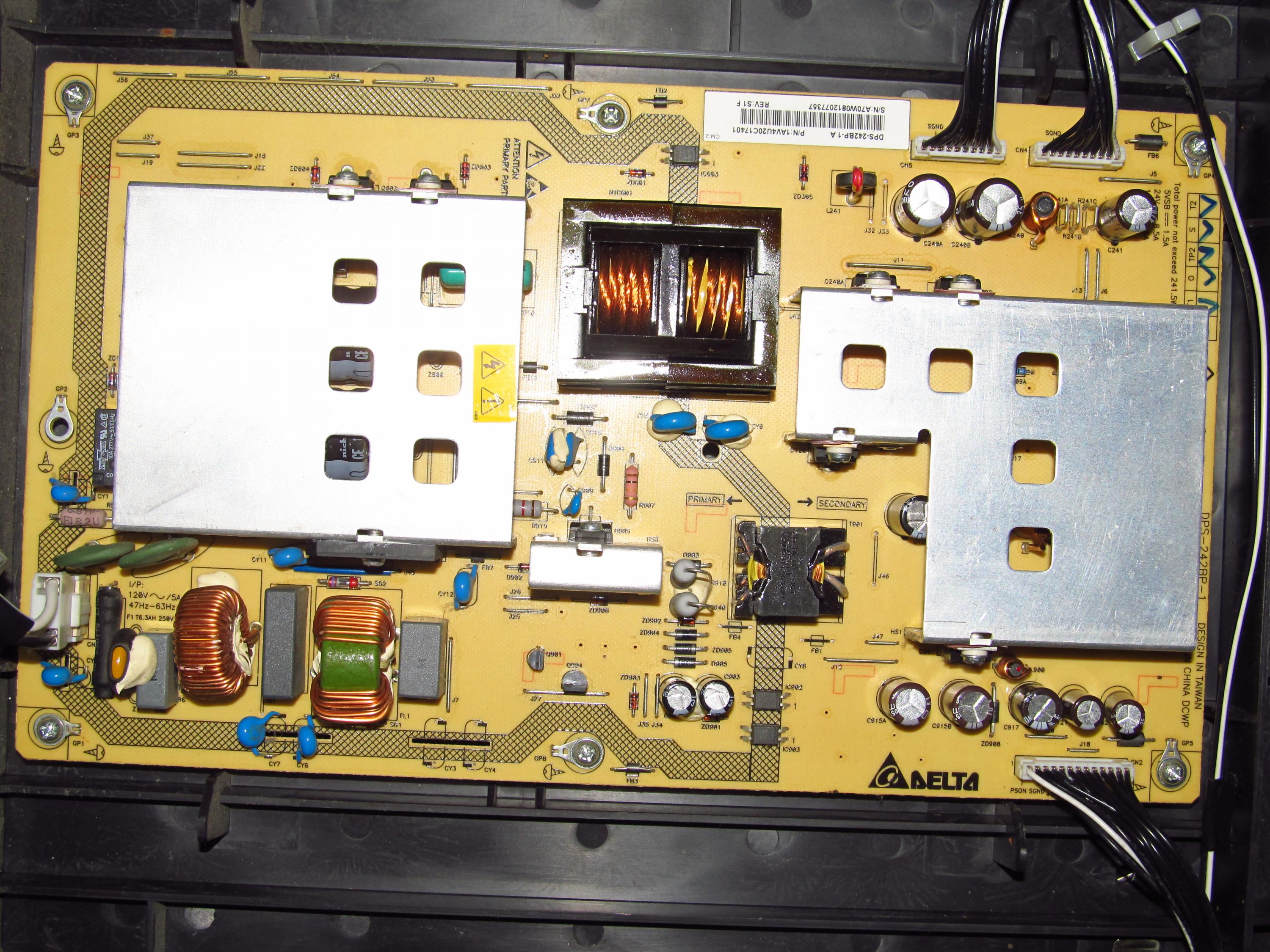

    I have a Sanyo DP42848 TV that I purchased for $50 because the display does not power on. This is a backlight or inverter problem from what I can tell. It turns on, you have sound, everything works but you can only see the picture with a flashlight. The inverter PCBs are getting 24v from the power PCB. I've checked the fuses on the inverter boards and they are good.
    I've read a few threads concerning this model TV here on the forums, and most are turning on for a couple seconds, then going out or turning off - mine does not do this. It turns on and stays on for as long as you'd like - you just don't get the CCFLs turning on.
    I work at an electronics manufacturing facility, so testing the PCBs down to a component-level shouldn't be an issue. My knowledge and tools are limited, but what I don't understand, and what tools I don't have in my arsenal I could have one of my Electrical Engineering friends help me with (I'm just the I.T. guy).
    When talking with my EE friend, we originally suspected the horrible solder joints on the inverter boards to be the cause of the backlighting problem. We cleaned up all the joints real good and touched up a few bad ones but the backlights still didn't fire up.

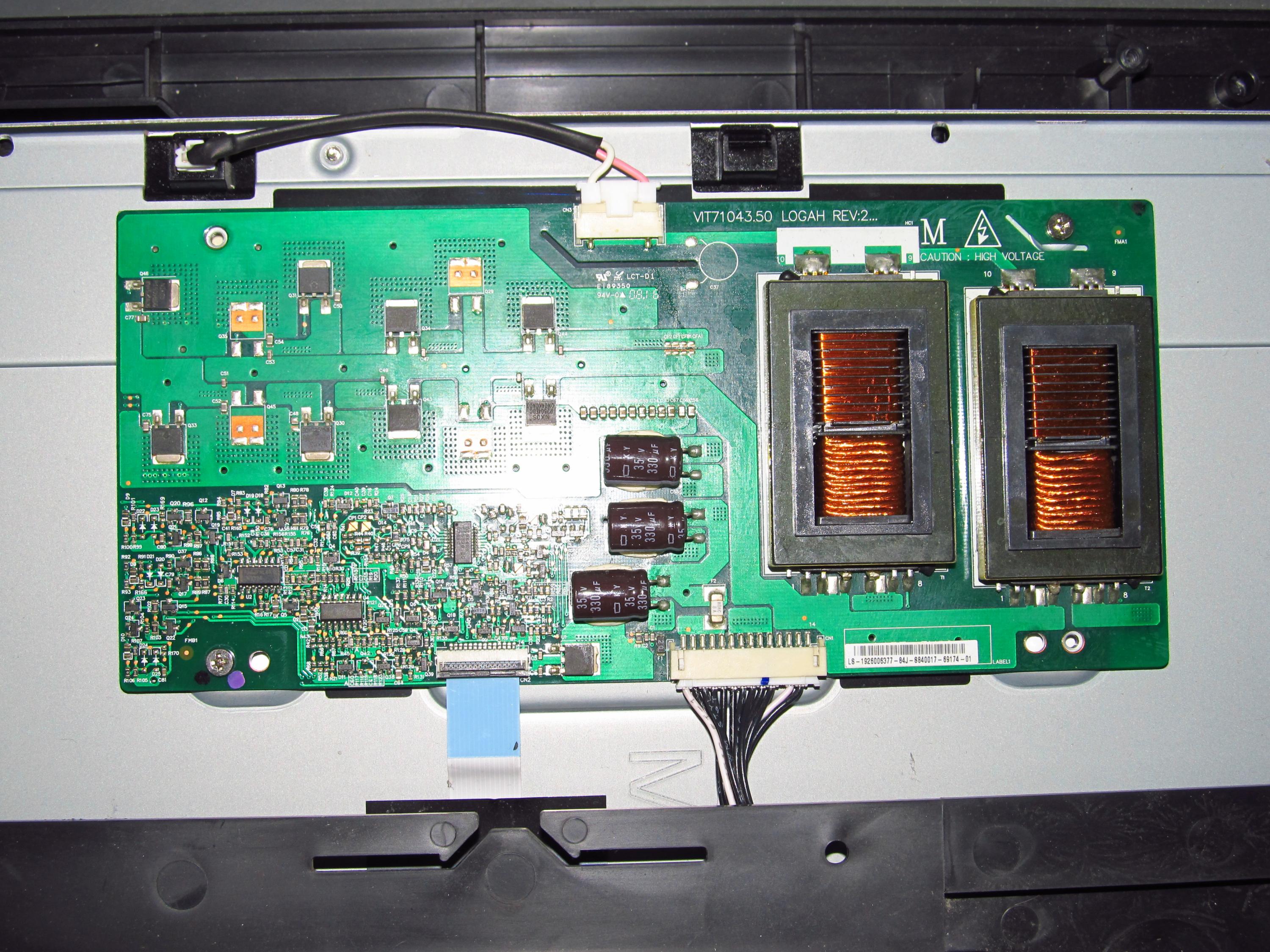

    I have tested the inverter transformers (per https://www.badcaps.net/forum/attach...4&d=1350660859) and on the master and slave, the outboard is open while the inboard is not.
    I've attached photos of the boards to this post, both with the flash on and off (flash washed out some parts, but without the flash the focus is fuzzy)

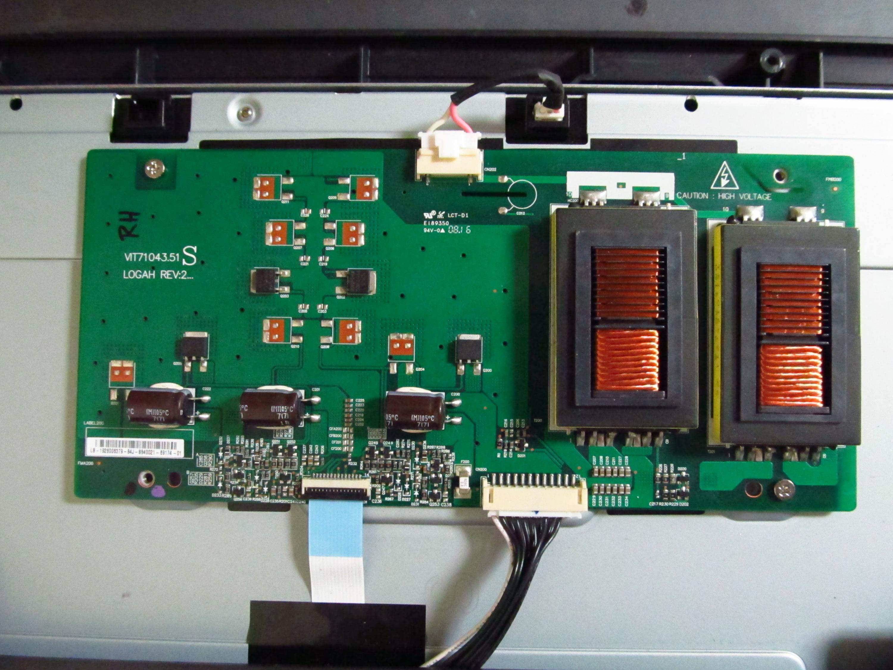

            I forgot to list my ohm readings across the inverter board transformers, tested on 20k setting.
            Primary PCB:
            Inboard transformer testing to pin 10:
            1: open
            2-7: 8.88
            8: .02
            Inboard transformer testing to pin 9:
            1 & 8: open
            2-7: 8.85
            8: .02
            Outboard transformer testing to pin 9 & 10:
            1: open
            2-7: 8.88
            8: .02 to pin 10. Open to pin 9
            Secondary PCB:
            Inboard transformer testing to pin 9 & 10:
            1: open
            2-7: 9.49
            8: .02
            1: open
            2-7: 9.50

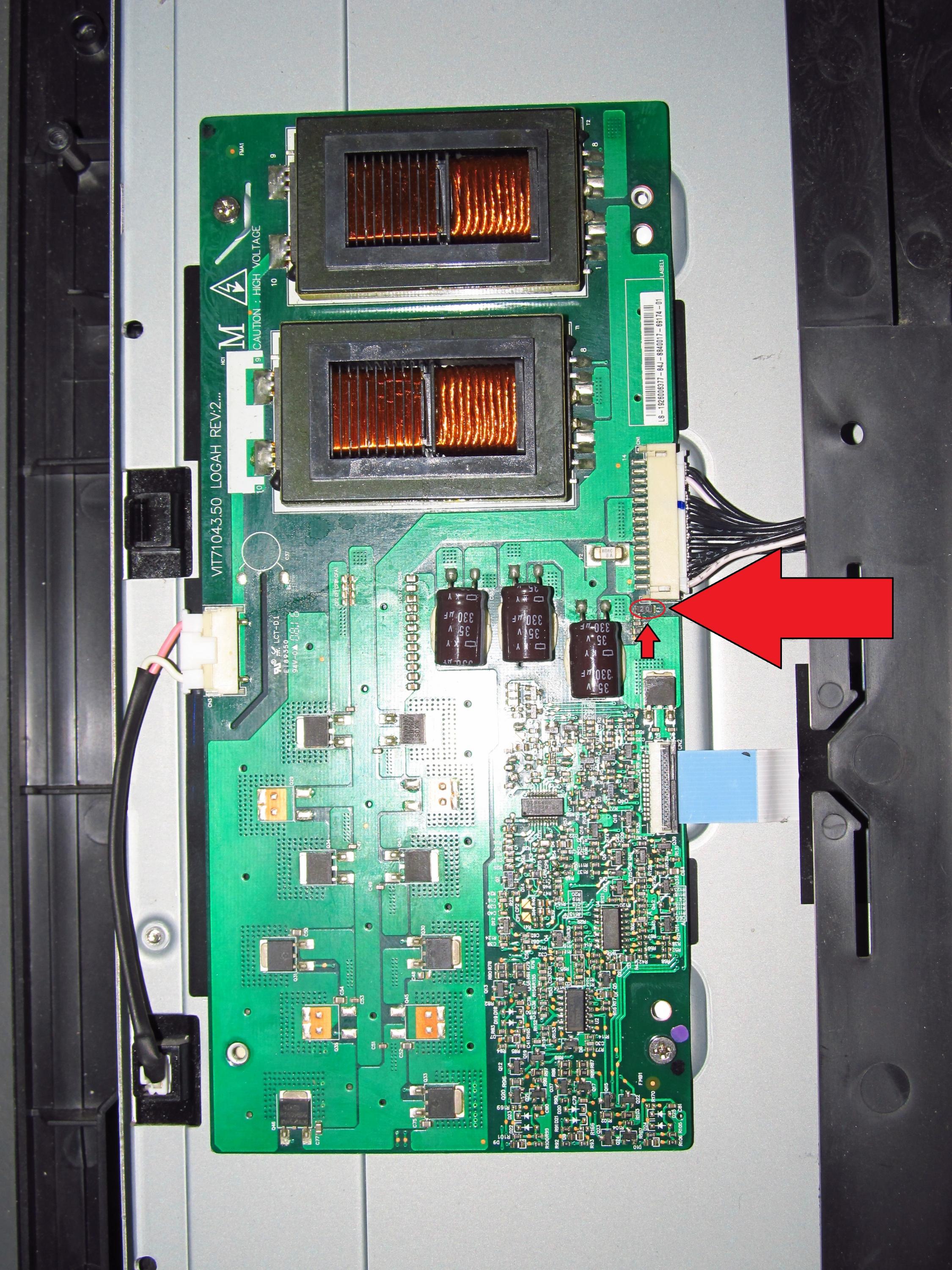

                    Alright guys, I got it! On the main inverter board, look at the power in socket. Directly below it is an SMD fuse that I missed, which showed no continuity (I was testing the large fuses next to the connector, which were good).
                    24v on the input, 0.00 on the output. I grabbed a scrap piece of CAT5, stripped a single wire to make a jumper and powered on the TV. With the fuse jumped, the backlights power on and stay on. I'm going to see if we have on of those fuses in stock, or if I can solder a different style (same rating) in it's place. I don't want to "hotwire" it by shorting the two terminals, because fuses blow for a reason.
                    Tomorrow I'm going to test the load on the fuse and see what amperage is going across the two terminals. It's labeled F1 on the PCB and I've attached a picture of it's location.
                    Best part is there's uniform light across the screen, and the TV stays on with K8L plugged in.

                      Re: Sanyo DP42848 sound but no picture
                      I have seen that type of black fuse failed a lot for no reason. I use PICO II through hole fuse for replacement, that fuse is for supplying B+ to the PWM IC. It should be around 1A fuse. You can set your meter to DC AMP Mode and put the probes on each pad of the fuse to measure the current draw, then double up that reading.

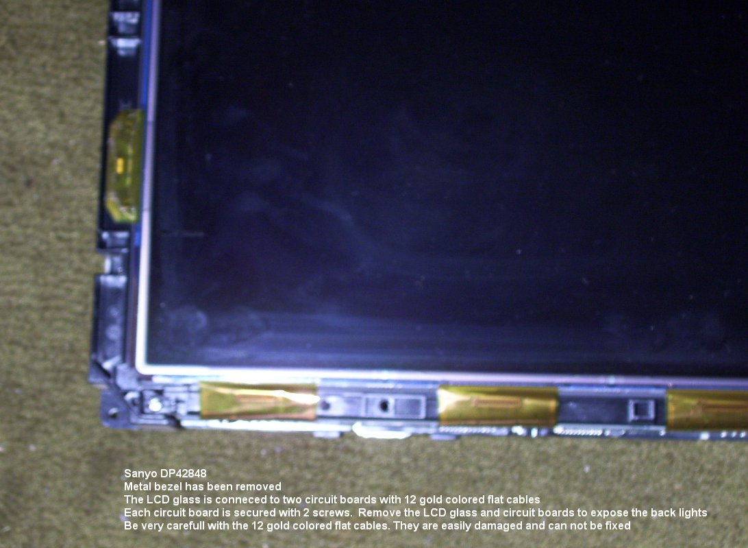

                            I had a bad Sanyo DP42848. Picture on for 2 seconds and then black.
                            I wasted my time and money trying inverters. No fix.
                            I discovered it was bad backlights. Reading various forums, this seems to be a very common problem with this TV.

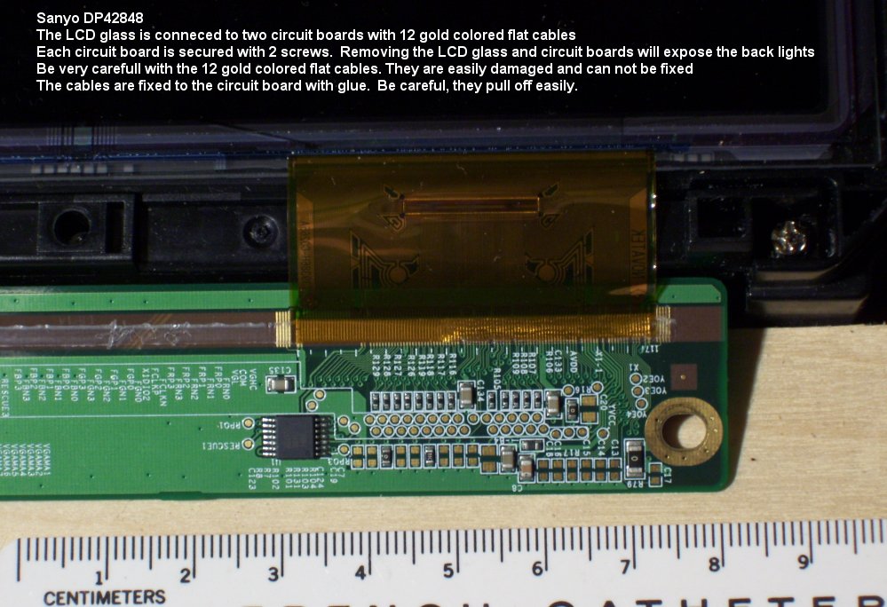

                            I disconnected the 2 ribbon cables from the T connector board to the control boards that ran the glass panel and removed the boards and glass panel. I left everything else intact. That way I could turn on the TV and observe the backlights.
                            I had 3 bad backlights. The originals backlights are 950 mm long and 3.3 mm wide. The ends are covered in conductive silver coating.
                            I could not find an exact replacement. The closest I could find was 950 mm long x 3.0 mm wide bulbs with wires at the end. I purchased these from http://www.ccflwarehouse.com for $25 each. Part number CC30950. I bent the wire ends back and soldered them to the metal sockets. When the 3 bad lights were replaced the Television came on and stayed on. So far so good.
                            There are 12 ribbon cables from the control boards to the glass. Unfortunately I damaged one of those cables and ruined the TV. These cables are glued on to the boards and they are pealed off very easily. I made several attempts to glue it back on and on my last attempt, I accidentally cracked the screen. The moral of the story is, if you must remove the glass, be super careful, otherwise you will turn a fixable problem into a non-fixable problem.
