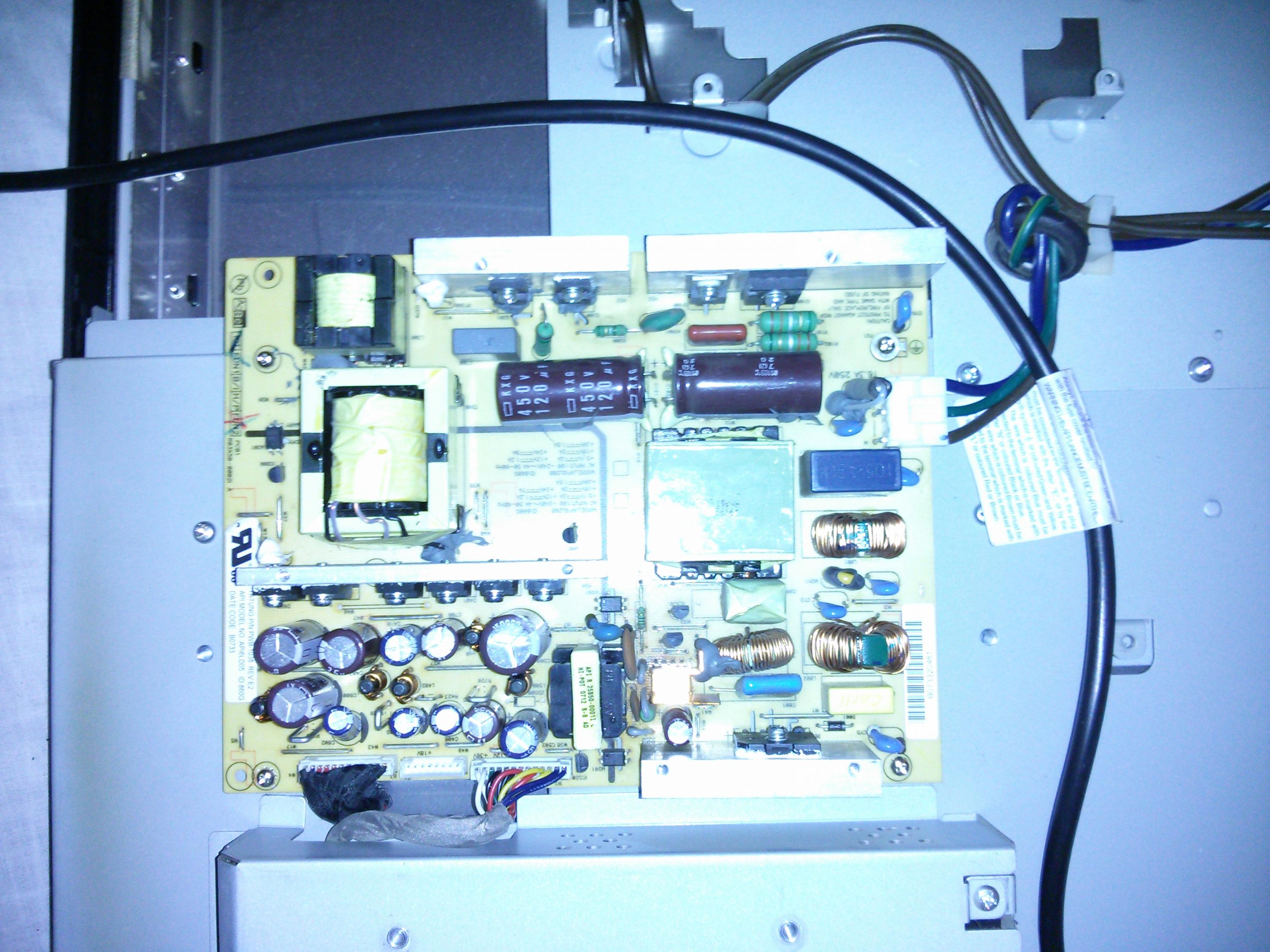

    I've been trying to fix this Polaroid TLU-03723B TV for some time, and I've got stuck.
    The big picture problem is that the TV comes on for a period of between 1 hour and 2 hours, then turns off.
    Please see attached pictures of the power supply.

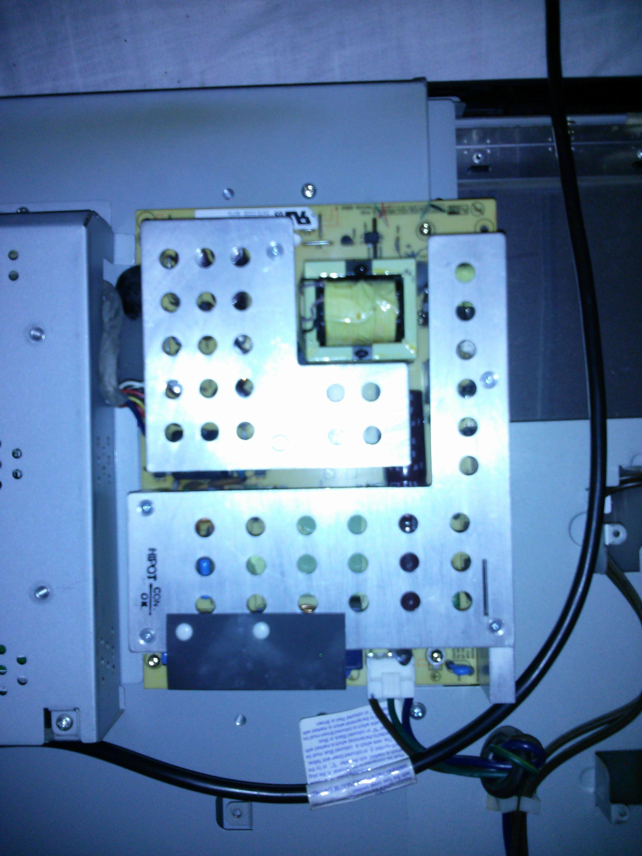

    This sounds like an overheating problem to me. If you look at the middle photo, the entire top left metal heatsink(?) gets increasingly hot when the TV is on, until it is almost too hot to touch.
    This power supply has voltages of 5, 12, 18v, 24v and 30v. All voltages are present and correct on the output. The 5v is standby voltage- it's always there when there is power to the set. All the other voltages only appear when the TV is turned on.
    When the TV turns itself off, it will not turn on again until some time has passed. During that time there is voltage on the filter caps, but no voltages from the output (not even standby power) and the transformers are not switching.
    The right hand photo is the power supply with the metal top covers/heatsinks removed. If you can see at 9 o'clock on the board, there is the heatsink that gets hot. Next to all the heatsinks are a thermistor. If you spray freeze spray on the thermistor and the heatsink when the set has turned itself off, it comes back on again when power is reapplied.
    The heatsink that gets very hot has the secondary rectifier diodes attached to it. The secondary rectifier diodes have been removed, and all test as good with a forward voltage drop of 0.1Vish. All of the capacitors test as good with my ESR meter, but I haven't removed and tested them individually, and since a lot are in parallel, I haven't been able to confirm that they have the right capacitance.

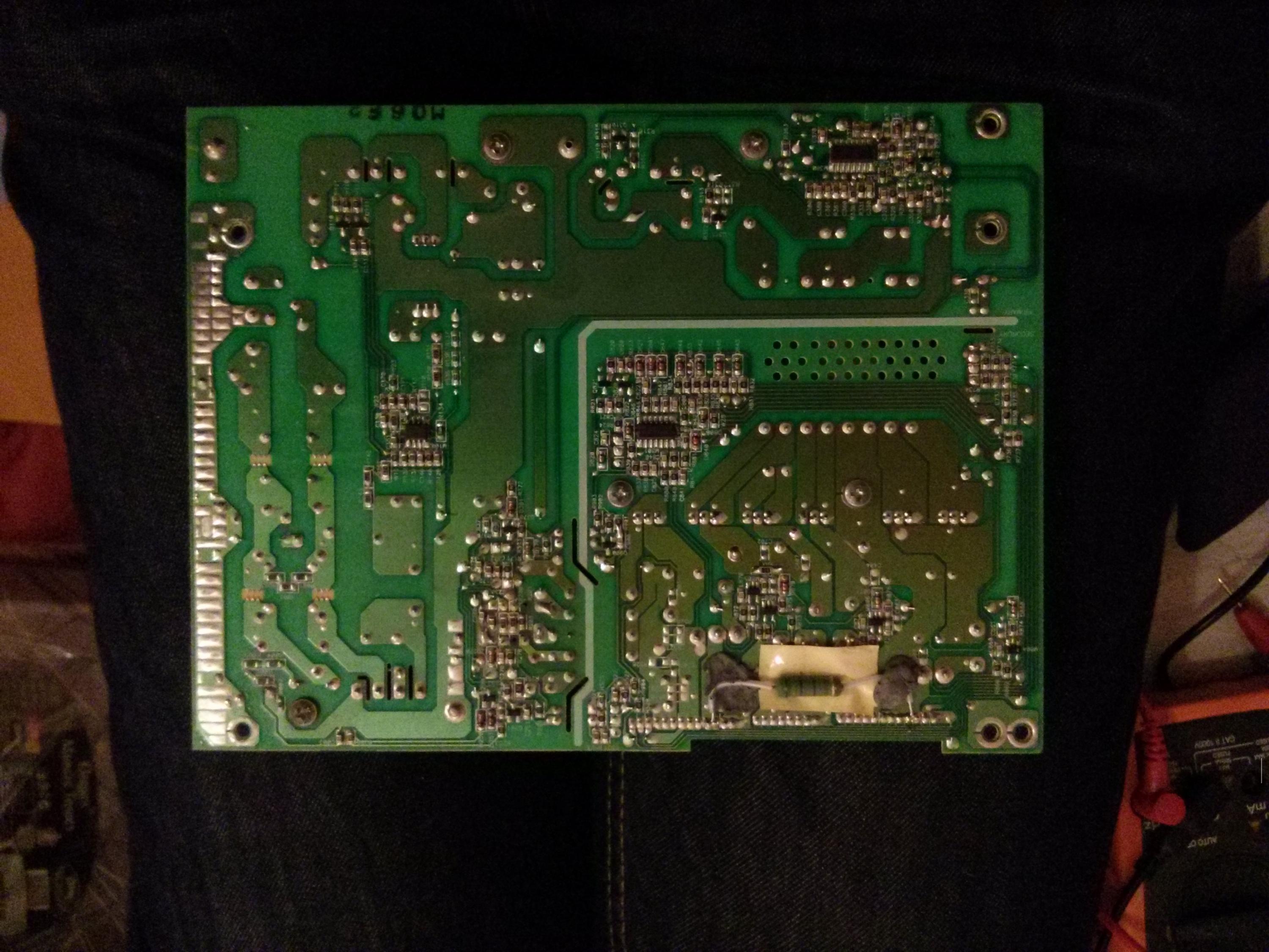

        Also note that there is a bodge resistor soldered to the bottom of the power supply board in the first picture. I don't know if it's a bodge done in the factory or whether someone has been here before me. It's attached between the 24V and the 12V output and is about 500Ω. I thought that it might be increasing load on the 24V line. I've removed it, all the voltages are the same and the TV still overheats.

                  If you look at my photo of the bottom of the board, there are two controller ICs, and there are separate transformers for the standby, and all the other voltages. (you probably already know this :-) )
