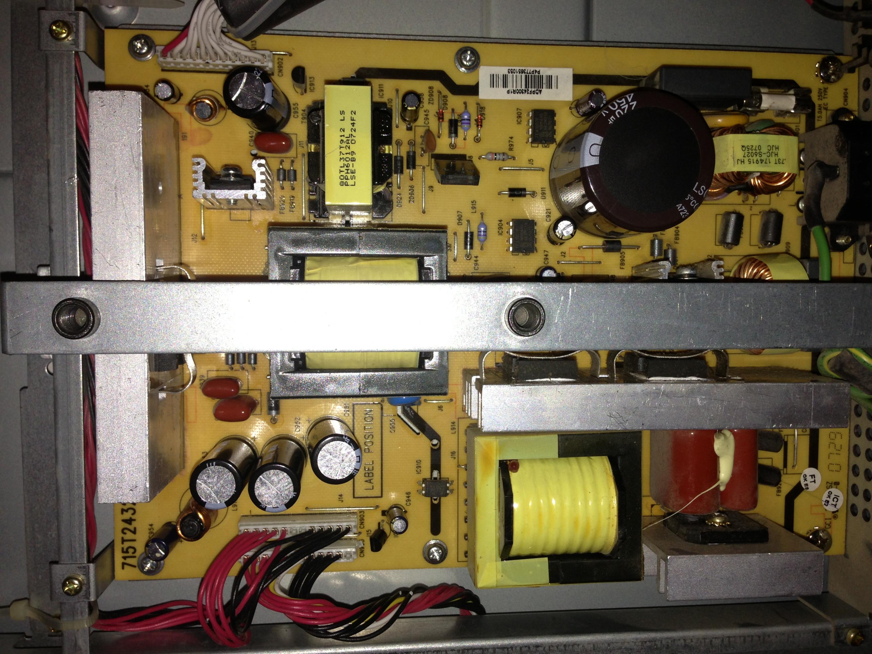

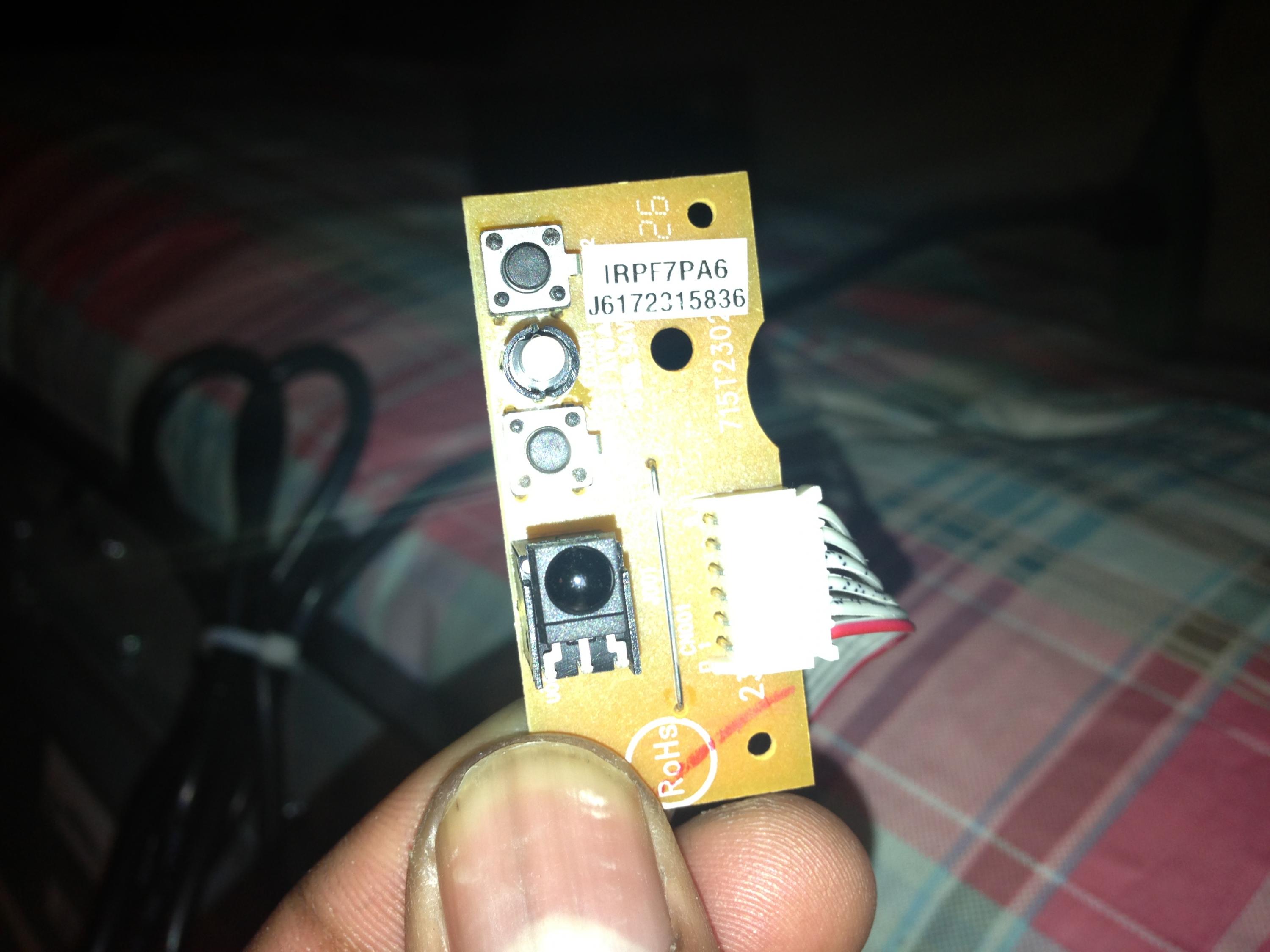

    Last week my LCD starting acting funny. It would turn on for about 3 seconds and then turn off. I read the posts on here about bad caps and I ordered the complete set from LCD alternatives.com. I changed all the capacitors on the power board except the biggest one. I put the tv back together and it immediately turned on! Great! So I thought. I went to change the channel with the remote and noticed that the led on the power unit was not green. The remote does not work, I confirmed that the remote is good because I have another Phillips tv in my living room. Everything works on the tv except the green/red led on the ir board. I purchased a new ir board for $1.51 online thinking that would fix it. It did not. I'm lost here, please help!

    Likely you fixed some of the voltages, and screwed up others (perhaps the 12v from the power supply works , but not the 3.3v now). Have you measured the voltage of all the wires from the power supply to the main board and confirmed they all are within 5% of voltage written on the power board next to the connector?

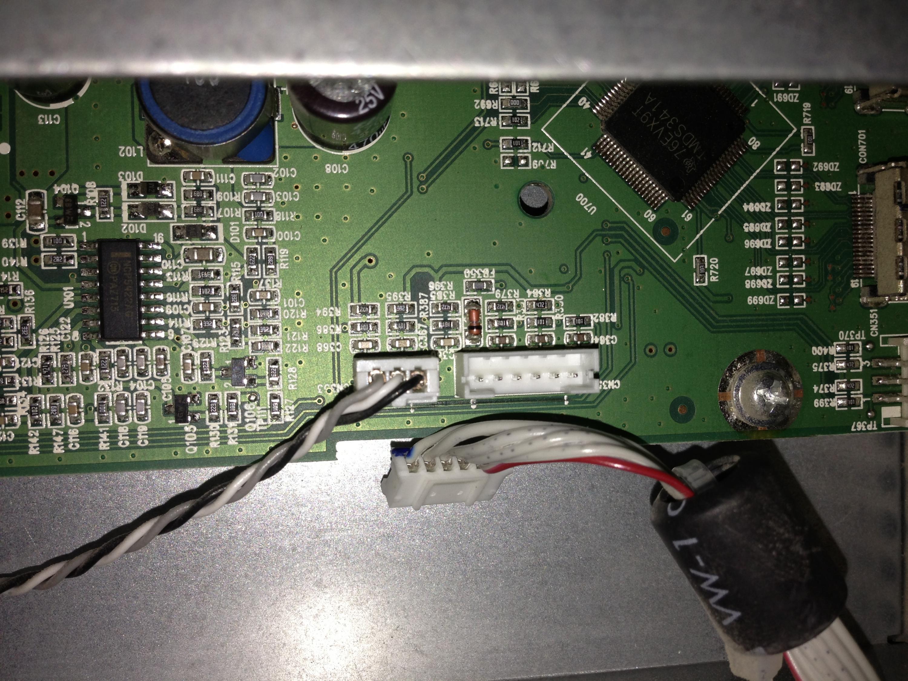

      I checked the 24v and 12 volt power coming from the Power Board. That all seems to be good. There supposed to be a 5v standby voltage on Pin 5 of the IR connector and it is not there. I checked the scaler board FB350 where the 5 volts is coming from and it is there. I think I'm getting close but I still feel lost.

            So if you take the reading at all 3 pins of the IR sensor, you do not get any reading at all?

              I haven't tried that yet, I will try tonight. The Power LED light is not coming on either.

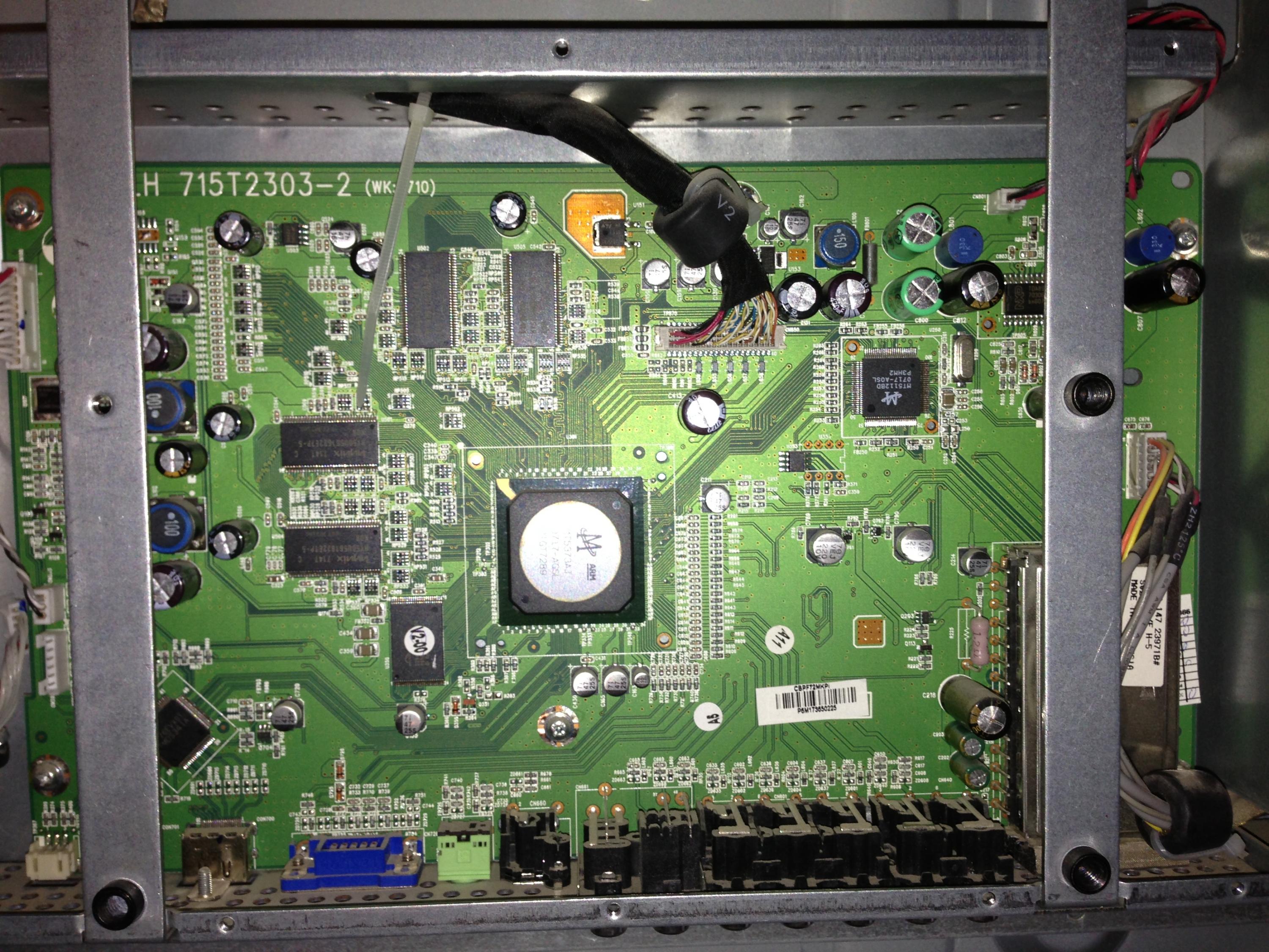

                Have you noticed that you also have several bad caps on the main board in the first picture? They may very well be the cause of no 5V since there are DC/DC converters near them. Look to the right in the picture (I spot at least three).
                  Re: Phillips 42pfl5432
                  At least 3 caps on the main board have domed tops, C218, C807, C812.
                    Two of them are for the speakers, the other one I'm not sure, but they all look like CapXon... UGH...!

                          Ok, just a quick update. I changed all of the bad capacitors on the main board. Tv does the same thing. It powers up fine when you press the power button. I am still not getting the Red Led or Green Led lights on the IR Board. The Ir does not work either. I am really lost here. Any ideas would be greatly appreciated.

                            Do you get any voltages on the main board where the IR board connector is? It's unlikely for the IR board cable/connector to be bad, but I would start from there anyways.
                            Also, which capacitors did you change, just the bad ones?
                            About 9 months ago, I worked on a friend's Magnavox TV that would not turn on. Since Magnavox is just a Philips in disguise, the TV had a similar main board to yours (a DL 715T2294-3). It had bad caps too, though in different places. Therefore, I suggest you replace all of the capacitors and not just the bad ones. The only ones you can leave are the SMD ones - those are too costly to buy and too hard to remove and they don't go bad very often.
                            Another thing I suggest you do is to verify the output voltages on the main board. Those round blue inductors that have "100", "150" and "330" written on top of them are all filters for the various voltage rails on the board. If the internal layout of your main board is anything like mine, one of these inductors should be connected to 5V (actually, in the case of the TV I fixed, there were two 5V rails - one for the main board ICs, and one for the build-in DVD player).
