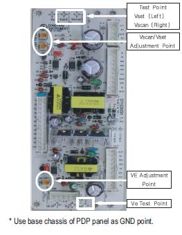

        My guess would be a Yrr/Yfr problem. These are the adjusments on the Y-main. Or, it could be a Vset voltage issue, or a bad capacitor on the Vs or Y-main.

          Would you mind telling me which is which and how to test their voltages? Here is a picture of the board i'm working with. Any help is greatly appreciated, thanks for the epic fast response too
          You can tell me the one on the left and right, as the picture is sideways. I already know where the pots are located just need to know which is which and what they should read and how to read their current value.

                            Vs should be within 1V, ideally, within 0.5V, of the panel sticker for proper operation.

                              Ok, they are all tuned there i just double checked. I think the issue is heat related i'm going to try to track it down. I notice the Y-main heat sink with the mosfets is much warmer then all the rest is this normal?
                              I let the TV cool off for about 5 minutes and it failed to power up again, screen flashed until i turned brightness down to 0.

                                  It should be within 1V from full dark to full white, measured at the PSU end. On the sustain board some fluctuation may be tolerable.
