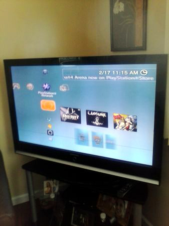

    I have a chance to buy this TV. Seller says the horizontal line was there from day 1. Is this a bad panel or fixable? I hope the photo is good enough.

    looks like a lower buffer board issue. i believe this is a samsung plasma set if memory serves me.
      Re: HP-S5053 Plasma
      Careful. Lots of issues with bad panels on this model causing the same issue. Rare for buffer to fail in such a way. Possible... but rare.

            Re: HP-S5053 Plasma
            I have had that on a Samsung PS50Q7 which is identical chassis and panel to that and it was a simple reseat of the buffer connector. That was not the original fault, it was introduced whilst I was using it's buffer boards for another for fault finding.
            One of those things it may be simple fix, a buffer board or non repairable which you can't really tell until you get it and play with it.

                    Yes, it's a plasma. I also agree with Tom that I would tread lightly on this one. I wouldn't think it's a buffer issue if "the horizontal line was there from day 1" and the TV appears to be at least 6 years old (I guess it depends on what the seller means by "day 1". He may have bought it used himself). There's some service info here: http://www.toms-service-manuals.com/...&Search=Submit
