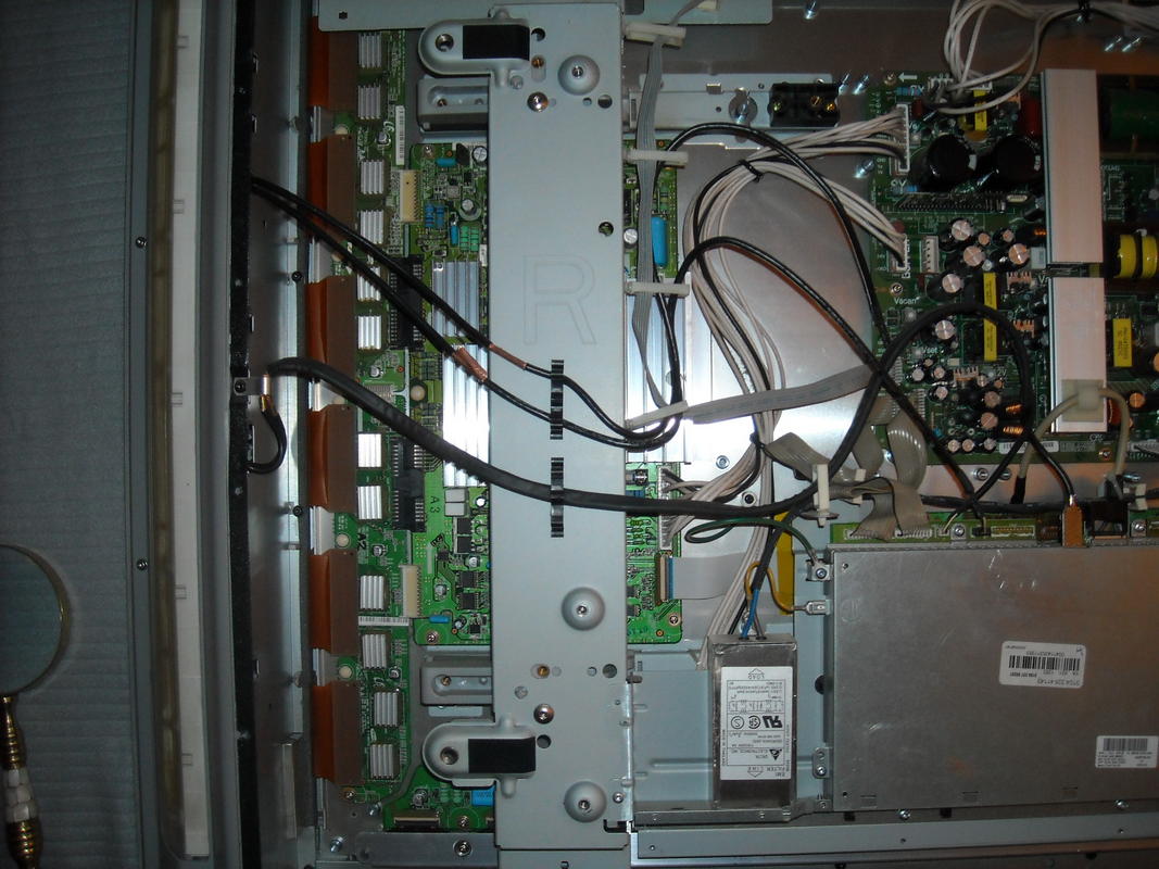

    Hello Badcaps members. I'm working on this set with the notorious bad buffers. I was hoping to find the bad caps on the PSU but it appears that it's the Y Main/Y buffer issue instead.
    I have confirmed this by disconnecting the Y power feed and then the set will stay powered up. With everything hooked up, the set does the 7 blink and shuts down.
    So, the question: How in the heck do I get the Y Main and buffers out?
    I have removed the vertical main structural rail and all screws on the main and both buffers. It still seems to be attached somewhere near the connections between the buffers and the main.
    I am wanting to remove these in order to test the y main and each buffer to get a better idea of what has happened. I am aware that they should all be replaced together and I doubt that will happen due to the extreme cost It would still be nice to at least check them, if only for my experience
    Thanks!!!

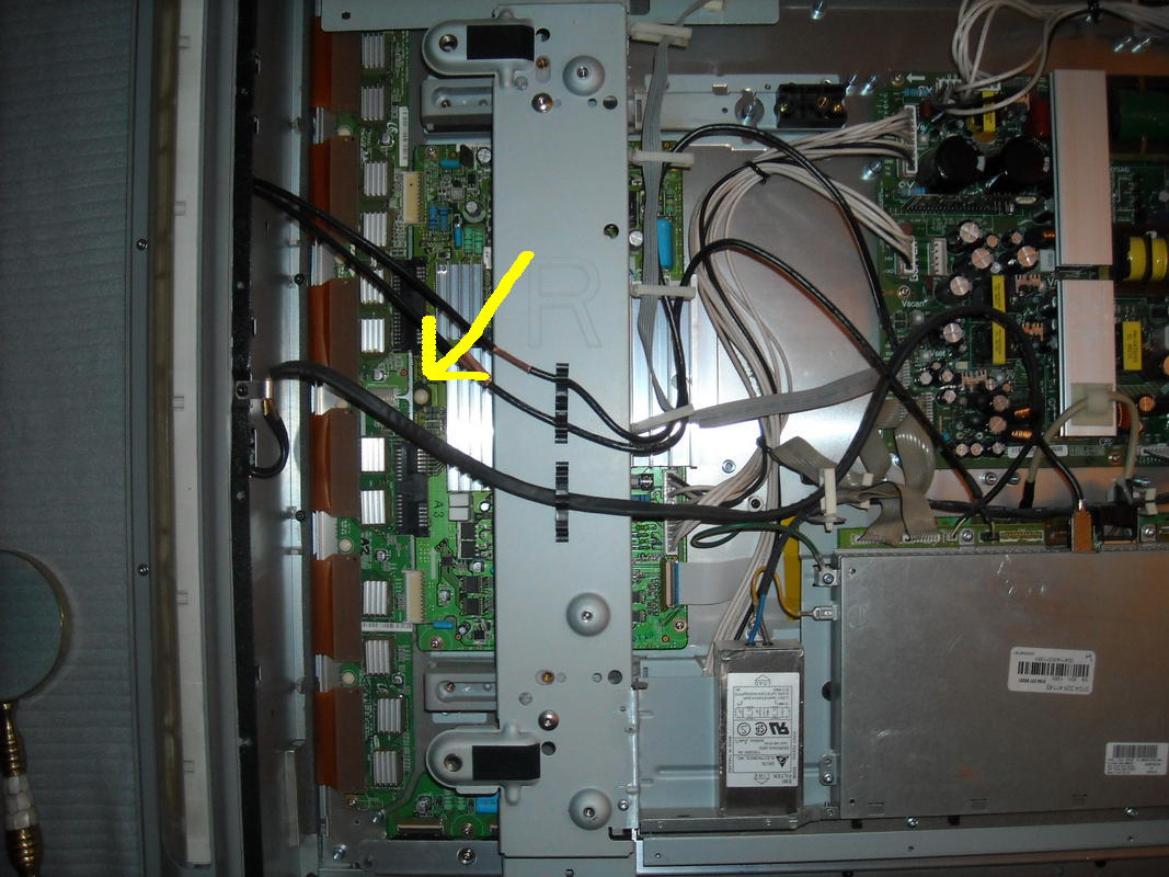

      ah yes! I was eyeing those thinking they may be the culprits.
      There are a bunch going down the left side of the buffers, but they are not securing anything, as I can lift the boards there a bit.
      There is only one on the y main/y sus, and it does appear to be attached. Only problem is, I cannot get to the underside to squeeze and remove??
      Thanks again

        Here is a pic indicating the release tab that I cannot get to.

          Re: Philips 42PF9630A/37 42” (plasma)
          it may be the one with the push down button. if you push downward on the button what happens?
            I appreciate the help. Pushing does not appear to do anything. It doesn't have any "give" when I push. I've been watching videos and searching high and low on the removal procedure!
              get a closeup of the tab, i can't enlarge it enough to see which type it is.
                Okay it's out Turned out there wasn't anything else securing it, it was just kinda snug and I was scared to pull enough. lol
