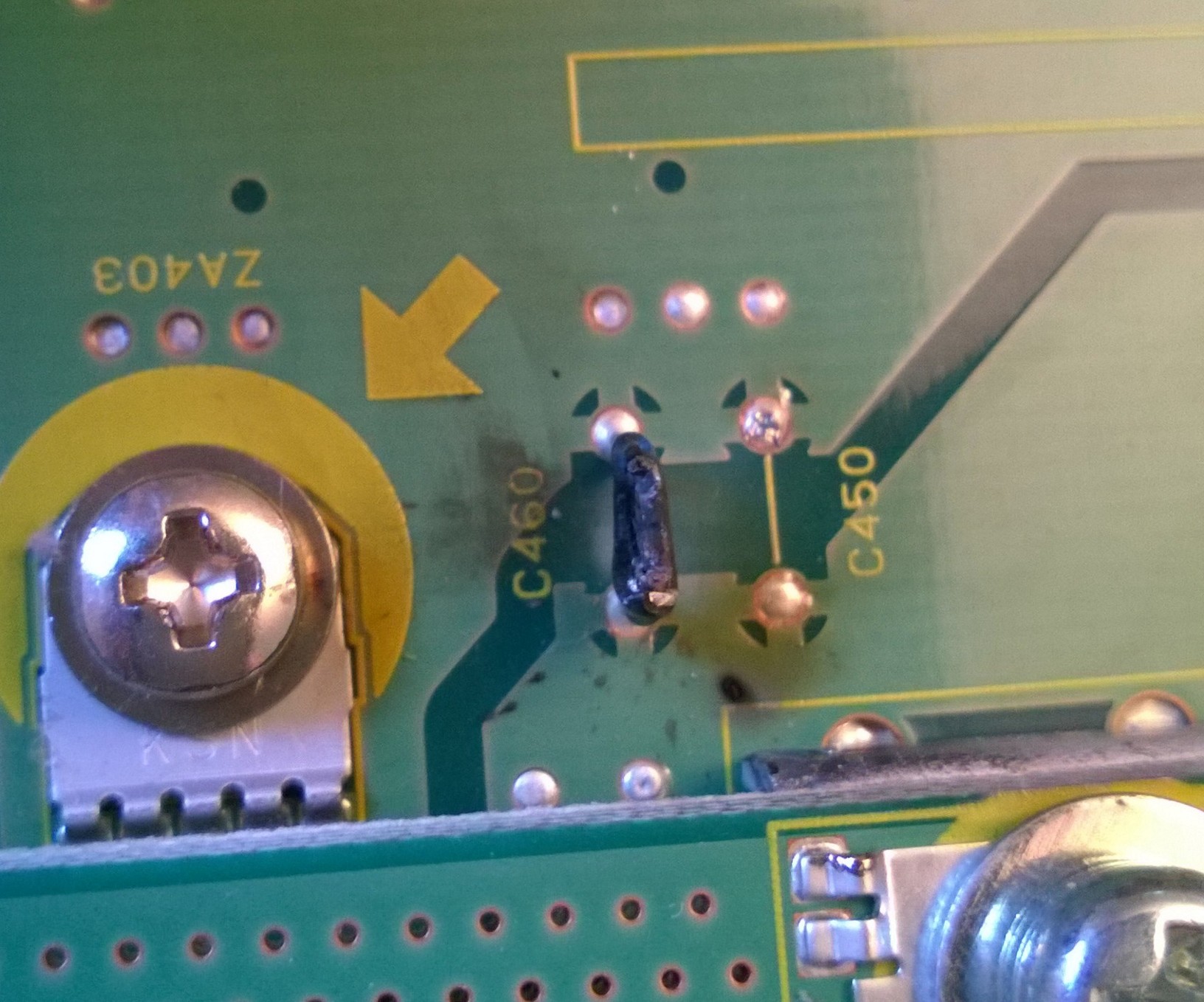

            Hi All,
            I have a Panasonic TC-P50VT25 tv. The other night I had a pop from the upper right rear corner of the TV and it went dead. I found C-460 blown on the board identified as TNPA5081 Rev K.
            I need to identify the value of that cap can any one help? Also any ideas as to what may have taken it out or is a just a bad Cap?
            Walt

              got a picture to post? So it rev AK. I have not touched any 3D model boards so not 100% if the repair is the same as some of the cct is different but might be able towork it out. I have an AK here so I'll look or the service manual parts breakdown will tell us. Standby

                Actually I have AY but same board really, that's really unusual to find this blown?, it's a 630V 820pf cap, type unsure but I'm really curious to get a view of what you see.

                  Oh, no it won't be just a cap issue. The pop I would expect would be the transistors popping. Start with Q661, that one always shortsand others etc etc

                      If you want the real McCoy, this is the part number (Panasonic number who knows the OEM brand)
                      https://www.partstore.com/Part/Matsu...1A002/New.aspx
                      found this description with a google
                      CERAMIC CAPACITOR MULTI LAYER F1E2J821A002 (SPARE PARTS FOR PANASONIC PLASMA DISPLAY).

                        Re: Panasonic sc tnpa5081 rebuild
                        tw2005 thanks for the help
                        Q661 appears to ok and I have attached a pic of the blown cap (C-460).
                        wveno49

                          Wow. What can I say, looking toasty. No idea on that one.
                            #253
                            Will be ~100pF capacitor for EMI filtering... can be safely removed for testing but should be installed for proper repair.
                              I managed to ID it and they're 630V 820pf .
                              As far as this board goes, all I could suggest is check all IGBTs and diodes on the heatsinks for shorts,
