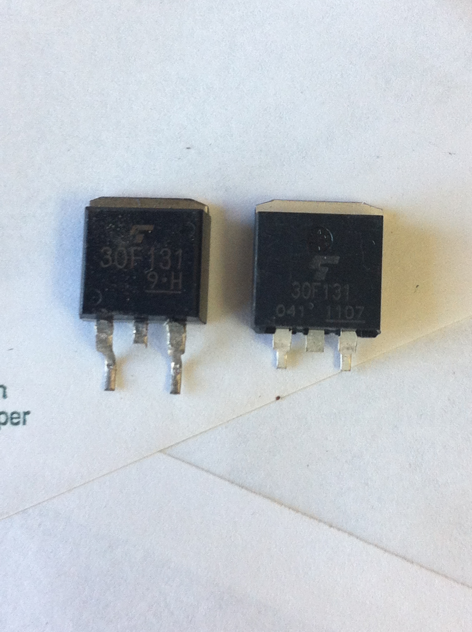

                          It's been a while since I worked on these boards. My customer bought repair kit from Shopjimmy for his TCP50G25 and now I'm installing it for him. Board version is AF. Here is list of parts in this kit:
                          Q660
                          Q661
                          IC501, 521
                          IC771
                          D451
                          D702
                          D482
                          Q701
                          Q421,422
                          R402,403,421,422
                          D641,642
                          Q452
                          Q402,403
                          PC461
                          And last but not least Q818, and I have question about this transistor
                          As you can see in pics, original one is smaller and marked KN, replacement in the kit is little bigger and marked K72
                          I still don't have a schematic for this sustain and don't know anything about these devices, are they interchangeable or is it a mistake by someone who assembled the kit? By the way original q818 measures fine, at least same as on my other working board version AL
                          Also some of the parts were fine on the board, mainly resistors, D641,642 RF2001, D451 they survived, but I replaced them just in case
                          Oh! Almost forgot, HA inverter was not on the kit!!!!! And it was bad, of course, luckily I have plenty of them in stock
                          I have not plugged board in yet
                          Any thoughts tw2005?

                            Yeah, strangely I was having a sticky last night at the prolific expansion of SJ kits and this one in particular. First thing I noticed was that very fact that the schmitt inverter was missing.
                            I think SJ is just copy catting other kits and not basing them on their own research.
                            A rather big mistake omitting the schmitt inverter in my opinion as this will result in Q661 blowing and most likely the other small transistors .
                            If I was going to leave a part out, PC461 would be it but one of mine was shot.
                            Q818 is a bit tricky checking in cct. Original is a 2SK3018T106,however the K72 is a 2N7002 and will sub but yes is a larger package. That's what I used on the ones that were bad only because it was easier for me to get but soldering it will be a small compromise.
                            I would err on the side of caution unless you're 100% happy because on my really bad board, I thought it measured ok initially but found a descrepancy down the track which caused me a lot of grief blowing Q661 a few times.
                            Or remove from cct and check with a good one. If you have a replacement, just as quick to replace it I reckon.
                            Pretty much anything wrong in the inverter cct or the small 0.1A 5V reg that feeds it if bad will destroy Q661.
                            Q660 was ok on my 3 boards.

                              Success!!!!
                              TV fired up fine, I was on cloud nine, customer had to pull me down
                              But before I delivered it, I decided to check one more time and here they were, I missed pair of 30f125's, sure enough they were not included in the kit.
                              So, I'm thinking what was the reason I had no success on previous repairs on these sustains? Was it Q818, was it opto coupler, IC771 or was it D702? I have not replaced them before. Q818 out of cct measured strange, reading was kind of running up to .550, not instantaneous like on the new one, so I think it was leaky, as for coupler, reading was slightly off, as well on others by a bit too.
                              All in all kit came handy, was missing key components, but we already know about them anyway, right?
                              By the way do you know specs on DG402RP and DG502LW? Could come handy one day

                                Rough figures would be 430V 40-45A, peak pulse 230A & 540V, 40-45A, peak pulse 230A IGBTs, Vce sat 2-2.5V the 2PG006,009, & 011 were their predecessors.
                                No 30F125, well that's another cockup then. I'll go with Q818, my opto was obvious , had short but that was only 1 board of the 3.
                                Yeah it's a bit of a thrill with so many bad bits to jag it. Heaps of kits and repair services now for this one. Prices are still high although Moduslink are ok but weird how an AP and AF somehow cost different to repair?
                                With the other parts were they identical to OEM? More interested in the OPTO and it's markings and any of those TO220 packaged diodes if supplied.
                                I guess you did not photo the kit before install?
                                Blindly trusting a kit is a risk for sure. To make the kit complete you'd need quite a few parts. GTV Watford would most likely have the most accurate kit in the UK but a bit pricey.

                                  No, I did not take pics, bummer!
                                  Some of TO220 components looked aftermarket with thin pins, I was even afraid to brake them while bending for install, I just don't remember which ones. Q661 was substituted by RJP63F4A FYI
                                  So in case I'm short on DG402, which currently I am, is it OK to sub them with DG502's?
                                  I would recommend sourcing parts individually, I usually get small components like HA inverter, 3Y marked transistors or micro SMD diodes directly from Panasonic, they are inexpencive and OEM quality. As for TO220 I source them from IBM trading in HK, if they have what I need, or Chinese suppliers. Sometimes you get lucky and parts you get look real OEM
                                  Once though, I ordered 30F131 SMD IGBT's from Utsource and they were horrible, package was visibly smaller then OEM, did not risk putting them in, reordered with IBM and got real deal

                                    I know what you're saying about the thinner leads. I was sus too but they did work and I used UTSOURCE. So IBM trading is your tip. Are we talking internet / Ebay ,??
                                    You could only try switching DG502 for the 402. As far as voltage and current would be no issue.
                                    That would be a nice experiment for you and then share the results.
                                    I'd like find some subs myself that would make it easier to get parts from conventional sources.
                                    Did you contact UT about the parts? I suspect if any were bad they'd refund. In Ebay that's what I saw but that was a while ago.
                                      I use Ebay, it's easier to control shipments and communicate with sellers
                                      I just got 3 or 4 from UTSOURCE, other parts in the order were fine, so I figured why to bother. But here is a pic of 2 transistors side by side, so you can see the difference
                                        Yeah, i'm guessing the left are the ones you're not happy with.
                                        That is the problem from china, fakes. I'll have to pay close attention to what UTSOURCE sends next time. I don't think all of it would be fake but that example looks bad .
                                        also, we just had our second thread regarding TNPA5081 SJ kit no good.
