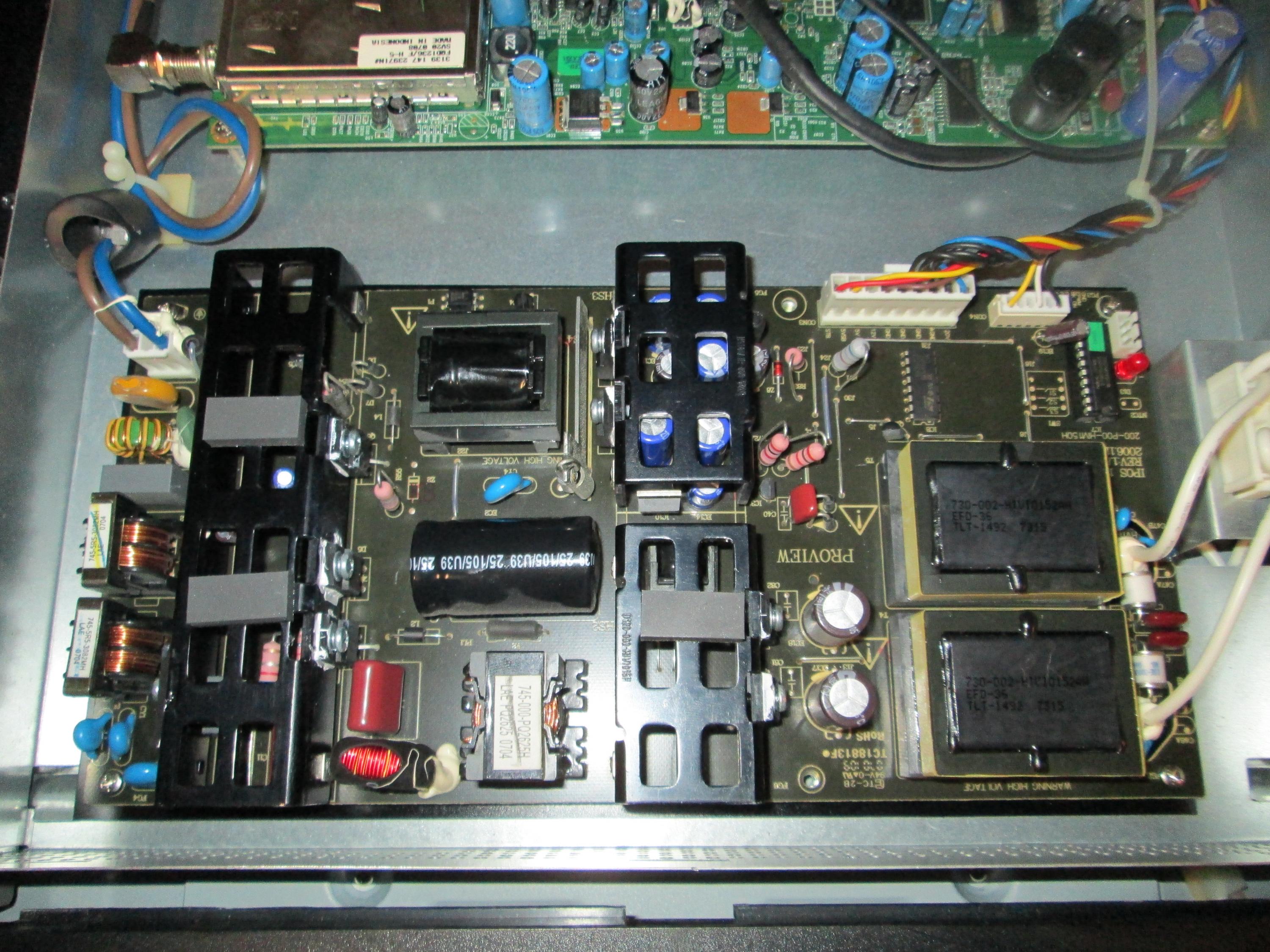

      This one is also known for two bad caps (10uf 450V) for the inverter circuit.
      http://s807.photobucket.com/albums/y...cpZZ1QQtppZZ20
      You might as well replace the caps as a set.

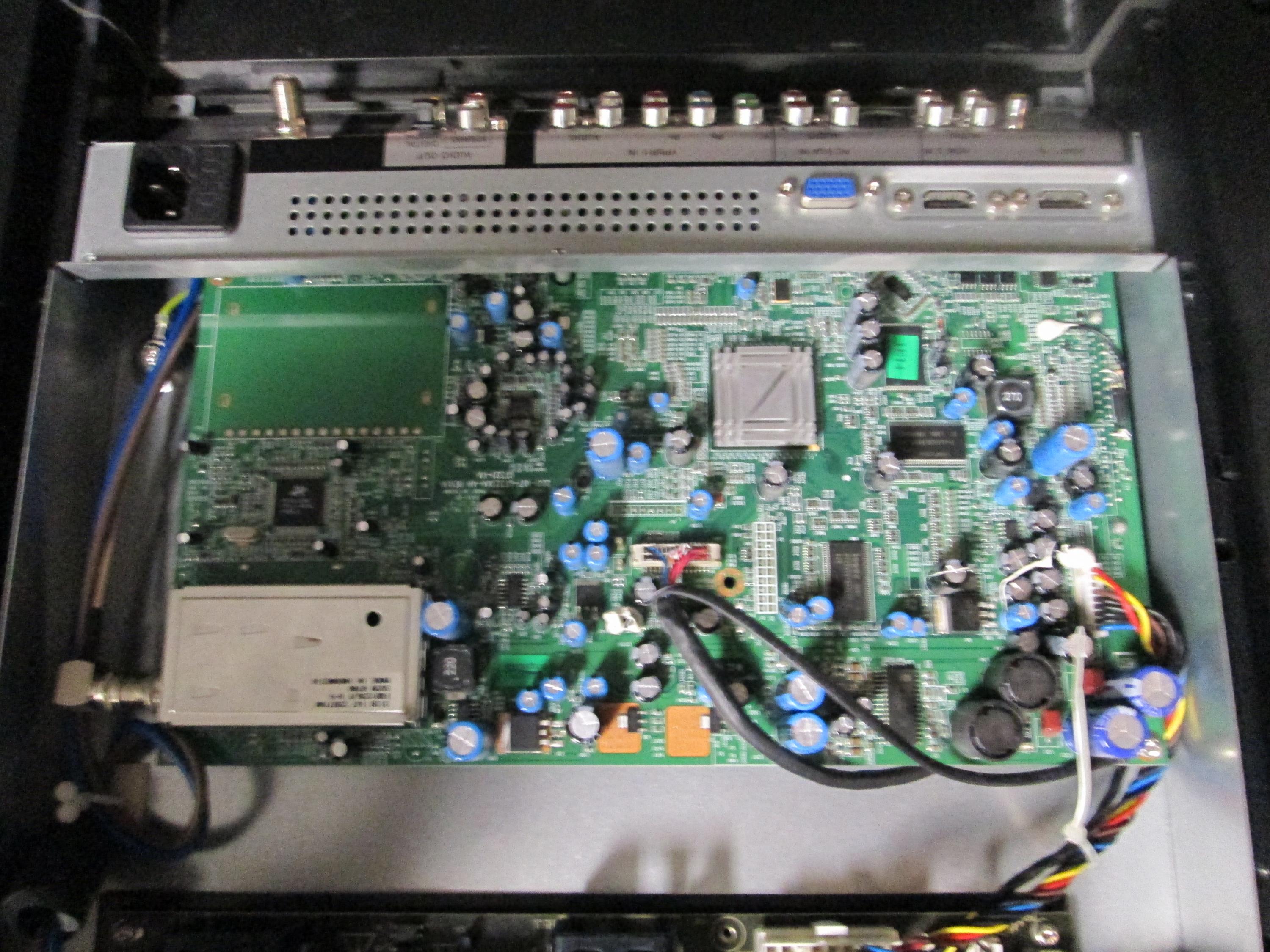

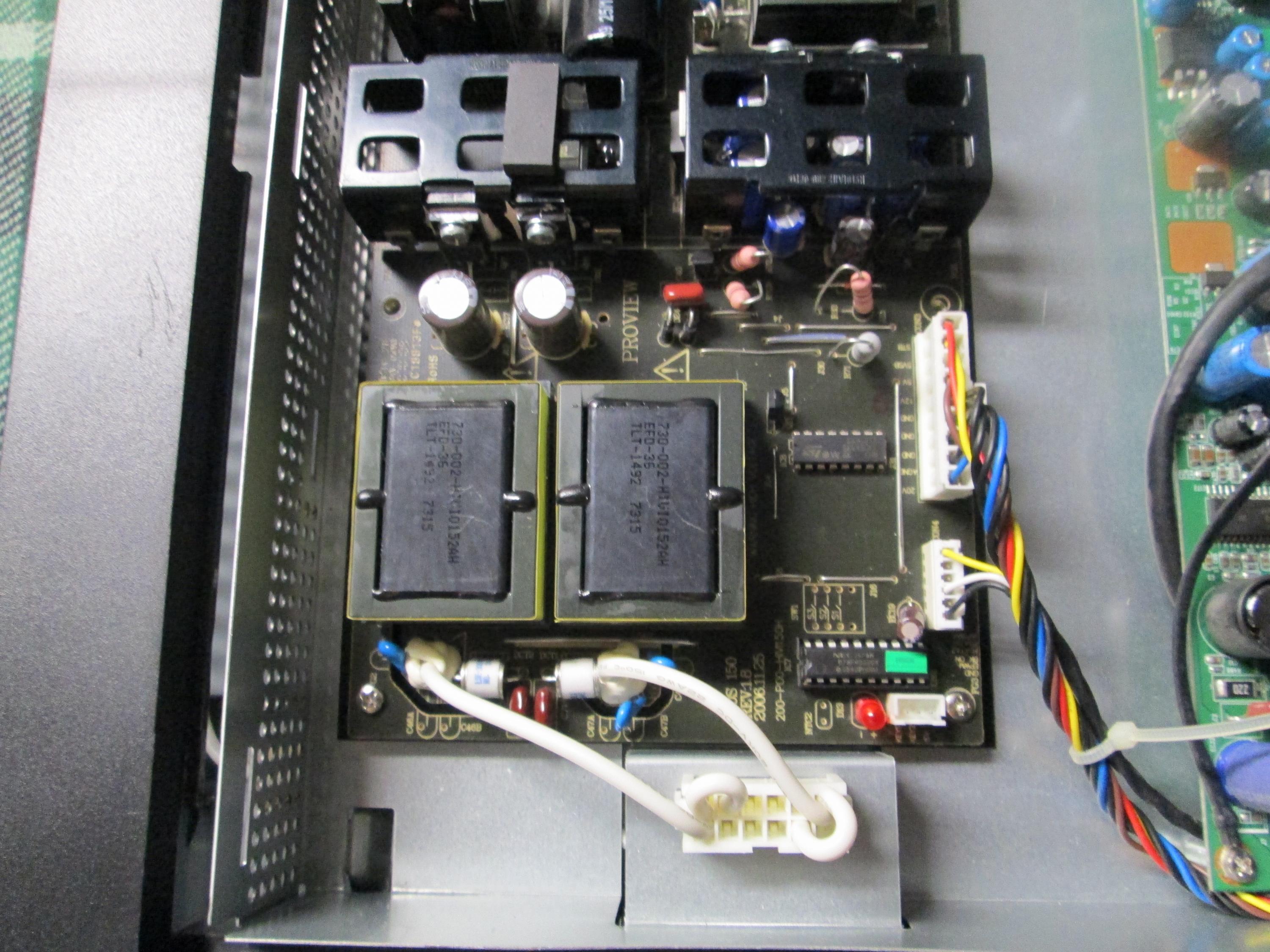

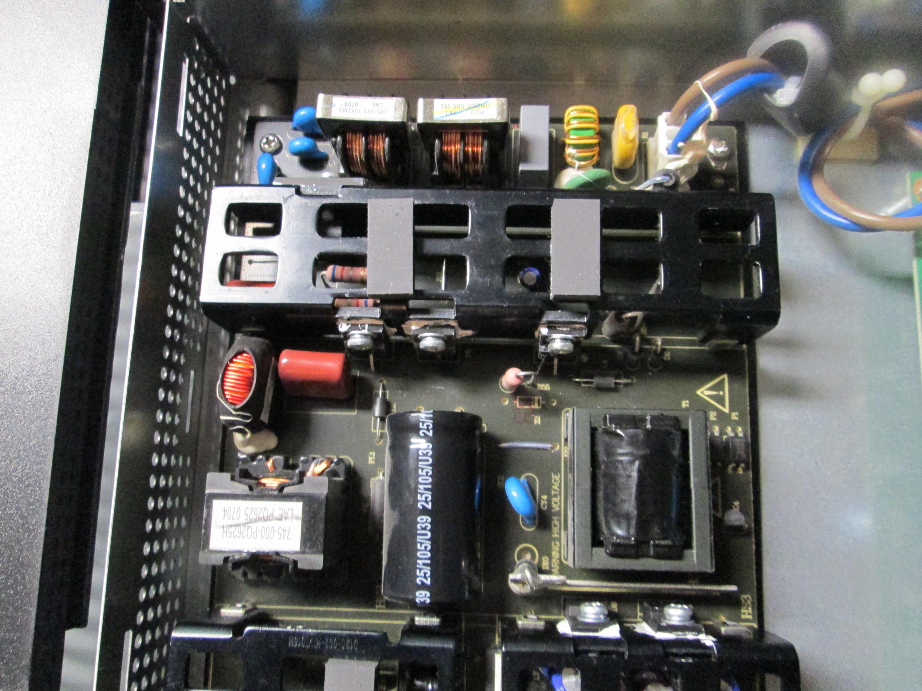

          How about the pictures of your board?
            Re: Polaroid TDA-03211C No Video
            let me do that and post it.
              Here we are the pics.

                              You will have to change the 2 450v caps. I replaced every other cap on the one I have and it would not work until I changed the 2 450v ones.

                                  Mine looked fine also, no leaking or bulged tops. But pulled them to test, one 22uf 450v cap read 1.8uf the other would not read. both were bad.
