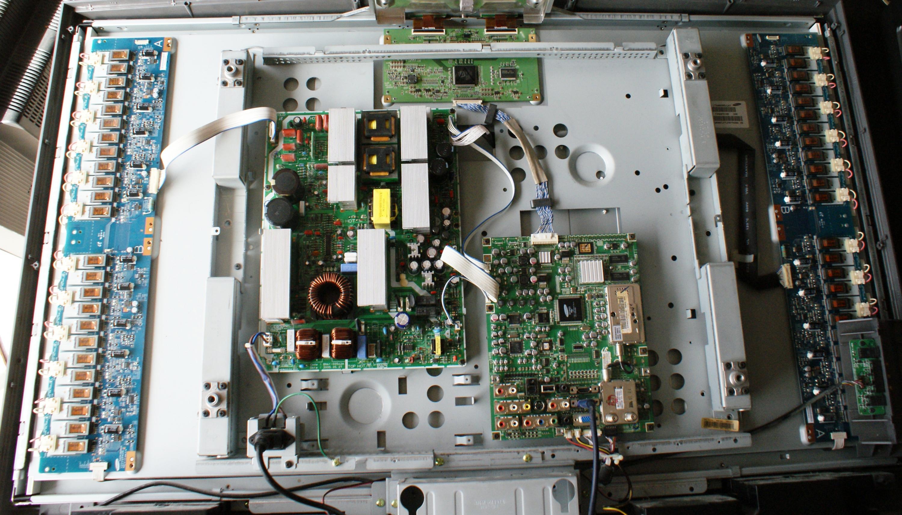

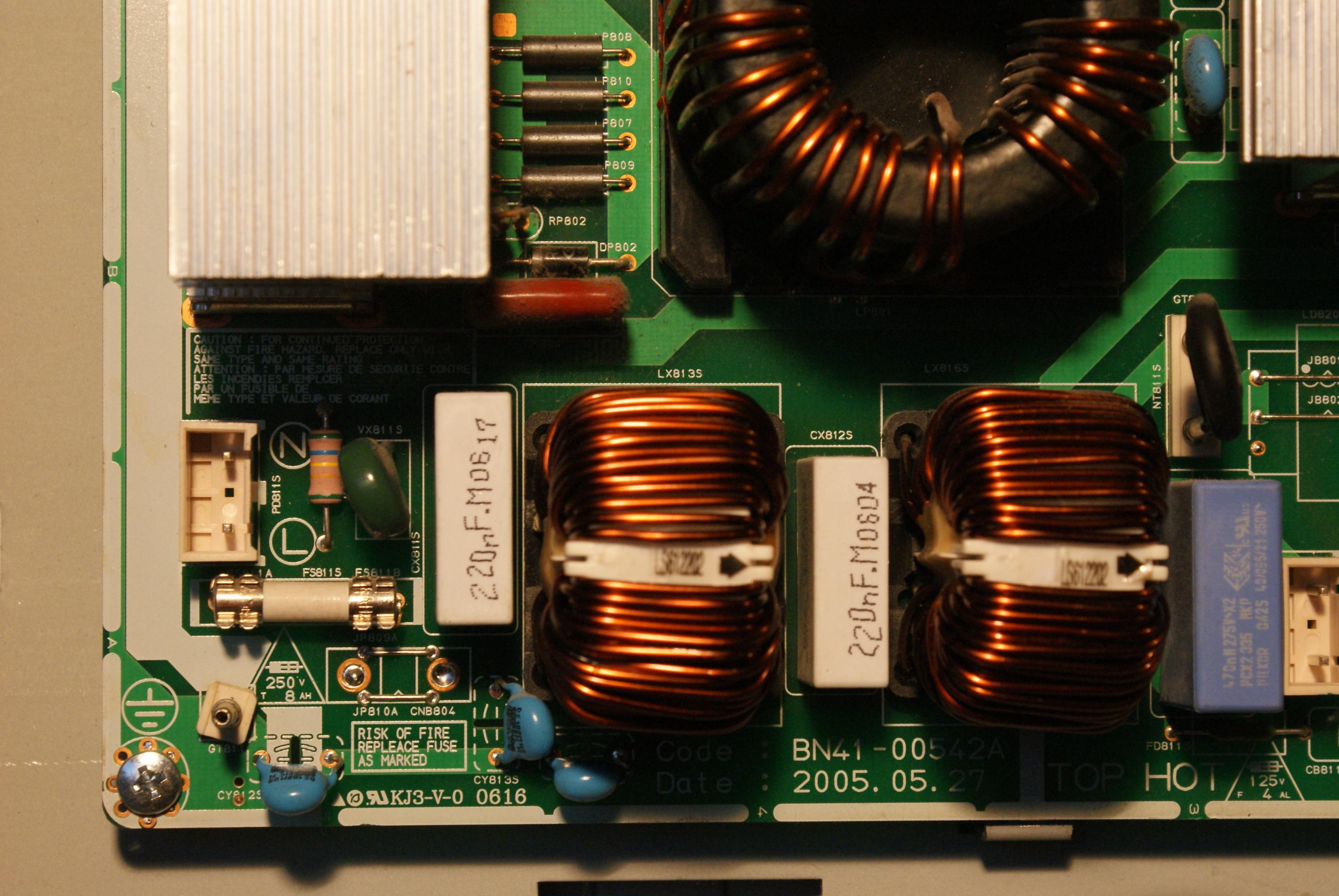

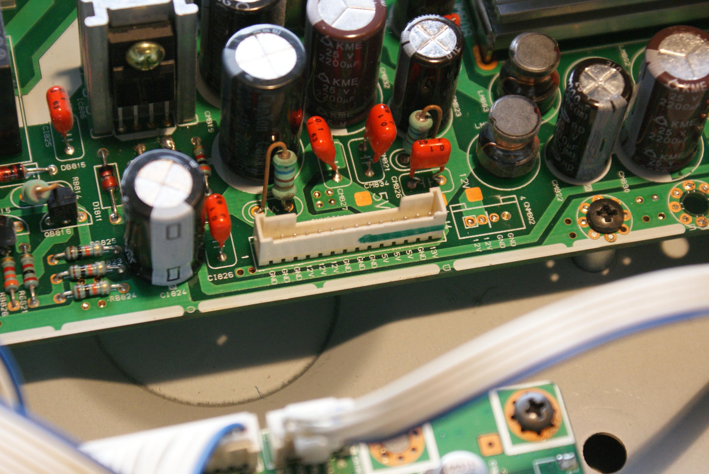

    Hi, i been reading all the information on this problem and i decided to get in line for the first time. I will try to give you all the inf i can. This tv was giving to me because it power on, you can hear the video but no picture even when i put a flash light close to the screen in a dark room. When i got it i replaced a bad capacitor on the power supply CI824. Other than that i check all the voltage everything find except on CNM801 i am getting 11.98 not 12v. and on CNM802 i am getting 1.3v not 12v. How can i correct that?

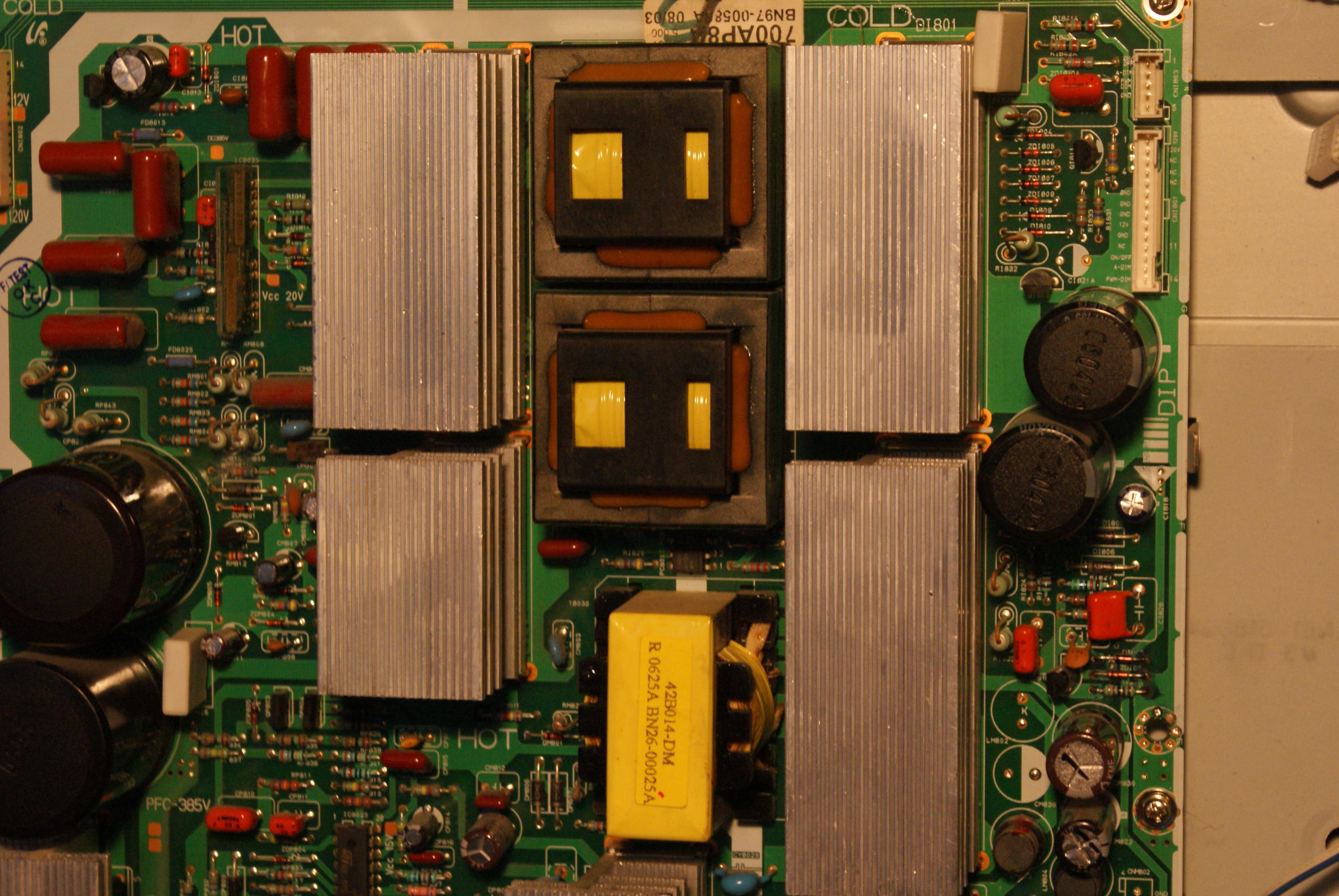

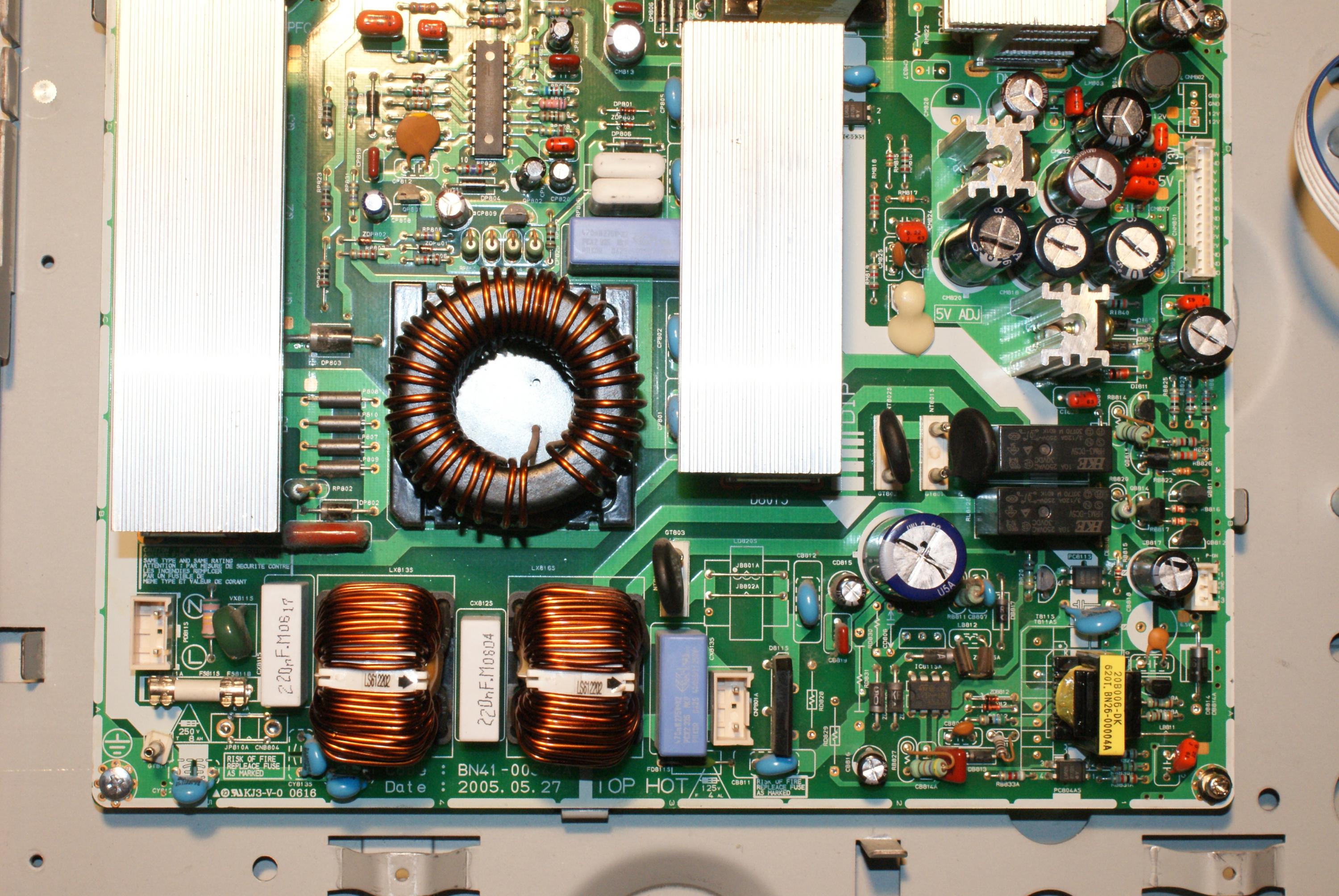

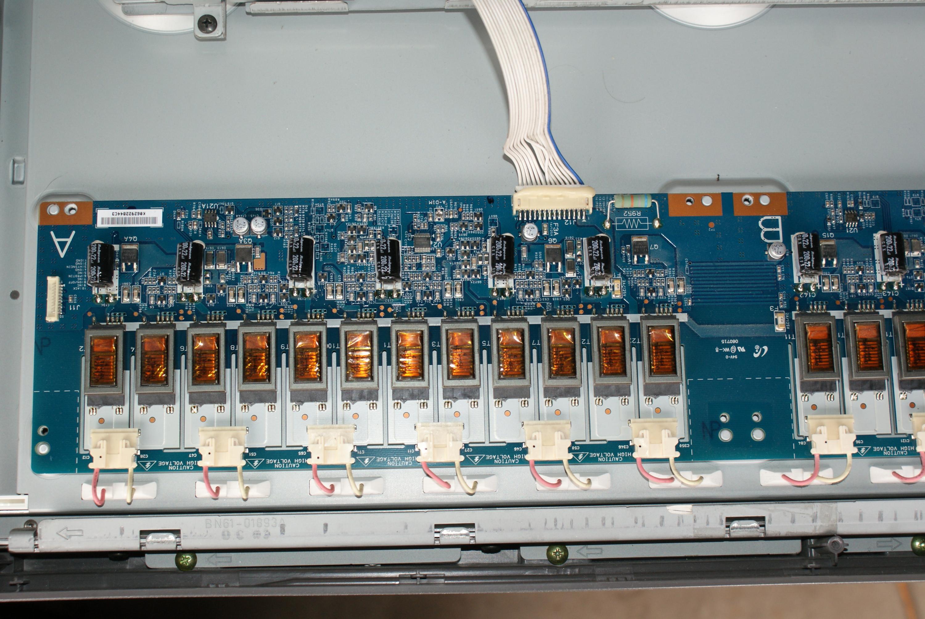

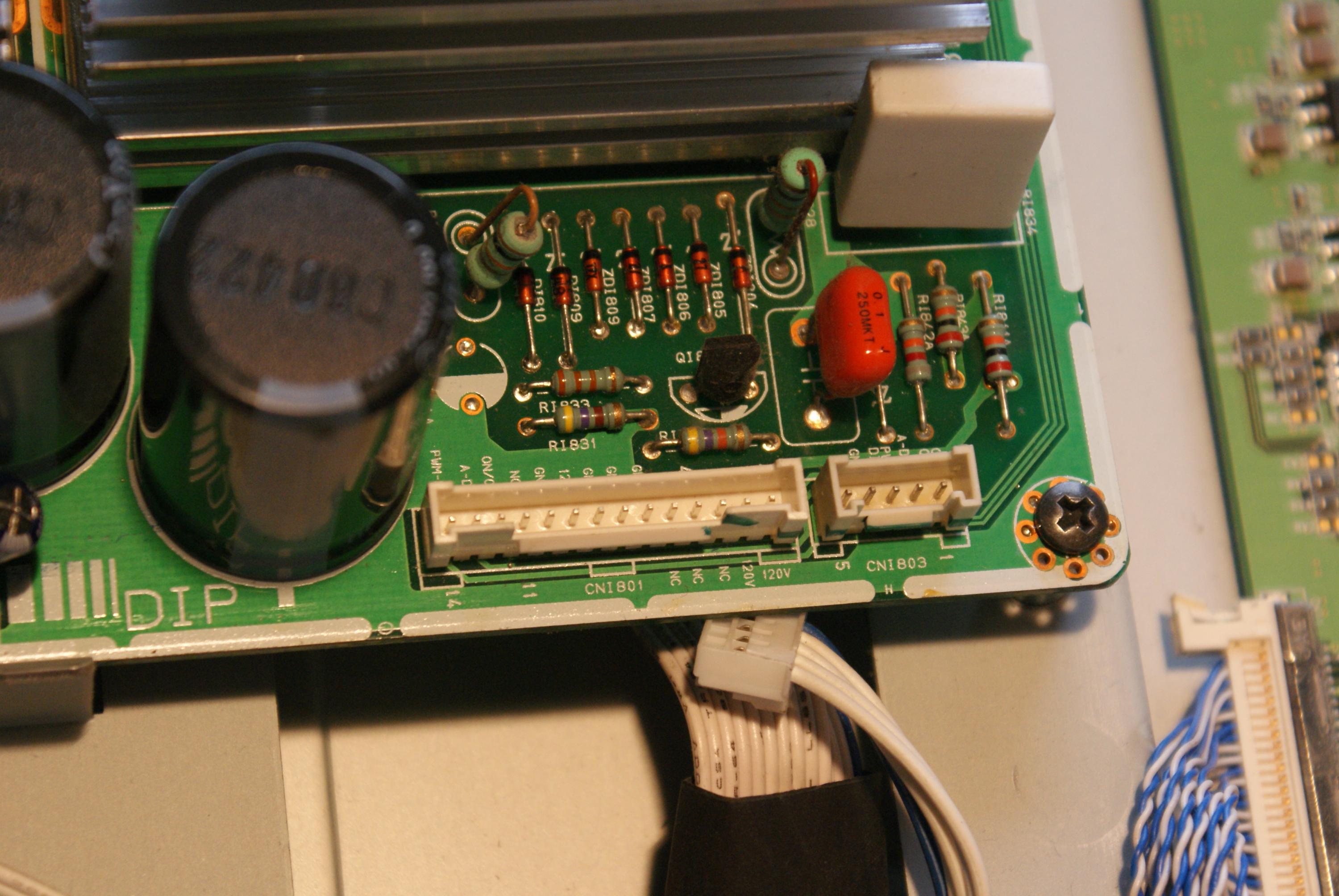

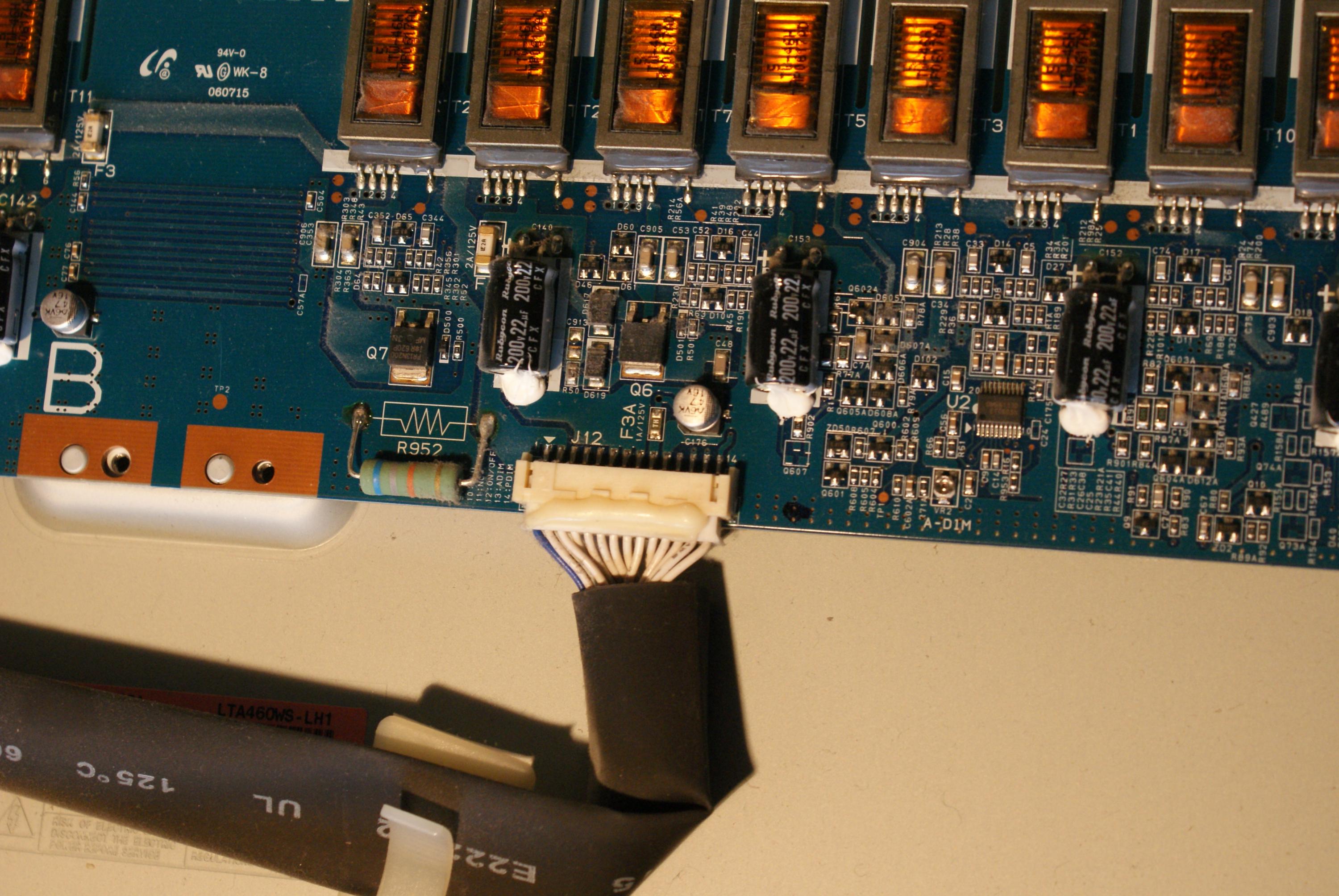

      Can we get the close up pictures of the inverter boards, power supply board connectors so we can see the labeling? Power supply board P/N?

          Re: samsung lns4692dx audio ok, no video
          are this good?

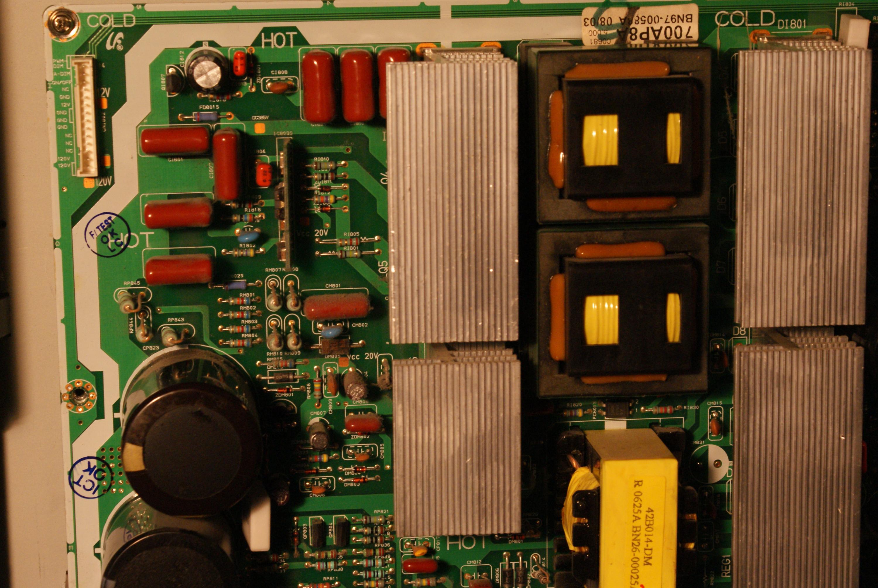

            power supply bn41-00542A

              Do i leave or do i keep waiting?
                Pics are good, sometimes post can get buried if forum is busy.

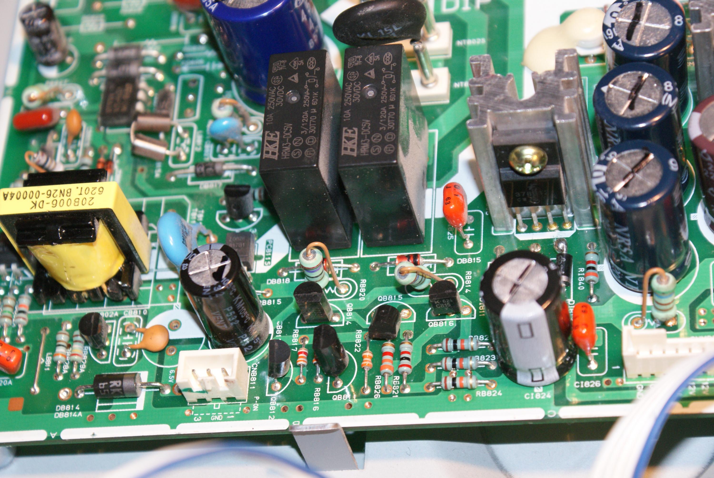

                If you are getting 1.3V on a 12V line I would suspect a failed capacitor that might not appear obviously bulged.

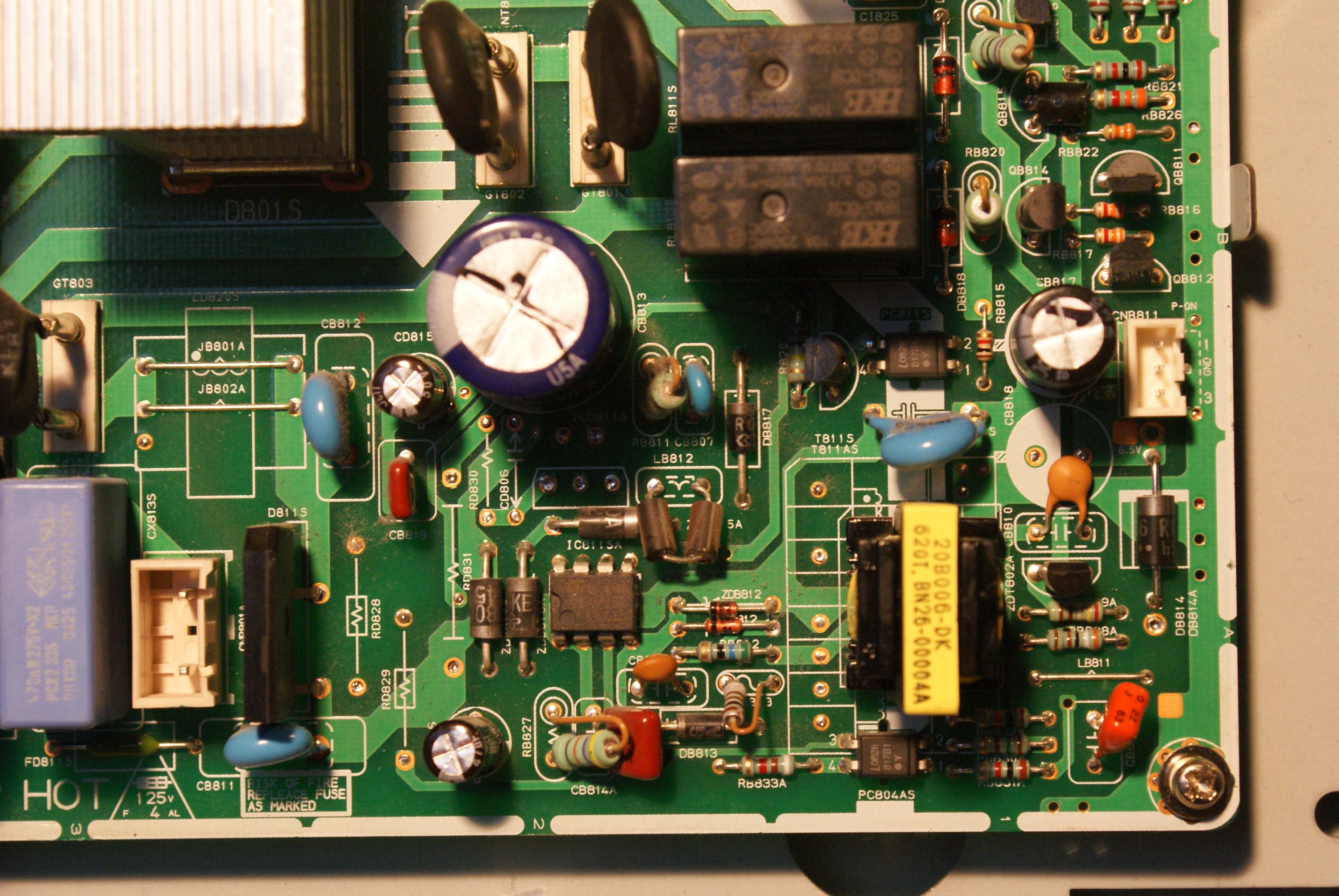

                  I will go ahead and change all the caps. Will keep you posting, Thanks, you guys are great!!

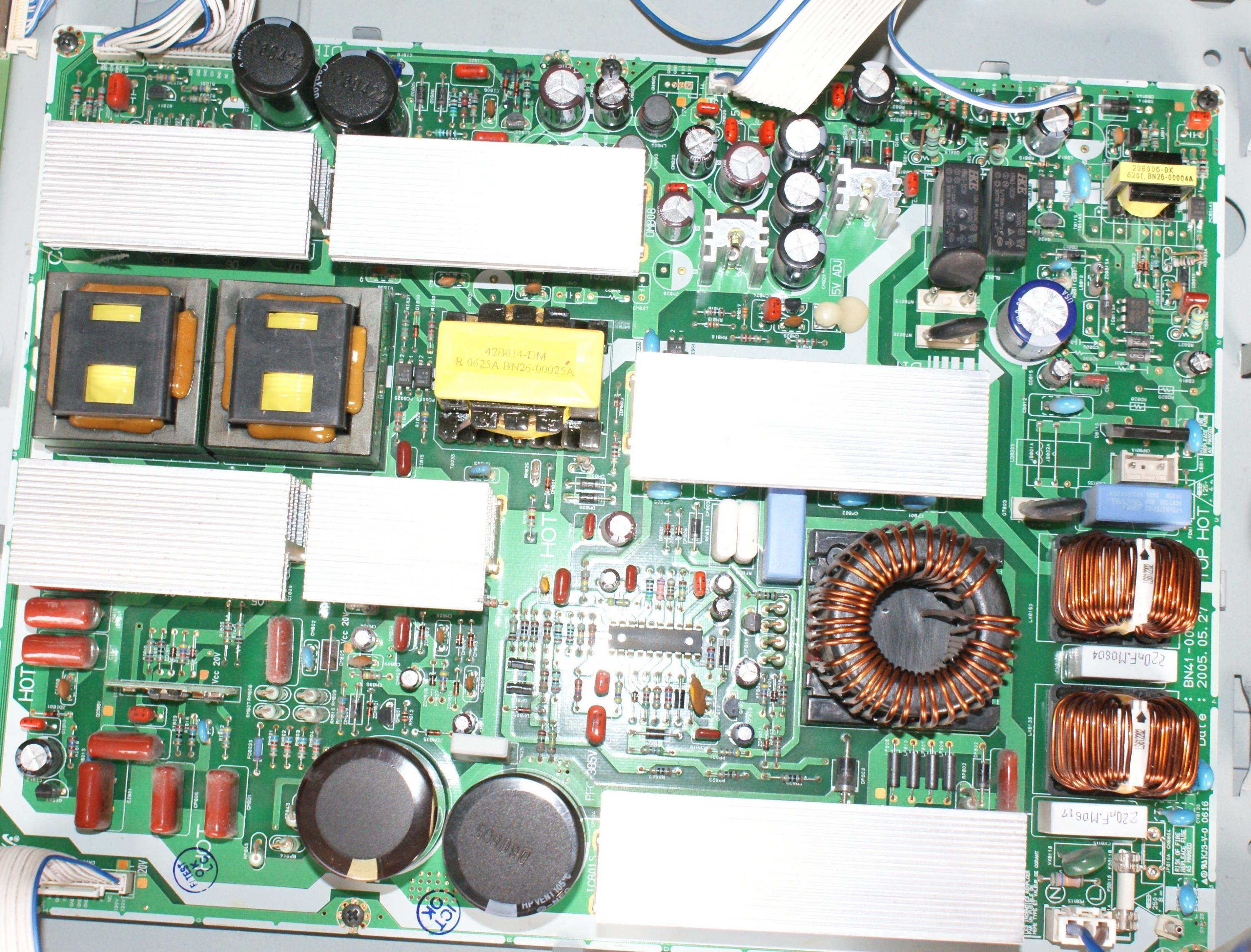

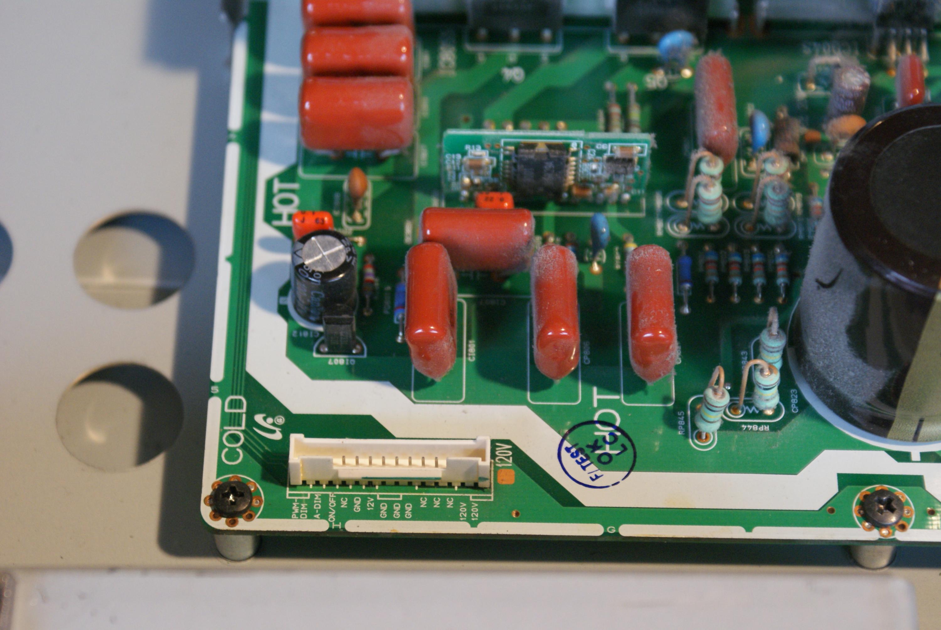

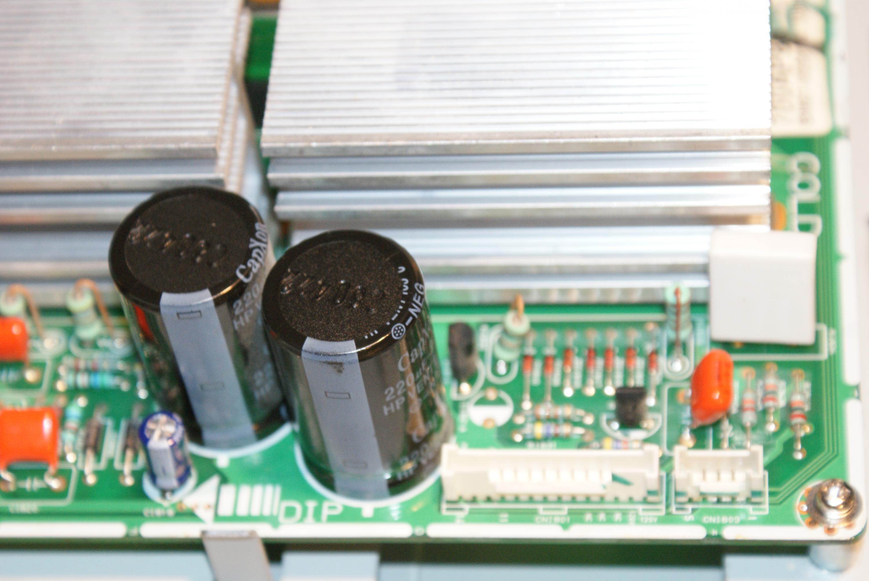

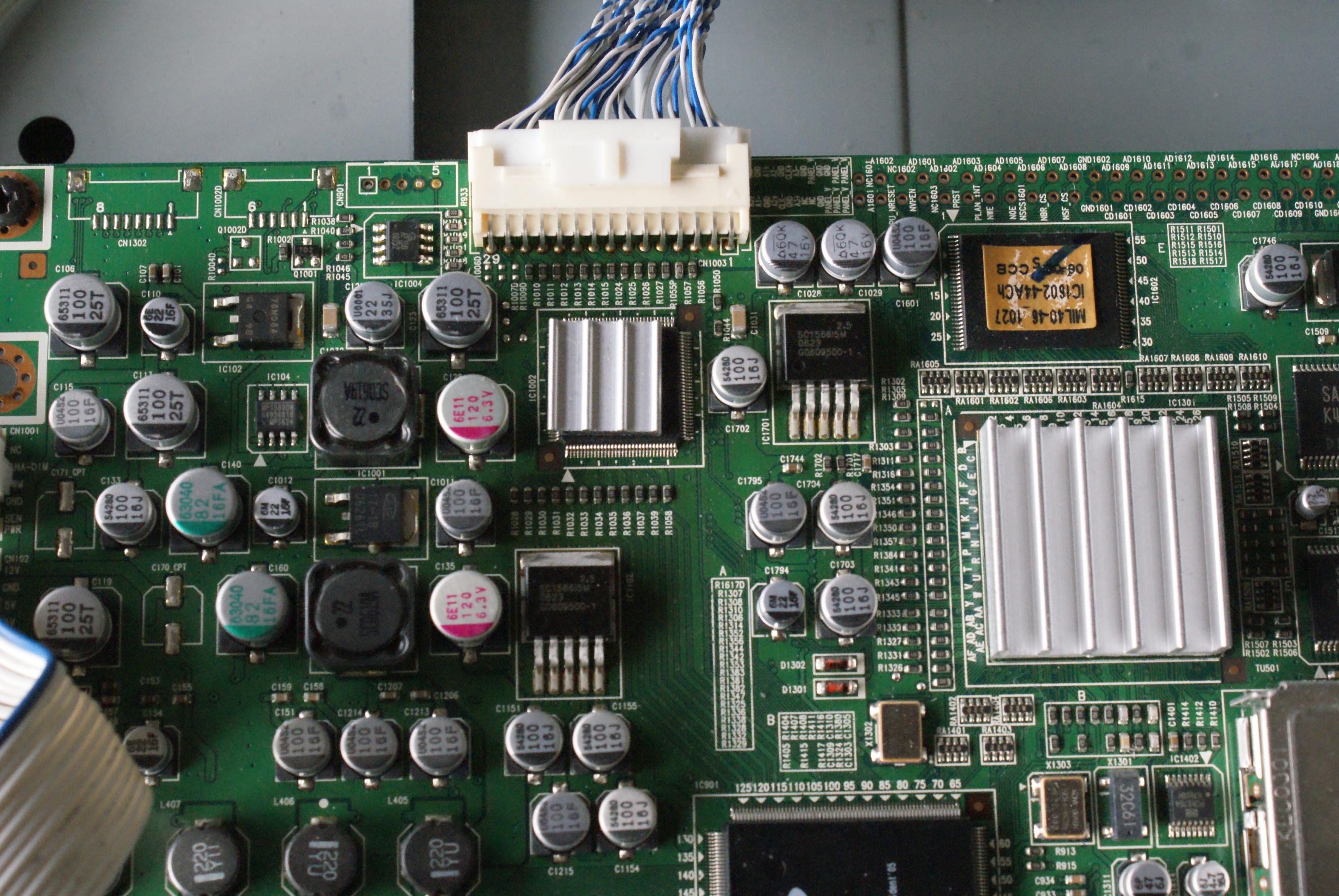

                    Good pictures, Can I get good pictures on the bottom side of the power supply board as a whole and also four 1/4 section? Same for top side.

                      Ok. good afternoon. I went ahead and change the caps, some i left because they were good but 90% change. Still have no video but now i have back ligth. I am sending the picture you request. I'll be by the computer if you need me. I want to said thanks to you all for the help i'm getting. JOB WELL DONE!

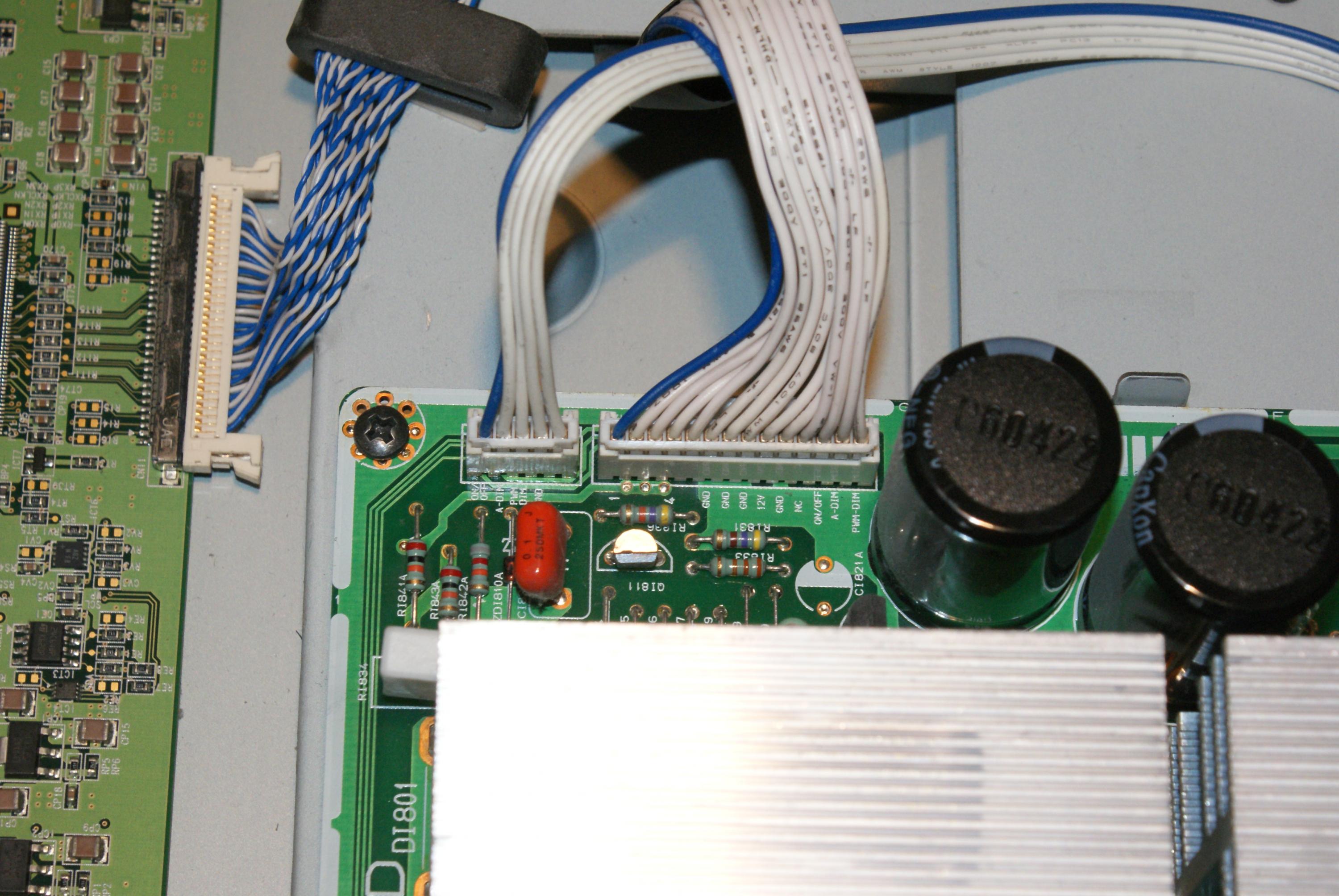

                        Great; now we need to check the fuse on the t-con board.
                        Top centre of this pic: https://www.badcaps.net/forum/attach...7&d=1360010928

                            Yes, getting 12v. I check the t-con and on cd30, cd31, c388 and rd67 getting no bip or reading

                              i am goint to put everything back together and check the voltage on the t-con board

                                i check the 4 voltage regulator, 3 of the are getting about 7 volt in and 1.8 to 2.2 out execpt on one that get about 7 v. in and the same amount out.
