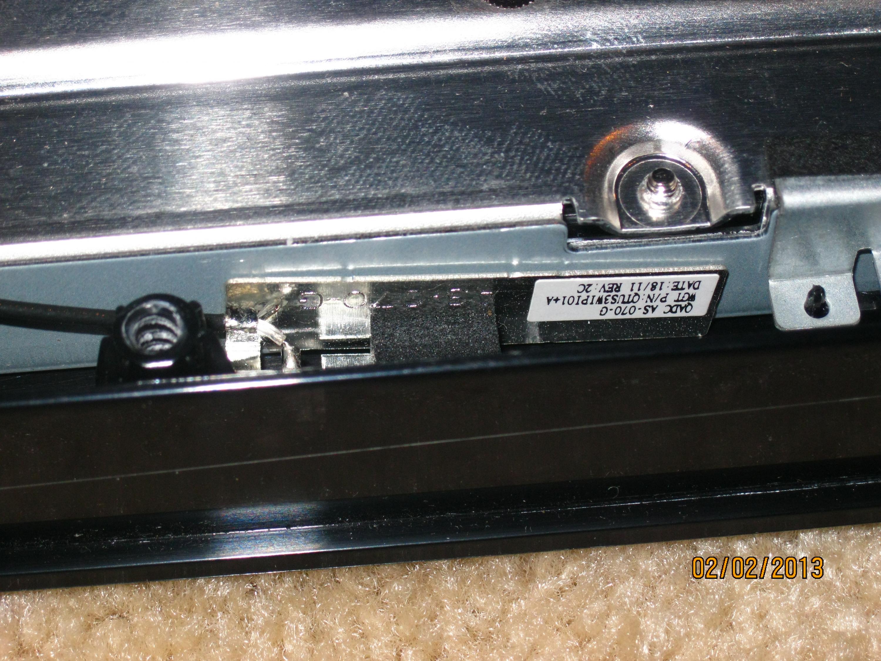

    Hi I am looking at this Vizio for a friend.It works fine for a while then all of a sudden back light turns off and audio is still going.I can see with a flash light that video is there.If i turn it off and back on back light is on and picture as usual.I understand that there is a light sensor that turns back light on and off does anyone have a diagram of its location?

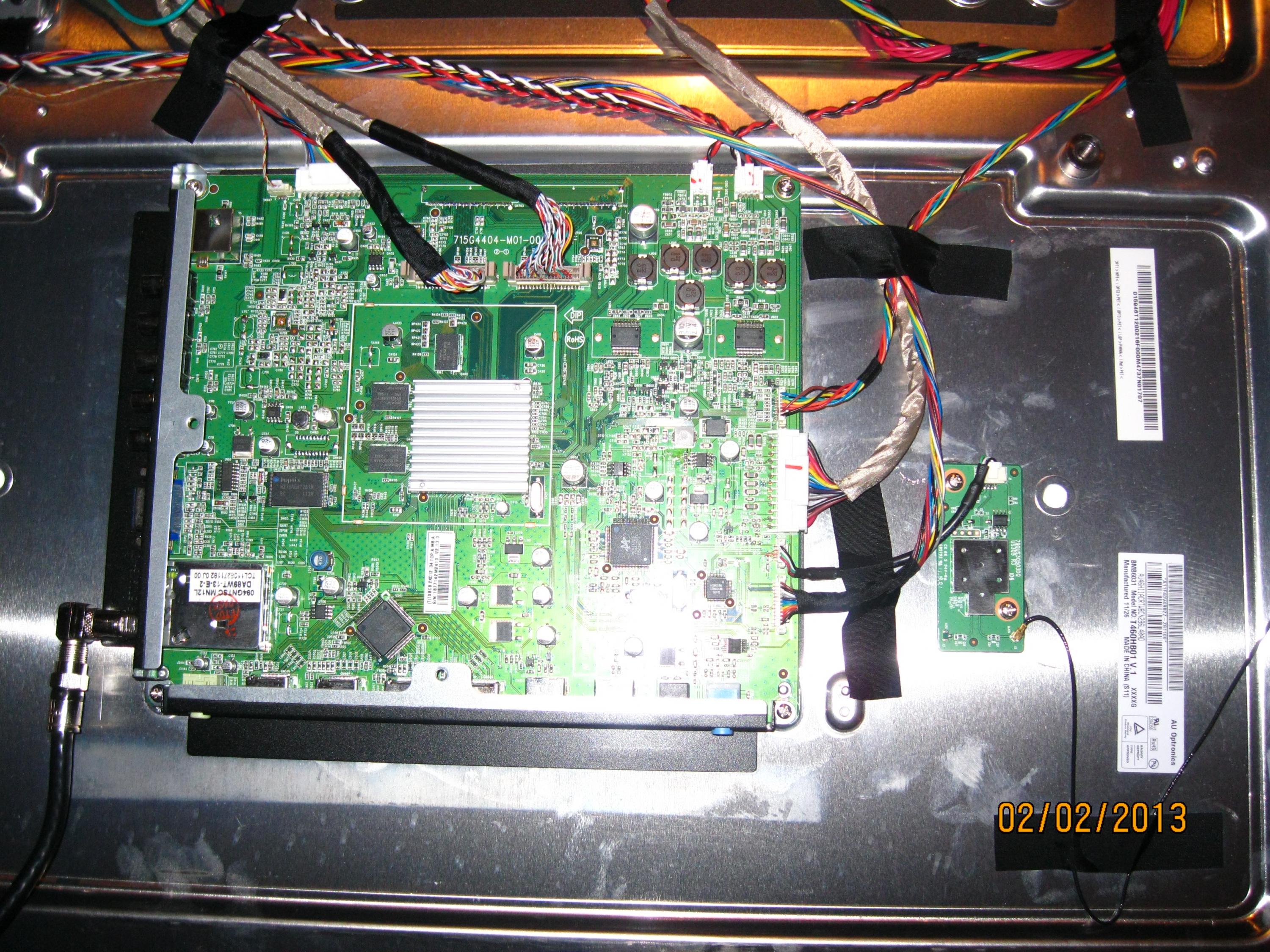

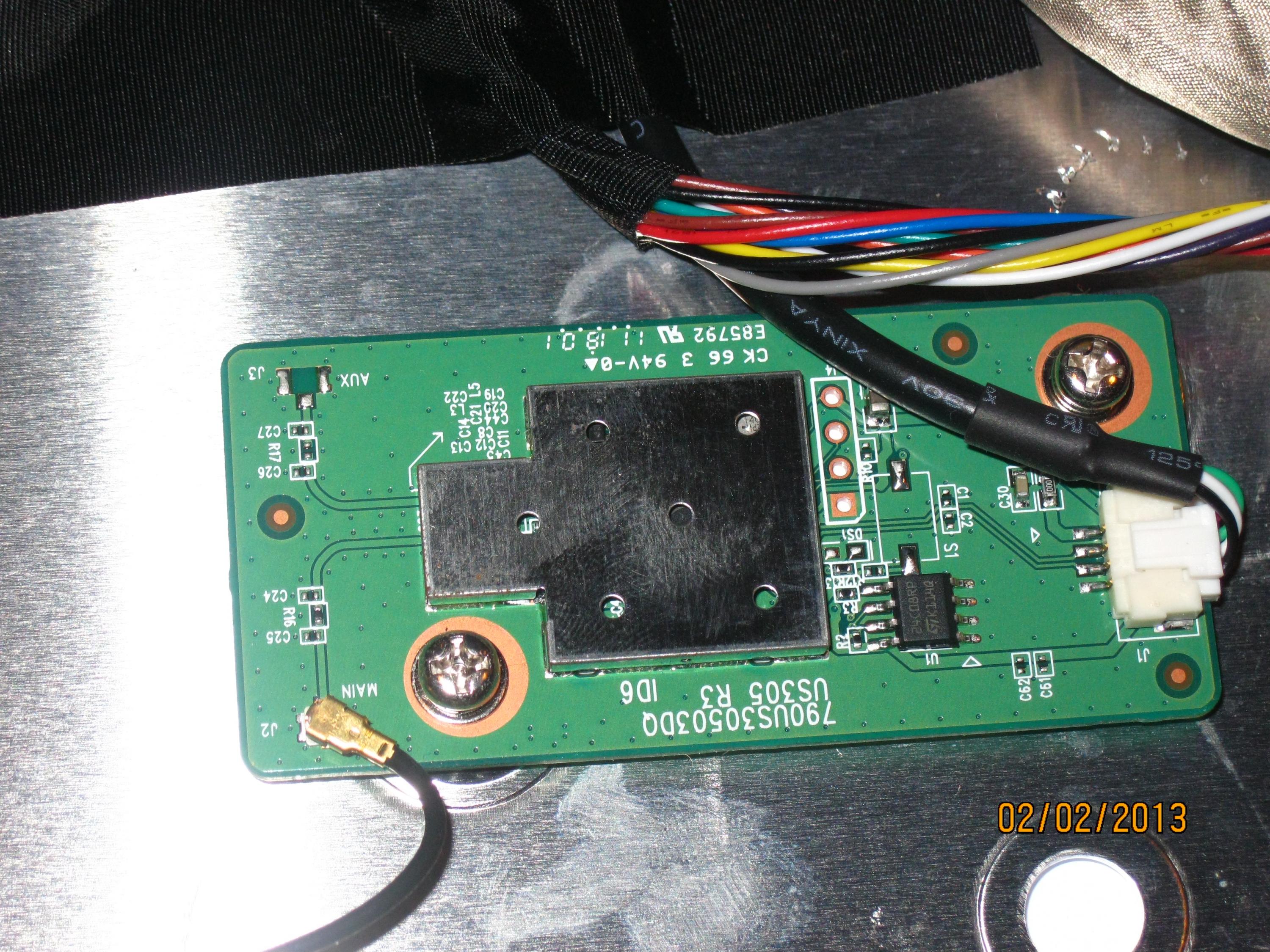

    I do see a small board coming off the main board that has a black wire going to top of frame with what looks like some kind metal strip or thermal element.posted a pic of the board and the little dielectric element thing.
    Another note it does have the high pitched whine that is posted about the vizio But that is not a concern.

      The sensor is most likely for backlight dimming, not for on/off control, and it'll make the backlight brighter in a bright room, not darker.

            Re: Vizio M3D460SR
            That small module looks like a BlueTooth transceiver.

              Re: Vizio M3D460SR
              Edge LED.Yes your right it is a blue tooth.

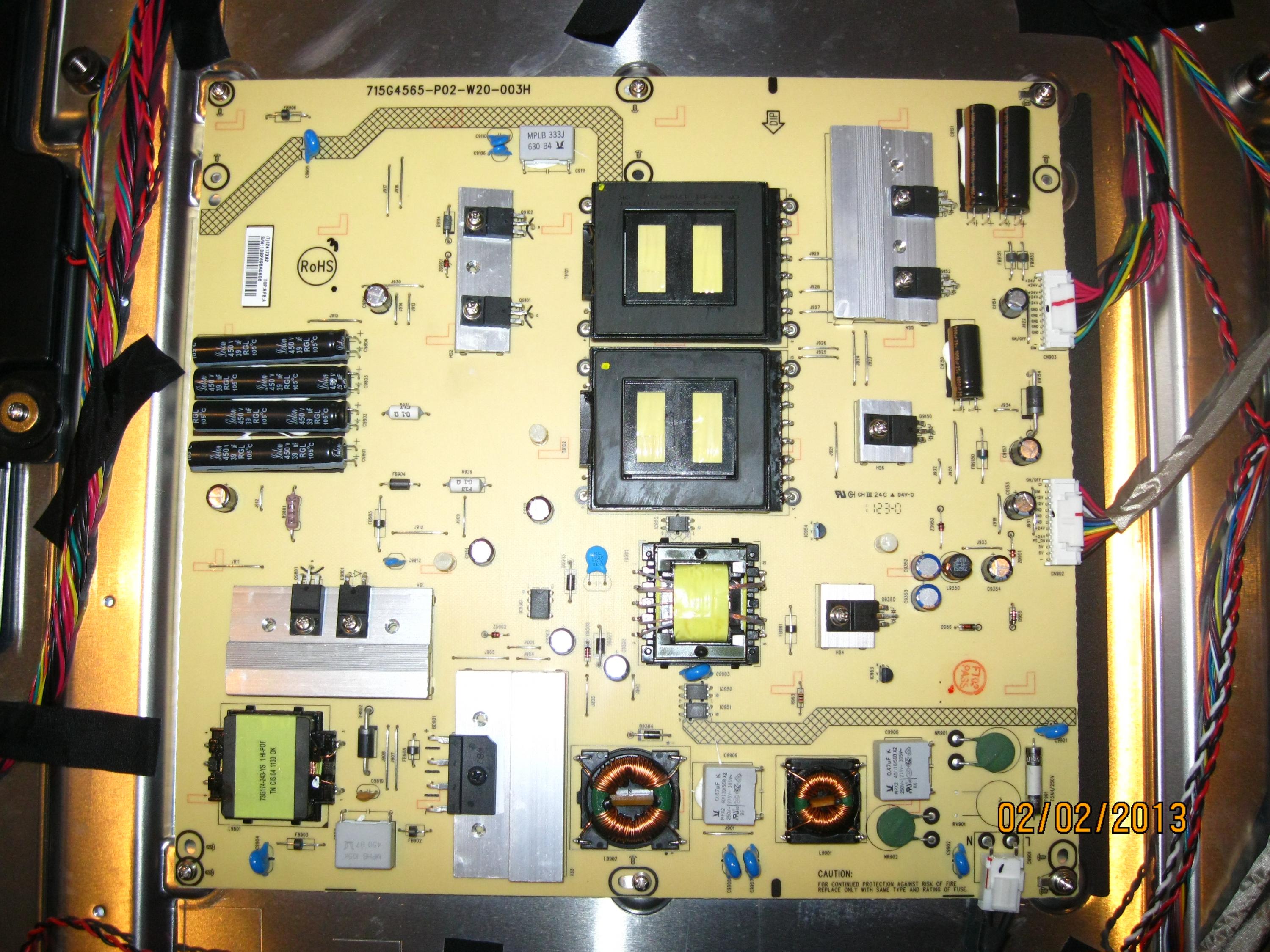

                      Re: Vizio M3D460SR

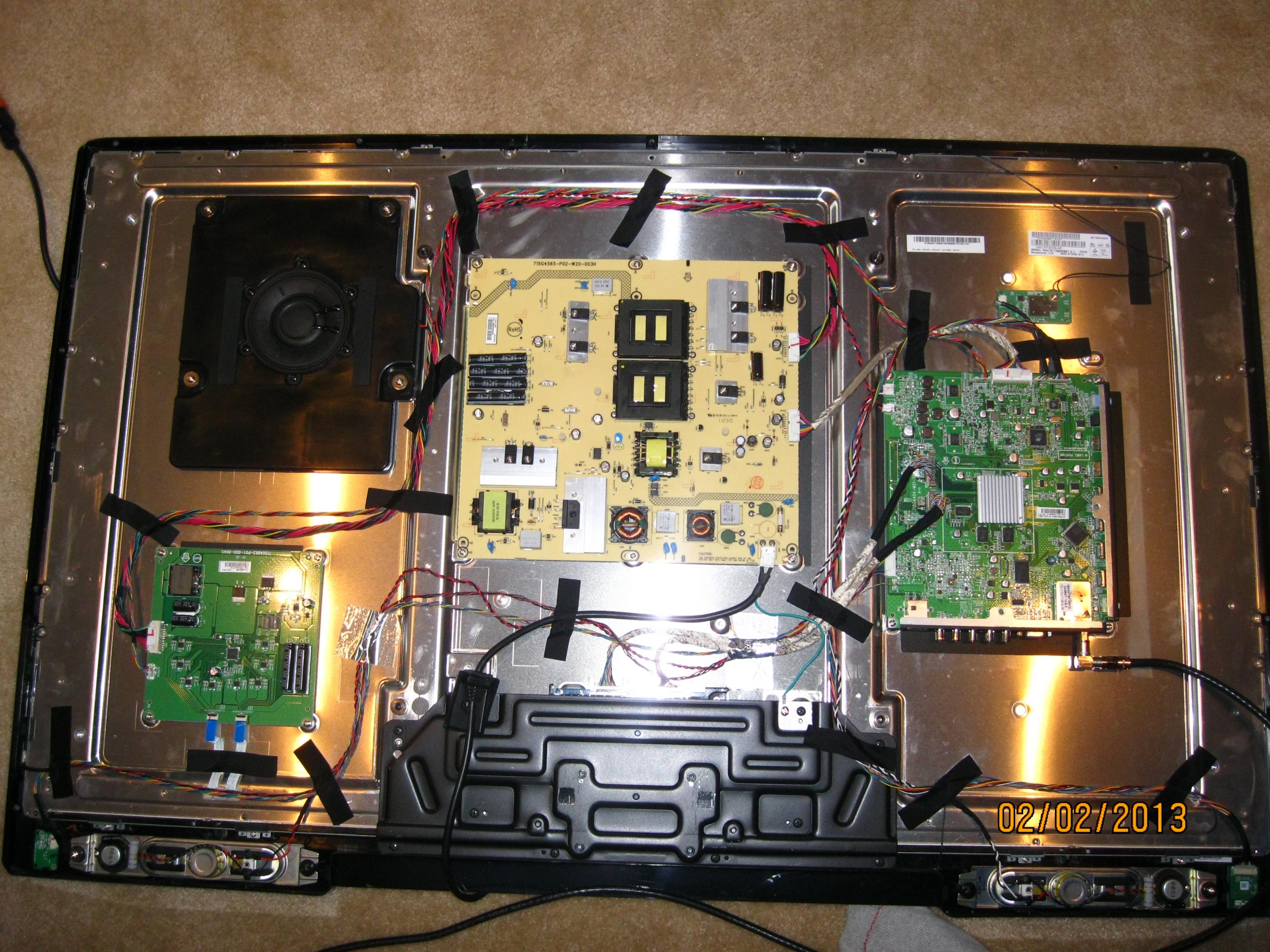

                      Can you show us a picture of the whole chassis and one of the PSU?

                        Re: Vizio M3D460SR
                        sure
                          Re: Vizio M3D460SR
                          Wow, I see what you mean. Pretty bare power supply. Looks cheaply made.

                            Re: Vizio M3D460SR
                            Very cheap and small everything.Guess its how they get them so slim.

                              Re: Vizio M3D460SR
                              Bent over caps to save space too.

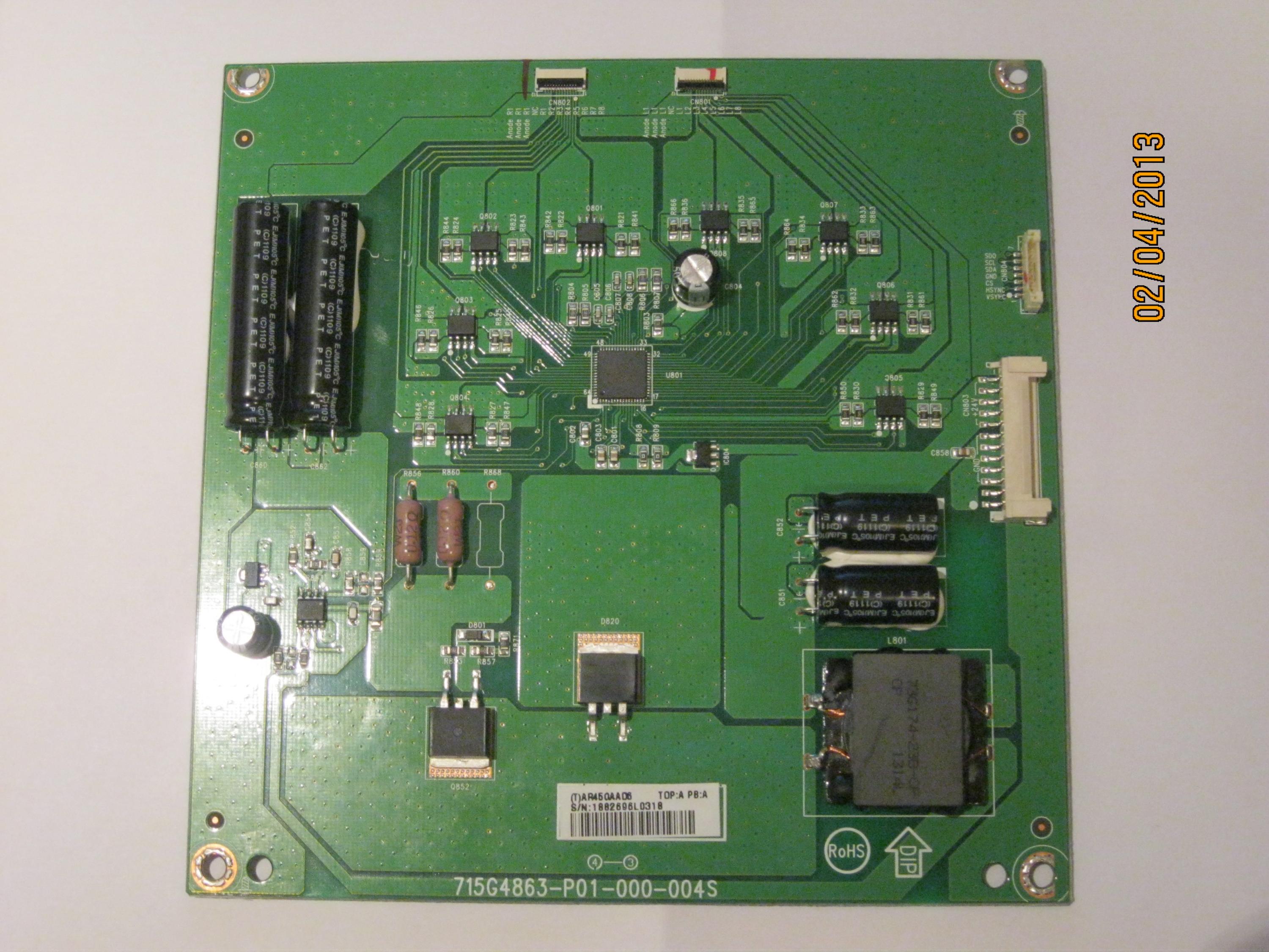

                                  Re: Vizio M3D460SR

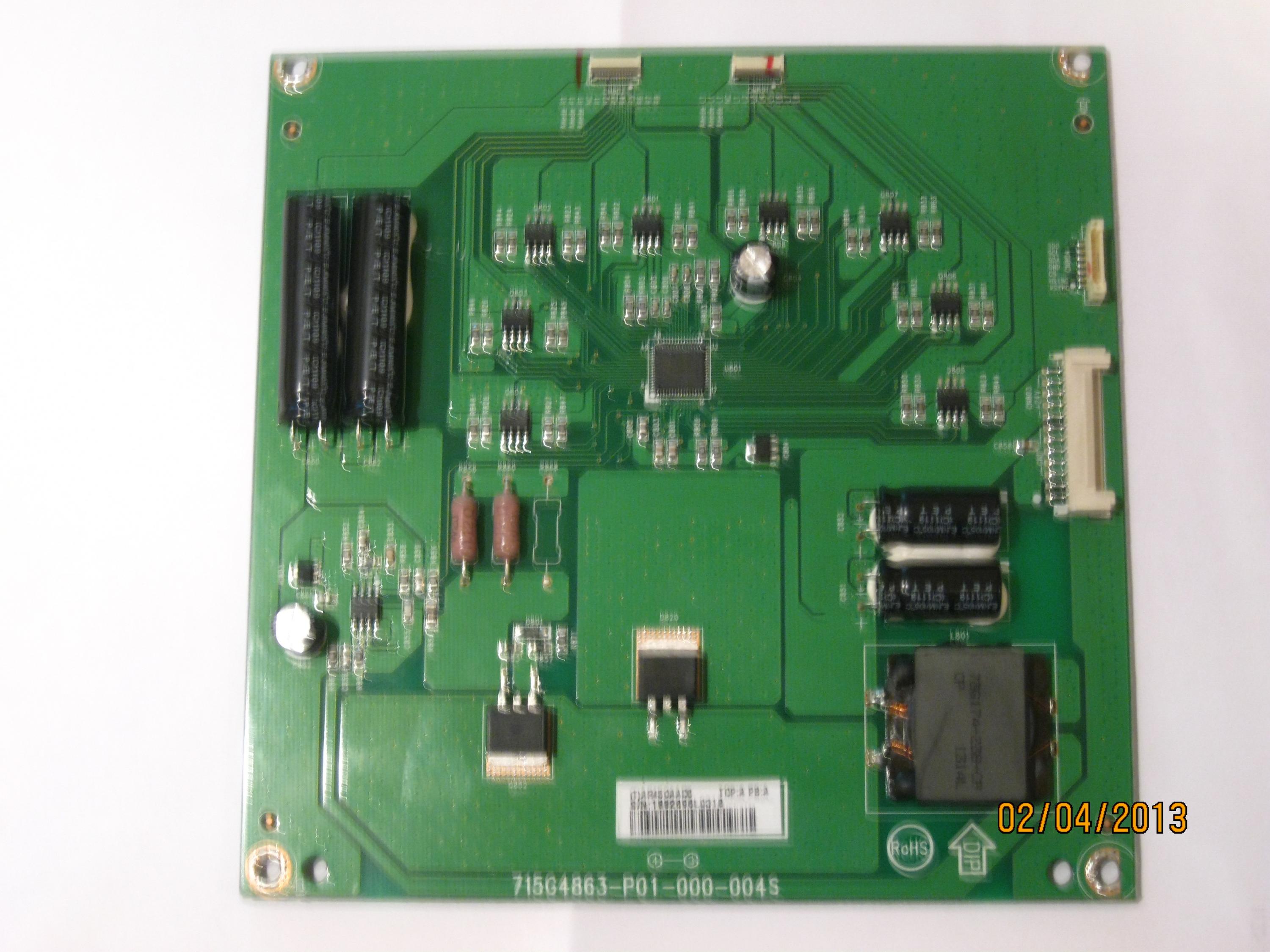

                                  Well i was wrong, today it shut off back light.I started putting light pressure on the psu with no change back light stayed on.Then put light pressure on LED driver inverter board and back light shut off,so i re started TV and pressed on board again around center just below mosfet and back light shut off.
                                  Now back light comes on for about 20 seconds and goes off.I did not crack board or anything only put very light pressure on it.So now i am wondering if the problem lies in the LED driver board.

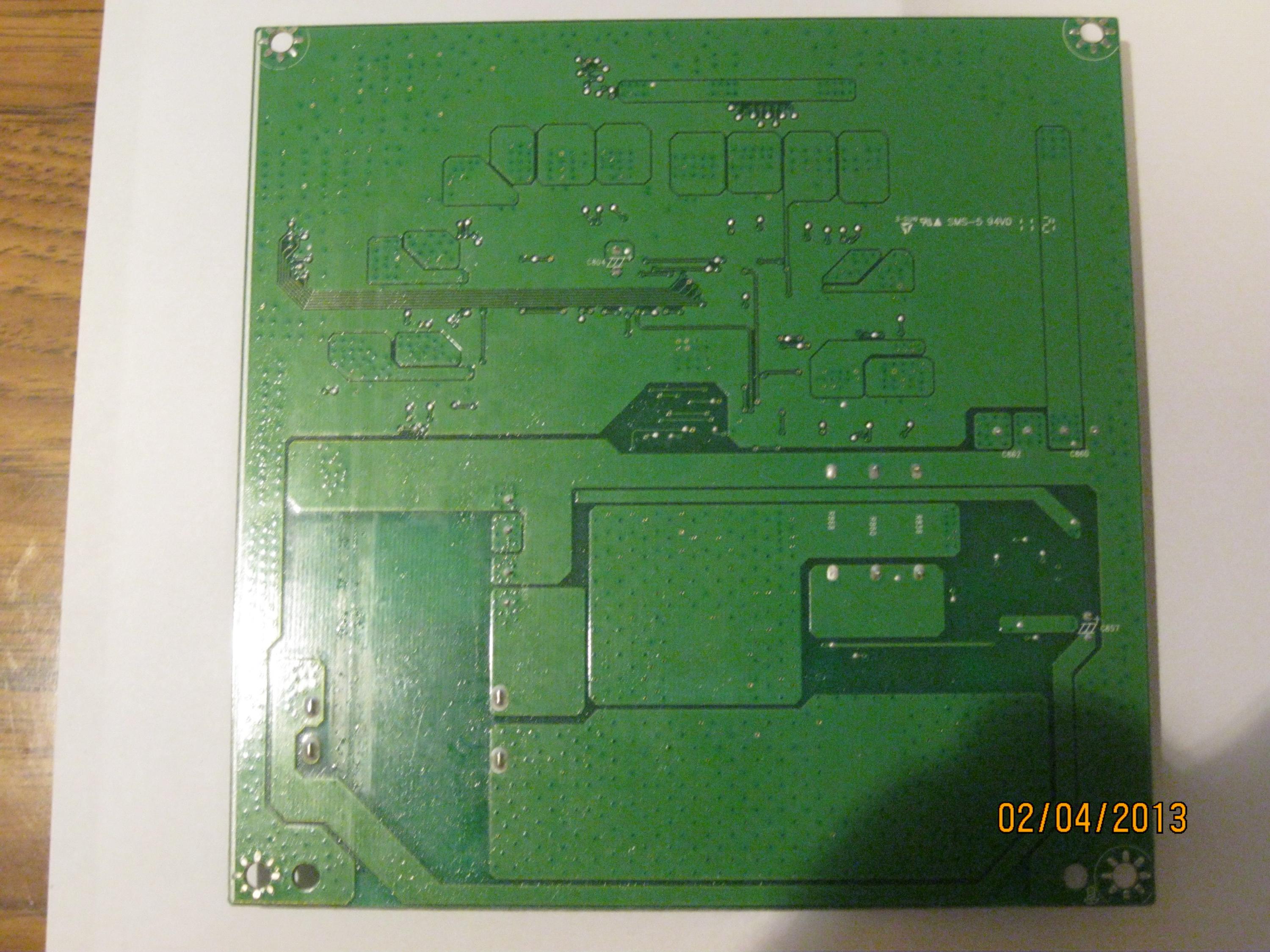

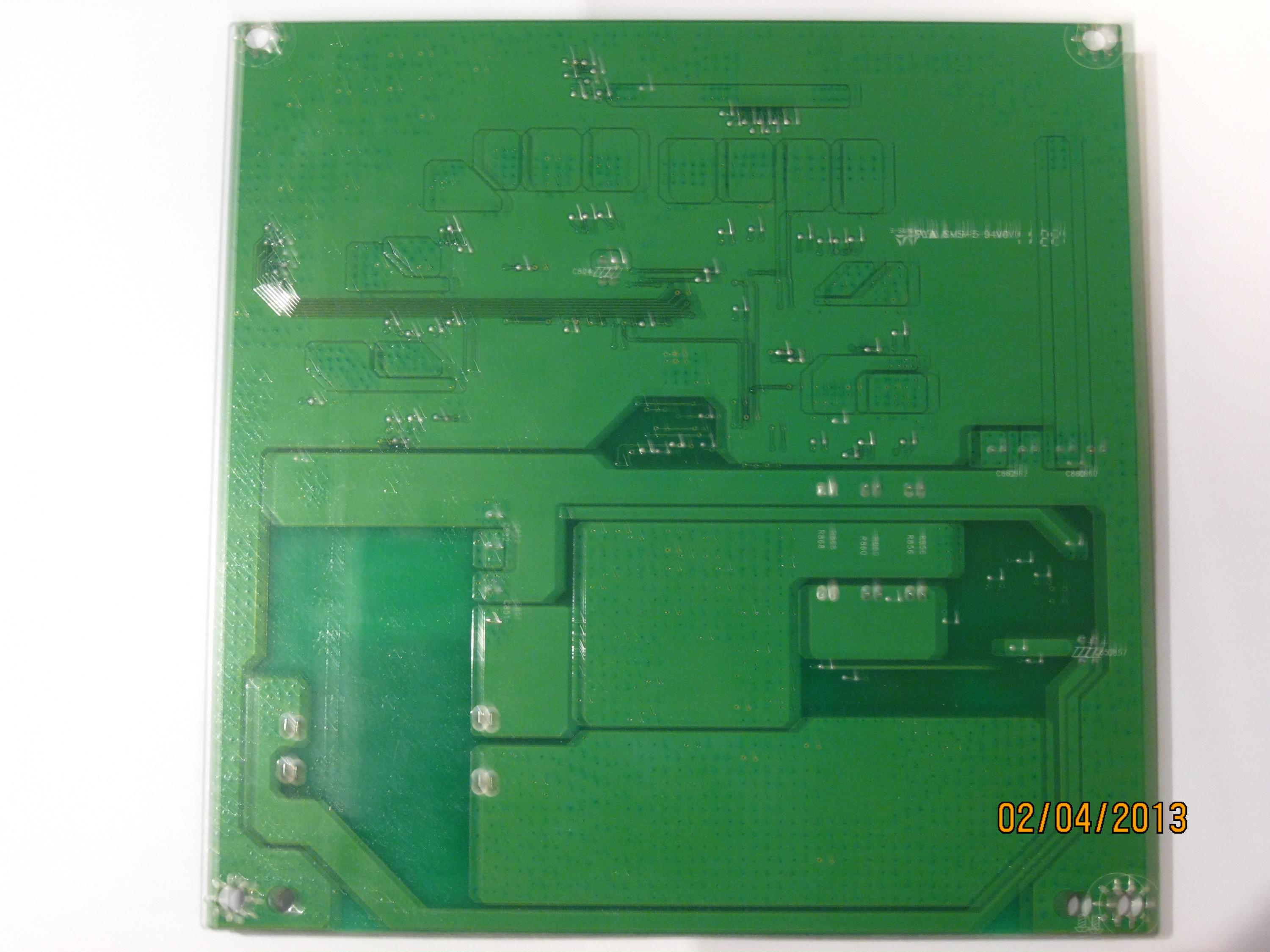

                                    Re: Vizio M3D460SR
                                    I see pics are bad here is re post of pics.
                                      Re: Vizio M3D460SR
                                      Check the voltage across those two longest rubycons - Care high voltage - I expect maybe 90~150V.

                                        Re: Vizio M3D460SR
                                        Update:Applied pressure to LED driver/inverter board and could turn back lights off at will. Ordered new board and installed and TV working fine now.After checking into it further found that solder joints for Q852 most likely bad or Q852 itself after heating up.
                                        So Vizio LED with random back light turning off,re solder Q852 if that doesn't work change Q852 or board.
                                        Thanks for all the help on this one.
