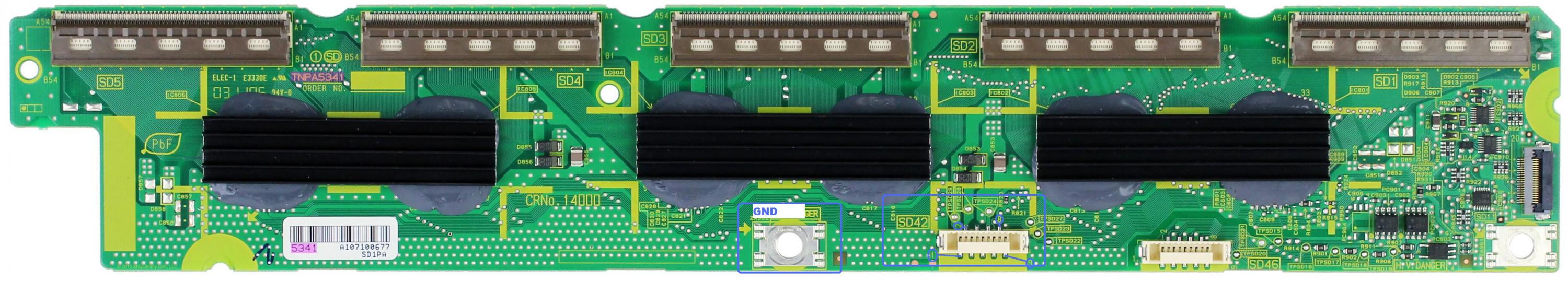

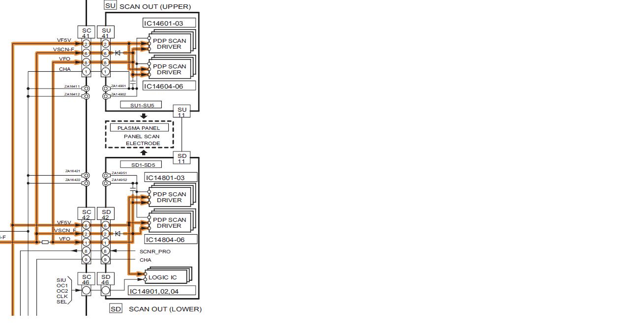

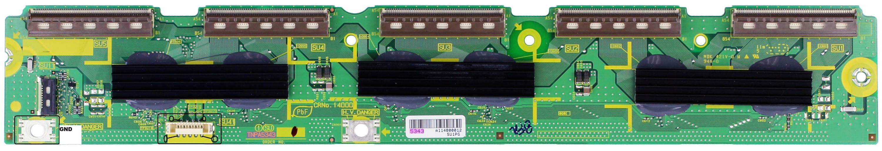

                    #29
                    Re: Panasonic TC-P55ST30 TV is not turning on.
                    Actually, I had a look at SJ and seriously something must have changed. They have a truckload of these. Assuming yours is TC-P55St30, the Sc should have a sticker on it showing barcode showing 5351 (no revision after that) or TXNSC1PAUU.
                    You do need to pay attention to the revision when searching as they can use the same board in different sized panels and they are tailored for the panel version.
                    At the price they are I would consider getting 2. To my knowledge has 6 months wty, extra $6 for 1yr, extra $12 for 2yr.
                    Only problem with a 2yr wty is very good chance they'll have no stock when you need one, hence if you are keeping this for a while I'd take the opportunity to stock up.
                    I did this with my 2010, have spare set of buffers and some SC boards ready to go when it fails again which I expect it will.
                    There are a few on Ebay but I'd lean towards SJ because with the qty they have they'll essentially be brand new boards out of damaged in transit as opposed to used for most of the ebay stuff.
                    I've tried to make it easy for you with the pictures. resistance is from my 2010 model hoping to see something similar but last person to try this we got one board bad with obvious low ohms but the other was much higher than expected. Trying to avoid a shorted buffers possibly damaging the SC.
                    You'll see the pins run odd on one side, even on the other.
                    These are the instructions from my guide.
                    Procedure:
                    1.
                    Remove the 4 VFG screws from the SU and SD boards. (See picture to the next page (page 44).)
                    2.
                    Disconnect SC41, SC42, and SC46 from the SC board. Also remove the ribbon cable between the SU and SD boards (SU11/SD11). (See picture on the next page (Page 44).)
                    3.
                    Using the VF-Ground (VF_GND) as reference, measure the Vfo, VSCN-F, and 5V-F resistance’s on the SU and SD boards individually.The board is considered to be bad is a short circuit or a very low resistance reading is found on any of these lines.
                    The image shows using the blk lead from the meter on the test points, red on the gnd.
                    See how you go with that one.
                    Post the results and if keen, do one set with the leads one way, then flip them around and record the second set.
                    hopefully your meter is up to the task.

                                          Pin 8 is Vfo, if Vfo is short to the Vfg ( gnd) plates on that buffer board, board is shorted.
                                          Shorted buffer can take out SC and Sc may have also blown the buffer.

                                          • midnightg35x
                                            Panasonic TC-P65S2 SU or SD Boards Bad?
                                            by midnightg35x
                                            I have a TC-P65S2 that blew an SC board (I had a previous post about some cross references). When I put the repaired SC board in, it worked with the SD and SU boards isolated and SC50 jumped. I reinstalled the SD and SU boards. I did forget to remove the SC50 jumper, but from what I understand about how that jumper works, that should not cause SC board destruction with properly working SC/SD/SU boards. When I turned the TV back on, the SC board blew again. Based on the fact the SC board was working without the SU and SD boards, it at least makes sense that one or both of them is bad.
                                            04-22-2019, 05:29 PM
