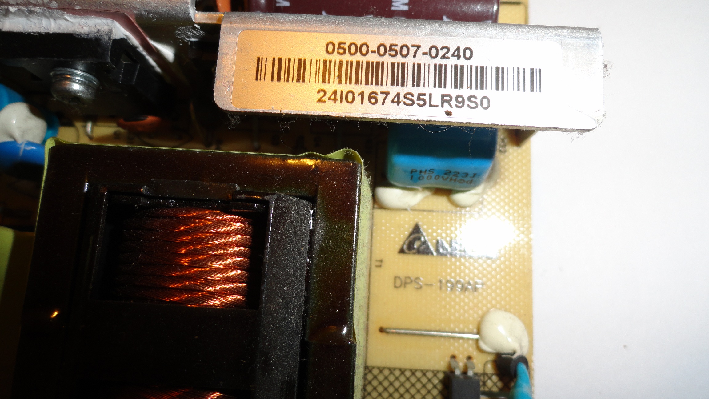

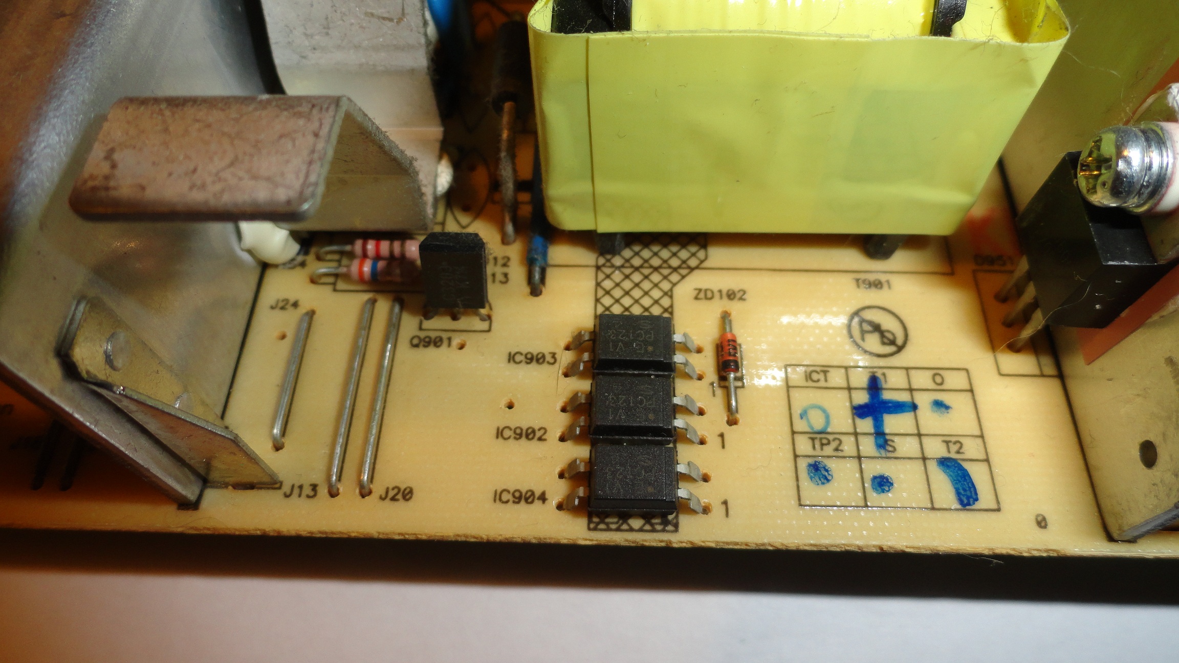

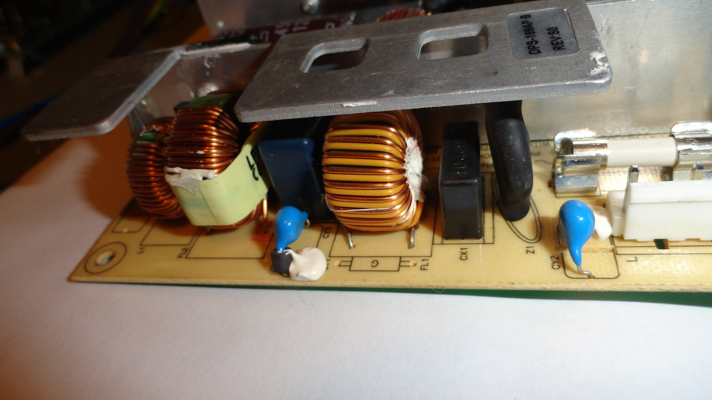

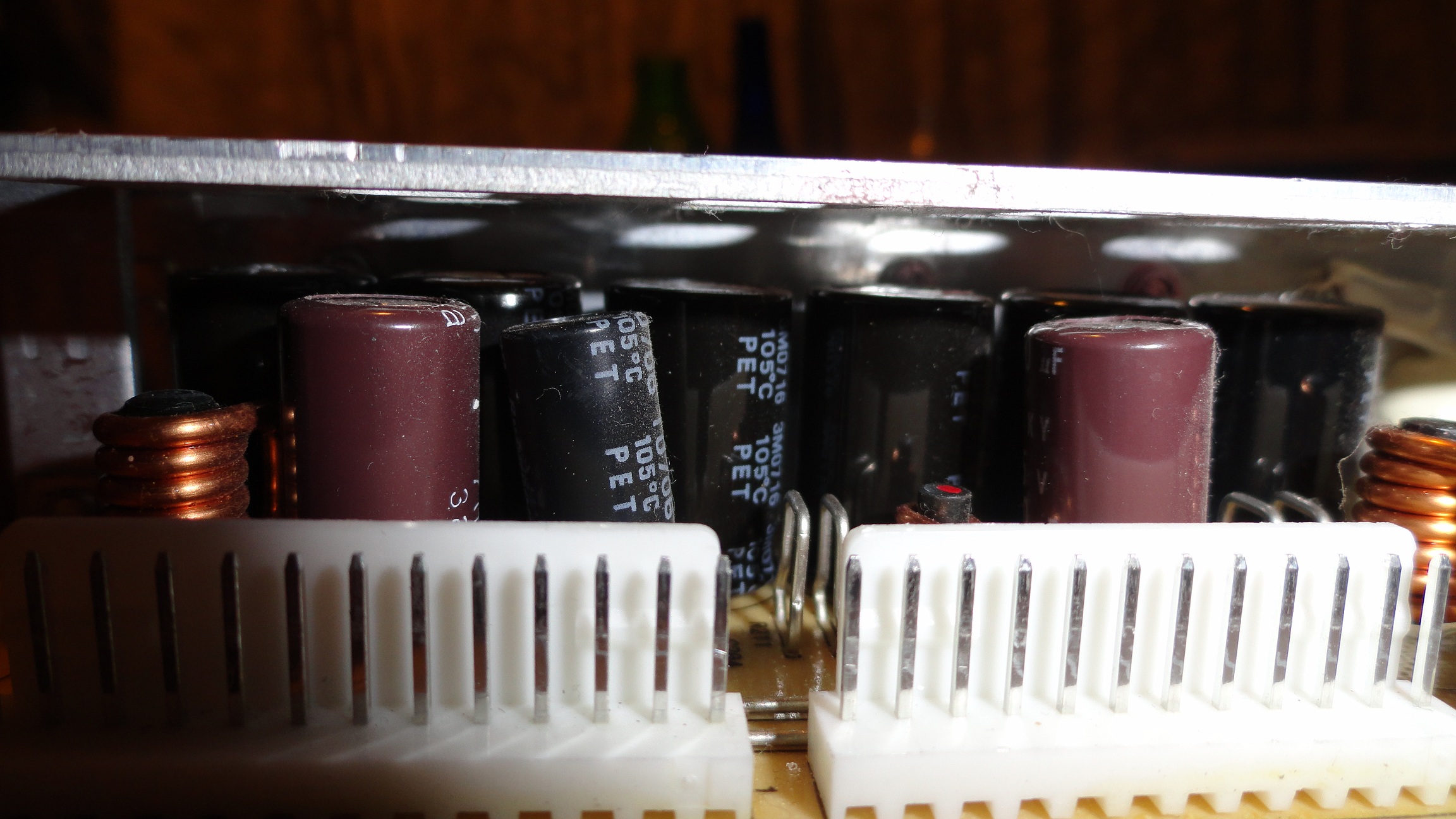

                                    Re: VIZO VX32l HDTV10A

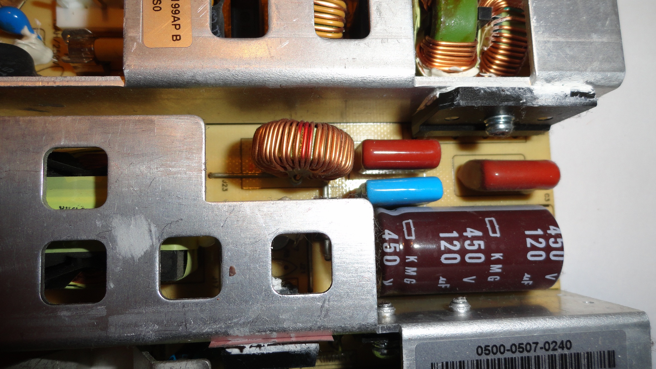

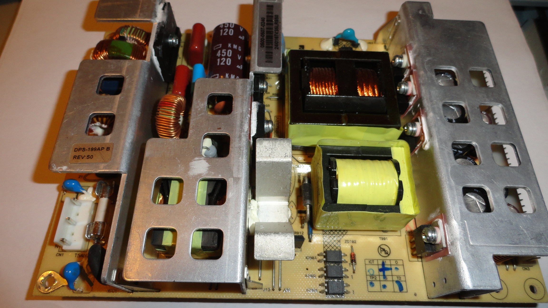

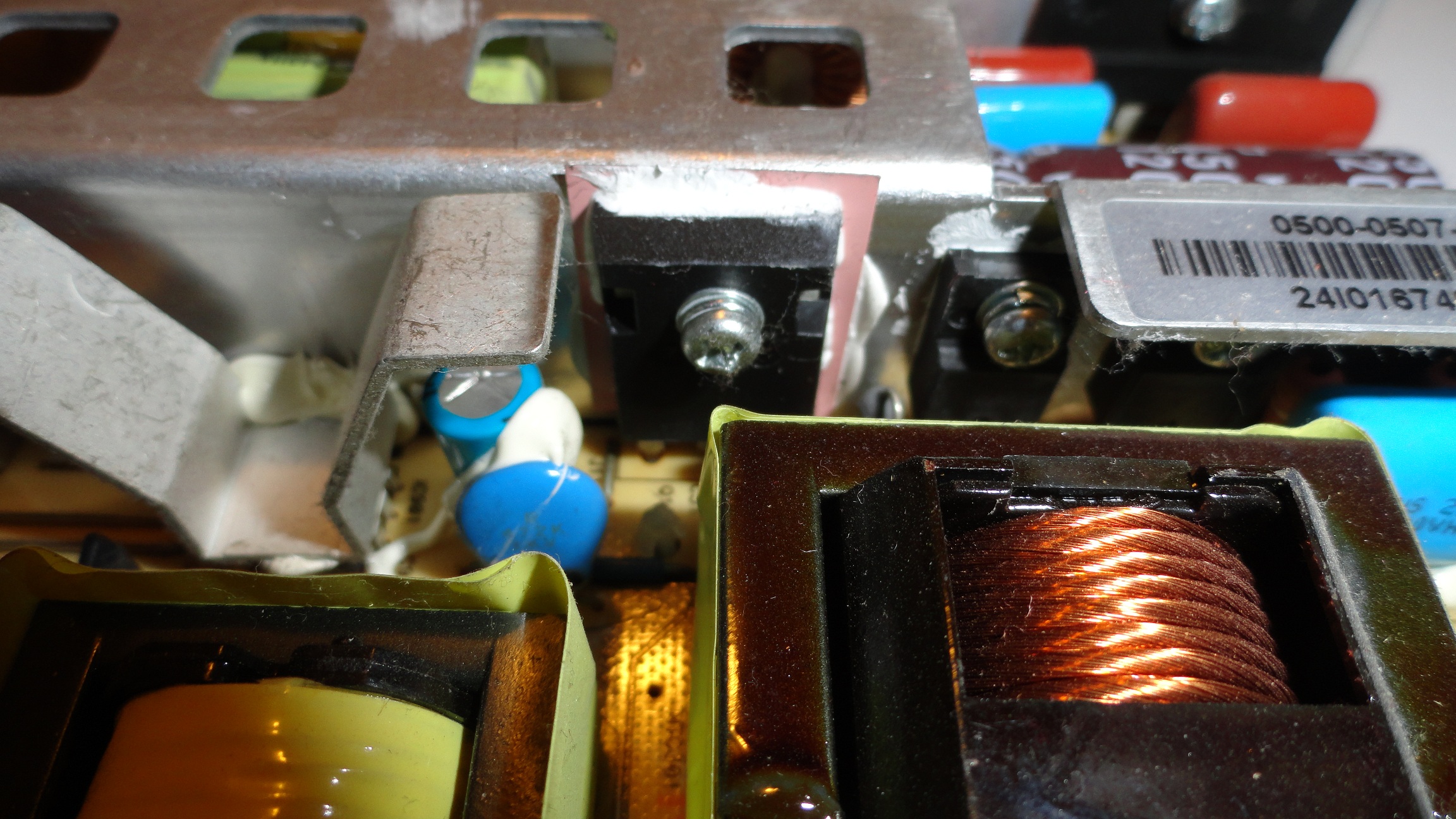

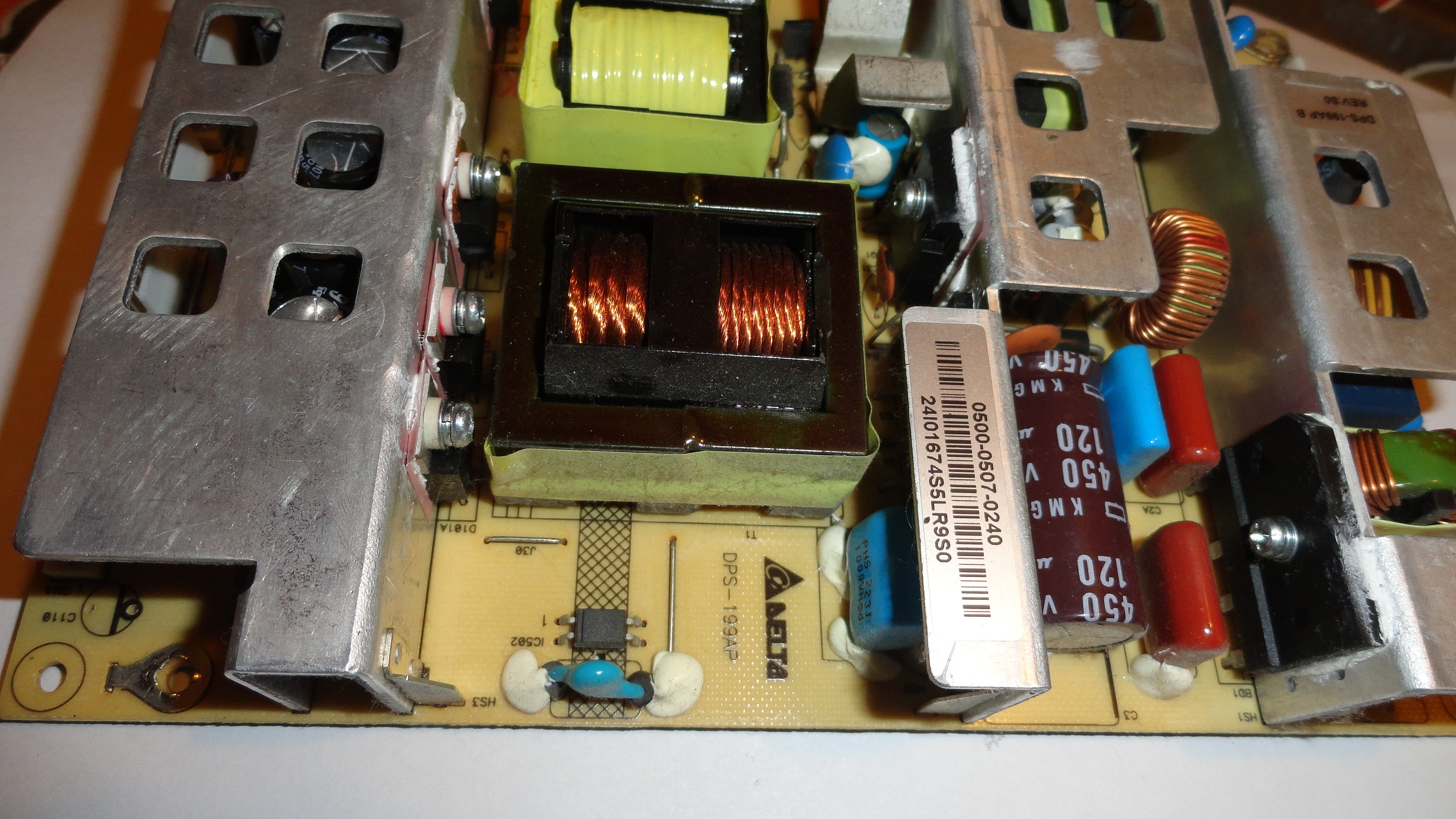

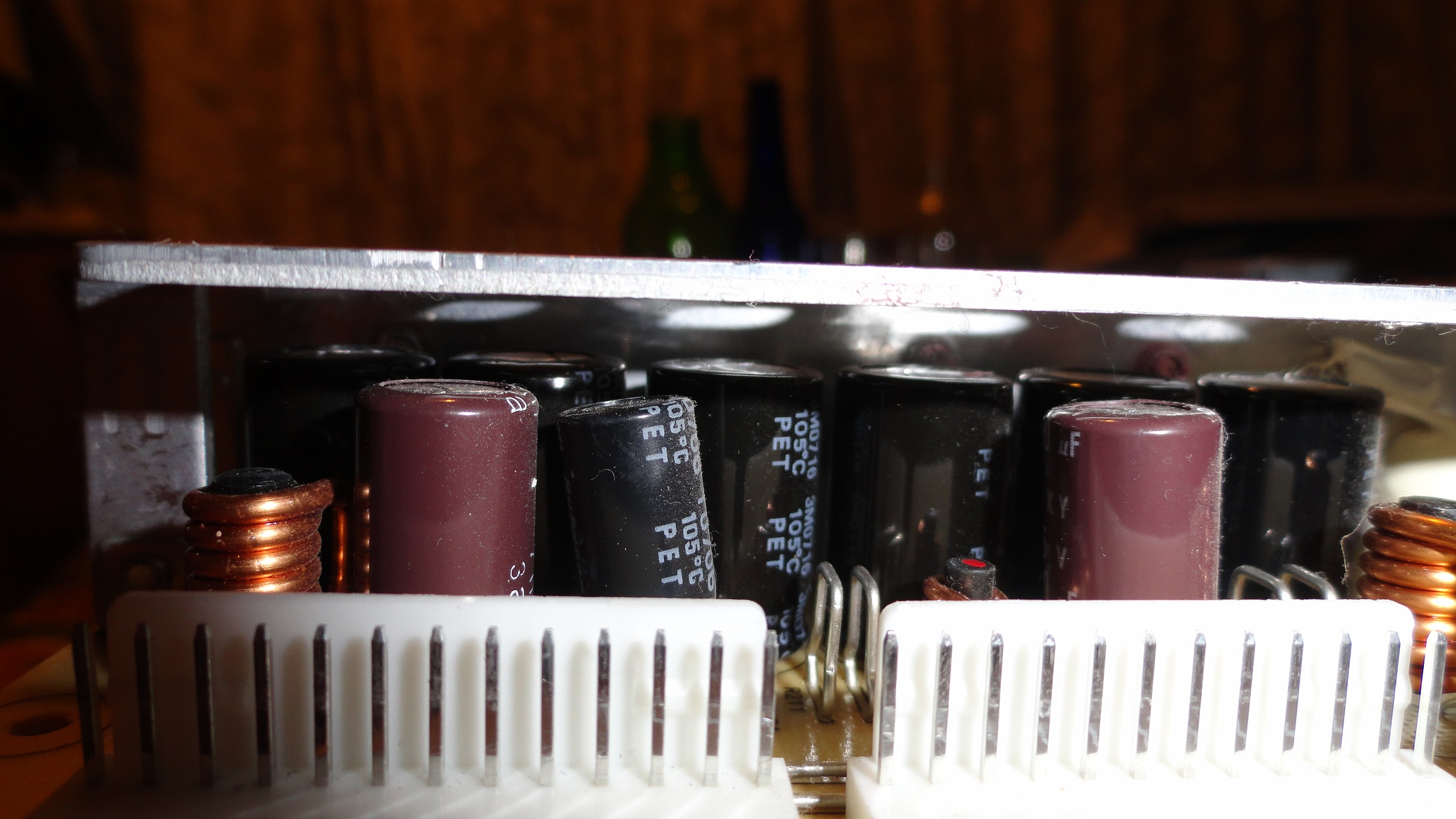

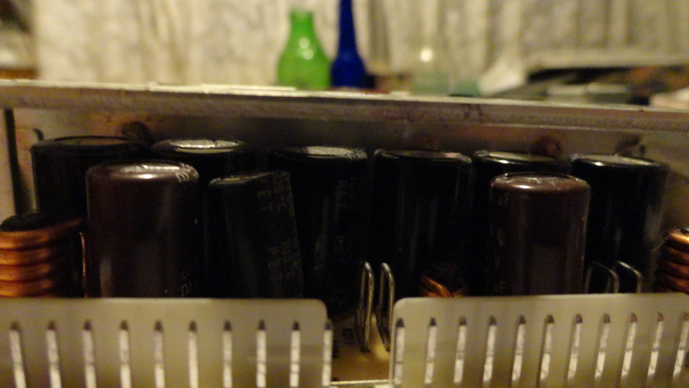

                                    But still dead, probably leakage. Let's check the PSU. Across the main 400V/450V cap you should measure 160V or so in standby, and 390V or so when PSON is high and TV "should" be on. Do you? Careful: High voltage.
                                    After this test can you remove it and get pictures of the top and bottom side, nice and clear and in focus.
                                      #38
                                      I have 170v in stby and 394v with power on will take me a few minutes to upload some picks
                                        #39
                                        OK, so the signal for turning on the PSU is coming up, so the issue is elsewhere on the PSU.
                                          #40
                                          here are some picks
