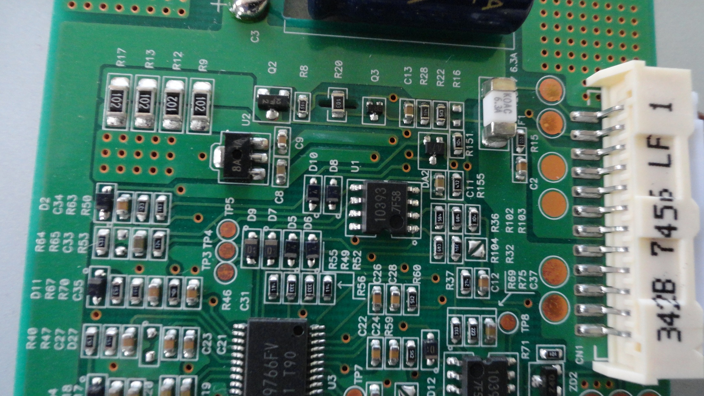

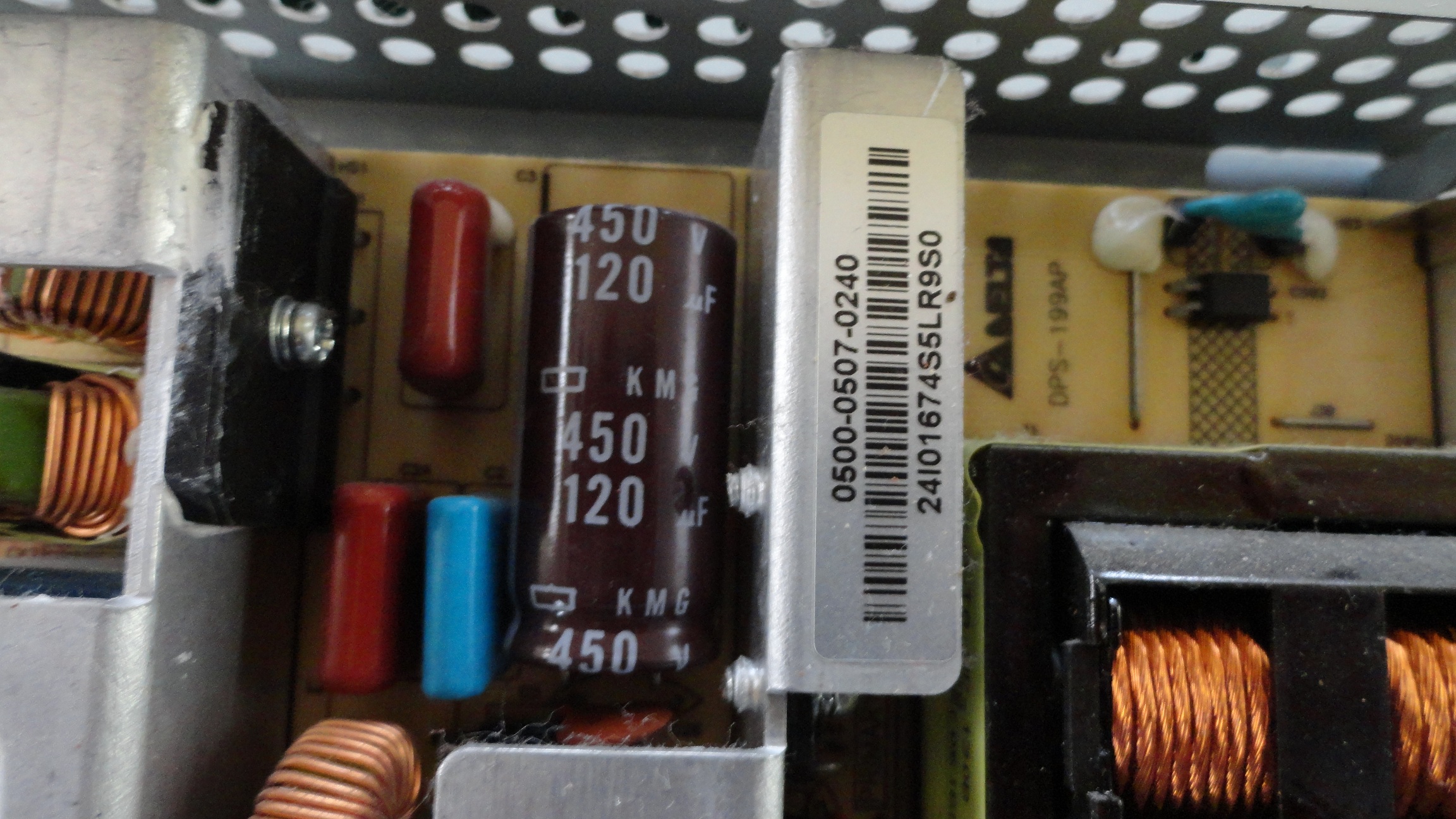

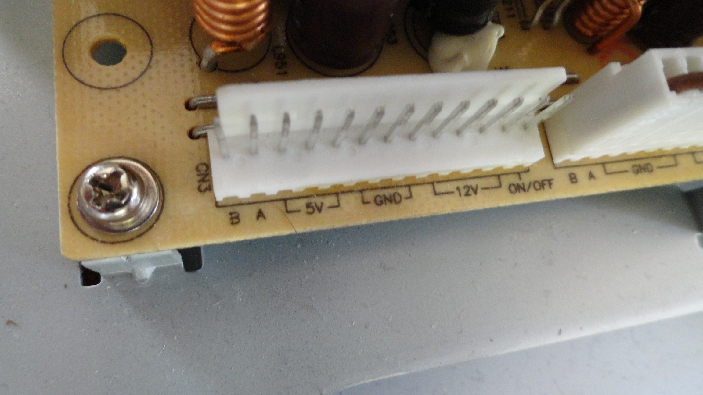

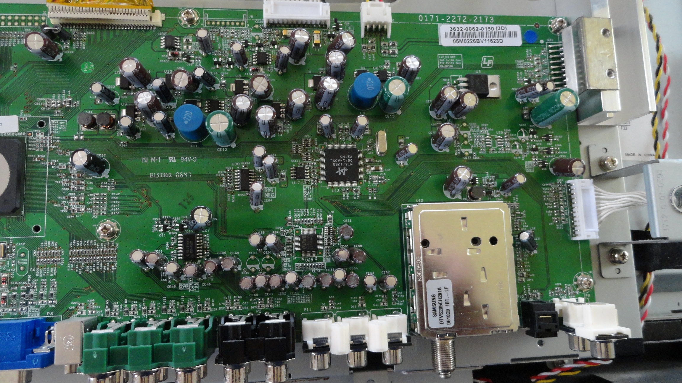

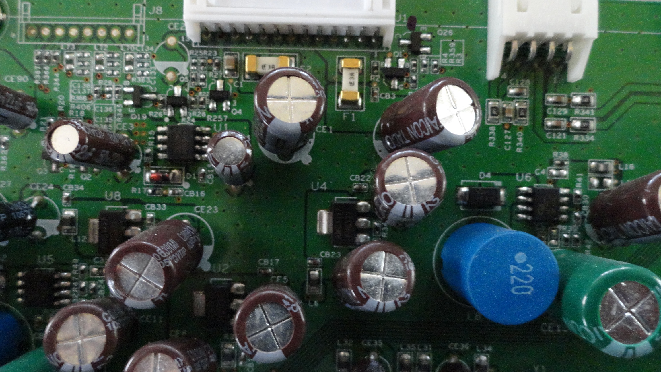

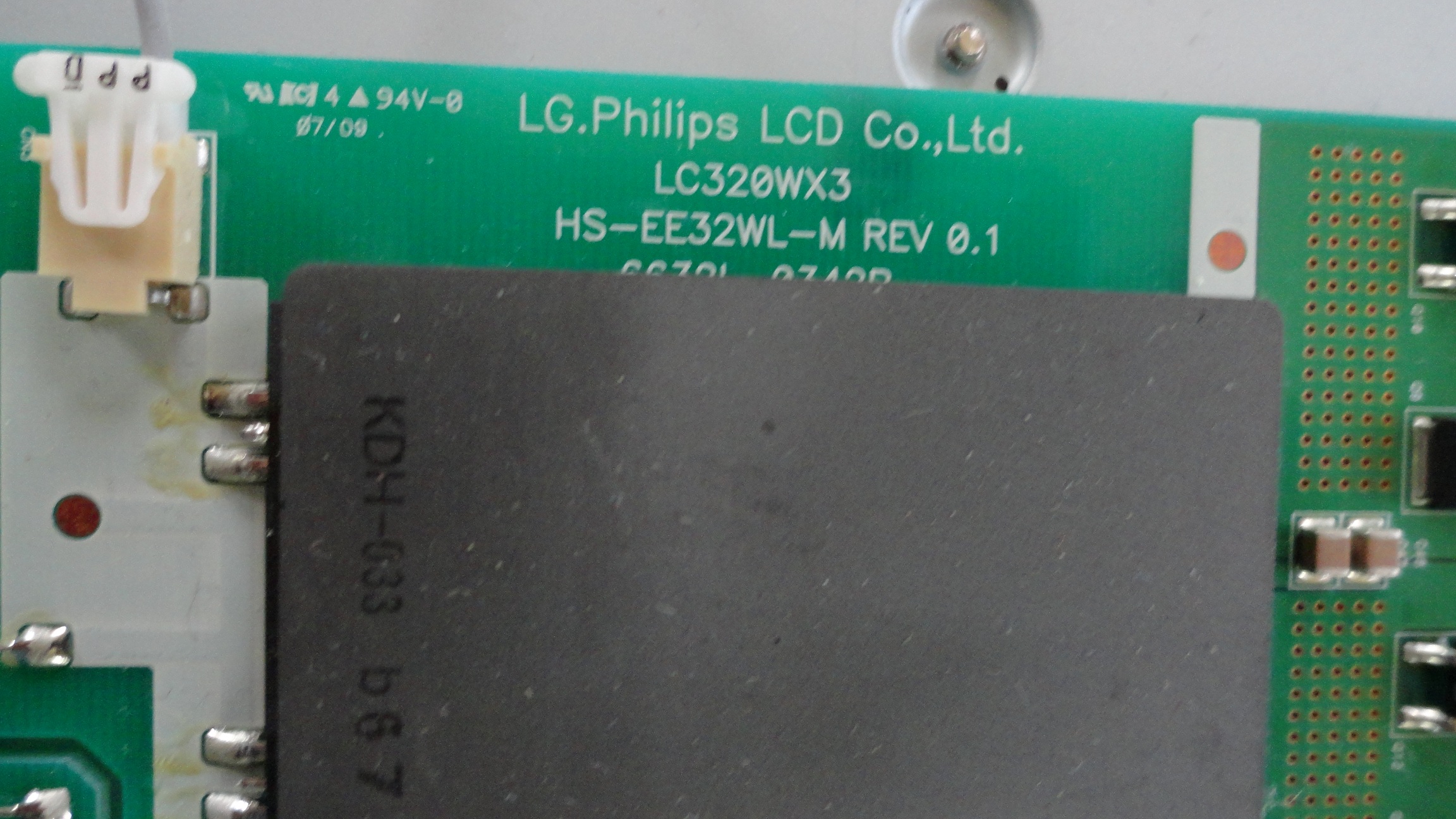

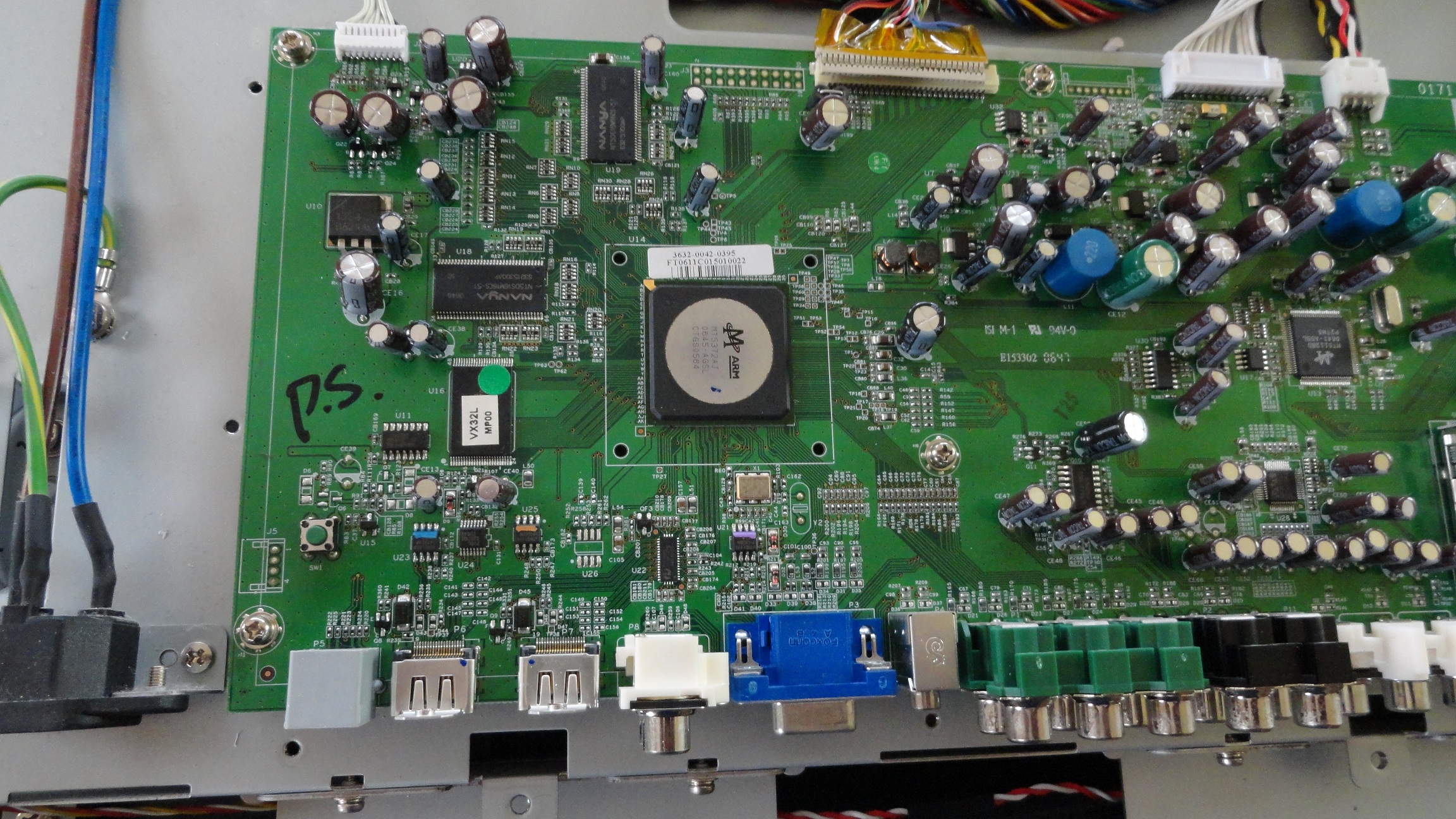

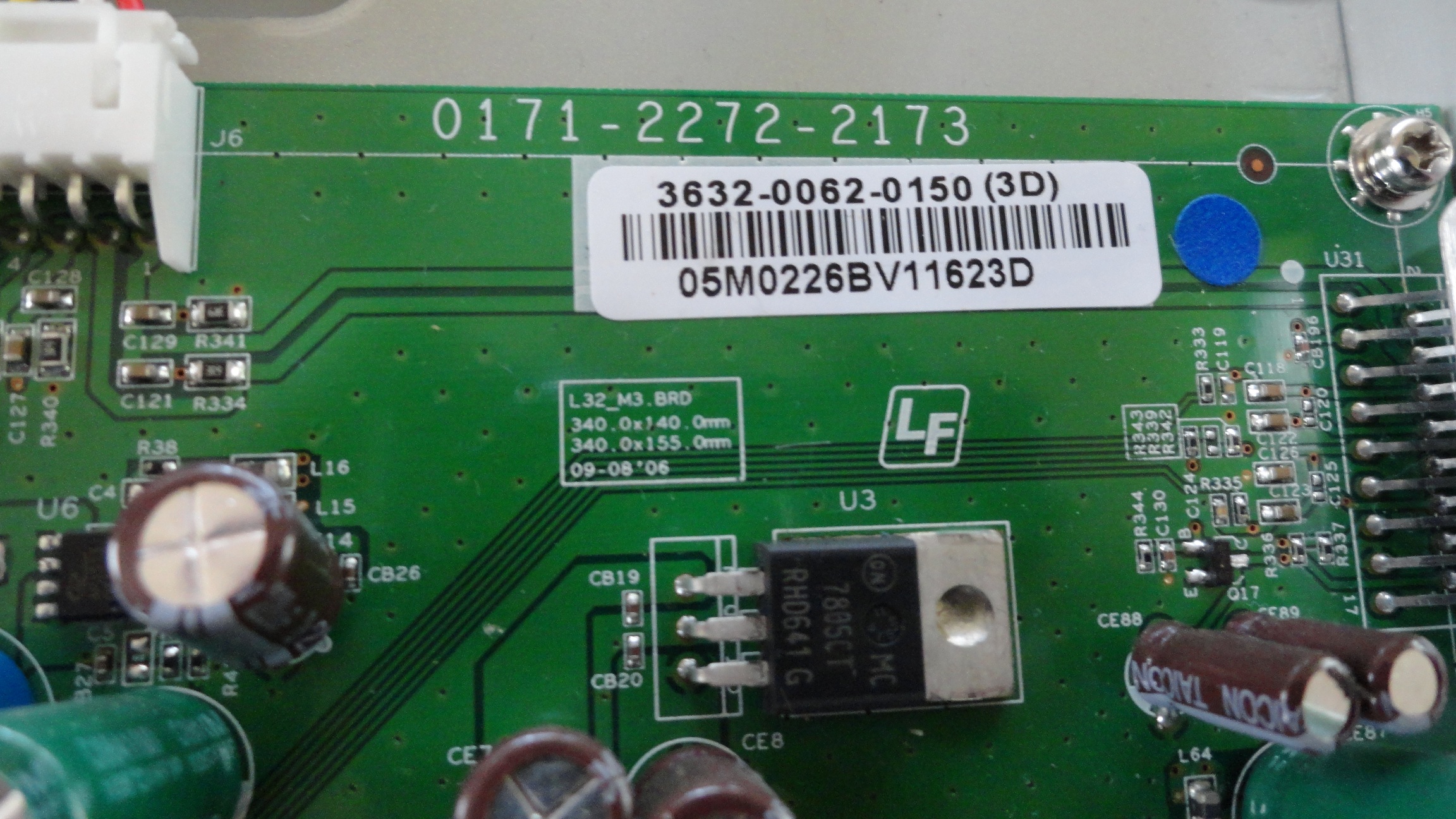

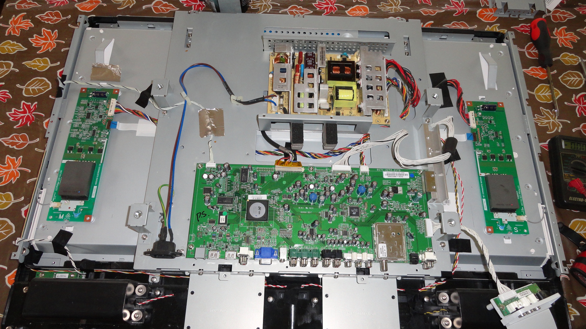

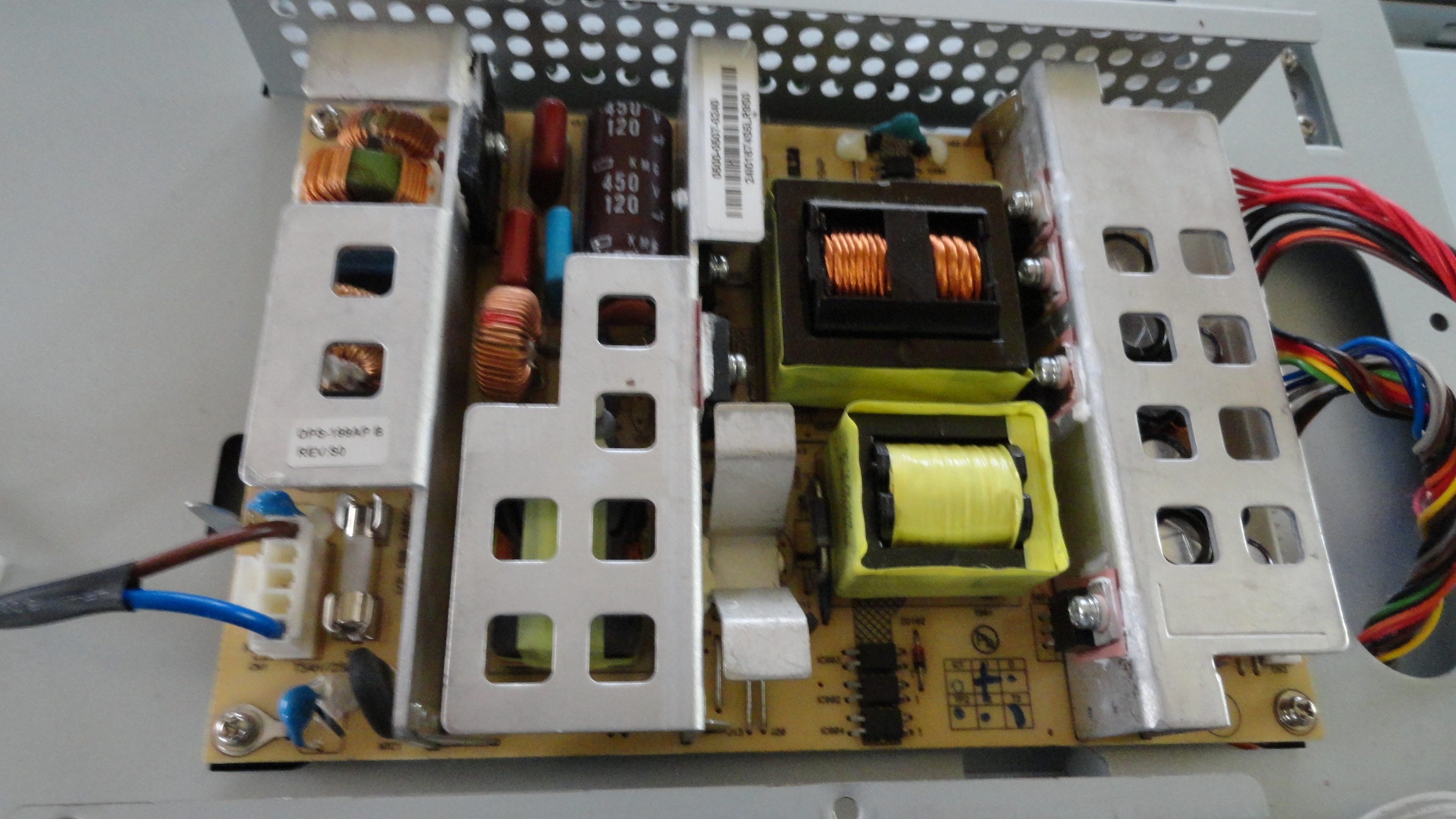

    HERE are some pics of the set

          went to the store got new 9v battery old one was at 6.4v then i rechecked voltage regulators they still seem off

            So you have one bad regulator. Do you see how I come about finding out which is good which is bad? The output should be within 2%. Please read the link below so you will understand, I also provide the link to Digikey for ordering adjustable 1117 series regulator.
