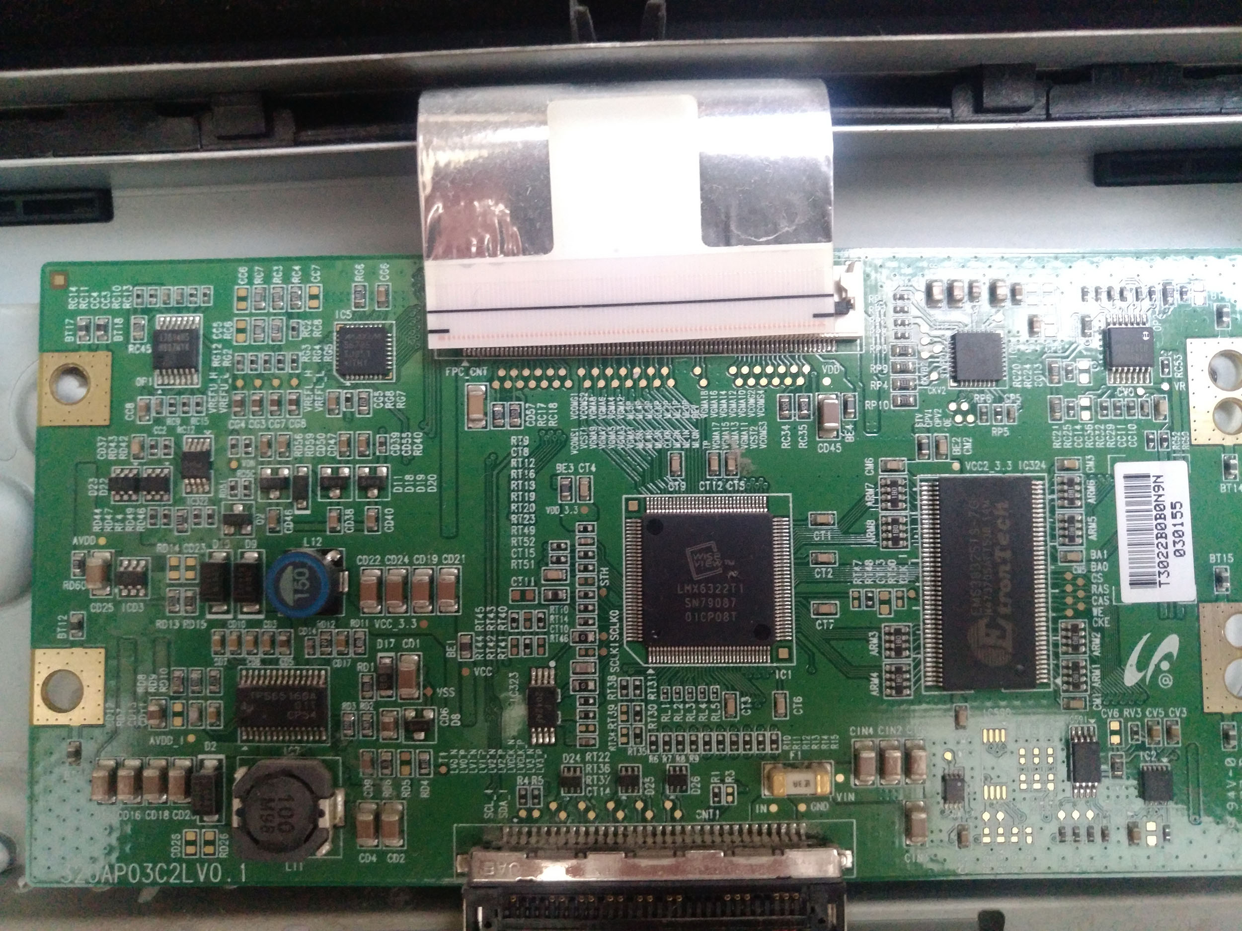

            Have a Samsung ln40A530p1fxza. Showing solarized colors, even the menu letters are messed up. Tried all inputs. Did factory reset in service menu, when tried to calibrate HDMI it always said "Failed". Yesterday tried to watch a football game and as I was browsing games, for a second the picture came back normal but then switched back to solarized colors. Do you guys think it is the T-Con board or a bad cable?
              Check other thread you posted in regarding this. You have a defective ic on your tcon board. Replace it or get it serviced.
