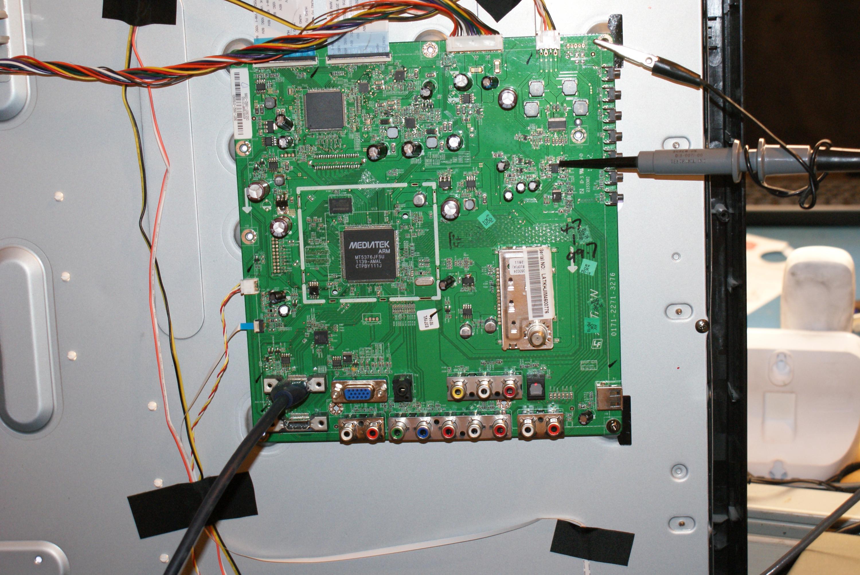

    i am getting no reading on 7
      Re: vizio tv e420vo No audio
      Other readings?
      Measuring using a scope, of course? You are tracing audio, not DC voltage.
        there is no voltage on 8 or out put on 7
          Just to be sure what settings are your scope set to.
          Lack of voltage on pin 8 is not good, as that should be the opamp power supply.

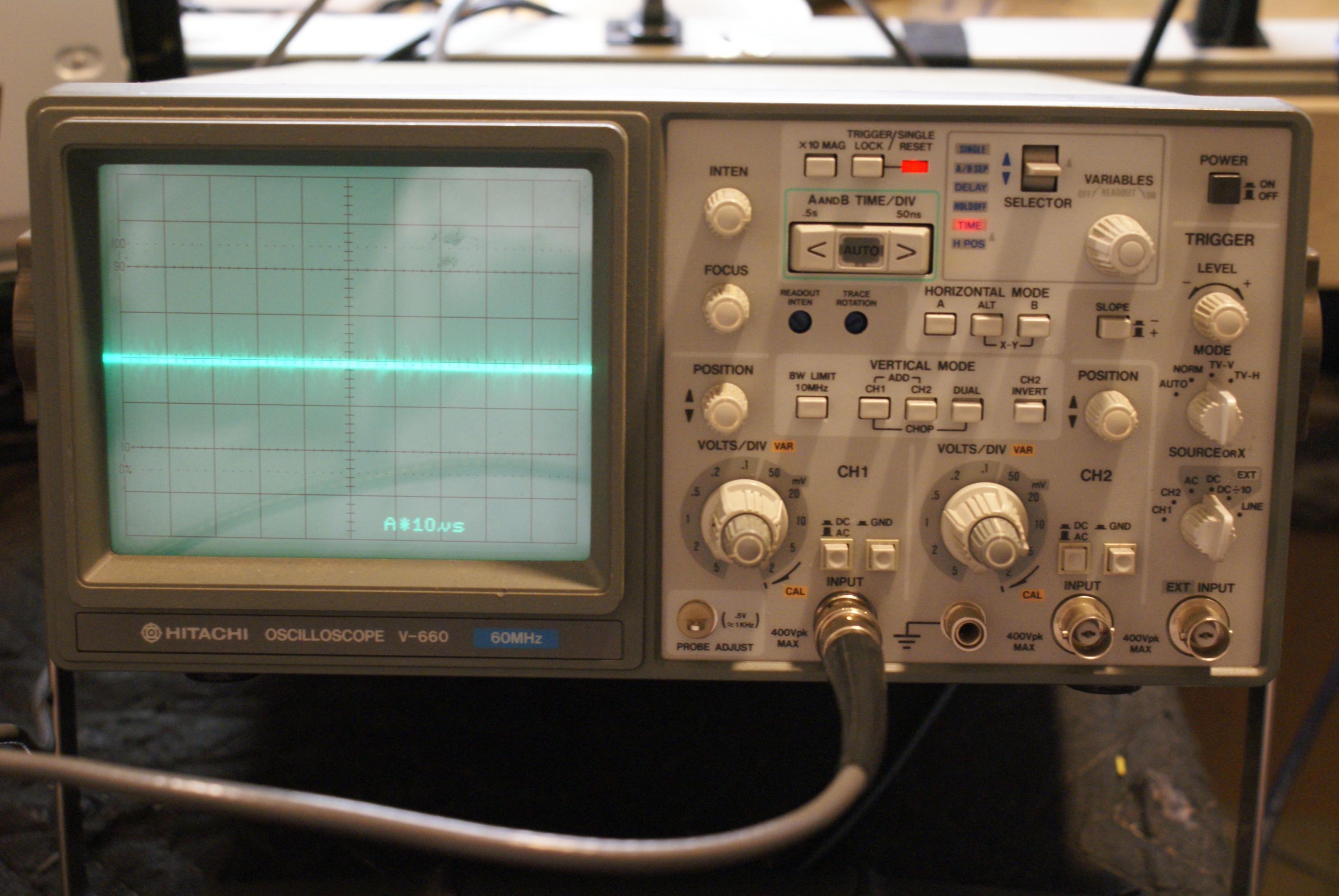

                i am trying to make sure that the scope is working.
                  Use the probe comp or probe cal output to test the scope. Hook probe to it and look for square waveform.

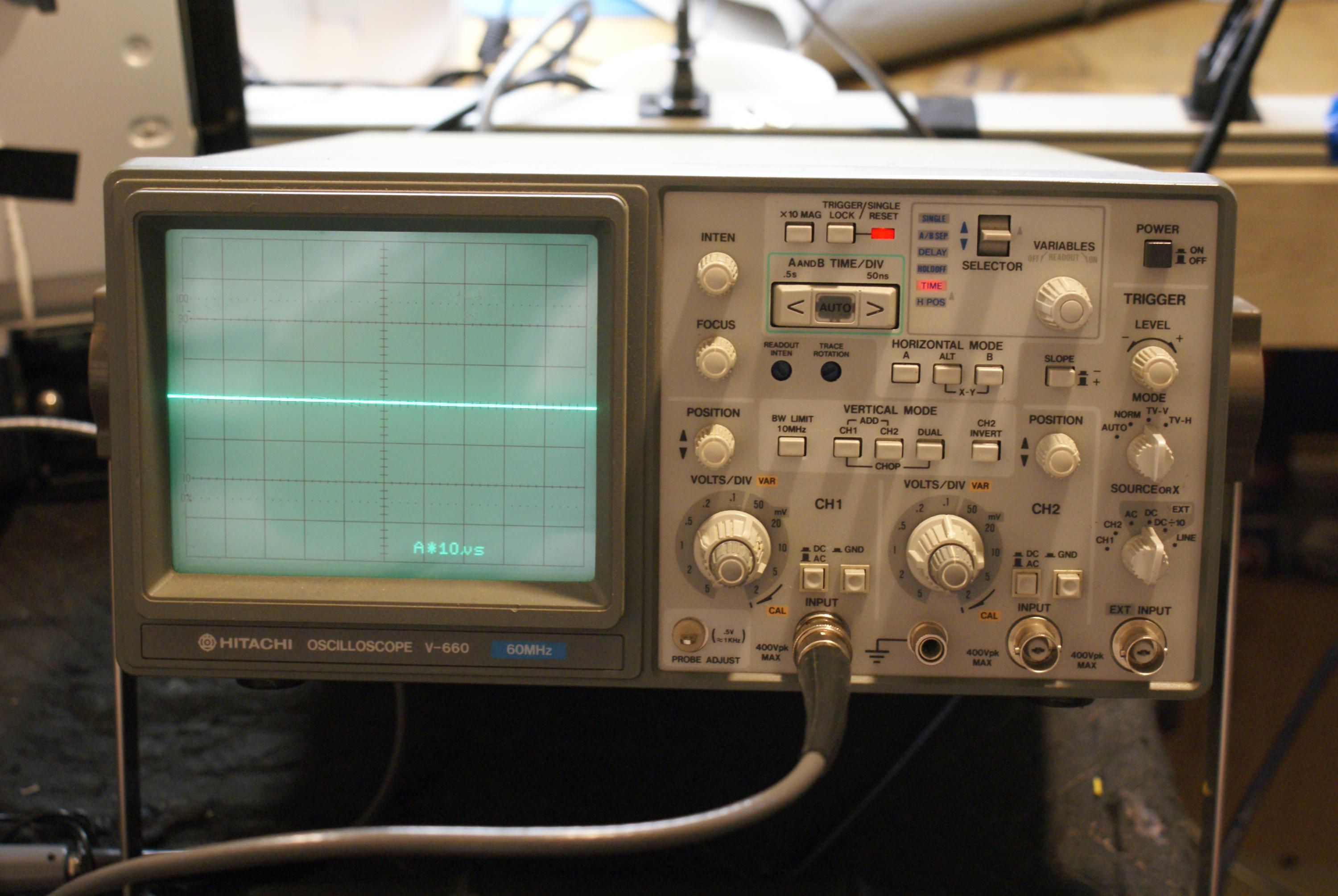

                                  i set the square to 5v and went i tested it it go 2 1/2 square wish is 12v if i'm not mistaking. Like i said i has never used it until now
                                    #37
                                    Can I see a picture?
                                    • ealequi
                                      • Dec 2012
                                      • 212
                                      • usa
                                      #38
                                        #39
                                        Connect probe to PROBE ADJUST.
                                        Volts DC to 0.1V/div
                                        Time to 1ms/div
                                        Select CH1 only
                                        Show me what you see.
