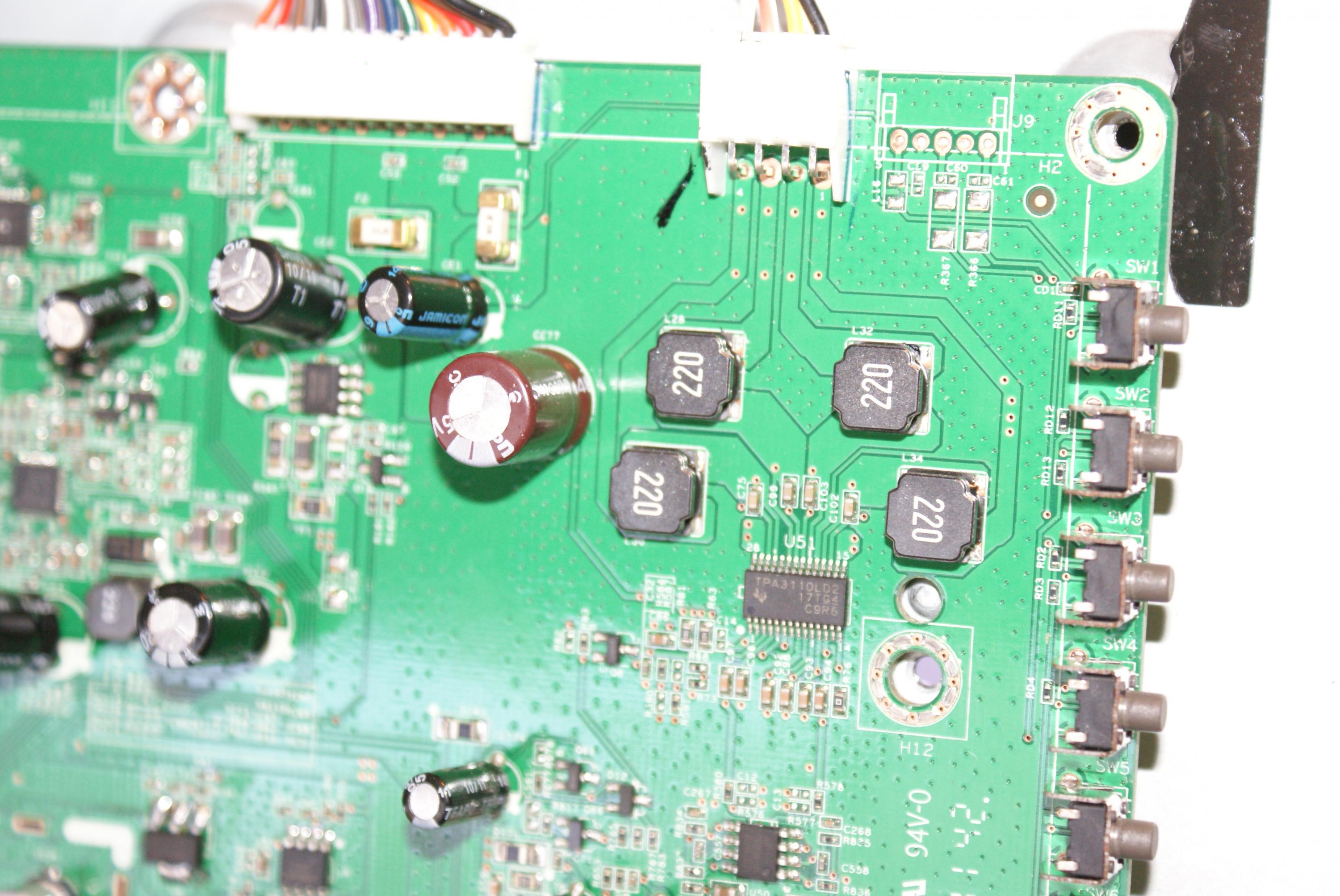

Part # of that chip near the speaker connector please.Please do not PM me with questions! Questions via PM will not be answered. Post on the forums instead!
For service manual, schematic, boardview (board view), datasheet, cad - use our search.Comment
Re: vizio tv e420vo No audio
TPA3110LD2 is what I wanted.
http://www.ti.com/general/docs/lit/g...2&fileType=pdf
Audio inputs are on pins 3, 4, 11 and 12. Check each for signal.
Verify 8V to 26V DC at 7, 15, 16, 27, 28 relative to chassis.Please do not PM me with questions! Questions via PM will not be answered. Post on the forums instead!

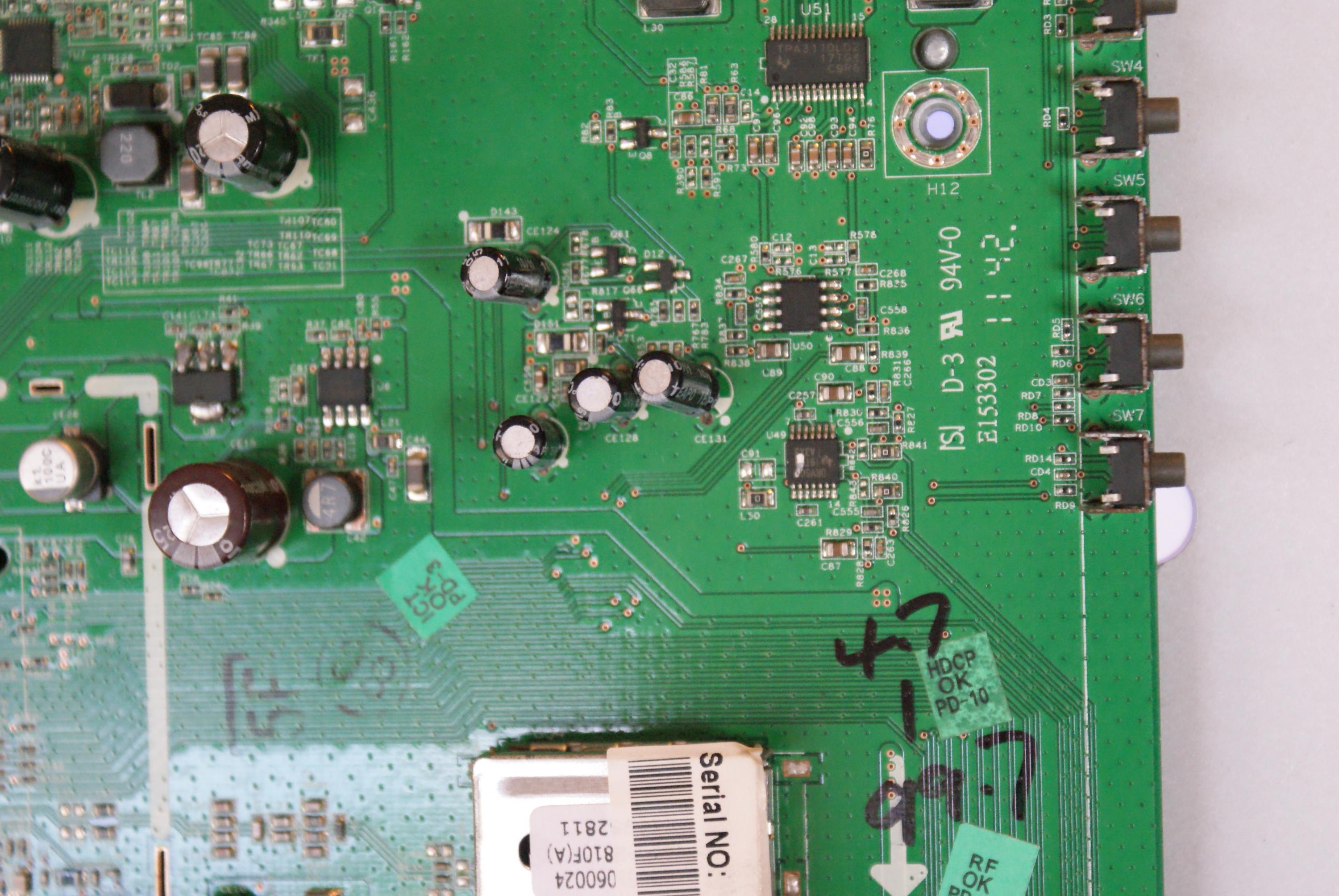

OK, 8 legged chip near the TPS chip, what is part #.Please do not PM me with questions! Questions via PM will not be answered. Post on the forums instead!
OK so as I thought it's a general purpose opamp.
https://cdn.badcaps-static.com/pdfs/...9fd35dadc9.pdf
Pin 1 and pin 7 are outputs of the opamp.
Pins 2, 3, 5 and 6 are inputs. Depending on the configuration two of them may measure a static DC voltage or not.
Pin 8 is positive supply, pin 4 is ground or negative.Please do not PM me with questions! Questions via PM will not be answered. Post on the forums instead!
