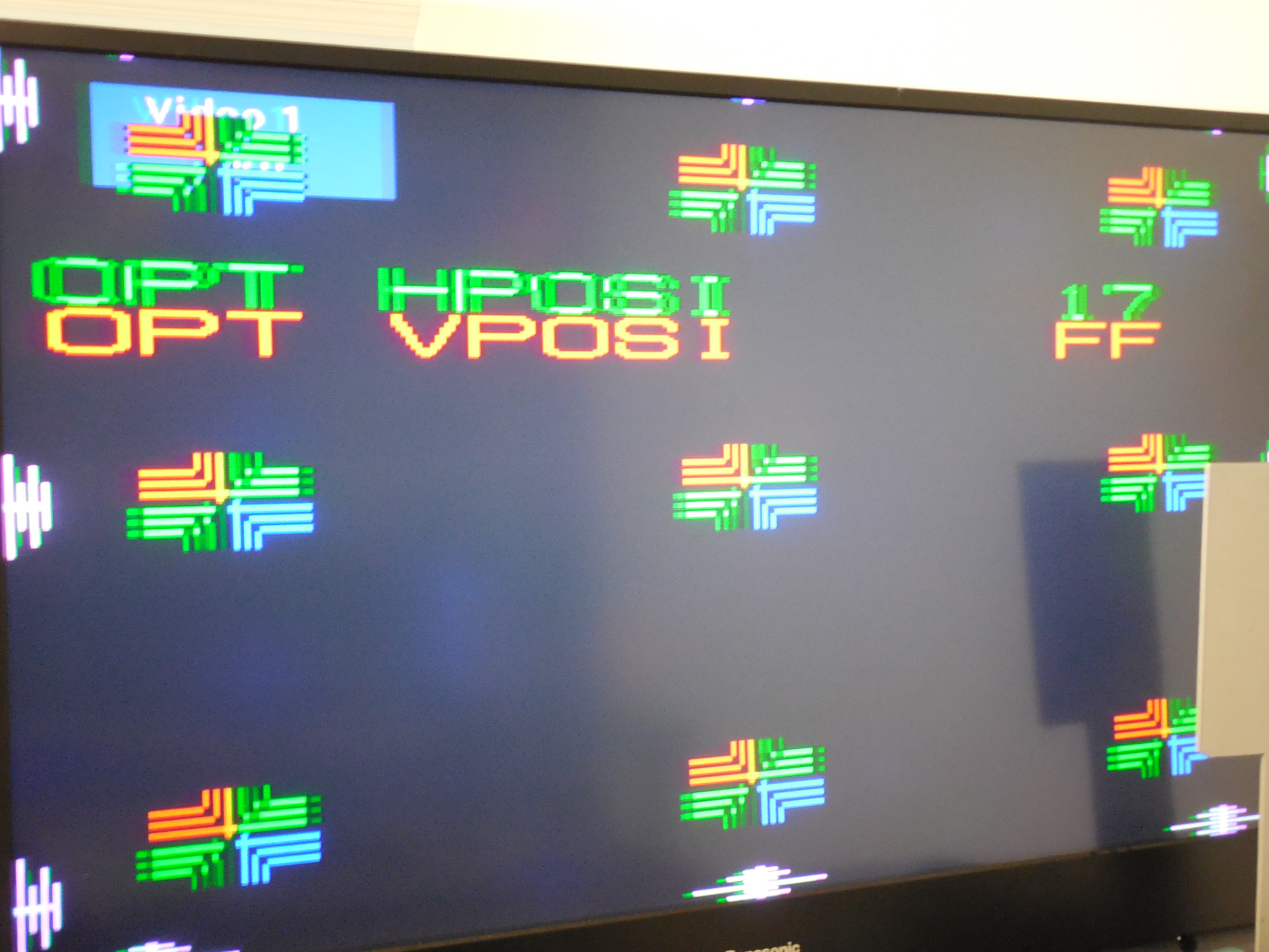

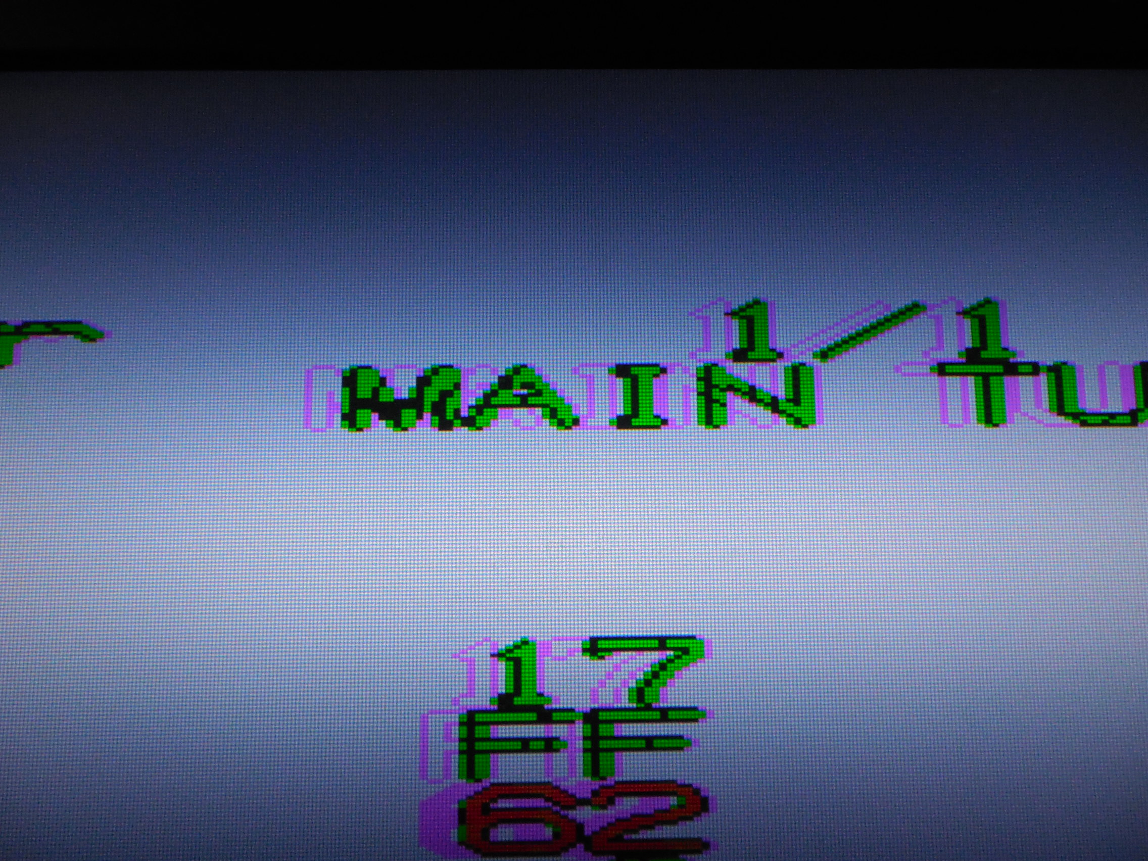

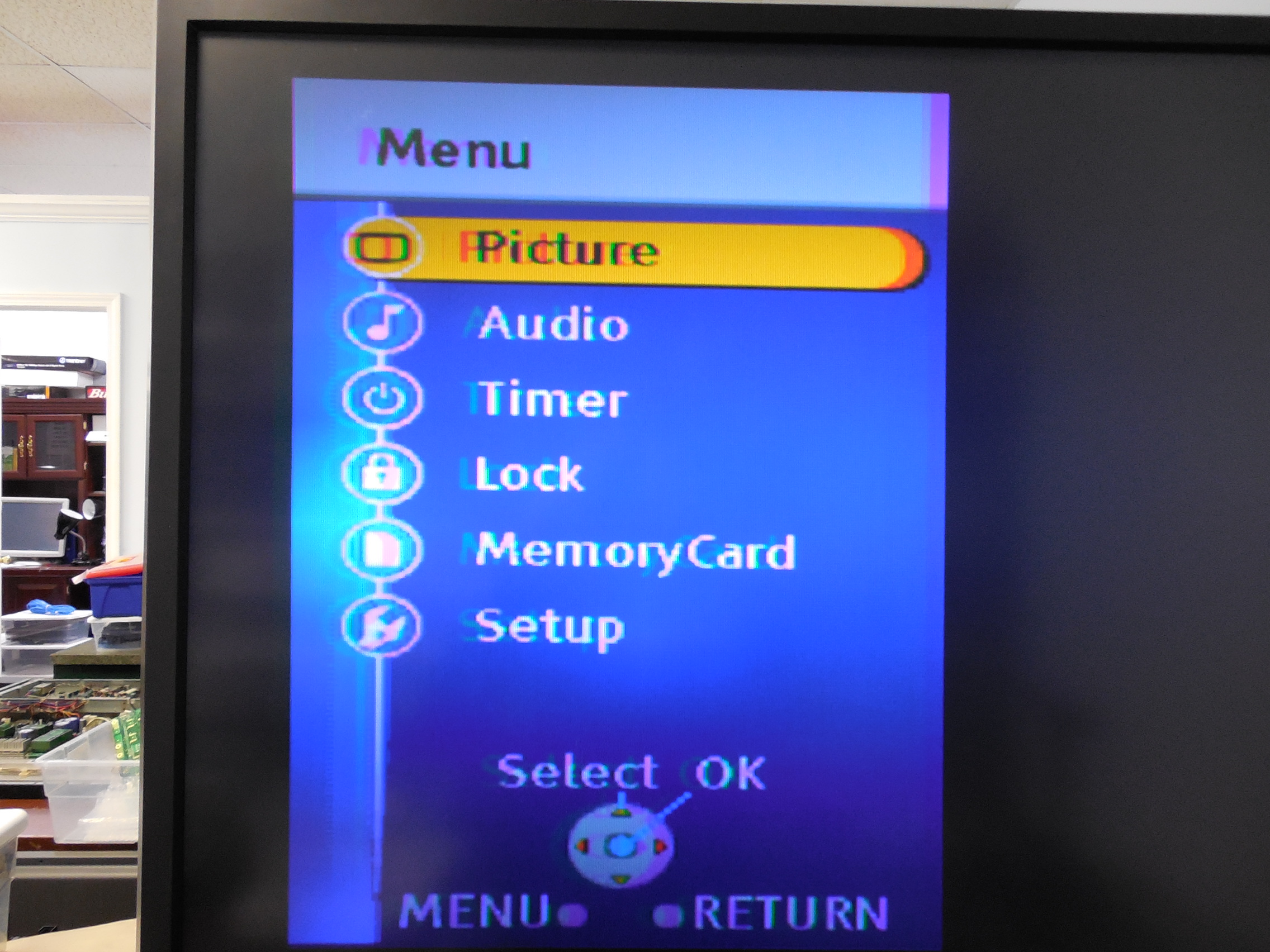

    This set works besides the colors being misaligned.
    This appears on all settings and was wanting a second opinion on the fault.
    I feel it is going to be the LCD controller that is causing the horizontal position to be off
    I also just want to say a lens or dichroic mirror is off place but would feel that would cause more problems and user said it just happened (wasn't moved or anything).
    Any thoughts? Or has anyone seen anything like this?

    It looks pixel perfectly off, not a lens alignment issue. Have you tried service menu reset?

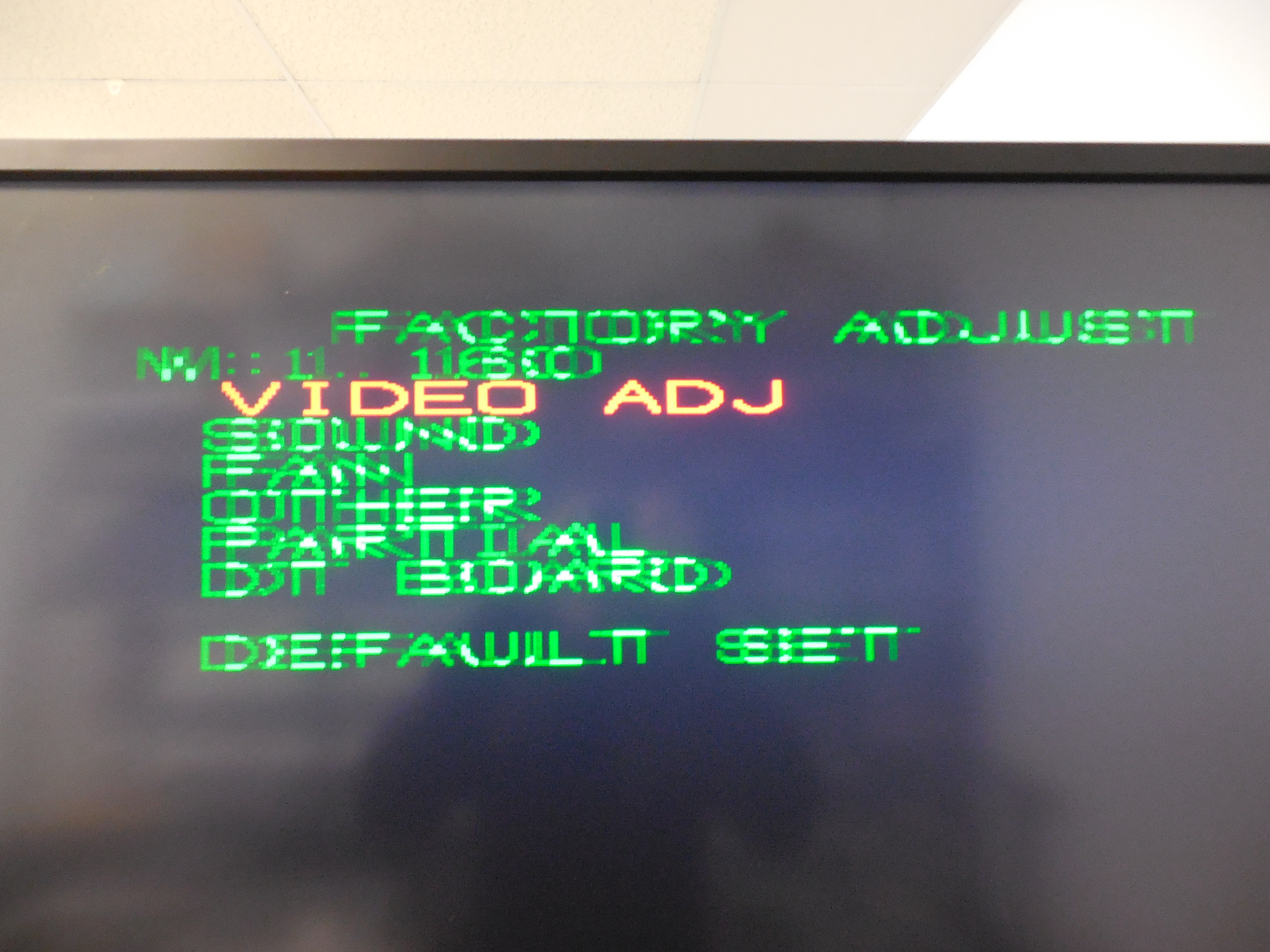

      Re: Panasonic PT-61LCX65 Colors off-sync
      I cannot find the service menu reset only system default reset.
          Ok, I'll rephrase:
          I can access the service menu (via button combinations in SM) but cannot find the factory reset option.
          I think those last two are for their plasma sets (and poss LCD too)
          But they did nothing.
            Ok, is the an option for moving individual LCD panel offset positions?
              The service menu reads:
              Service Mode (1/3)
              - Current Lamp elapsed time
              - The number of Lamp ON (For reference only)
              - BKSV number read-out
              Service Mode (2/3)
              - Key detection check
              - Communication check for IIC bus on the Main C.B.A.
              - Total Lamp elapsed time
              - EEPROM IC6007 version and build version (For reference only)
              - IC6003 software version and build version (For reference only)
              Service Mode (3/3)
              - IC6003 Port information
              Then Factory Adjust menu:
              There is a lot and I cannot copy and paste
              but there is a "DEFAULT SET" and that did nothing and under the picture menu, well you can adjust the values for the each individual color but unfortunately not position.
