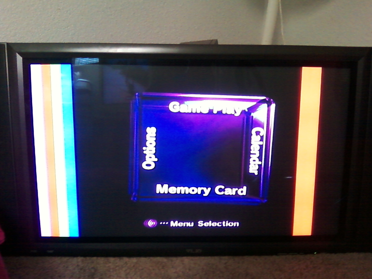

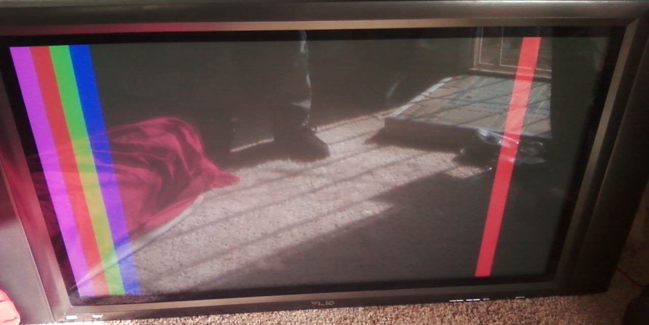

              Re: Vizio P42HD (Plasma) 2 Vertical Lines
              Attempting to fix the same issue on the same Vizio set. Came onto this post searching for a solution and wondered if the set is beyond fixing like indicated above. There are 2 vertical red bars,one to the right slightly off center, and near the left most red bar are green and yellow bars.
                Can we see a picture?
                • XeoNexus
                  • Feb 2013
                  • 8
                  • usa
                  yes, I will take and upload one now.
                    Hmm, I have not seen that before. Could you move it to an attachment on the post? It's taking a long time to load. To me, it looks like it could be a y-buffer problem, repairable. Have you tried it with an actual video source?
                    • XeoNexus
                      • Feb 2013
                      • 8
                      • usa
                      original and with a system plugged in.
                        I see the red line got bigger. Does this return to how it was if you remove the source?
                        • XeoNexus
                          • Feb 2013
                          • 8
                          • usa
                          The bars change whenever I bump or move the set. No change when using the inputs.

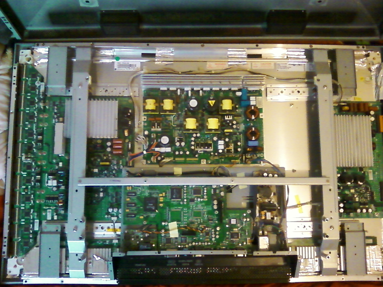

                                No change re-inserting the connections. I might be in the wrong area, but I didn't' see what you described on the bottom. The only thing similar to that were about 10 ribbon connections on the far left side. I tried what I could find, besides the connections from the PSU.
                                  Can I get a picture of the chassis? Also, who made the plasma panel in this model? Samsung, LG, Panasonic, ...?
                                  • XeoNexus
                                    • Feb 2013
                                    • 8
                                    • usa
                                    LG made the plasma panel (PDP42x21000). Sharpest picture I can get with my cell phone.
                                      OK, the ribbons on this model are hidden behind those heatsinks on the bottom.
                                      You will unfortunately have to remove all of the main board and framing. Then remove the lower heatsinks and reseat every connector. DO NOT power up the set with those heatsinks removed -- doing so will destroy the plasma panel drivers in short order, which are not replaceable (without swapping the panel itself.)
